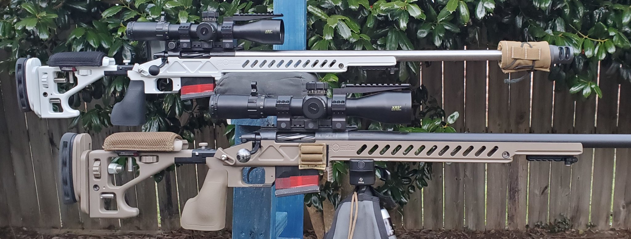

Hi, everyone.... my name is Hollywood, and I have a Tempest problem....
Top:
2020 production Tempest in 6GT
Bartlein GAP #7 barrel
PDC Custom Gen 5 Competition chassis
Bushnell XRS2 in Hawkins Heavy Tactical Mount
Armageddon Gear Cheeky Bastard
TLC Grips pistol grip
Timney HIT trigger
Bottom:
2015 production Tempest in 308
Bartlein Medium Palma barrel
Timney HIT trigger
The Area 419 Maverick, Kestrel HUD, and Atlas CAL bipod (not shown) get moved between rifles as needed. I still have a little paint work to do on the white chassis, and I need to find another SAP 2 round holder to go on it.
