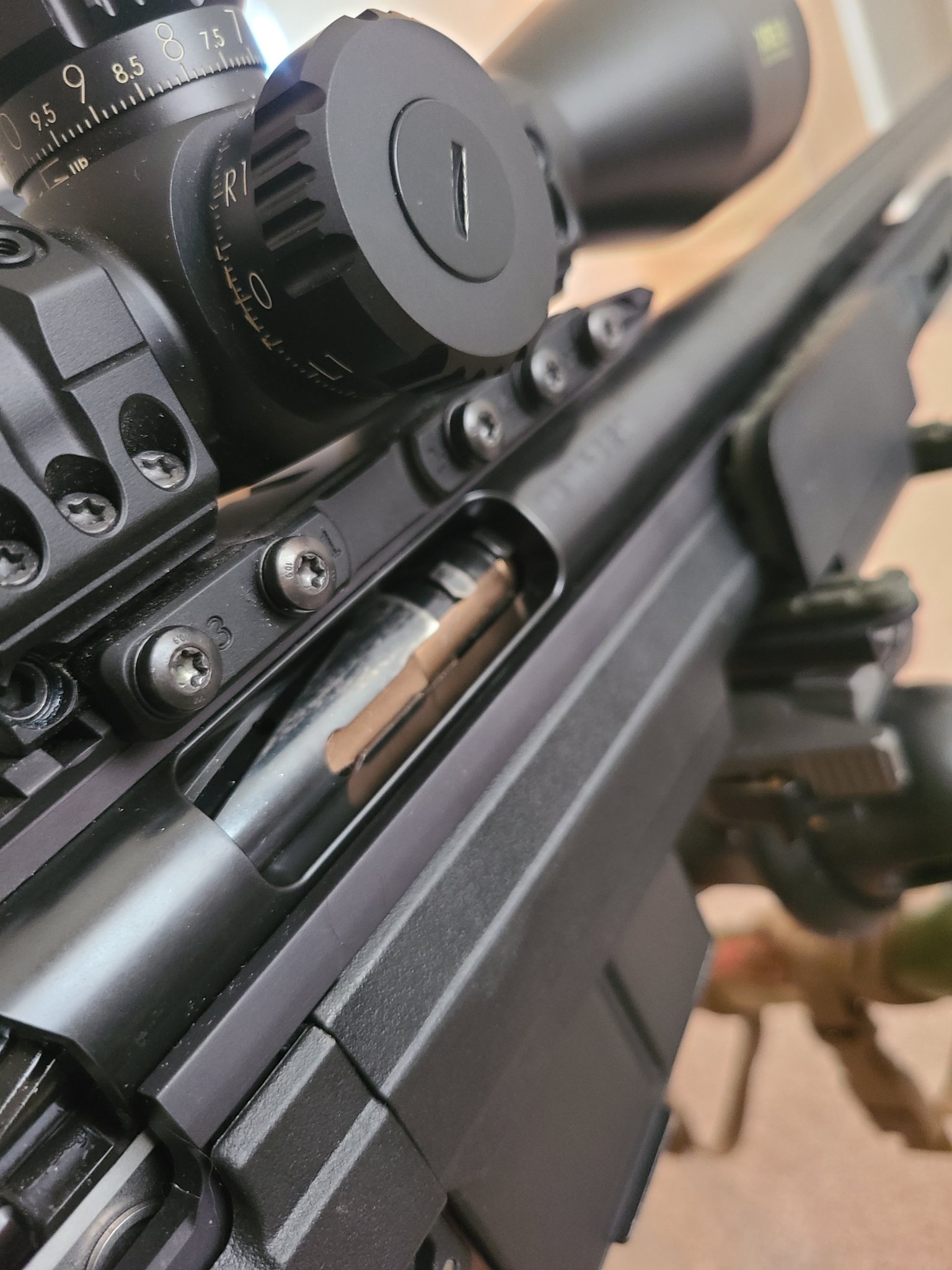

That makes absolutely no sense. The round is already loose from the magazine and clear of the feed ramp at that point. Can you be more specific on how it's binding up? Is the bolt not going forward?
That is what is getting me. I tried feed lip adjustments, making sure my magazines have no play by getting the extended mag catch. The bolt just hits resistance and comes to a complete stop. I have to wiggle or back the bolt out to get it to go forward.
I am just going to stop chasing my tail with this and start fresh. Have new aw mags on the way. The mags i was were adjusted to my vector. I think if i keep messing with the feed lips ill weaken them before i can get them adjusted, so ill probably just get rid of these 2. Ill go from there and trim the mag catch.
I'm pretty sure you don't have a mag issue now that you've posted a photo. Try single-feeding a round into the chamber (with and without a mag inserted). Does it ever do it without ammo involved?
Where your bolt is located in the photo is WELL after the point where the magazine is involved in the feeding cycle. Unless something is getting hung up between the mag and a flute on the bolt (which I doubt) I think you have a different issue.
Reactions: 5RWill and jb41291
No issues single feeding with and without mag. Doesn't do it without ammo.
I contacted kevin lin over there. He recommended i open the front of the feed lips. Did that and still didn't work.
Did you send Ken the same picture?
In the photo, your front bolt lug is at the edge of the ejection port. At that point, the bolt is completely covering the magazine well. If that's where it's hanging up, I don't see how the magazine could be the issue - but there could be something I am missing.
I'd still say call them tomorrow, and send them the same photo you posted here.
Reactions: jb41291
Will do. thanks for all the help. Worst comes to worst i'll pick up a trg 🤣
Its always binding at this point in the cycle.
If it's catching/"binding" at this point only with ammo then I bet it's not actually binding. I willing to bet it's a sharp edge on the chamfer leading into the chamber or a lack of chamfer with a sharp edge that your cases are catching on. Check to see if you shaving a bit of brass off of the cases. I've had this issue in the past.
I do see some brass shavings in the area. I will pm you. Dont want to flood the thread anymore with my problem.
