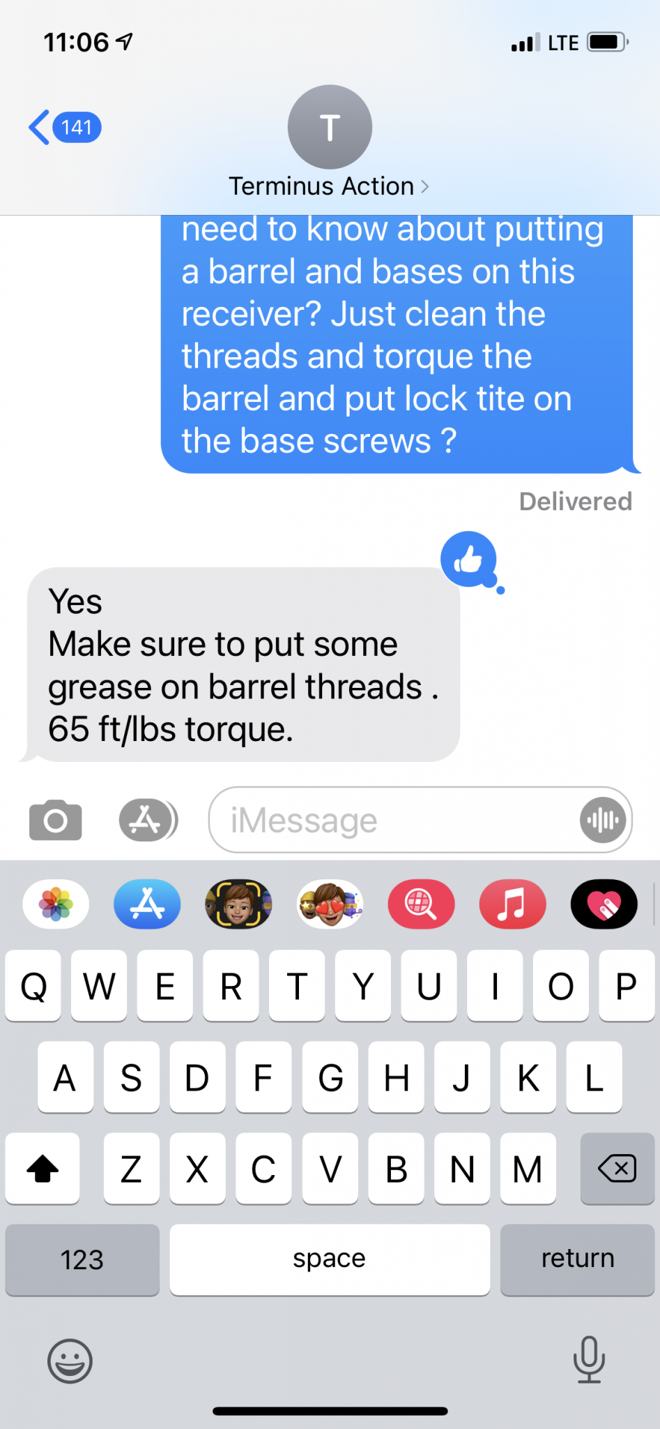

GreaseJust got my Zeus and I was wondering if the threads go together dry on the QC system or should I put a little lube on them? @Joel Russo
But still put grease
Well shit. Next time ill switch my QD system to aint-seize instead of blue loctitePut some anti-seize is what Joel told me. For the QC system, the set screws are 10 in/lbs.
No loctite. Not on the barrel and not on the QD screws.So for the QD system, we should grease/anti-seize the barrel threads but blue locktite the set screws?

Ask him (@USACS) why he didn’t use any. Anti seize isn’t necessarily required. Some kind of grease is a good idea but the thing is it kind of defeats the quick change system. If I’m swapping a barrel in the field. I don’t have that stuff with me nor am I going to clean the threads in the action.I didn't see him put any anti seize on threads. I thought that was necessary.
I didn't as I knew I was going to be swapping barrels. I keep a little tube and apply it now when I do swaps. The sun still rose the next morning even withoutI didn't see him put any anti seize on threads. I thought that was necessary.
