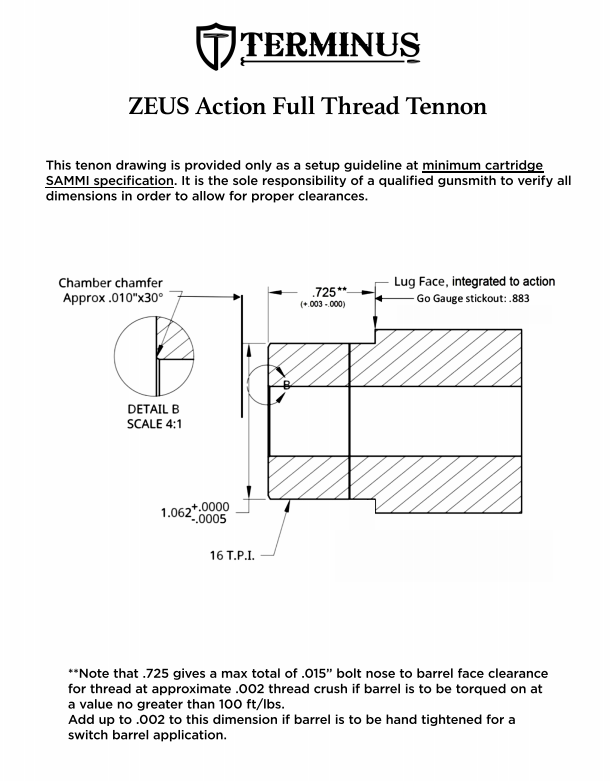

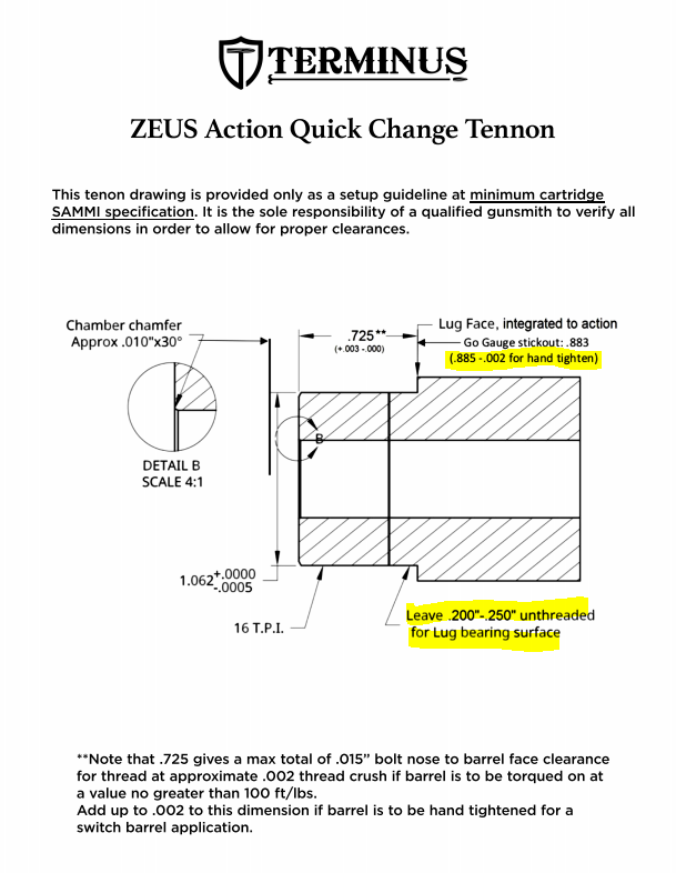

Are most of you ordering the full thread option or the quick change? Can you still full thread a barrel on even if you ordered the quick change one?
I know I have to specify which type of threads I want on a prefit barrel when ordering but that’s where my knowledge stops on that
Yes, you can still torque on the pre-fit bbl even if you ordered the quick change Zeus. Just make sure you order it as torqued.
For example, on Straight Jacket Armory's Pre-Fit page, you can choose, full thread torqued, hand tight, or torqued.
Thinking I might as well order the quick change action then to always have that ability
what’s the difference between torqued and full thread torqued?
Reactions: DangerRanger
His post wasnt very clear.
The zeus action itself only comes in two ways, either
  1. quick change or
  2. full threads
In the quick change action you can set the barrel up to either 1A) hand tight or 1B) torqued on. There is no 2A or 2B option, full threads gets torqued every time.
VS
Does anyone know if a barrel threaded for quick change threads but torqued will work on a full thread?
Switch barrel tenon will not fit on Full threaded Version (as is).....Switch barrel version will accept both.
On fully threaded Zeus the threads are all the way through the recoil lug section.. meaning it either has to be fully threaded to shoulder or recess leftovers need to be cut below threads..
