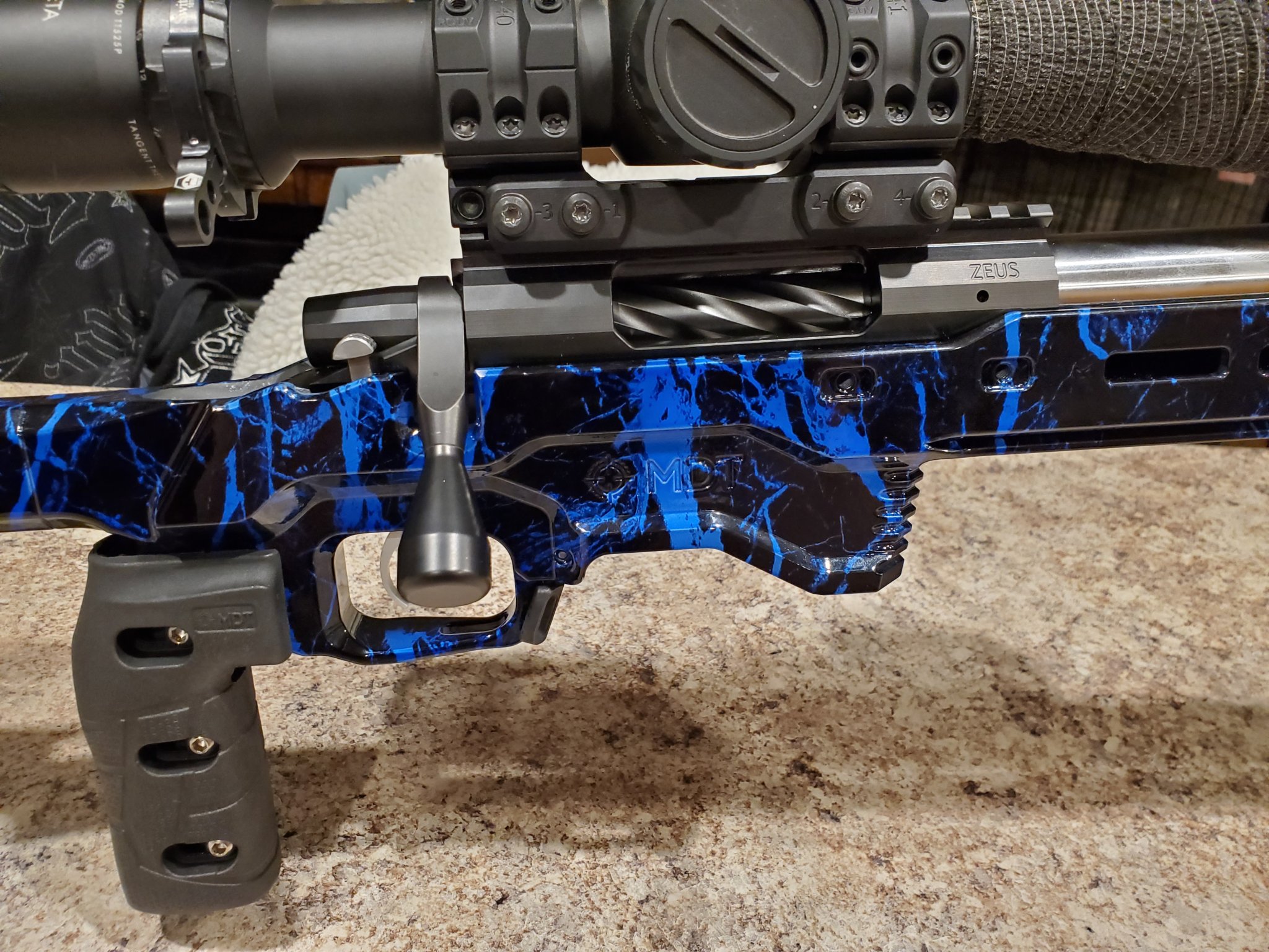

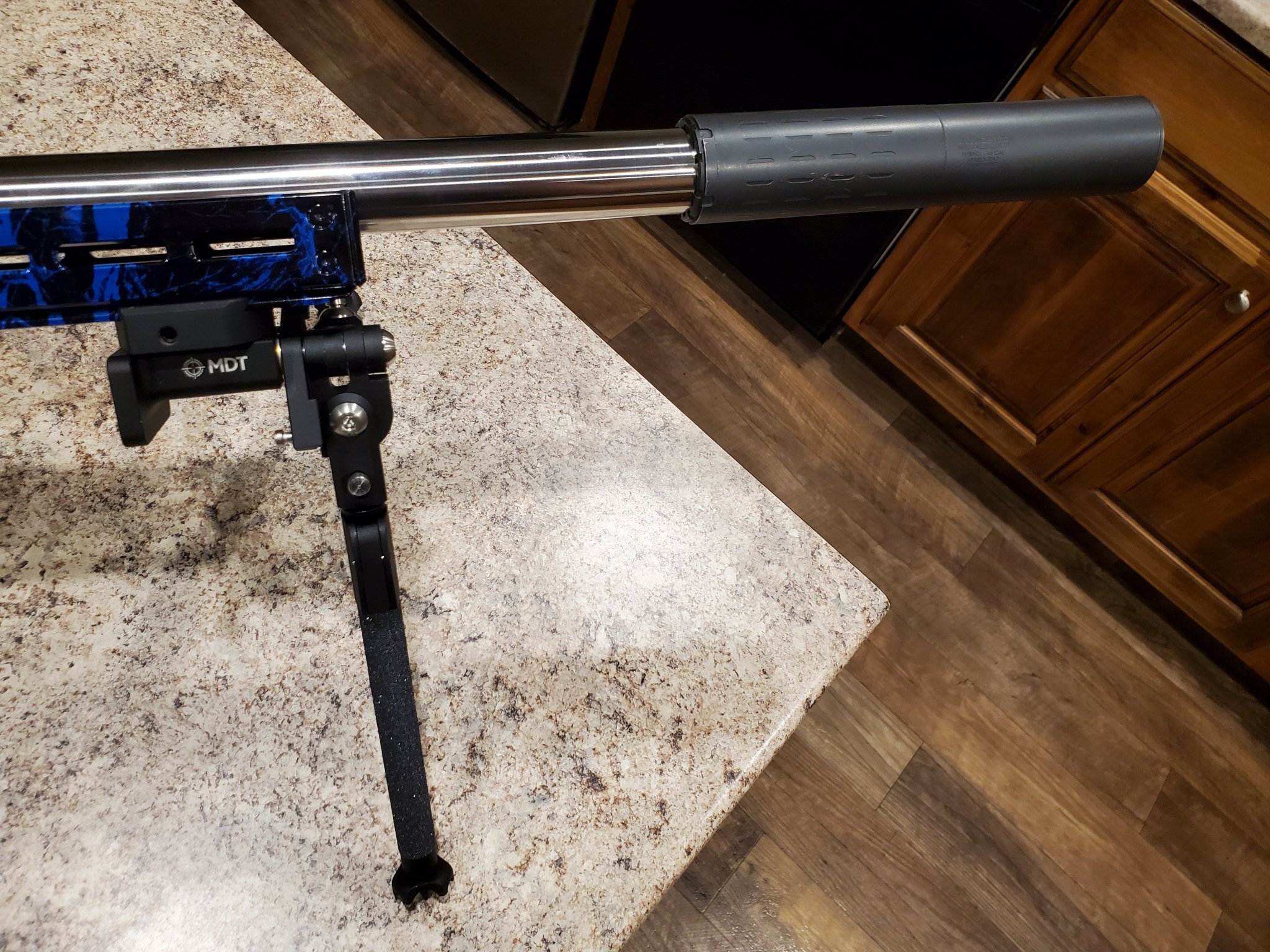

The 22BR is finished...
Built by Brad Hiskey of Brad's Precision Rifles, Spanish Fork, Utah.
1.25 straight Bartlein 4groove 1:6.5 twist
Finished at 22" with a SilencerCo Hybrid
My TBAC 6.5 Ultra 9 should enter jail this month.
Hydrodipped by Black Ice Coatings, Spanish Fork Utah.
So far it feeds from AW mags with HRD kits but two of my three need to have the latch filed just a tad more, one works perfectly.
With that throw lever oriented this was do you not find the your thumb hits it when cycling the bold?
It's on 5x and I don't really shoot there. It has a small nub that the lever fits over, so I don't have an option on where to put it sadly.

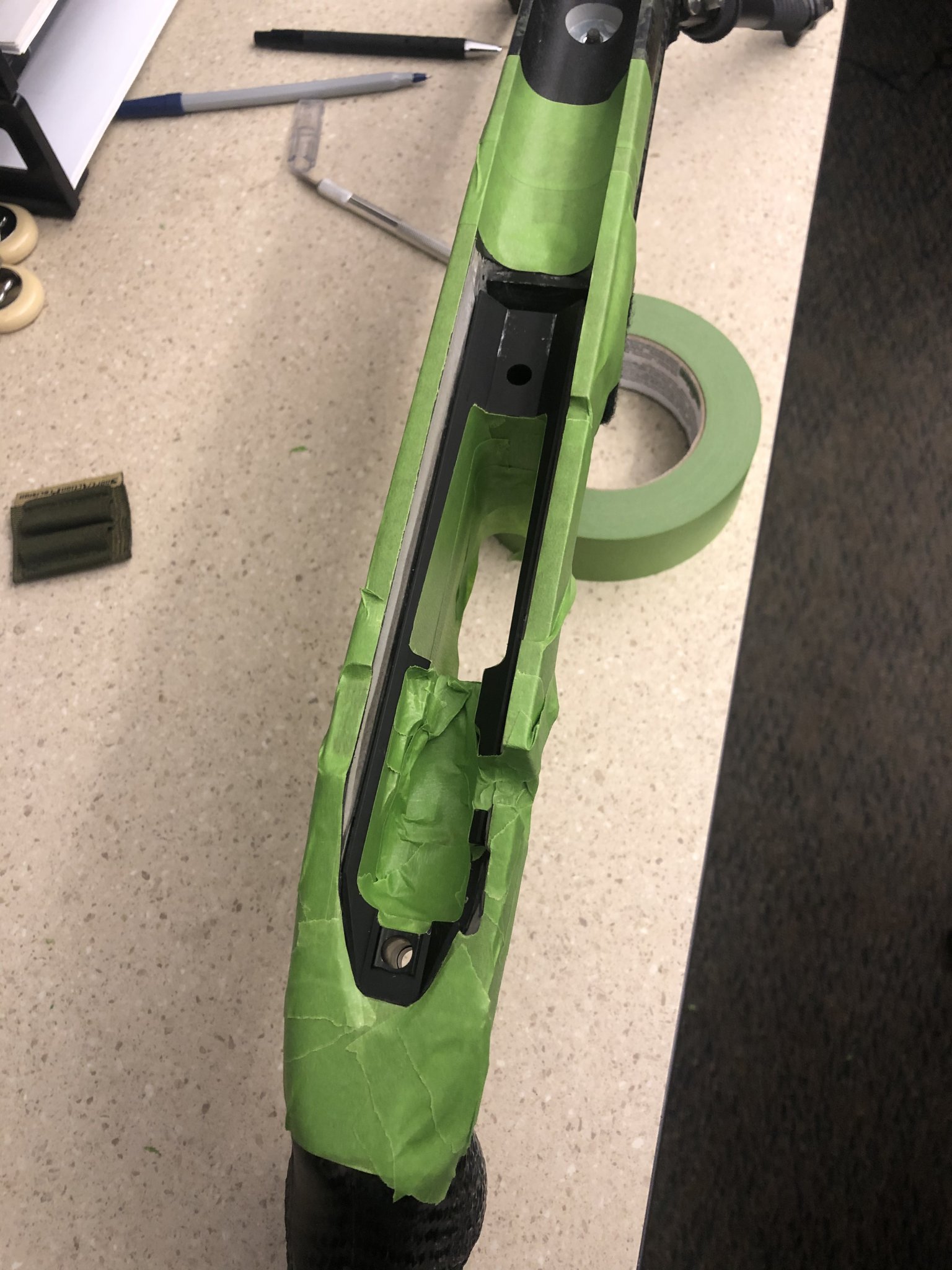

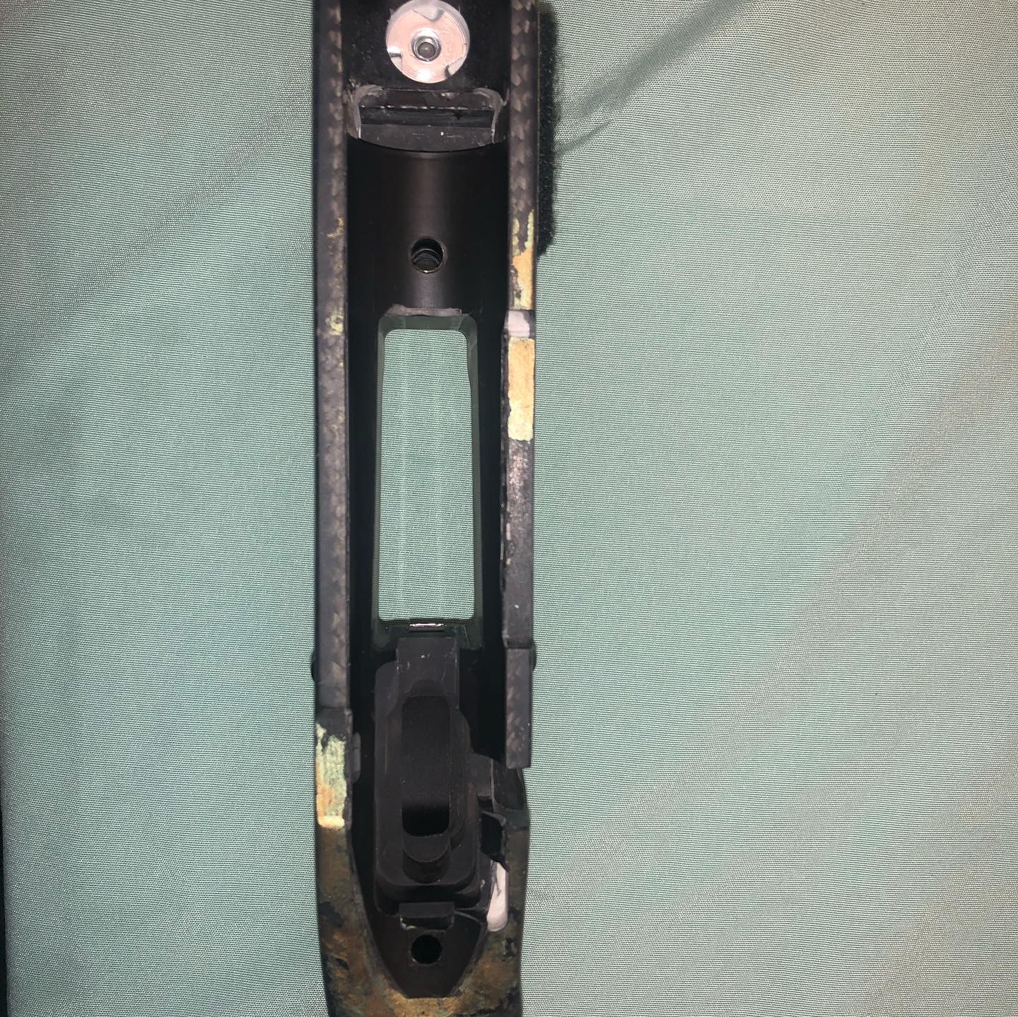

Bedding a chassis is like getting life insurance at the age of 30. It’s cheap, you might not have needed it, but if you do you’ll never know it. Ha
I’ve bedded all of mine and I definitely don’t have to chase my zero or have issues with my rifle “settling”
After my issues with my ACC, I will continue to bed everything in the future; split groups are infuriating.
