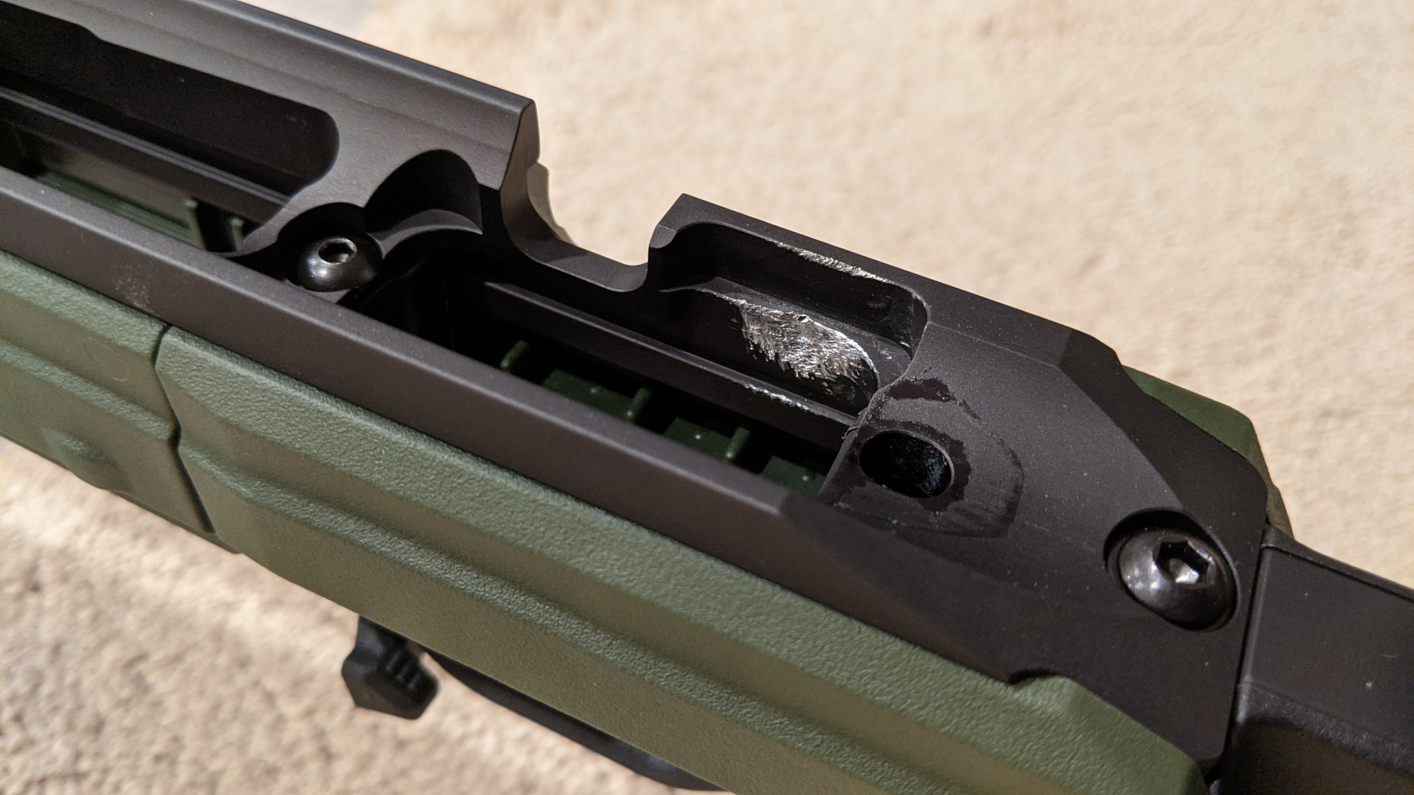

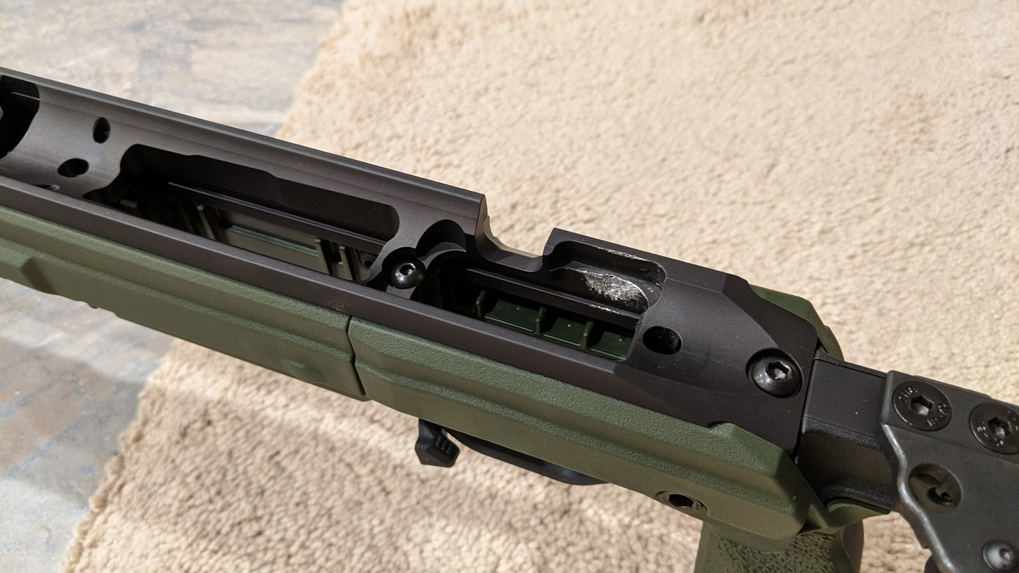

Just a note, I'm using a KRG Whiskey 3 with TT Diamond. I had to take some material/aluminum off the chassis so that the TT would go in to safety. Hope that helps out someone who might be using the same components i am.

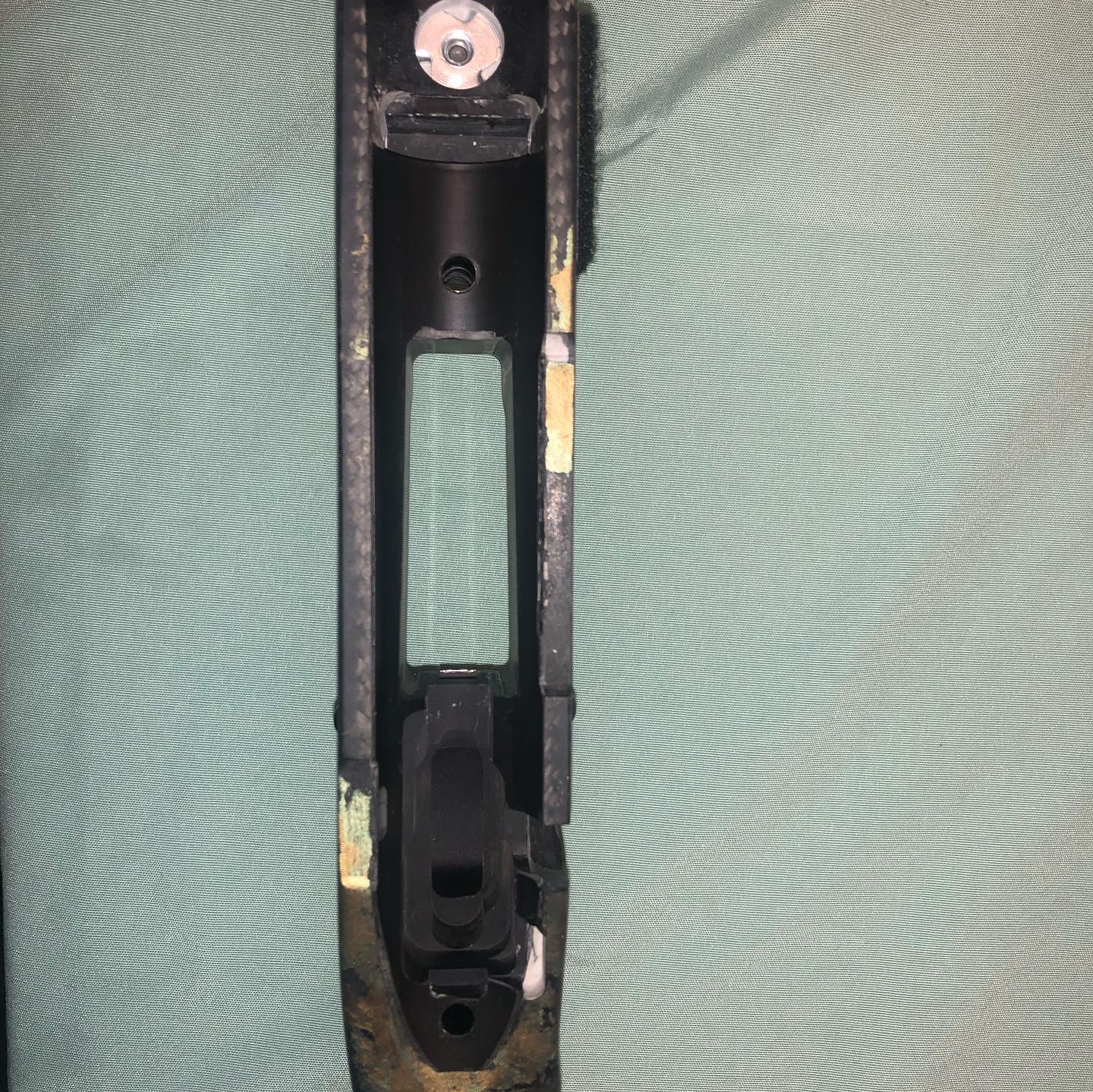

Any pics of the mod?
It ain't pretty, but can't see it when the action is installed, unless you shine a light down there ?
My other W3 with TT Diamond and Nucleus did not have this issue. My Seekins Havak had the same issue with the TT and Bravo Chassis.
My other W3 with TT Diamond and Nucleus didnt have this issue. My Seekins Havak had the same issue with the TT and Bravo Chassis.
Thanks for the pics.
Stack up tolerance on these precision components is ridiculous my TT safety has an 1.4 degree angle relative to the sides of the trigger housing. Im going to put it on a proper indicator but it looks to me like the lower angle is off on most of the TT safeties. We maintain better tolerances on pipe bends in the heavy duty diesel engine industry. I think bending the safety in a bit is in order once my action arrives. May have to make a jig to keep from damaging the trigger. If that doesn't work I guess it will be dremel time.
Mine looks like that as well. TT Diamond on a TL3 in a Bravo. Not sure what caused it, but I just dremeled it out to make the safety clear.

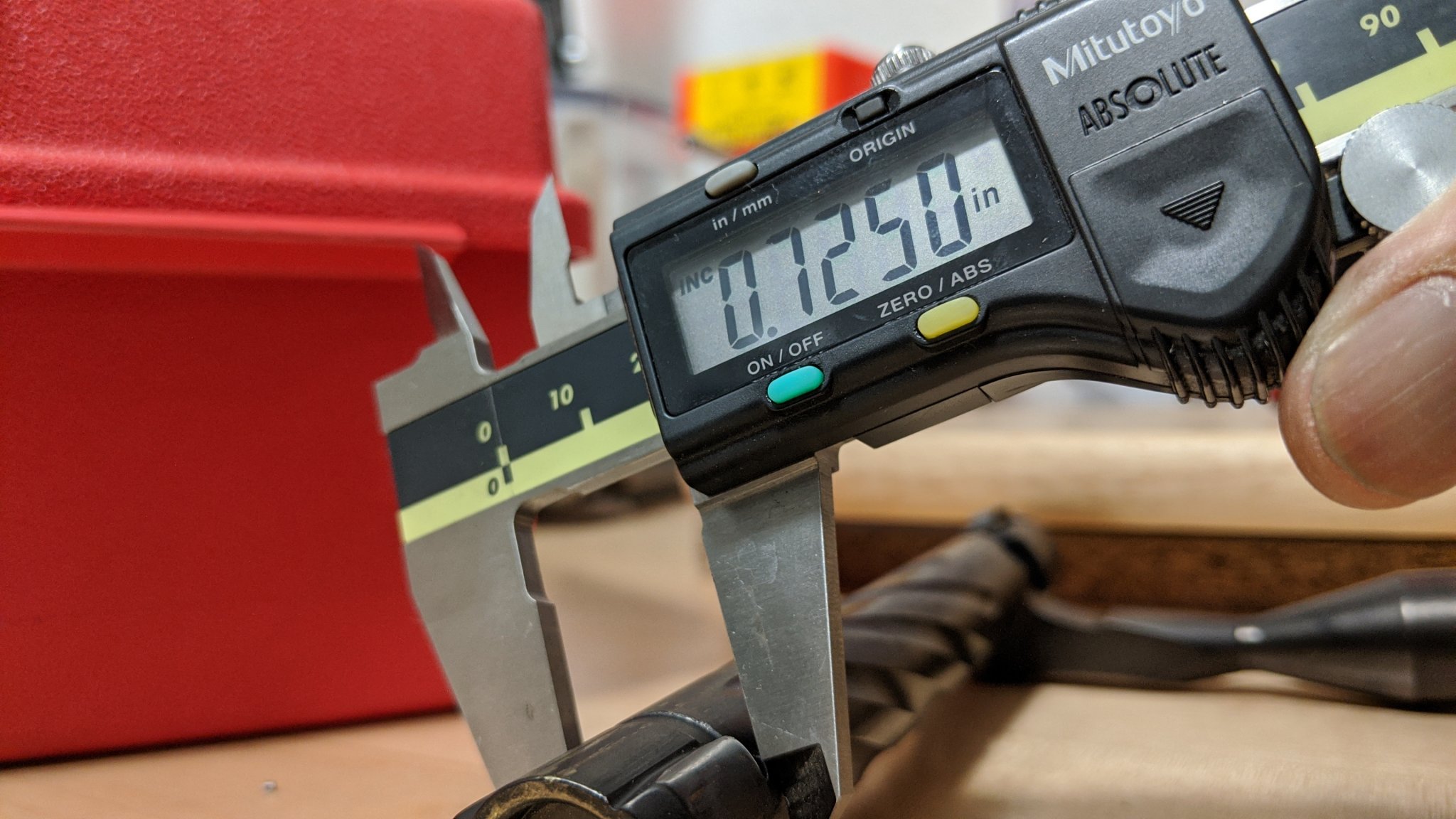

@DDRH65CM , you seem to be having a lot more bolt binding issues than some. Would you mind putting some calipers to your bolt to confirm it is truly a .725 bolt?

@AXMC Sure i can check for you later, but i'm sure i have the 0.725" bolt. I requested the updated action.
But again, I DO NOT have a Bolt Binding issue. It is possible the KRG Whiskey Chassis' magwell is slightly oversized compared to actual DBMs.
AW magazines work fine and there is NO BOLT BINDING.
The Single Feed Magazines (AICS) is thinner in the back and can ride up the action if pushed up from the rear and cause the bolt to bind. AGAIN THIS ALSO HAPPENS TO MY ORIGIN (And it's cut for AICS). This is NOT like the Vector issues.

@AXMC
Not sure I'm measuring at the correct spot...but here's a photo of the bolt diameter. 0.725"

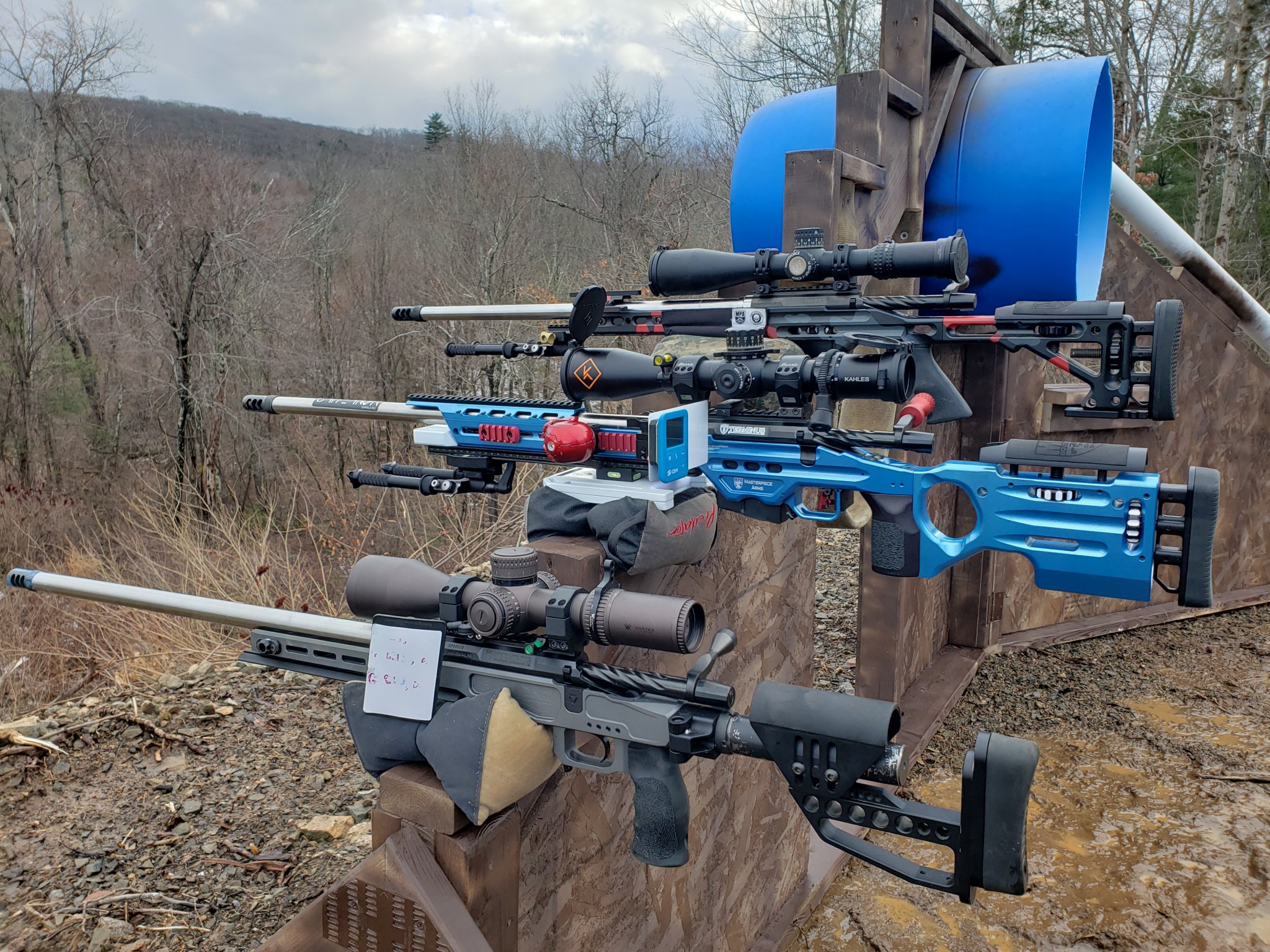

@Redeye3 Which actions are those, and any range reports?
6.5 has about 130 through it. 140eldm-140Berger's-- sticking with the 144 hybrids at 2800ish. Shot great at 1000 no vertical that I could see, 6" plate hitting or barely missing left and right. Still have some work to do.
144 60off lands 2.900 42.2 h4350 in Lapua 5x
6xc was brand new, he was shooting old ammo. He didn't seem happy but gun run flawless
223 I think he's running 75gr eldms at 2900ish. Still in load development, I sent a couple through it. I want one as a trainer
All ran great no hiccups

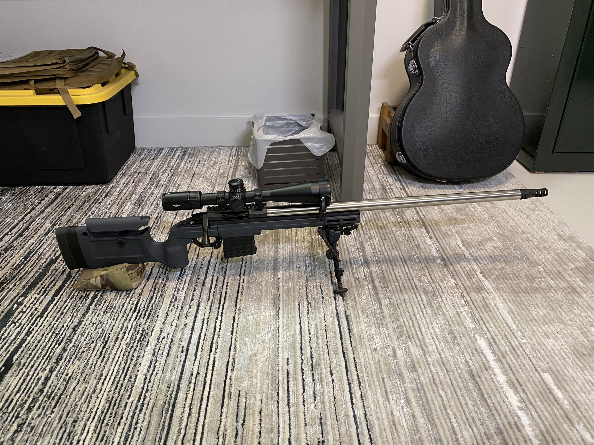

Got my Zeus last Friday. Spun it up on a 26” Benchmark Comp MTU in KRG Bravo. Bix n Andy Tacsport. No issues. Started load development. 15 shots .002 of lands varying from 42-44 grains H4350. All fell within one MOA. I will say that the Zeus will need to be ran a bunch to smooth out more but the DLC coating is money. Machining looked great. No weird finishing marks or extra material in any crevice. Top-notch work.
Also, the hand-tight barrel swapping option is very nice. Not worried about significant POI shift but will report back if I find anything worrisome. First hit at 1000 going to take off and reinstall barrel and see if I get another hit. If so, will repeat at a mile.

Awsome man. Thanks for the insight. Sounds like it's a 6.5cm? That's what I'm having sounds up. Benchmark barrel as well. M24 contour only 24".
