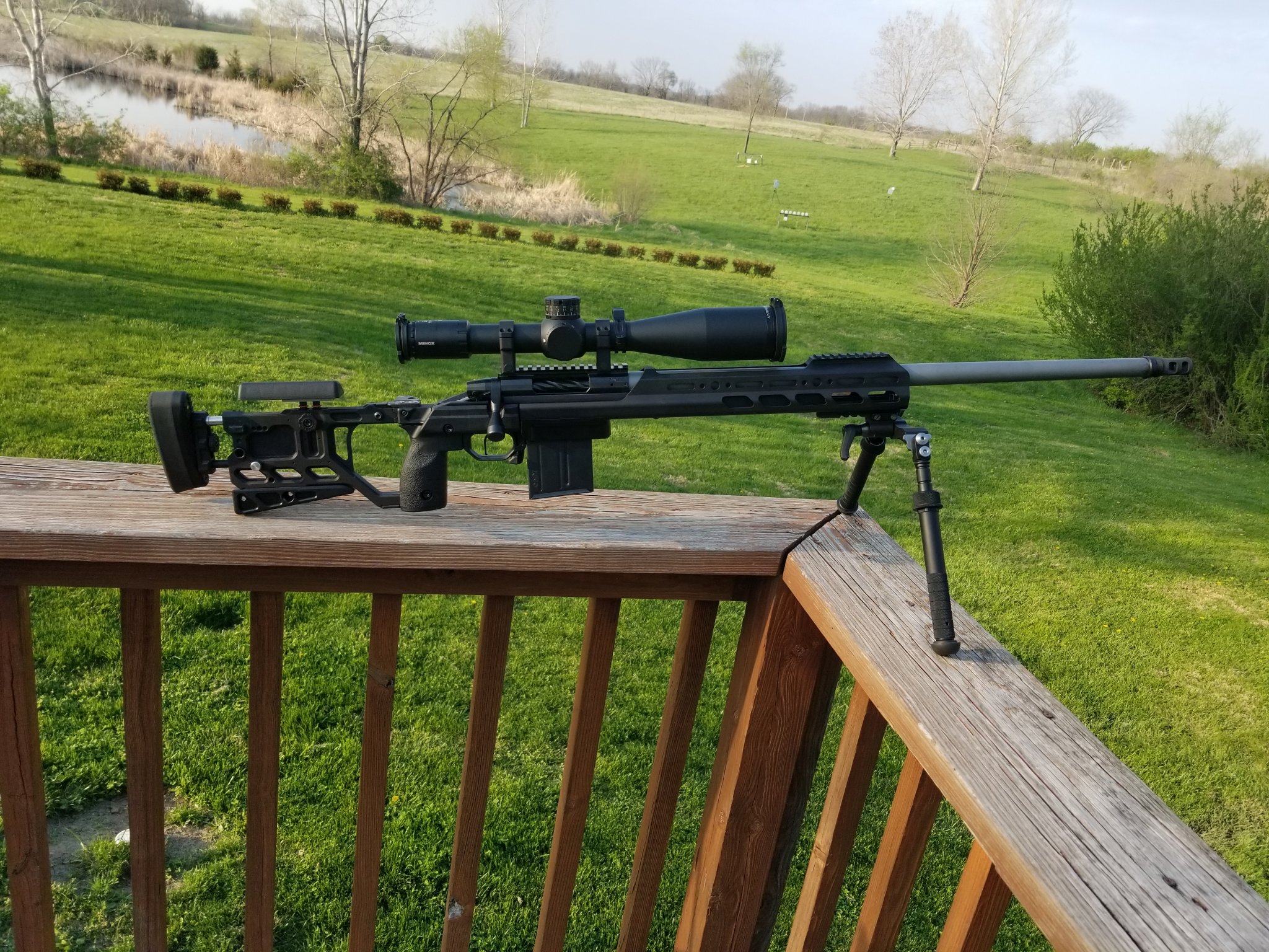

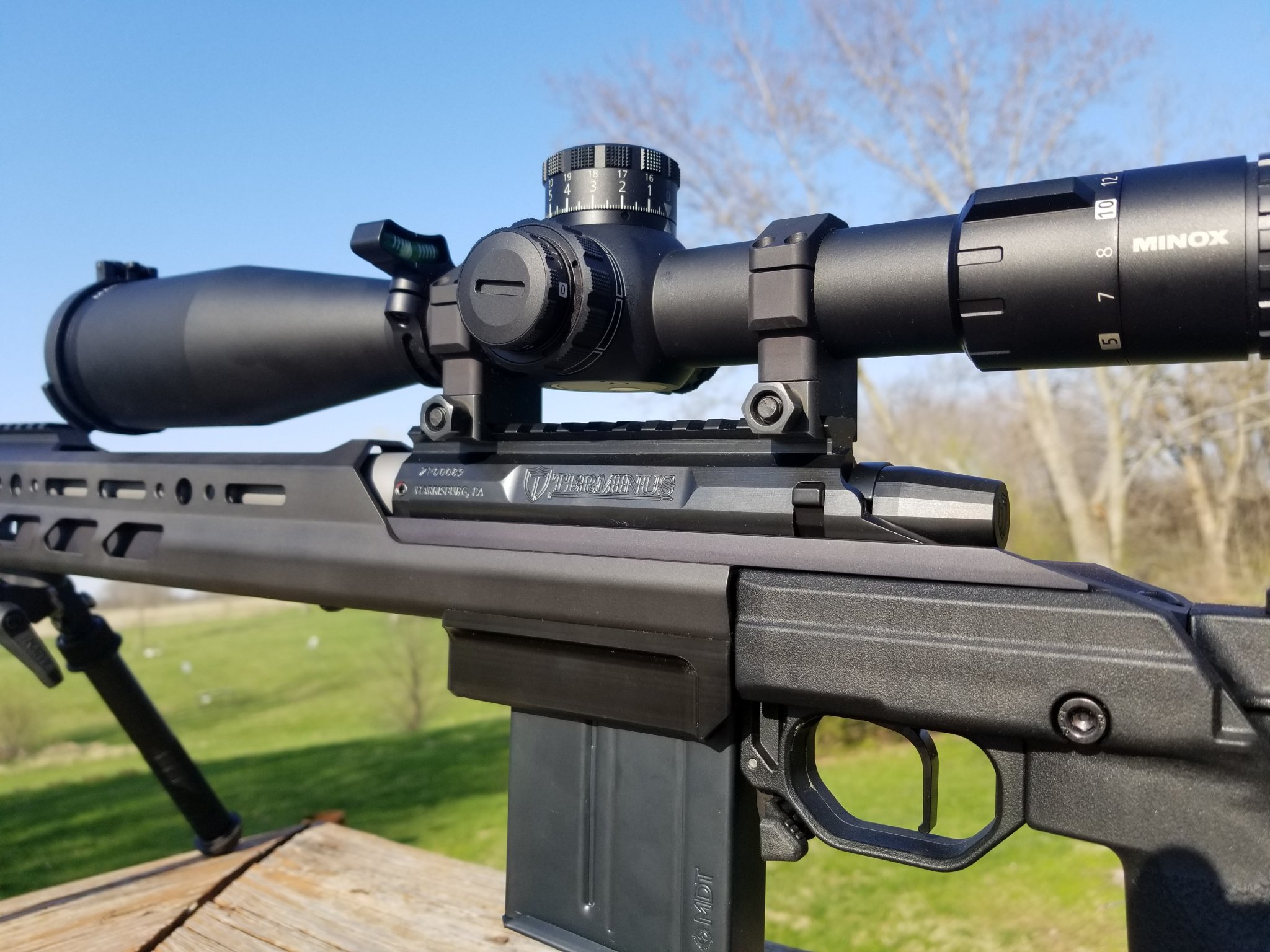

I got my rifle back from the smith. The Terminus Zeus is awesome. I love the 60* bolt. I'm running 260Ackley Improved and have experienced no feeding issues with the sharp shoulder and straight wall case. Buy with confidence. Jeff Hayes and his crew at Rivers Bend Gun Company did an amazing job on this build.

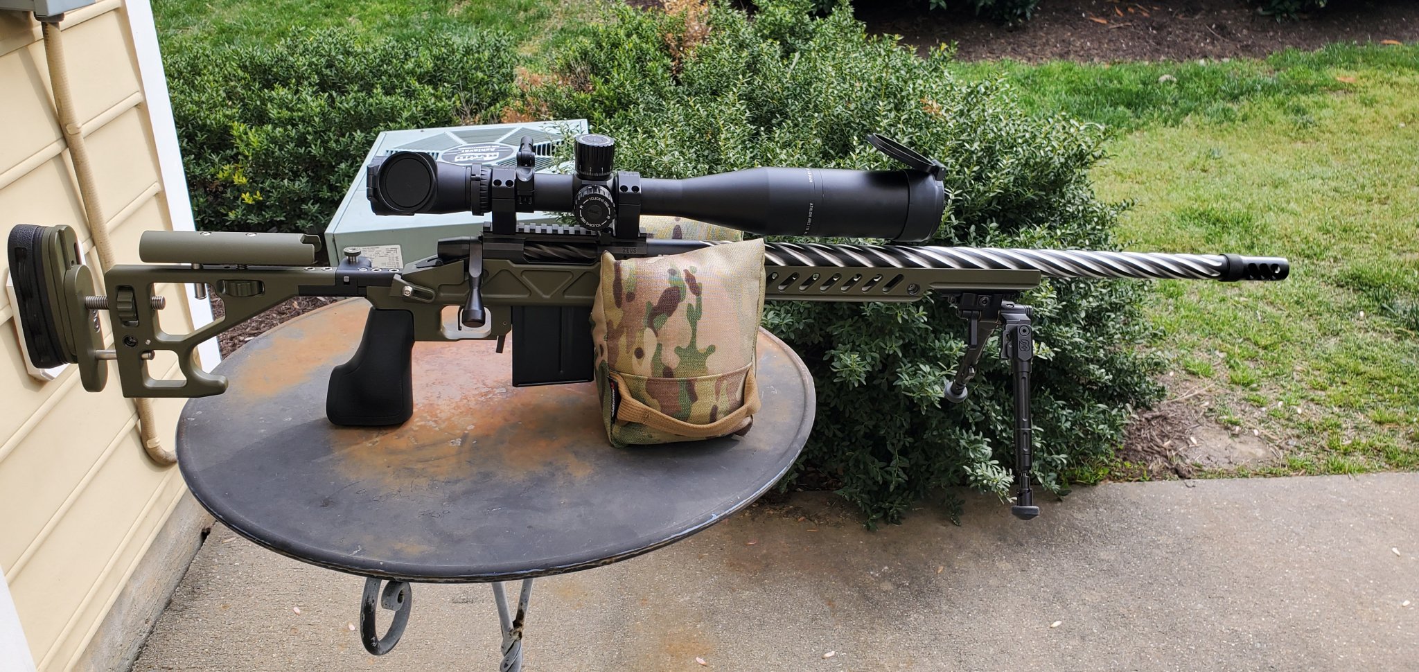

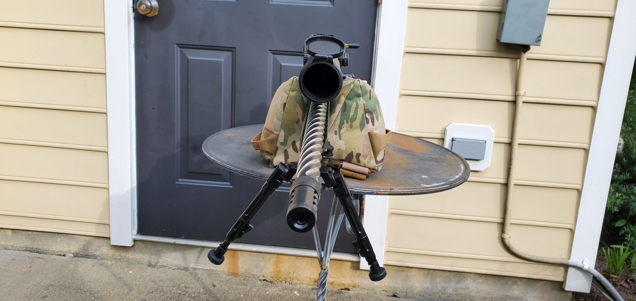

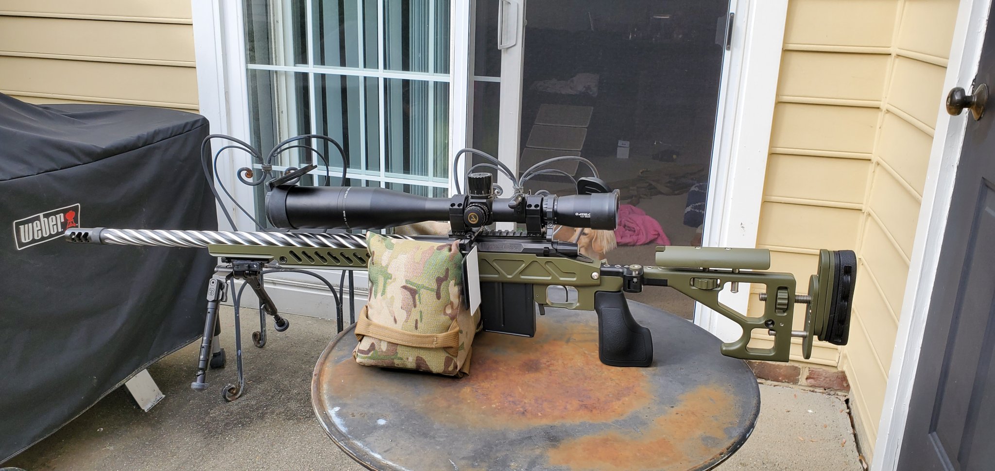

The 22BR is finished...
View attachment 7250589View attachment 7250587View attachment 7250588
Built by Brad Hiskey of Brad's Precision Rifles, Spanish Fork, Utah.
1.25 straight Bartlein 4groove 1:6.5 twist
Finished at 22" with a SilencerCo Hybrid
My TBAC 6.5 Ultra 9 should enter jail this month.
Hydrodipped by Black Ice Coatings, Spanish Fork Utah.
