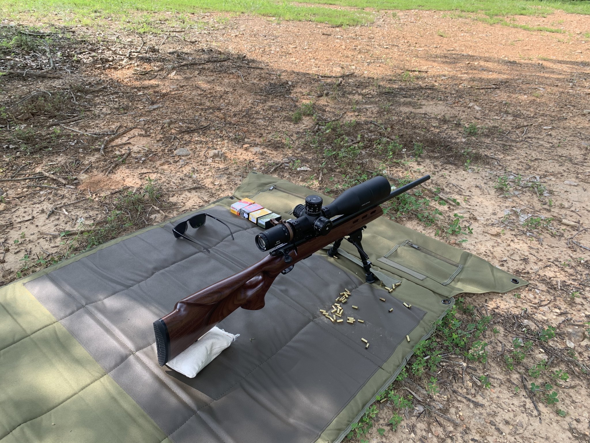

I was in the market for a new .22 and came across the the 722 Varmint online and thought it looked interesting. I’m pretty happy with the fit and finish(though I wish the barrel was threaded), and it seems to be a decent shooter.
I was planning on testing six different ammo types, but of course I forgot the CCI SV(and the chronograph).

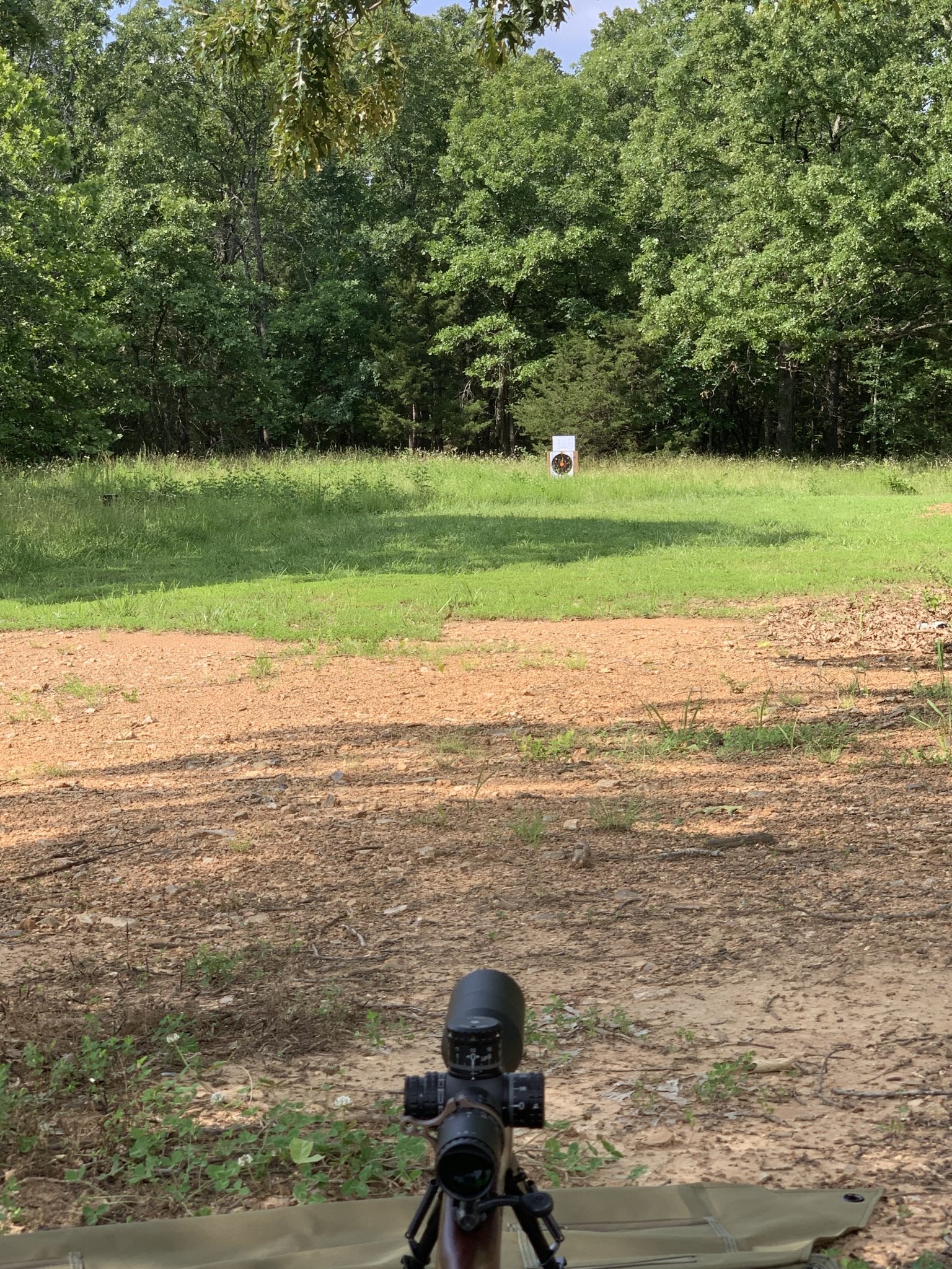

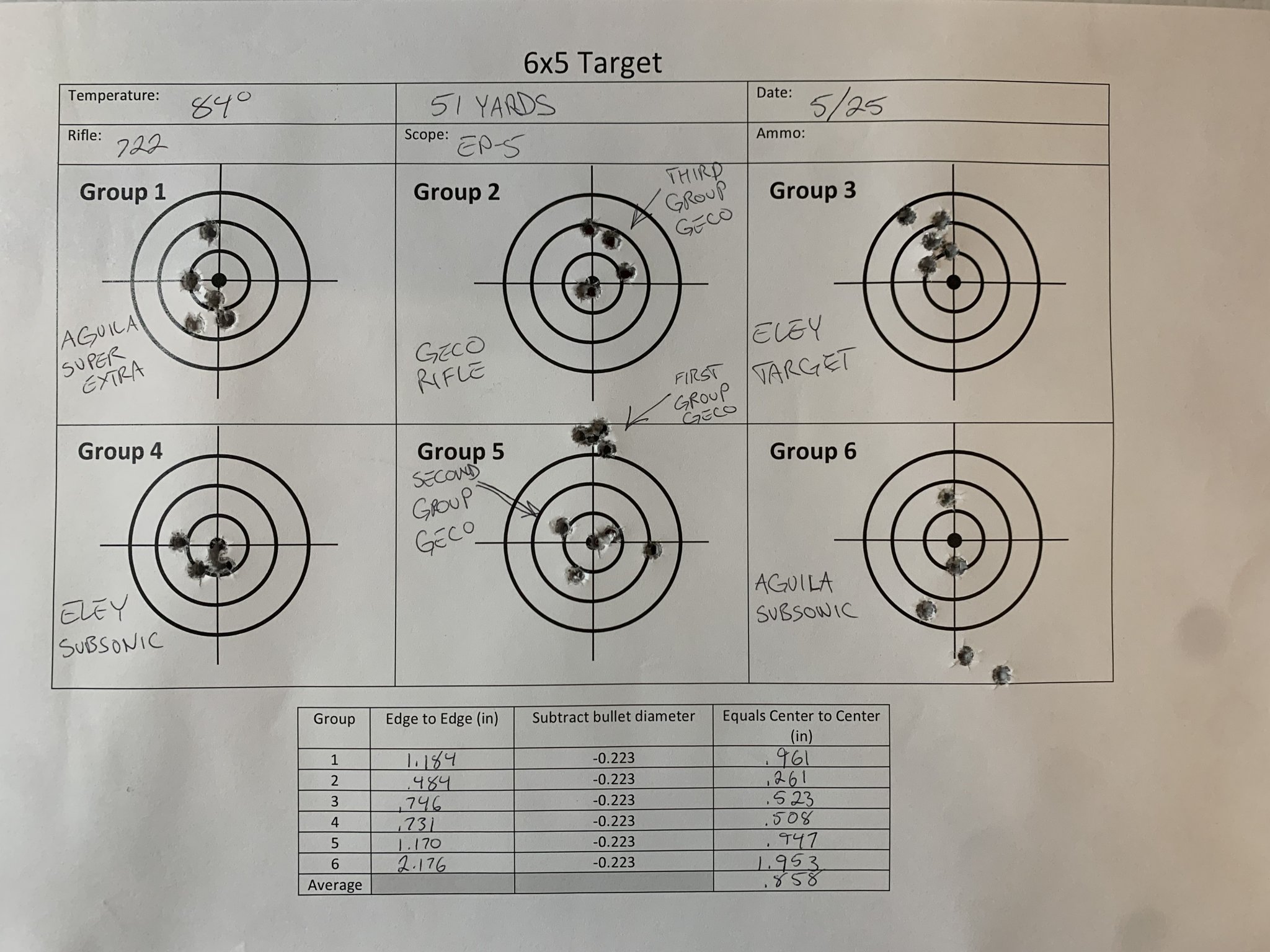

I tested the following ammo in five shot groups at 51 yards, all fed from the magazine:
Aguila Super Extra(red box)
Geco Rifle
Eley Target
Eley Subsonic
Aguila Subsonic
The rifle was sighted in with CCI SV, so I had to hold under for the Super Extra, but forgot to change back with the Geco, so the first Geco group is between targets two and five.

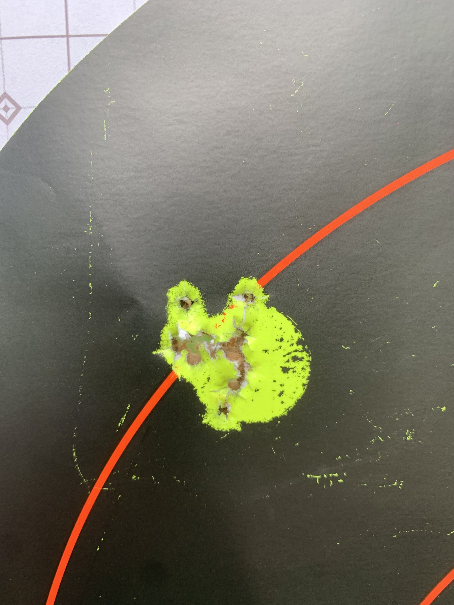

I thought I hit the lottery with the Geco, so went ahead and shot two more groups(with disappointing results). I need to pick up a few more brands for more testing and remember to grab the CCI SV.

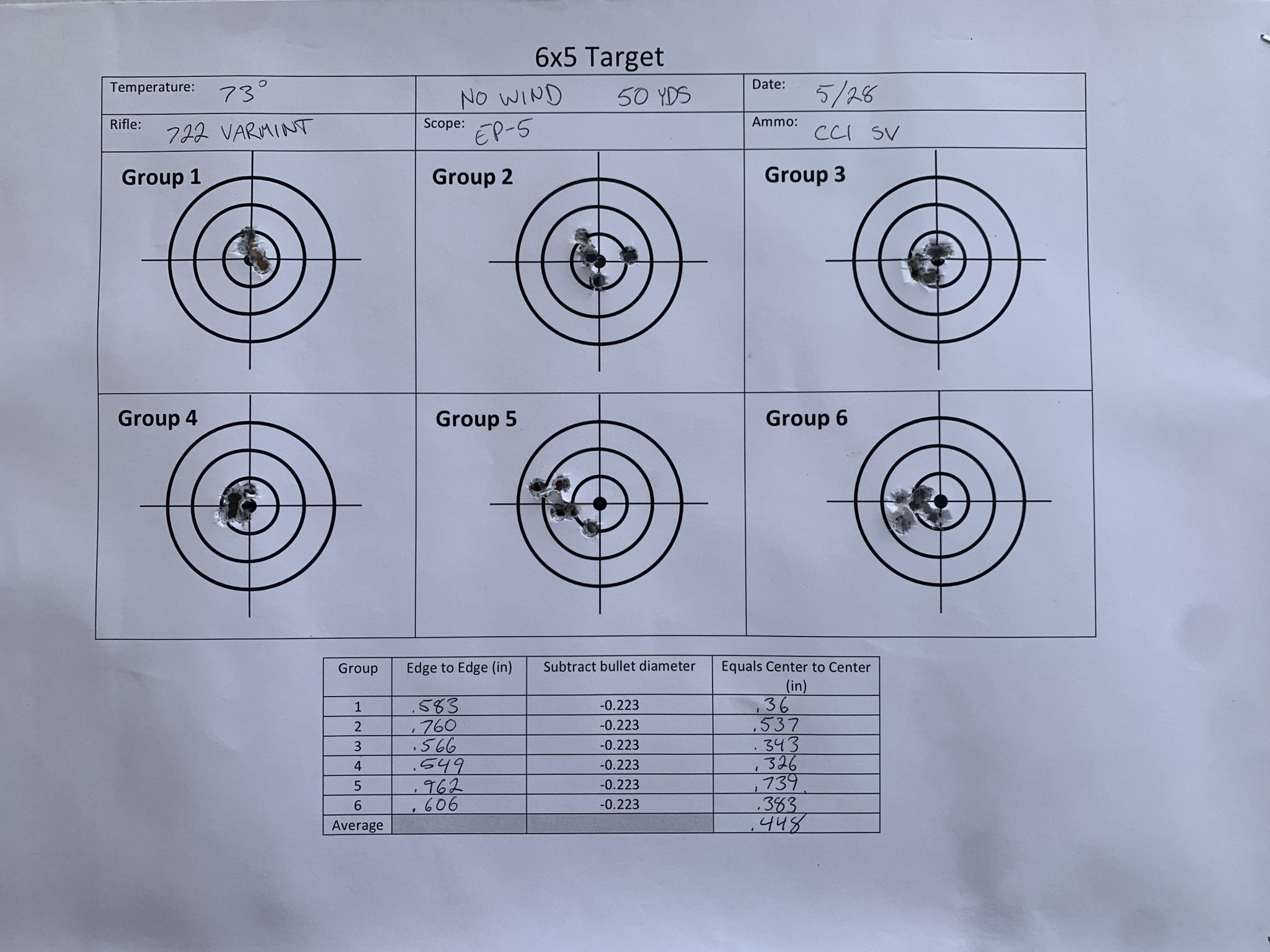

The following group is 15 rounds of CCI SV from last week:
Reactions: BowChamp and todde
I found some polyurethane runs in the barrel channel that were definitely putting pressure on the barrel. My POI shifted about two inches after sanding them out.
I was able to test out some CCI SV this morning, and was pleased with the results. Not sure what happened with the 5th and 6th groups. I shot the groups in fairly fast succession but the barrel was just barely warm to the touch. These were also fired from the magazine. Maybe @justin amateur has some insight on the POI shift?
Reactions: BowChamp
If you shot in sequence 1-2-3-4-5-6, you caught a slight right to left breeze.
1 and 2 were good for the conditions you started with.
By 3 it changed a small amount so 3 and 4 grouped left of center.
5 was the peak of the wind shift, then it dropped off a bit for 6.
Even under calm conditions, those localized thermals can push things around.
Might not show up at y'er wind flag if the thermal is in the gap between flags.
I did shoot them in that order. I didn’t really think about wind because I didn’t notice any, but that makes sense. Thanks for the observation.
