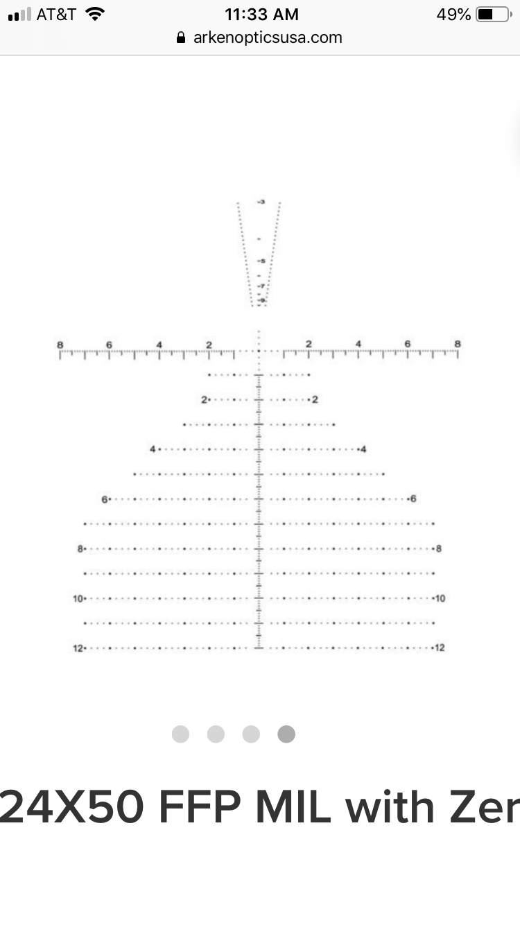

EPR Reticle
The EPR MIL reticle is a grid style reticle with a ranging tree at the top. This has more of a military style and purpose but very cool. To use this feature, you would place the feet of the target at the center point of the reticle and the top of the head would give you a range indication on the scale above the reticle. This reticle also allows ranging with shoulders inside the vertical lines on each side of the range indicators.

Reticle - 5
Very useful for those used to this style of reticle. Some may not like the crowded feeling but this style has become more mainstream, so I get it. They removed the horizontal lines near the center point to provide a better picture of the target. One suggestion would be to add a chevron, something other than the same size dot, to attract the eye to the absolute center.

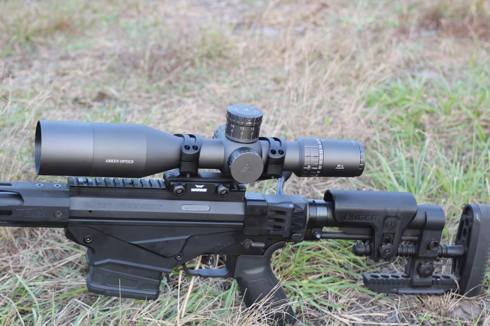

    406 is Montana -- Isn't that Rex?
    Even if they had no idea why cantilevered scope bases exist or how they mount, I would not have spit my coffee out, if it was at least at the front of the receiver. Then one could easily cover their tracks with statements like "I wanted to show the brilliant range of the eye relief" or some other nonsense & BS.

    The eye relief on the scope is no issue, it's pretty consistent
    being a 16x it's not short
    not the actual eye relief of the scope.
    its that the ocular of the scope is in the middle of the cheek piece. because the scope mount is backwards IN ADDITION to it being mounted as far back as possible on the reciever
    any credibility the author may have had is gone. yeah yeah some media person probably took the picture but why.

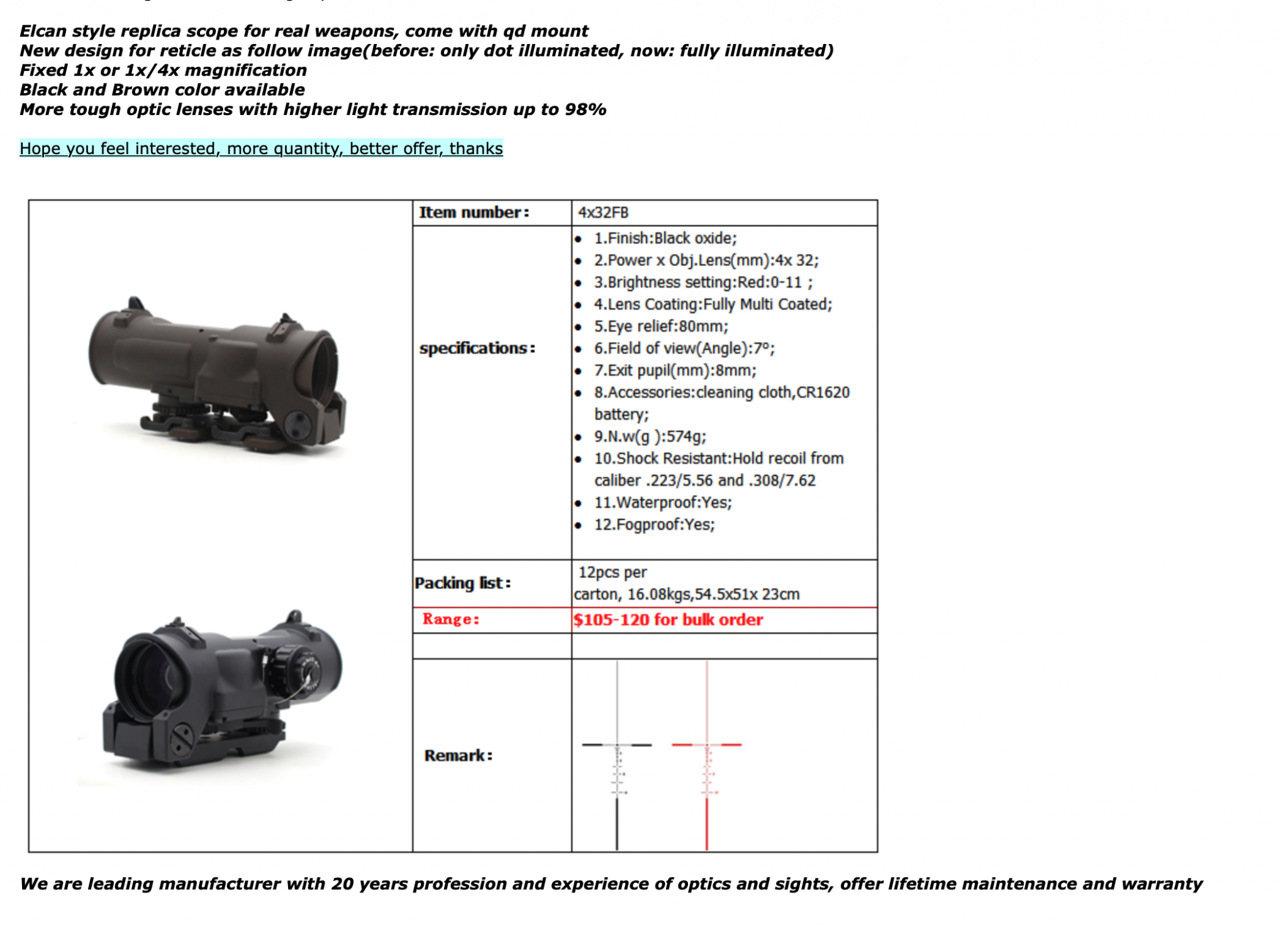

    It actually does not say where it is from, it appears to be LOW but could be a variation from somewhere else
    But it's pretty consistent with the others we see, and in fact, it's a bit more solid of an optic vs something like a Nikon Black

    His mount is on backwards,
    that part of the picture
    Warne mounts go the other way
    I had to flip the mount because the lugs were interfering with bolt. It is not a 20 MOA mount and works great as is guys. This scope really is impressive and was just trying to write a review and post it around to help promote a new option for us long range shooters.
    b6graham
    MMPRL
    Belligerents
  • Jul 29, 2014
    4,471
    3,577
    so you're saying you shot the rifle as it's pictured?
    406Reviews
    Nov 18, 2019
    9
    4
    Well then, move the scope in front o
    Oh, boy.. that explication makes this worse not better..
    moving it in front of the bolt where it is designed to be would have been the solution, even if you had it mounted backwards - so much wrong here.
