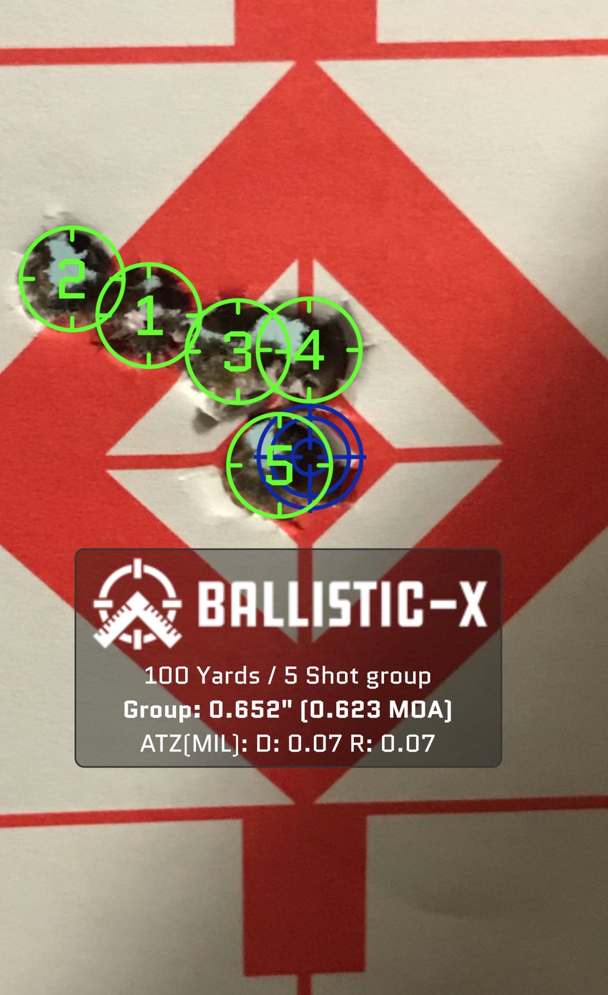

I went 4 for 4 with the CNVD-LR, first shot was at 125 and the last one was around 200.
definitely happier with the thermal

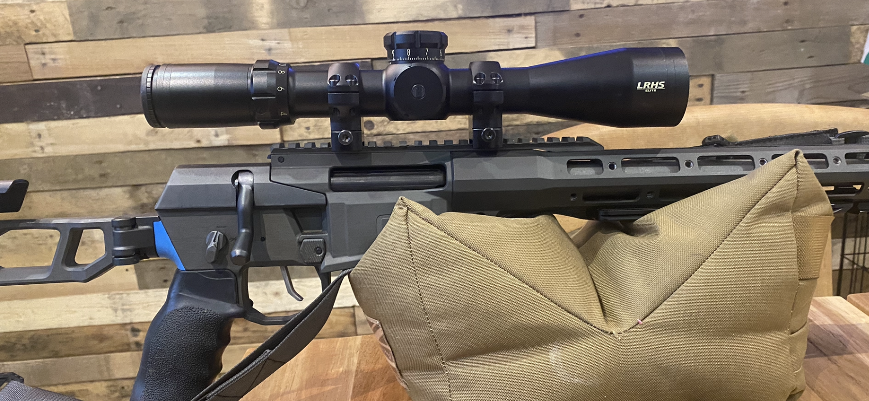

I have just sourced a Bushnell 3-12X44 LRHS. Quite rare in the U.K. and I wish I got one years ago. I am yet to compare last light capabilities but it suits the Fix down to a T.

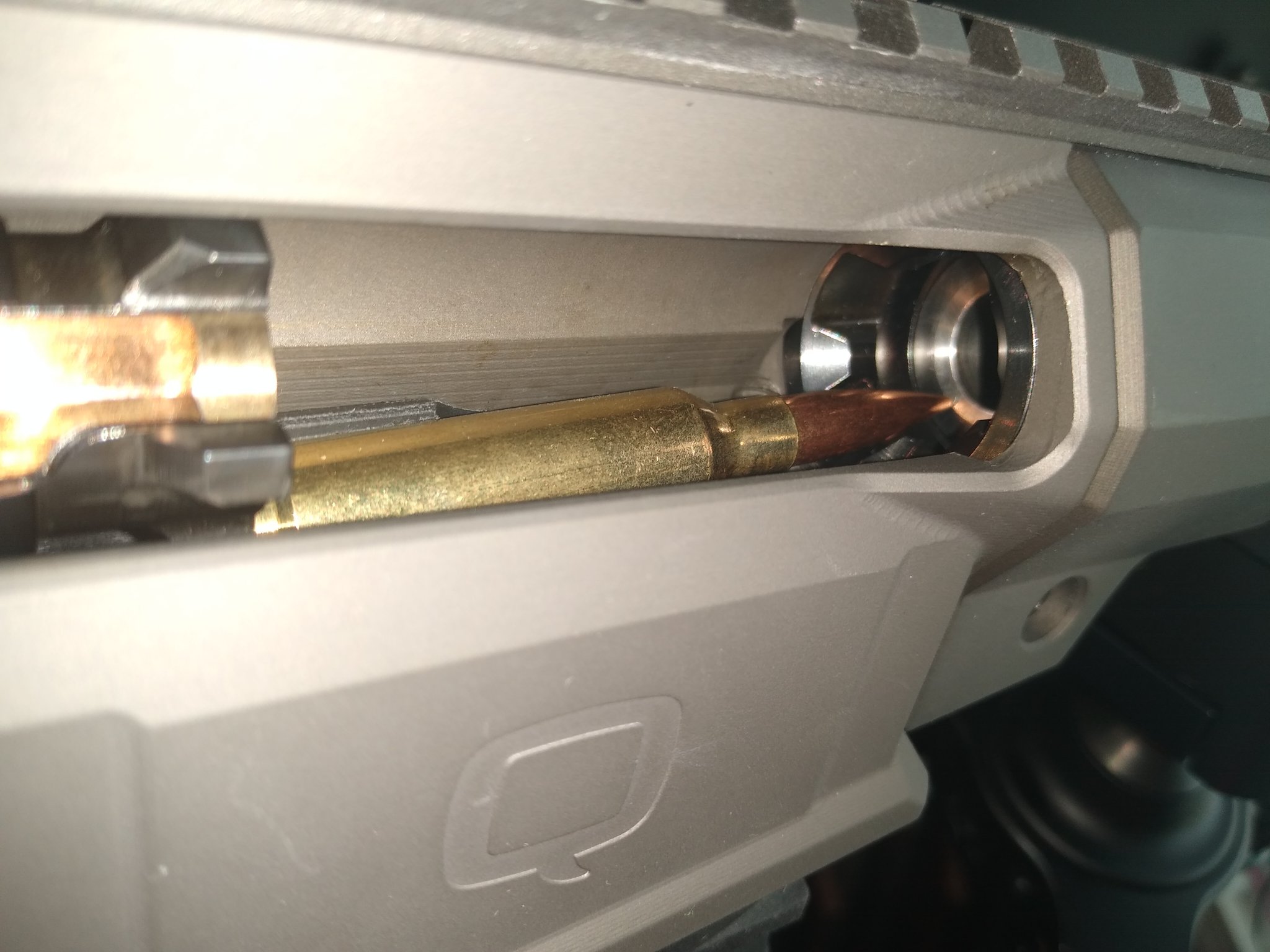

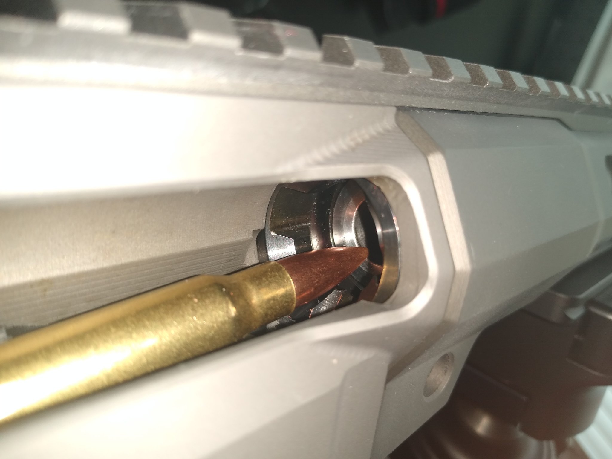

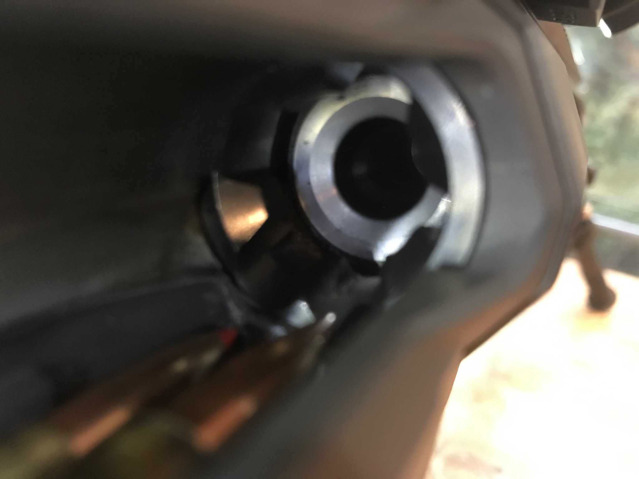

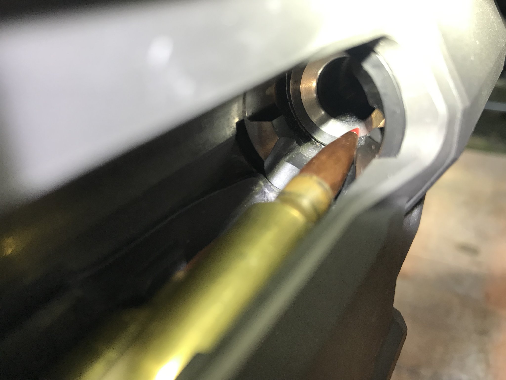

Best photos I could take of the proof bbl.
Looks like the chamfer area might actually be larger than the factory barrel.
So guessing they must really be depending on that chamfer to facilitate feeding...
Still seems like a bad idea to depend so much on the tip of bullet for feeding though.

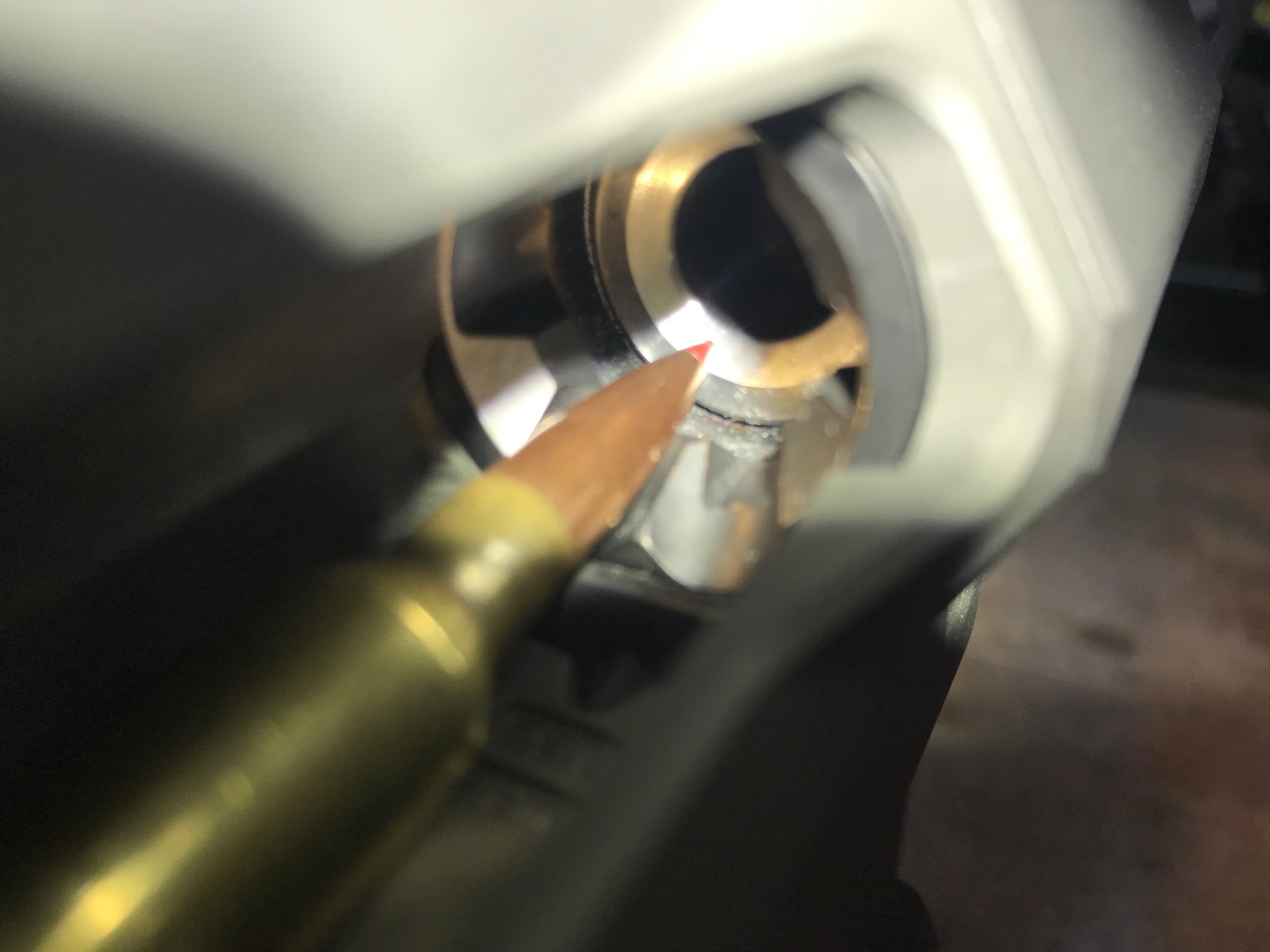

Thanks for the picture. If you happen to be out again push a round forward until it starts to contact the chamfer and snap a pic. Or see if perhaps yours doesn't contact the chamfer...

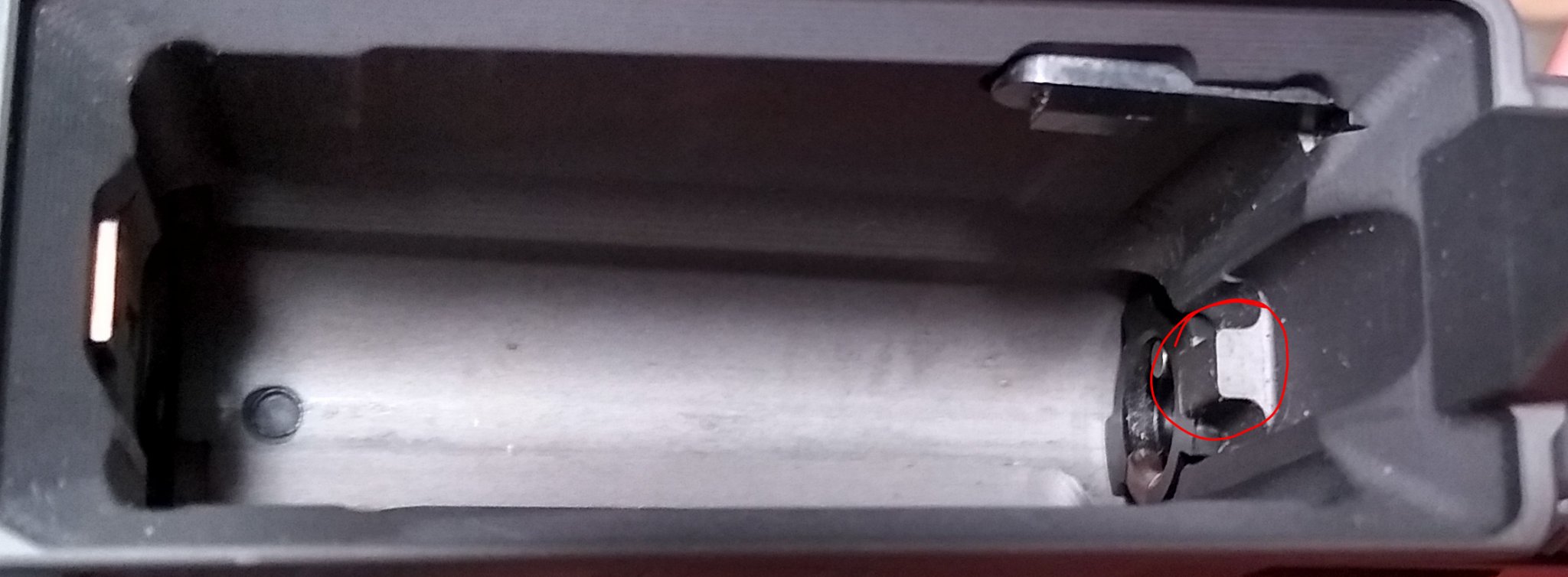

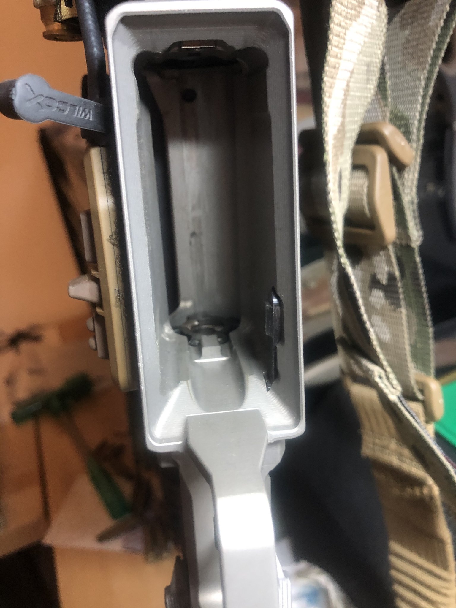

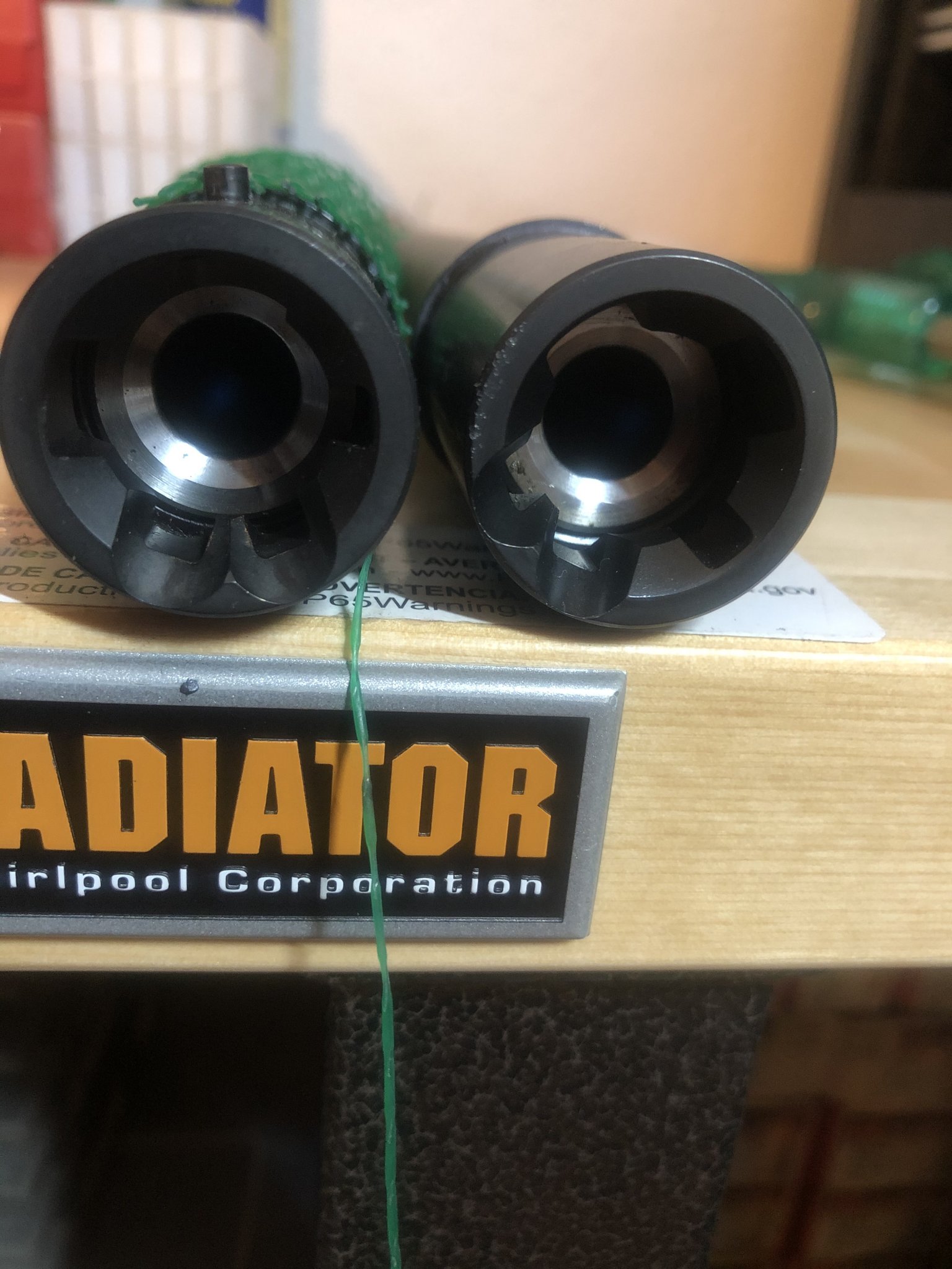

This is a proof 6.5, Bartlein 308 and bartlein 6.5 installed. The little bump at the back of the magwell is what I think is different from the original receiver but I could be wrong.

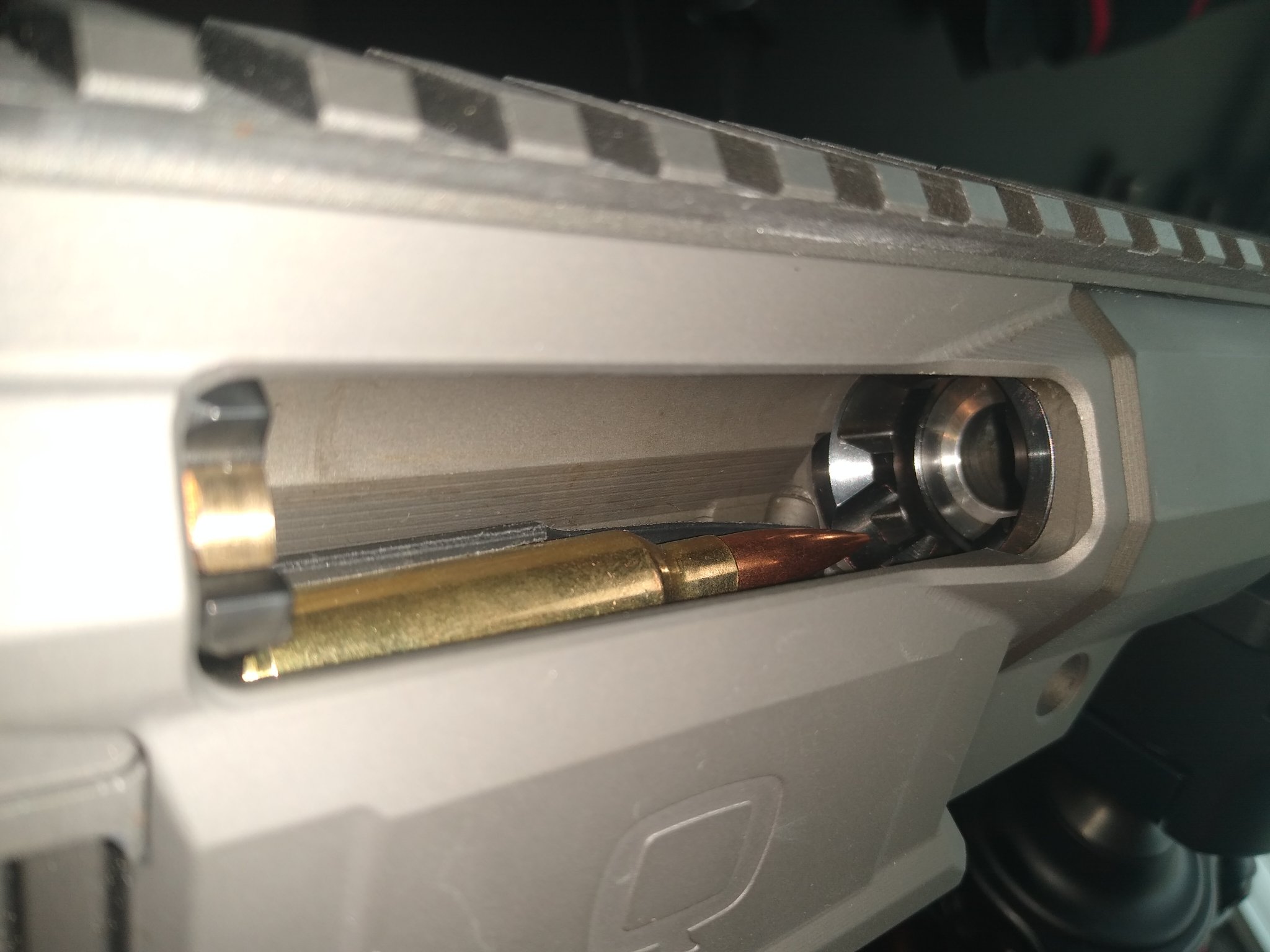

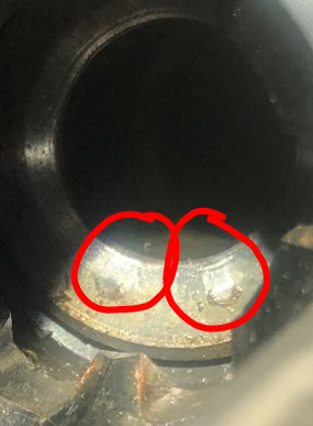

This pic is of a working rifle correct?
Observation of your pic makes me think the problem isn't really resolved...
Just running the ragged edge of function with the smaller calibers
I'm willing to guess these two smears are where the bullet point is hitting that flat face / chamfer edge when you are running 6.5
I'll do some experiments, but I wonder even when we are getting this thing to chamber if we are pushing our bullets back into the brass in the process
That’s exactly what those marks are but I don’t remember if I ever cleaned it up. I plan on taking it to a class in December and just pulled the proof barrel a few weeks ago. Feeding is night and day better since the receiver swap. It gets almost an exclusive diet of 143 eldx at 2.85” oal
I didn’t have any problems with the q 6.5 that I recall and the proof hasn’t had so much as a hiccup. I handload hornady 140eld-m’s because that’s what I had and it likes them. The picture is not its best group but it’s most recent, after a light cleaning and before I took it to a long range challenge match as my main rifle for that task is being re-barreled.
Ok, so for the time being I am assuming this means my receiver is a "corrected" unit... Circled what I think you are talking about with the bump?.

Mind testing a theory for me? Put a round in and push it up slowly and see where the point presents at the barrel? I have factory Hornady match with 140 edlm and it will hit right at the chamfer transition. As long as I run it fast enough I can get it in the chamber, but it's not feeding correctly to get it in there.

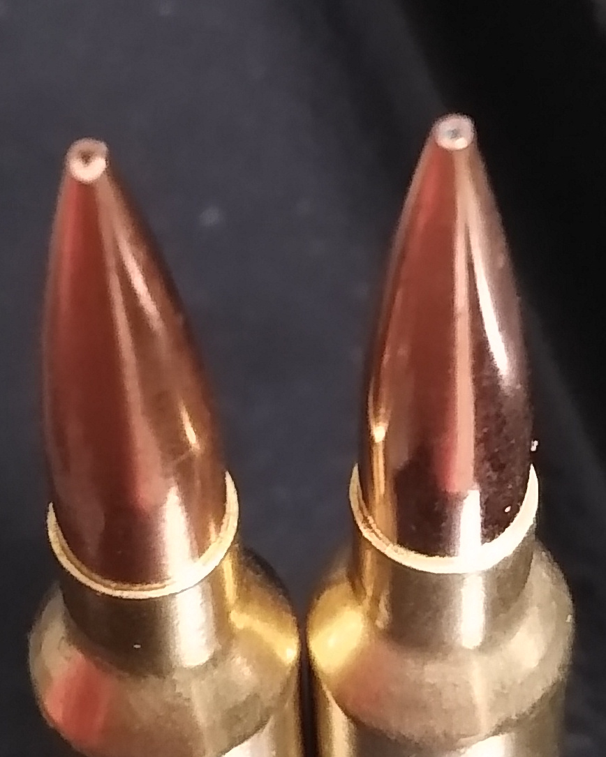

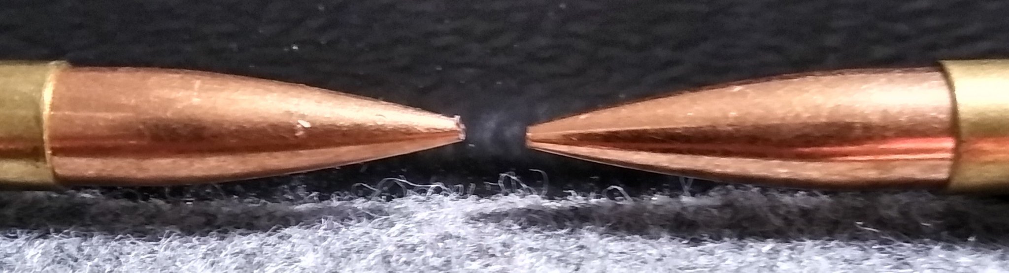

So to my experiment I said I would try...

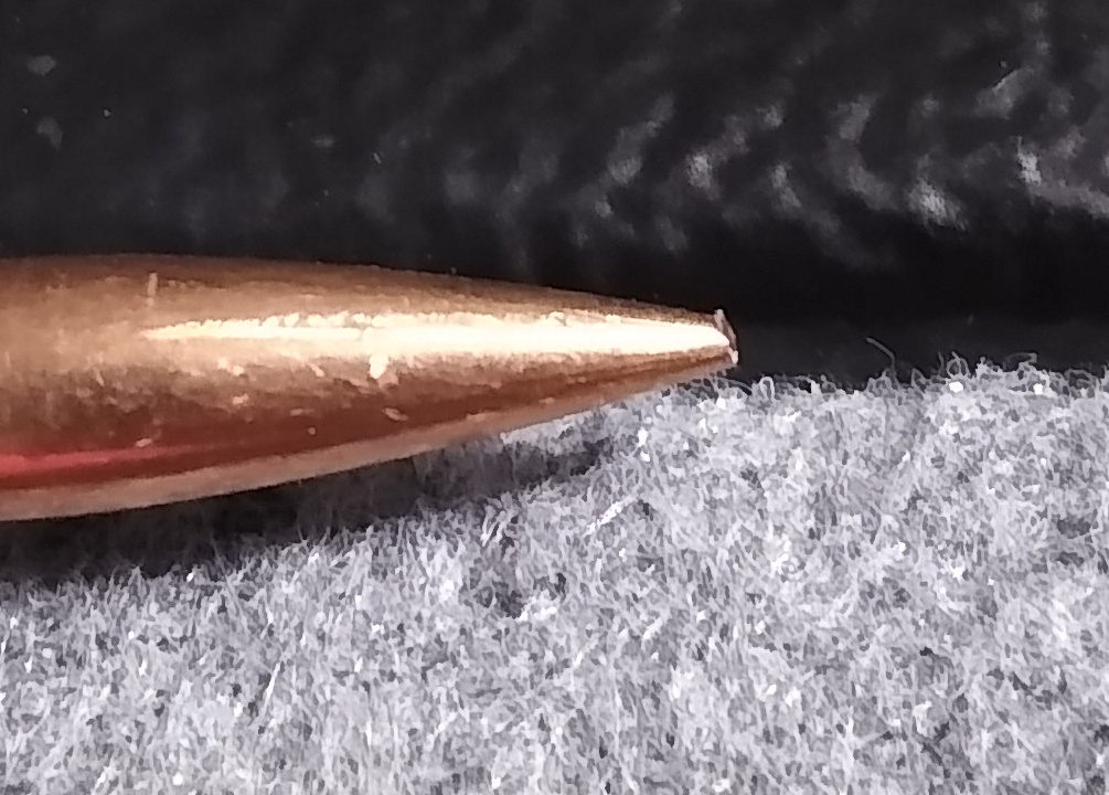

Took three factory Hornady match 147 ELDM rounds and checked length with calipers, and runout with Sinclair concentricity gauge.
Loaded them into the mag, and fed them quickly through the rifle. (As long as I run it fast enough I can get them in there)
I was expecting that the bullet might get pushed back into the brass, but not so... Now what it did do was knock about .003-.004 runout into each round.
may do an experiment with a dummy round and light next tension as well this weekend
With the Hornady poly tips you can't really see how much it's getting hit, but ran a few federal gold metal 130 bergers through and ejected them the same way to find some angled tips. (Did best I could to focus my camera on it, but it's a pretty good little angle and burr off the tip)
Bullet on left has been chambered and ejected. Right just for comparison
So I'm still not seeing how this rifle could possibly do a proper job of feeding most any high bc 6.5 rounds from the mag...
At this point I'm leaning towards this just being the rifles design flaw vs an individual sample issue...
I'm guessing the answer has become to just run it fast enough to get it in the chamber...
Can anyone slowly feed a high bc 6.5 into their chamber without hitting the chamfer head on?
The proof has a bit larger of a chamfered area. The eldm hits comfortably inside and I’ve had no issues with it. Haven’t tried any other bullets in it as I’ve found a load that works. I’ll try and get some Berger’s loaded up and see what happens. It’ll be awhile though.
Thanks, and just to make sure I'm understanding your pic and statement...
It's comfortably hitting inside the chamfer area? Not hitting inside the chamber....
No worries. If you are hitting the chamfer you are in the same boat I'm in. I've been getting the impression that there was a fix for the fix that actually made them feed properly into the chamber... Hitting that chamfer to get nosed over into the chamber is the saddest example of feeding I believe I've ever seen on a rifle... This thing is basically going into the 308 only category for me from now on....
Guess I should visit less vld / hybrid designs to see if anything actually feeds into the chamber before I swear it off though
Just wish I hadn't gotten two 6.5 barrels before I found this out lol
Perhaps 7mm is large enough to ride the cut out for the bolt higher like the 308 does and actually feed into the chamber...
338 federal may actually feed even better still lol
I don’t know how to explain it anymore than the pictures. Sorry, the tip of the bullet rides past the feed ramp contacts halfway up the chamfered area and then goes into the chamber in one smooth push of the bolt handle. I’m surprised q hasn’t gotten back to you yet. They’ve been good the few times I’ve needed them.
You explained it fine, but since I was expecting that to be the case I wanted to make sure I didn't just read what I expected vs what you were saying... Hope that makes sense..

I ended up pulling out my ar10 308 and compared the feeding from the mag by slowly allowing a 308 to move forward and it rides the bolt cut out the same way and lines up with the chamber. Tried slowly allowing a few 6.5 options to ride up the feed ramp and it does EXACTLY the same thing as the fix by hitting the tip on the chamfer vs in the chamber. This was part of the reason I never liked my 6.5 gas gun either because it tore up bullet tips instead of actually feeding into the chamber.
Basically we will just have to accept that this is how this rifle feeds... The same way we end up saying it's just an AR and that's why it dings up rounds.... It's just much more obvious when you've had bolt guns that feed correctly into the chamber then this thing needs to bounce off a chamfer in order to get the bullet into the chamber. Likely made more obvious by the fact I started in 308 which actually feeds into the chamber due to the larger bullet riding the ramp / bolt cutout higher.
Maybe I'll find someone who wants a 6.5 instead of 308, or maybe I'll find less of a vld / hybrid design that will actually get the tip to present into the chamber instead of hitting the chamfer.
Either way this rifle is a sad example of feeding in a smaller caliber, but... I do now understand how they ended up where they are. I also understand that if I go to an aftermarket barrel I could increase the chamfer but I still call that crap feeding if it needs to bounce off a chamfer... At some point you'd loose case support if you angled the chamfer in deeper to allow less of an angle to bounce off of...

You can likely see what I'm referring to using your 308 barrel and putting a 6.5 in the mag and pushing it fwd to see how it interacts with the chamber / chamfer area. I think most of us are just hitting the chamfer hard enough to get it into the chamber...
I don't call that proper feeding in a bolt gun though...
