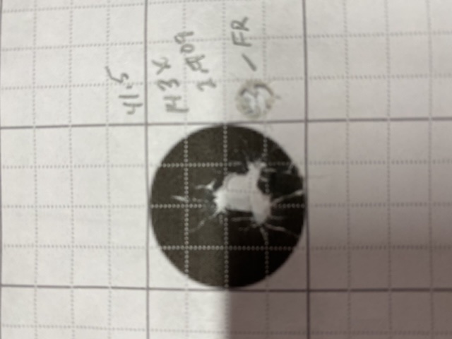

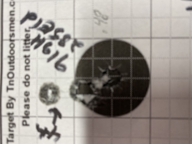

Hi,

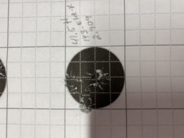

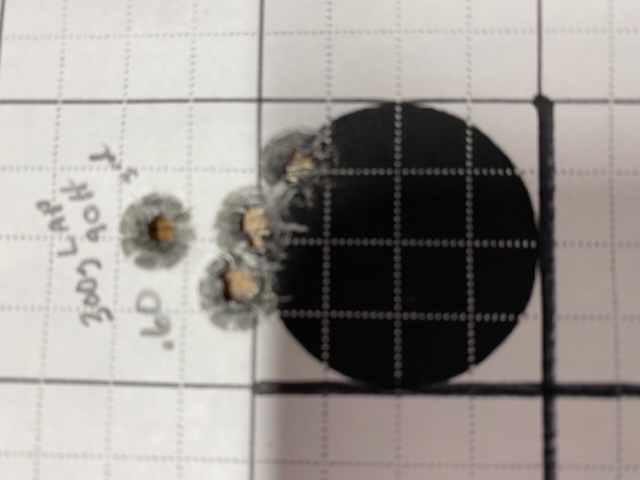

New MRAD owner here. I started out with a 24” 338LM barrel, then added a 24” 6.5CM barrel, then added a 26” 338LM barrel, which I like best.
ATAC on top, AAC Titan QD suppressor.
Not much load data floating around out there, so I started with the load my previous long range rifle used (Barrett 98B), 300g Lapua Scenar over 90 grains of H1000, Lapua brass, seated to the lands. After adjusting the rounds to the lands on the MRAD, 3.650 OAL, I have found it shoots about .6“ fairly consistently at 100 yards, for 5 rds.

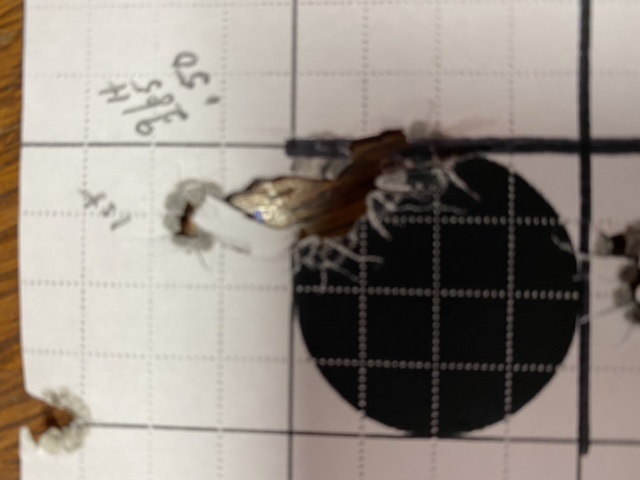

I also tried 285 ELDs over 91g of H1000, set to 3.750 oal, and turned out about the same. I await some decent weather to head out for longer range performance. I have to work on my form, I always seem to throw a flyer in the mix.
Next was 250g Lapua Scenar over 92g of H1000, set at 3.605, these shot the tightest of all.

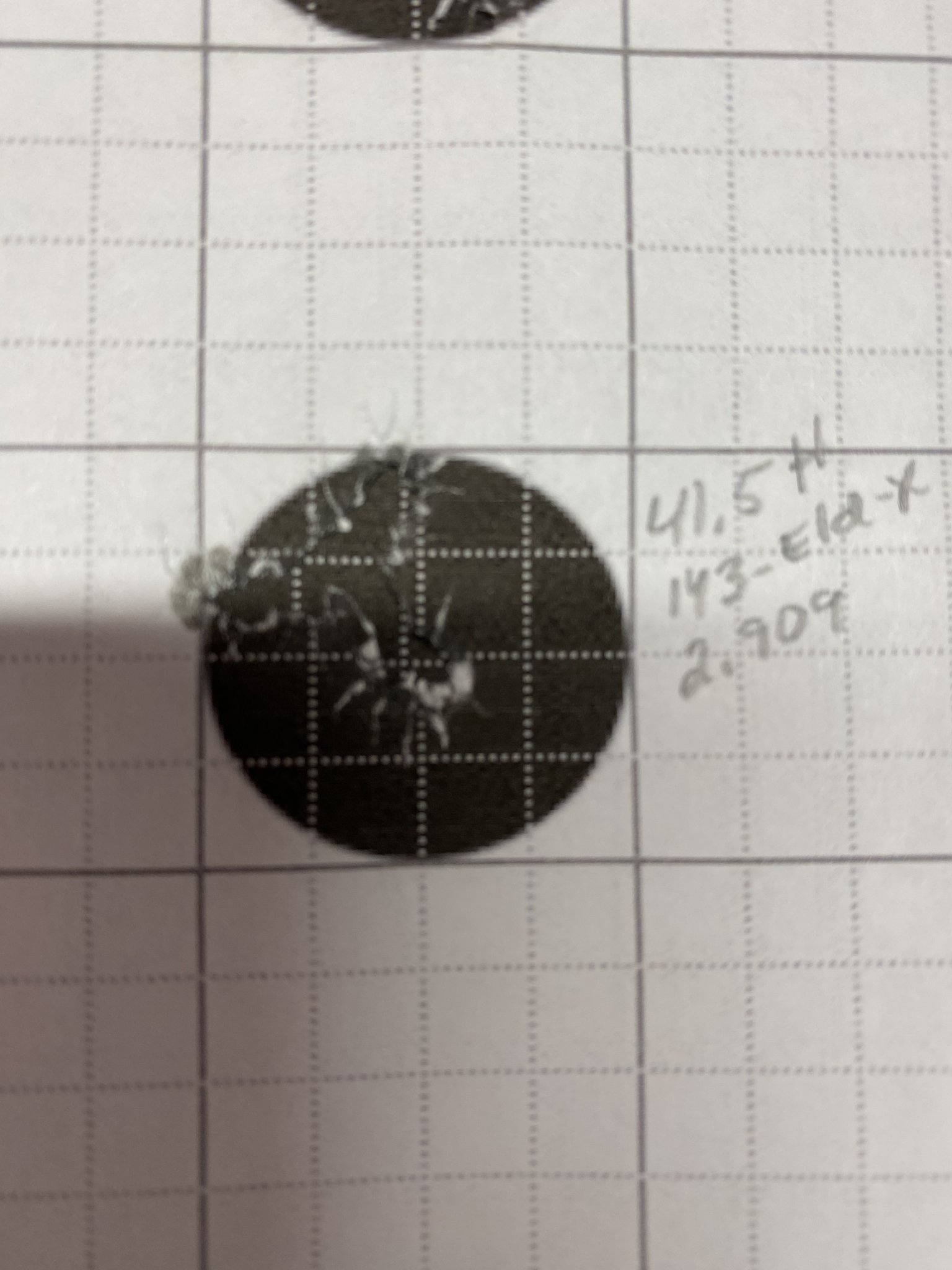

The 6.5 CM ended up with 41.5g under a Hornady 143g ELD in a Lapua SP case, set at the lands, 2.909 oal. This shoots under .4” at 100 yards.
Love the rifle, I look forward to shooting it at distance.

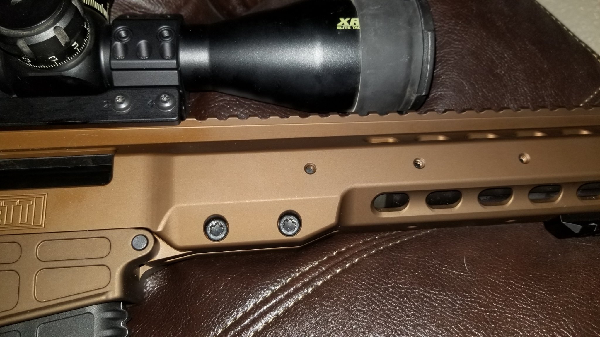

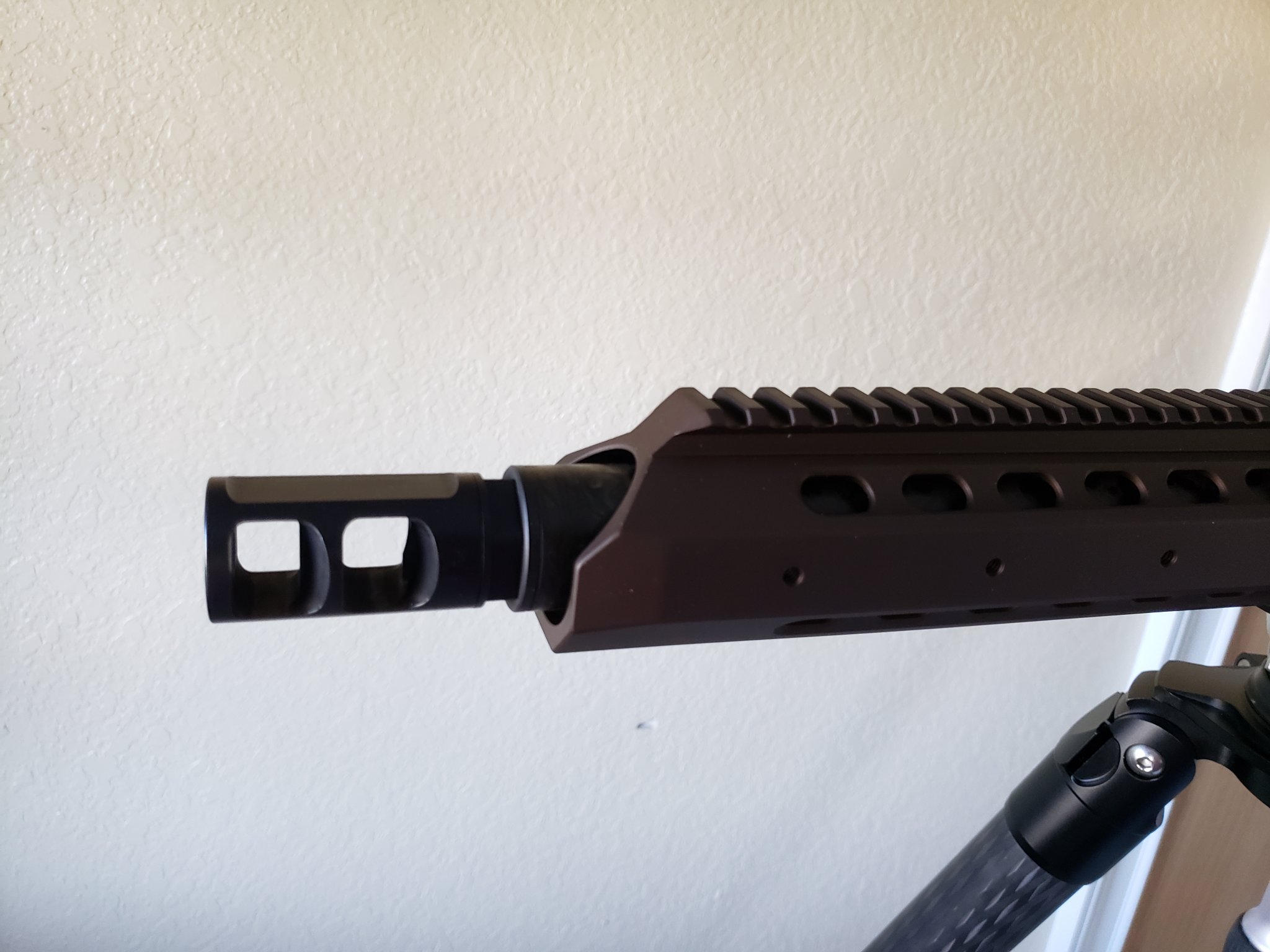

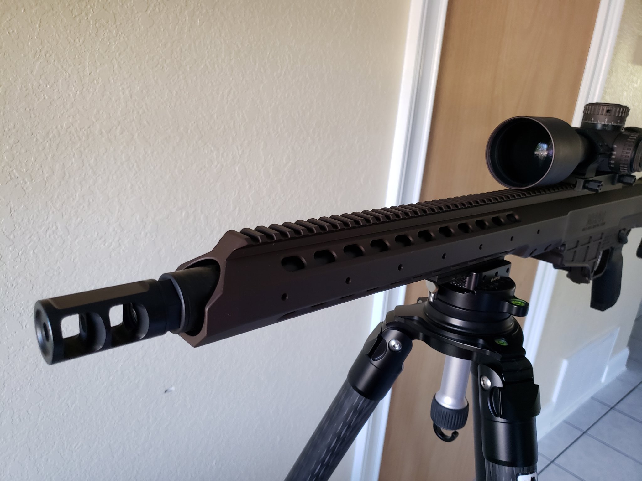

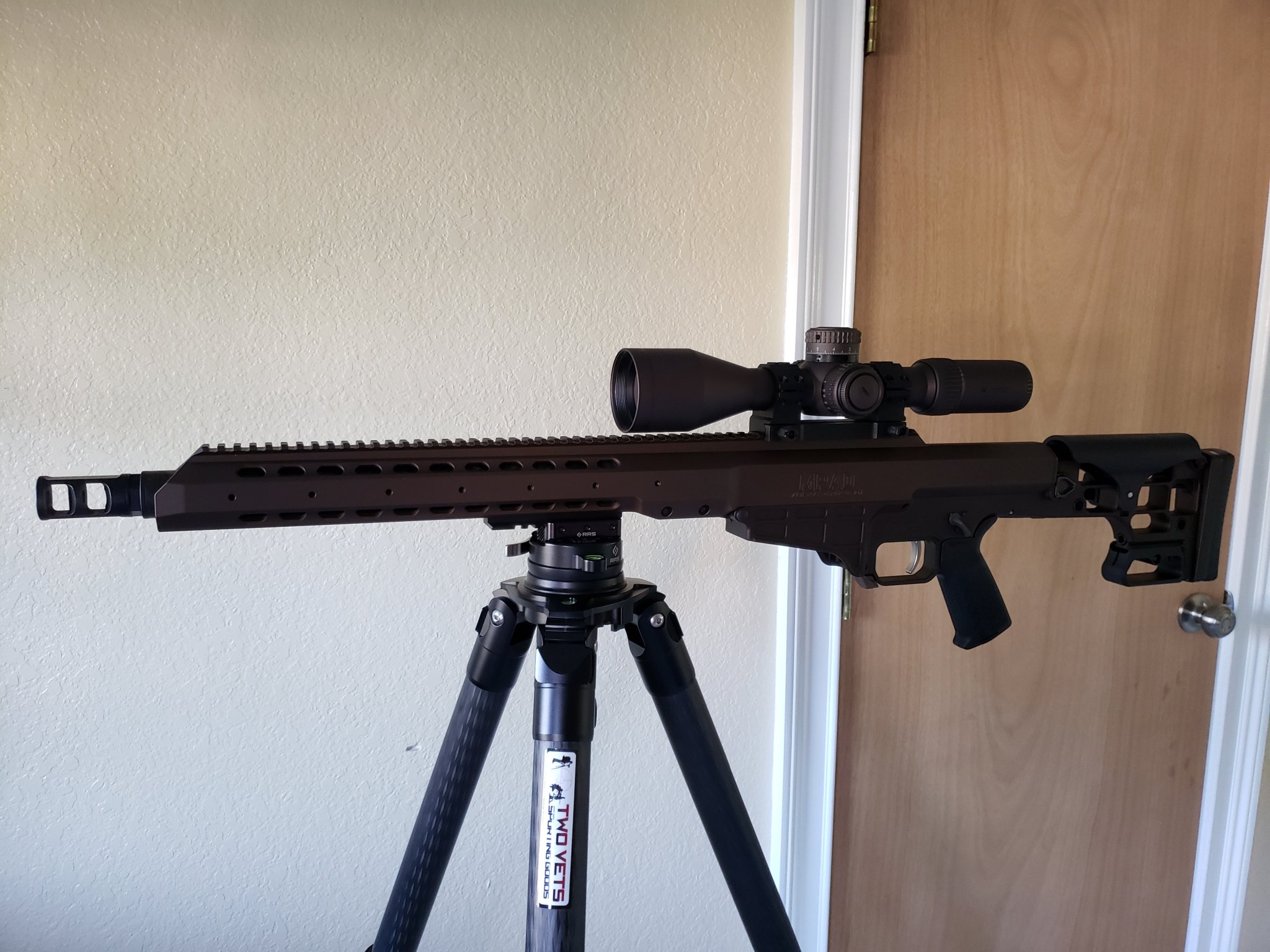

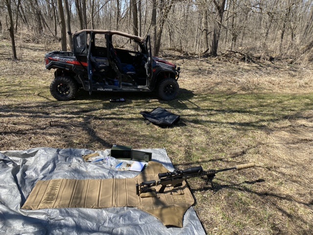

Finishing it up before I take it out this weekend. Should I take the Barrett brake off and install the Area 419 brake I have? Is the Barrett brake more effective than the Area 419?

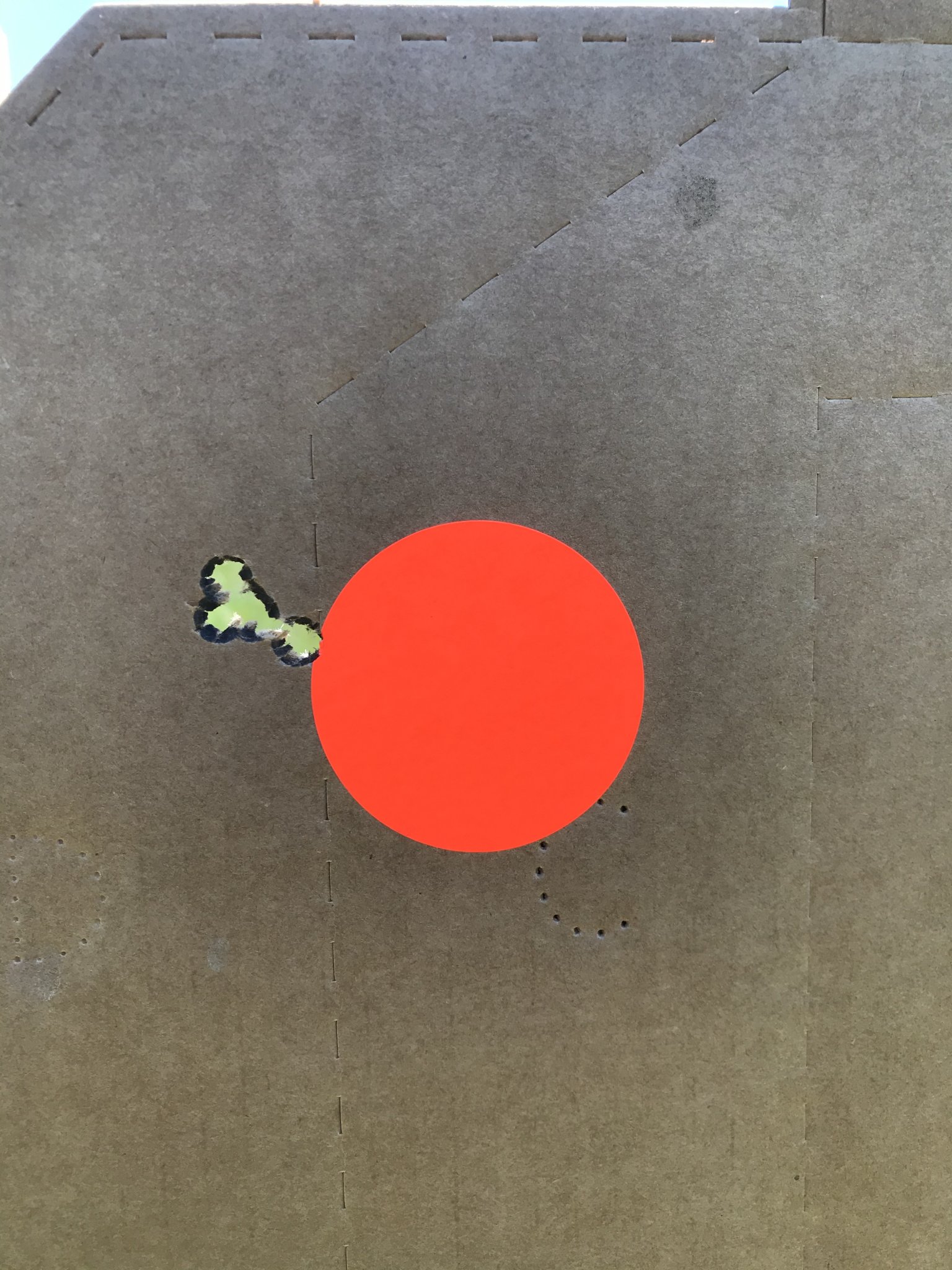

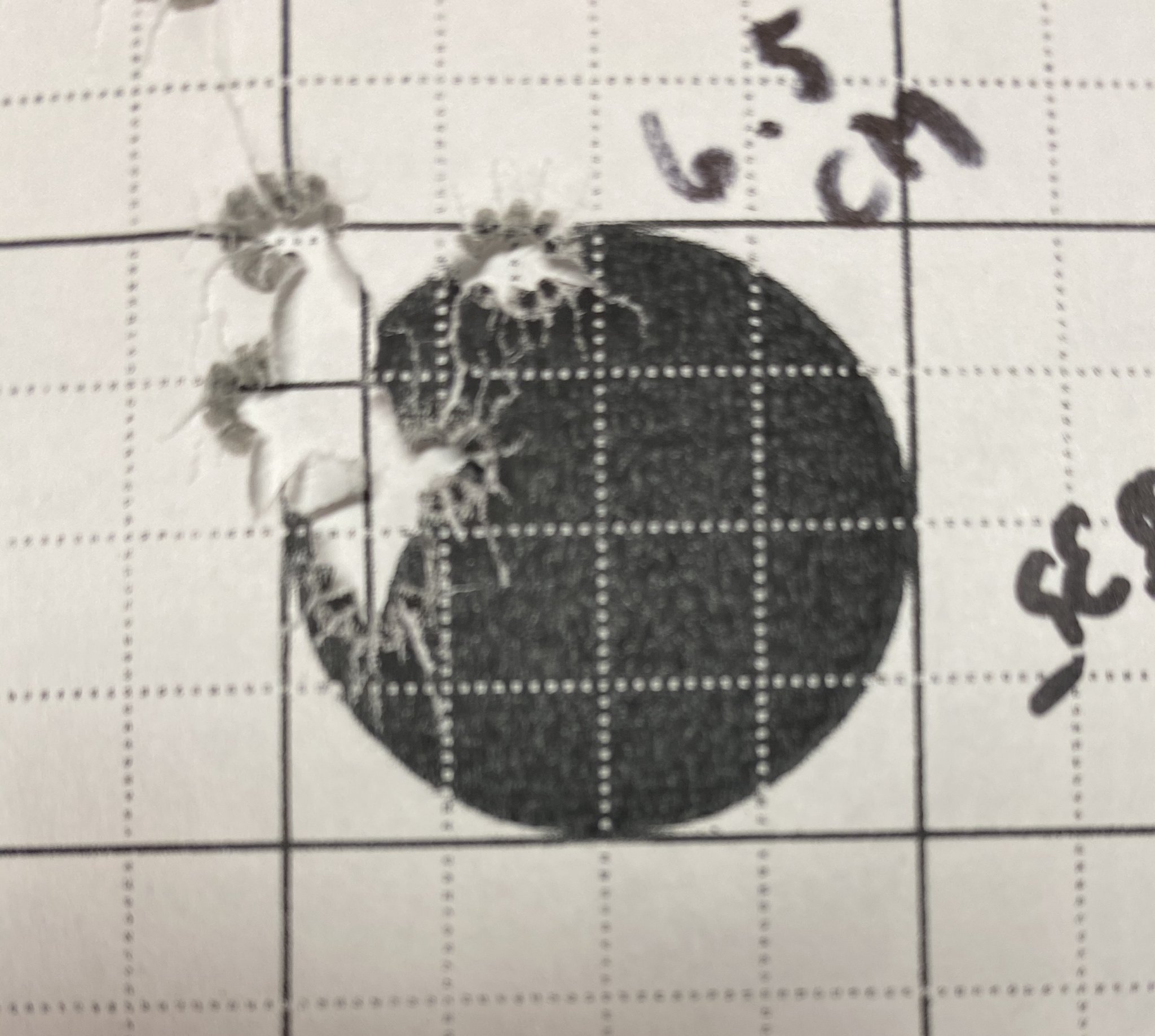

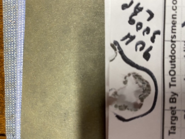

Wanting to document the return to zero capability, I zero’d the 24” 6.5 CM barrel, removed and installed the 338LM barrel, zero’d it, and reinstalled the 6.5 barrel a week later. Using the recommended procedure of switching barrels in the vertical position, return to zero was about .25 moa to the left. Group was a relatively hurried shoot, I was load testing another rifle. These are 5 round groups. I believe this is within my own abilities of controlling my own errors in my holding/executing fundamentals.

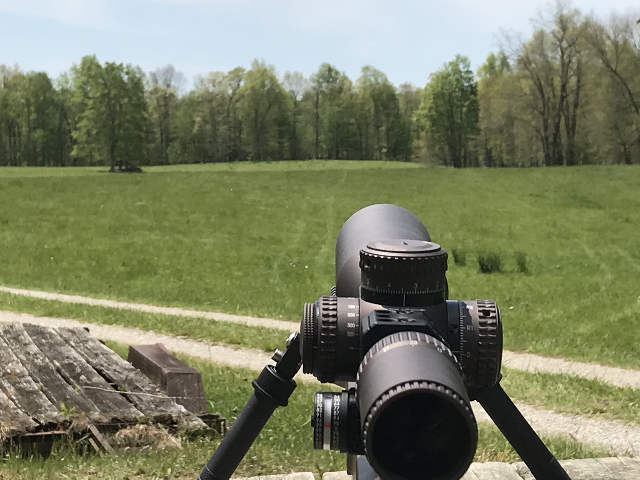

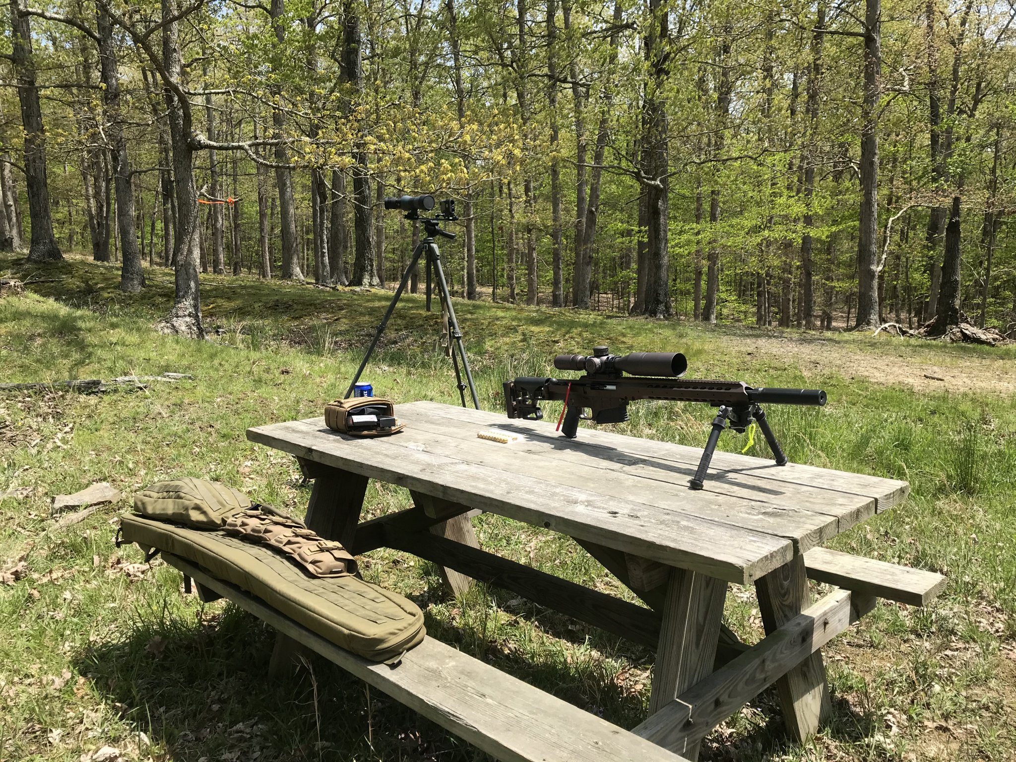

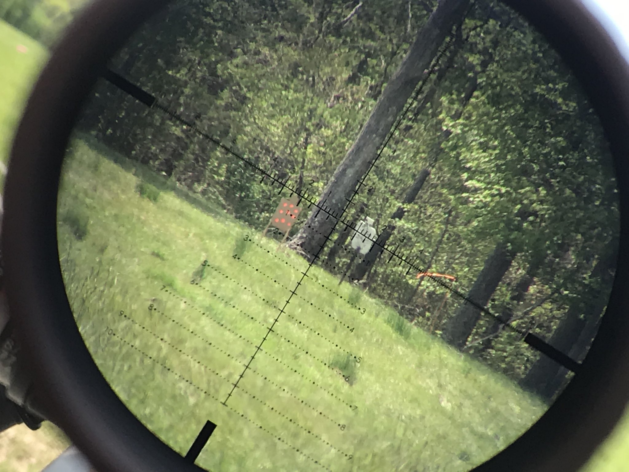

I got a deal on a vortex razor 4.5-27, i’d been saving for a ATACR to put in my scope less MRAD. I do not regret it at all this is every bit as good as the NXS I had really it’s better, though I don’t know if i’d prefer a 7-35.

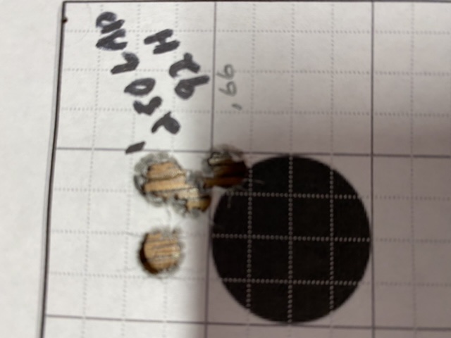

Anyway, I finally got to shoot thai thing, during my wait i’d purchased a 22” 300WM and 17” heavy 308 barrel to go with it. I’ve started with .308 because I have the ammo, it’s easy to move around, it’s cheaper to shoot and I need the practice.
Did a rough zero at 100 yards with M80. The next day I shot 5 rounds of about 5 different boxes of ammo. The M80 sucks (147grn), this thing loves 75grn Federal Gold Medal
Match, I also shot Hornady 75grn ELD-X which groups pretty well but all 5 ahota of FGMM were touching with 3 practically in one hole.
Since then i’ve switched my range finder to meters, it’s an mil scope; the furthest I can get in my property without building a stand is 588 meters. I can make first shot hits on steel ipsc and soda cans at that range. My wind averages 2-4mph on a normal day and it’s consistently from one direction, or theirs no wind at all.
I’ve shot it weak handed and made hits, I put in 5 rounds and had 5 friends shoot it 200m and they all hit a 6” plate. It’s a laser, I can’t wait to work it out further and switch over to 338. I found a place I can get a 1.1 mile ahor but I need to get the land owner to allow me to set up a target.
It’s heavy but I love this rifle, I have a TMR’d 12-40 mk4 on the way to replace my athlon ares, it’s a nice scope, but I want to be able to have spotter call corrections without guessing.
I’m running an atlas 5H and a squeeze bag with bag rider, and all shots have been with a sandman-S. Down the road I may try and get a thunder beast so I can have as much fun with the 338. The .308 seems quieter than a suppressed 5.56 which makes plinking steel a joy.

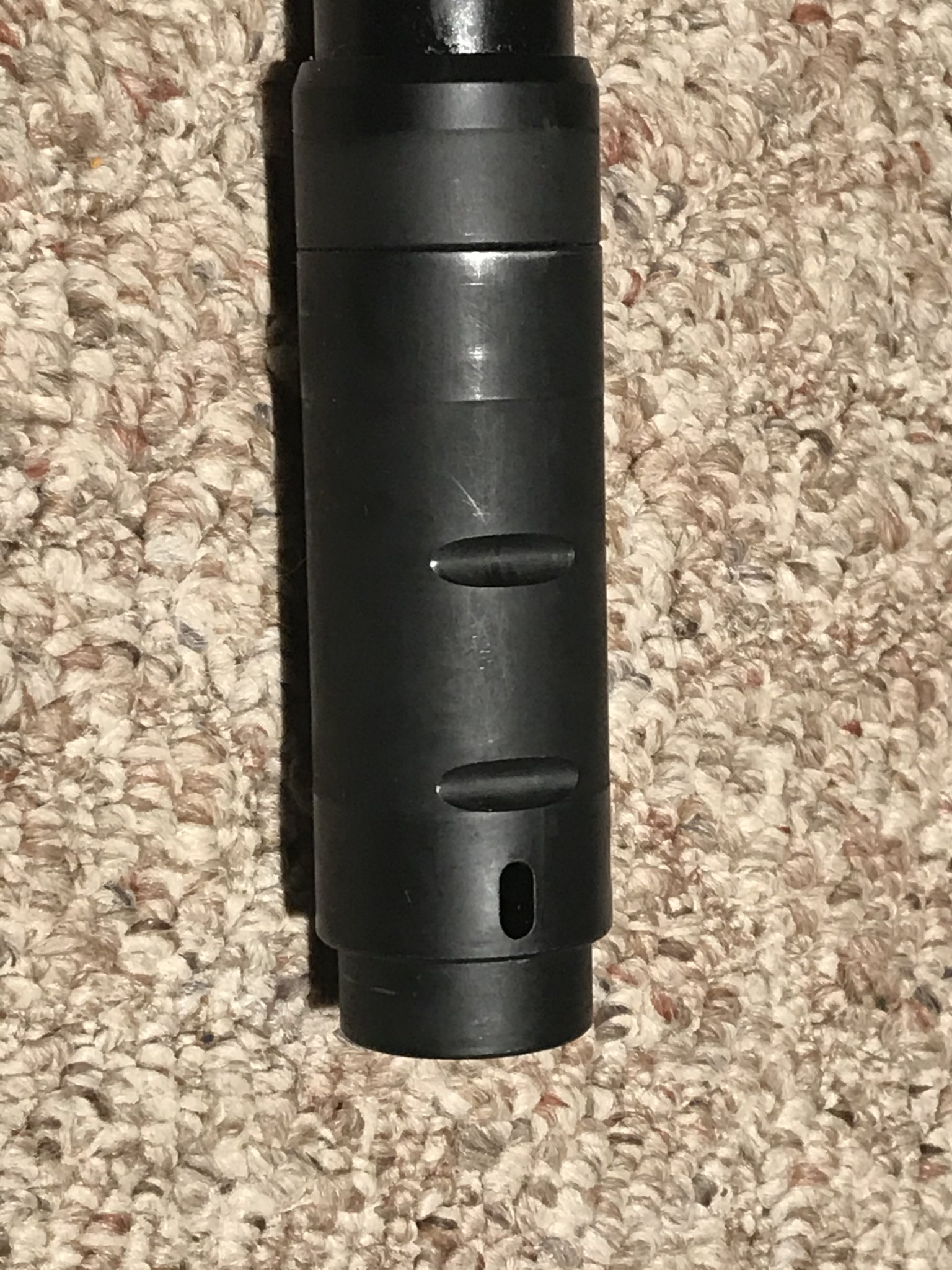

How much was the machining to make the small breech work in a large breech?
I wonder what the differences actually are? Like will a large breech barrel thread into a small breech extension? Interior dimensions of the extension are different along with bolt head, bolt body, I'm sure.
I'm curious if the barrel is cut the same and just the extensions are different.
It’s lmost the same I can put a small breach barrel with extension in mh large breach, but you can’t push the torque bolts through.
Large breach barrels have two cuts for the boots to go theough across the extension. It looks like the cuts that pin an M4 front gas lock into place.
They didn’t charge anything, they said any barrels I want just buy direct and let them know and they would machine it before shipping. They did the service on a barrel I bought on here without knowing.
You mind taking some photos of all this? I'm always interested in the historical/version differences of this particular rifle.
I have an AJ prefix serial in the 1300s which is pretty early. It's large breech, but even mine doesn't have the torque bolts passing through the extension.

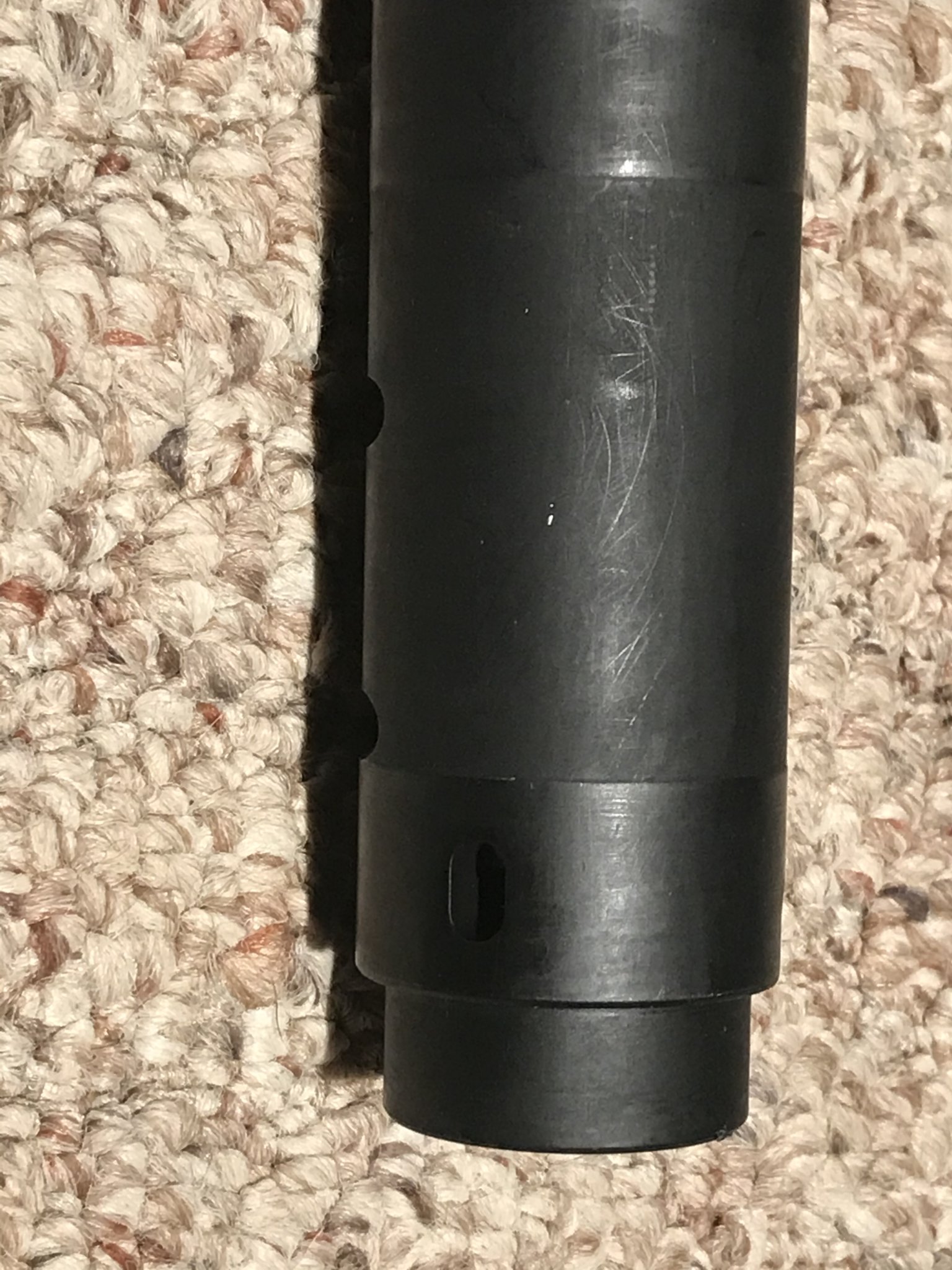

Bottom and aide profile, Barrett has to cut those two grooves, barrels typically come without them now.

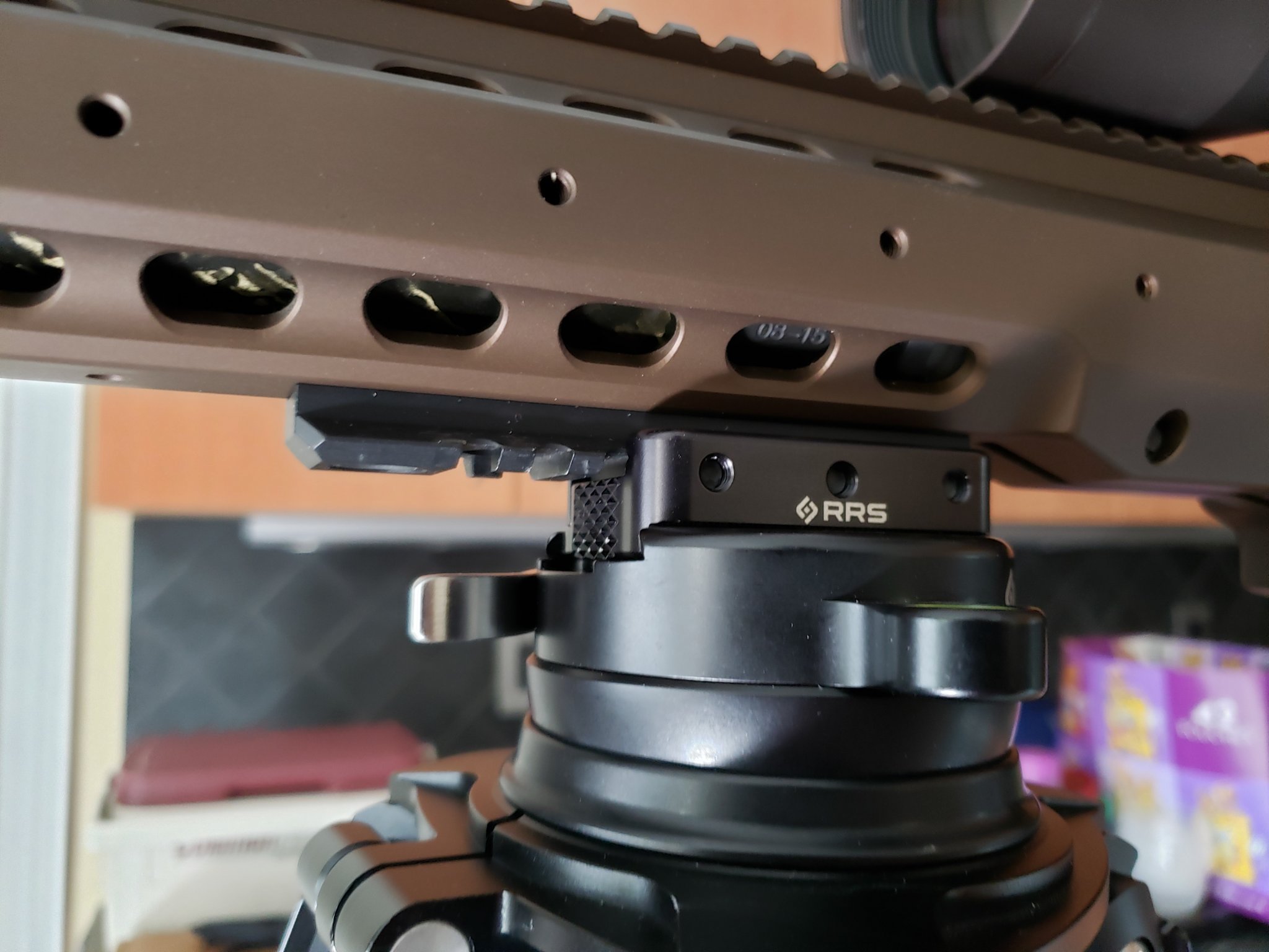

I just wish they’d make a rail with non rotating QD, every time I touch the sling it gets twisted. Sometimes that’s ok but under a 20lb rifle it gets a bit painful.
