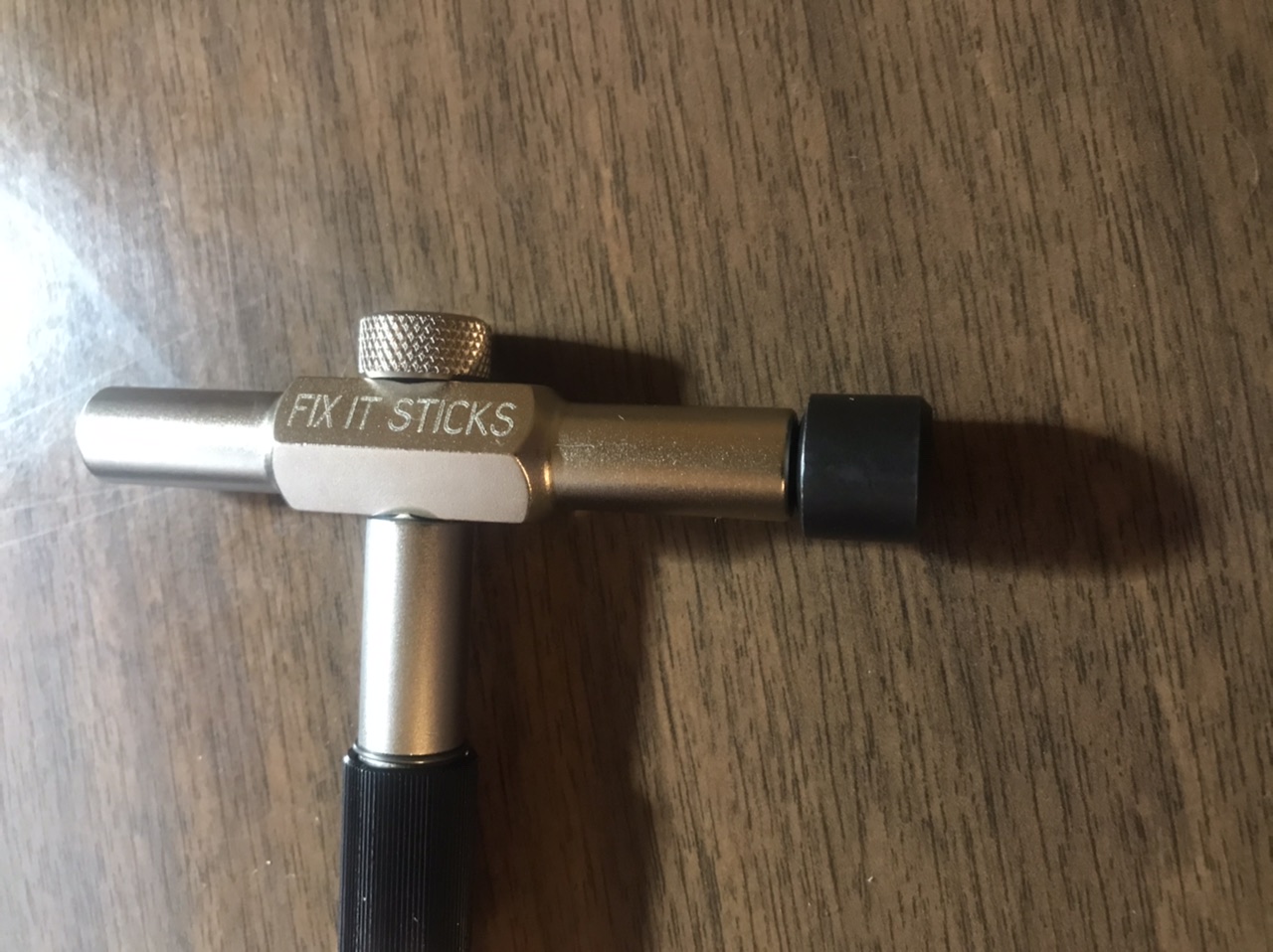

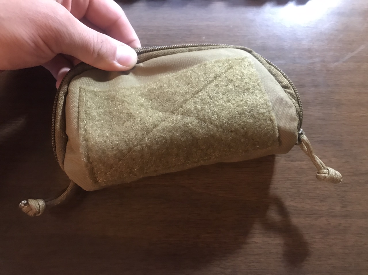

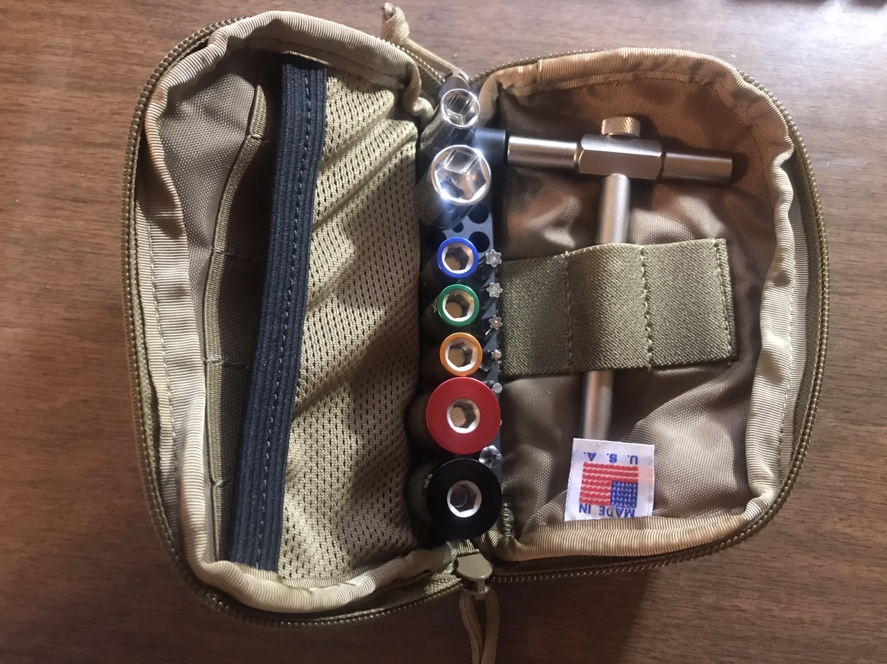

Mk 22 tool kits listed at Barrett, well worth it, I just bought some fix it stix. The kit includes several torque limiters.
It is decent but expensive and I already have some fix it stick sets. I just need the 140 limiter.

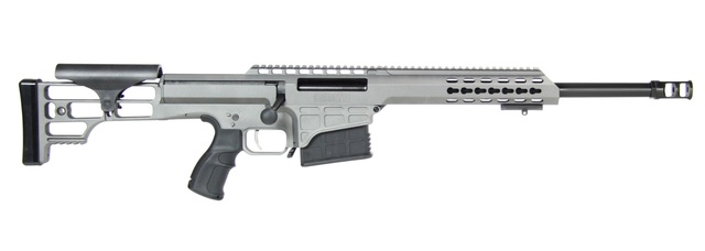

Does this rifle have the barrel change option ?
The model is MRAD.
It also lists 98B
Does it take all of the barrel conversion kits.
Thanks
Additional Info 98B TAC 308WIN TUNG 16 10+1 UPC 816715013873 MPN 14804 Model MRAD
No to both.
I know funny enough I was looking for one on there a couple days ago then this kit was released.That is a unique kit - Fix-it-Sticks does not list a 140 in-lb torque limiter on their website.
It’s a pretty blah kit compared to others they offer for $100 less. The only thing I need in it is the 140 driver. Hopefully they start selling them separately.That is a unique kit - Fix-it-Sticks does not list a 140 in-lb torque limiter on their website.
Did you email Barrett or the Fix it people?I happened to email them 2 days ago and asked about the 140 inch limiter, no response.![]()
Gotcha. Wonder if they are doing it exclusive for Barrett so they can mark the shit up so much.Fixit!

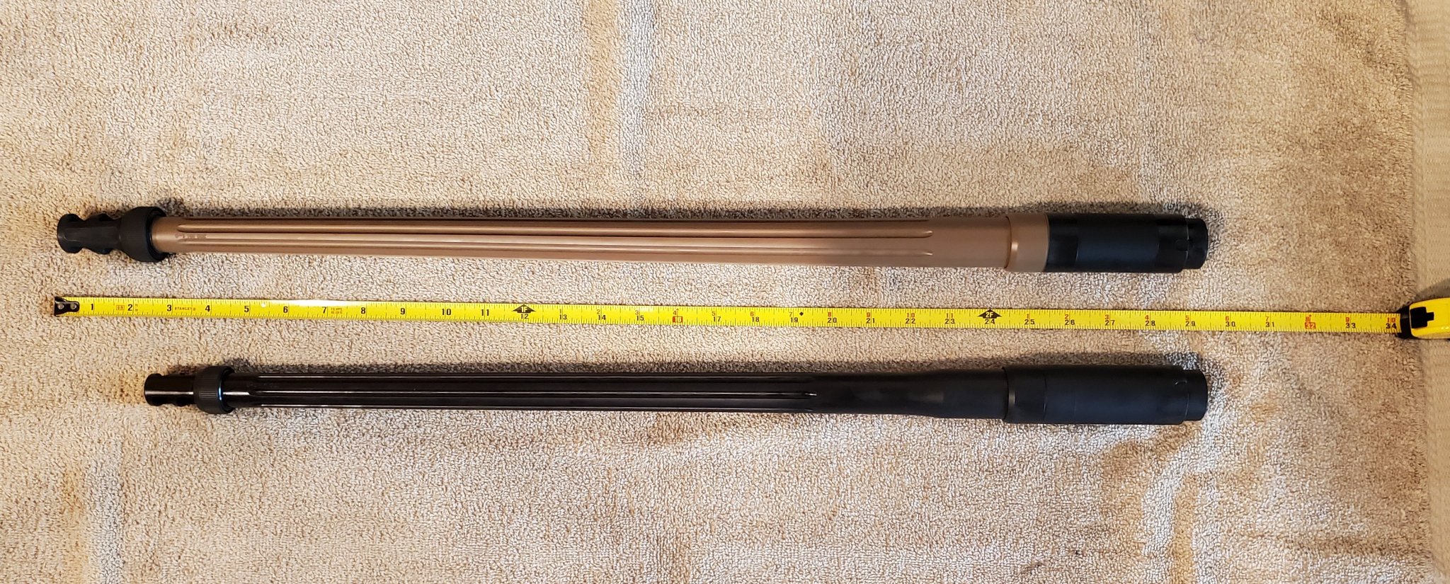

Have the 26" 338LM; 20 and 22" 308 all fluted. The 26" is really barrel heavy. But, don't plan on clearing structures or humping mountains any more.Anyone out there own a 26" heavy 338 Lapua barrel? Does anyone own more than one of the different contours of barrels in the same caliber for the MRAD(of course)? Or say 17" 308 & 22" 308 at the same time.
While I don't have a 300 Norma, I can tell you the 300win mag recoils less then my Remington 5r in 308 did (the 5r did not have a brake) in fact, I feel like my mrad in 338lm recoils about as much as the un-braked 5r (maybe SLIGHTLY more). And it's not just me, my friends that have shot the mrad were amazed by how light she shoots...How does the 300 Norma feel to shoot with the stock MRAD barrel and brake? I usually run area 419 brakes. Looking hard at the deployment kit

Think you are referring to large breech and small breach. First roughly 1100 or so MRADs were a larger diameter bolt. The large breech requires a breach kit about $400 to use later small breach caliber conversion kits. Large breech barrels are identified by two cross clearance cuts (slots) for the barrel tightening screws in the barrel extension area underside. Smaller diameter small breach barrels do not have these as the screws clear the extension diameter.GREAT !!! Sp what's with the "short / long" talk? Is that Gen-1 only?

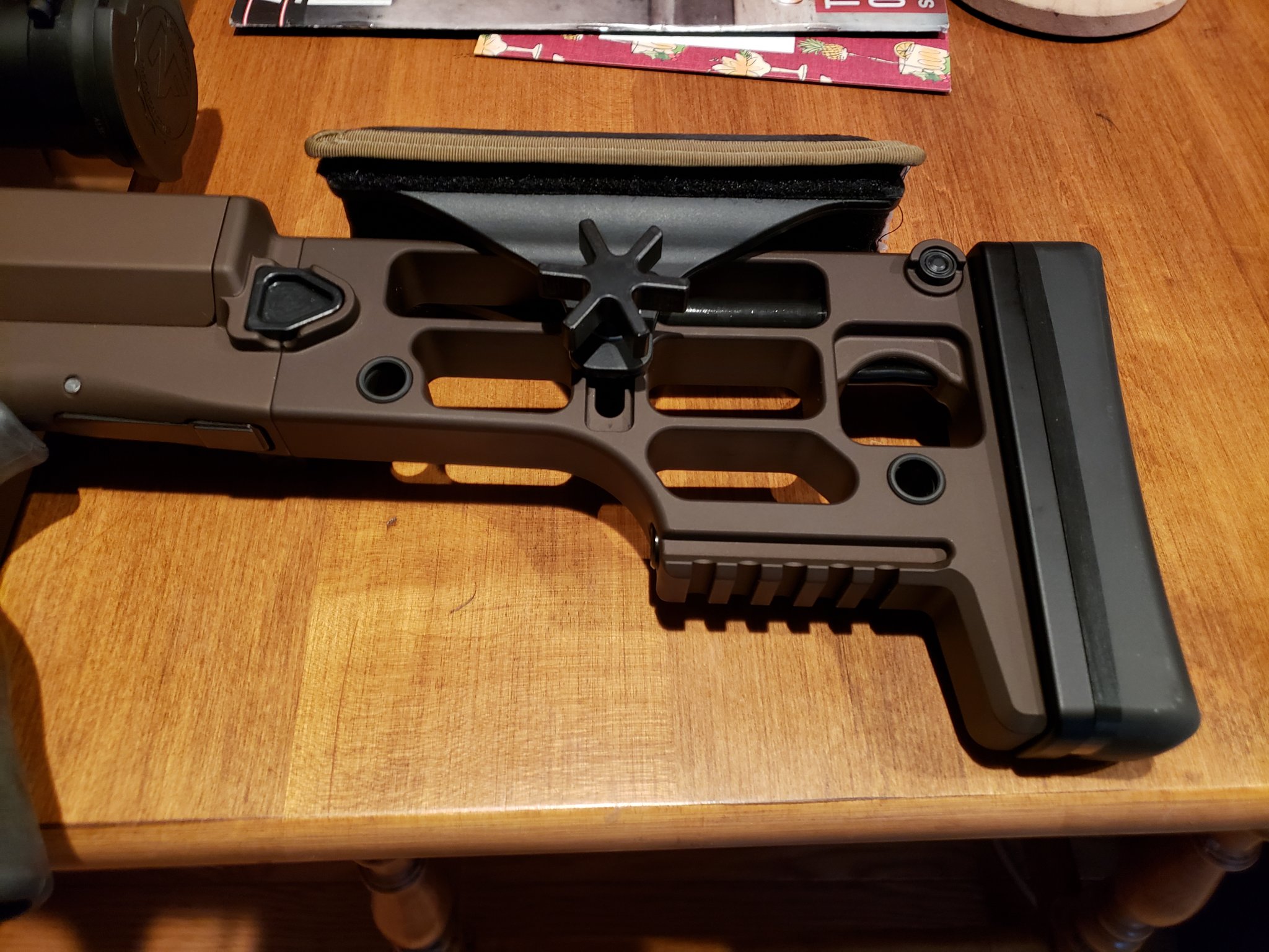

MRAD Bag RiderSKU: 18799 in black only is available in Barrett store at $75.00. It will be slightly long for the civilian MRAD as it was designed for the MK22 Mod 0 stock, but will work on any picatinny rail.What I'm missing Barrett is a bag rider and vertically adjustable buttpad, when will they be listed on the Barrett Store under accessories?View attachment 7171824

Think that is the MRAD SMR (Single Mission Rifle)...non-change barrel and non-folding stock. 98B was predecessor to MRAD, now discontinued, and replaced as SMR at $4995 versus full MRAD at $6145.....best $1150 up cost for change barrel and folding stock.Thanks.

Both GEN 1 and GEN2 both pinch the barrel. The roughly first 1100 MRADs were large breach with the barrel pinch bolts "nicking" the barrel extension.....bout 1/2 diameter bolt slots. Small breach bolts totally miss the smaller diameter barrel extensions.IDK how, but I learned today it’s done, assume a drill press or end mill. The gen 1 bolts go through the barrel the gen 2 pinches the barrel .

Look at YouTube video by Darrik Bolduc, Barrett Engineer, demonstrating MRAD caliber swap technique. Note to preload barrel to left....it's a RH twist.....during bolt torquing....similar to pushing scope mount forward against pic rail during torquing. That preload increases zero repeatability.-Install barrel and close bolt with rifle vertical so that the barrel's weight seats it against the shoulder while tightening the collet bolts
-Mitigate minor play between barrel index pin and index notch by rotating barrel to right or left as it is seated (just do it the same way)
-Tighten collet bolts alternately 1/4 to 1/2 turn until “finger” tight, but torque front bolt first
M-Lok, bag rider, vertical adjustable butt pad are features only on the MRAD MK22 MOD 0 version as on 6/20. Appears they will be migrating to civy models at undefined time. Also, includes the "toggle lever" bolt disassembly, 10MIL vs 20MOA rail.I would try used on one of the resale forums. Many are unfired, or close to it. I found my small breech on the px here for just over $4k here with .260 and .338 barrel kits. I think there has been an unfired .260 in grey on the PX for $4k for months.
The only changes I have seen on the civilian sale guns are minor details in the buttstock design. The newest revision appears to allow tool-less up and down adjustment to the butt plate. I have also seen pictures of a version with MLOK and a bag rider, but have not seen it for sale any where.

Regarding the barrel preload right or left. Might suggest preloading to the left only as the barrels are RH twist. The same concept as pushing scope mounts FORWARD into the picatinny rail....instead of rearward.I've had mine for a limited time but did observe a decent amount of shift between .260 and .338 that was repeatable within one to two tenths of a mil. I had close to one mil windage and .5 mil elevation going from the .260 to .338. I did purchase all components used and don't really know the part's service history or treatment by previous owners.
Based on advice from other MRAD owners there are a few things I could have done to mitigate this:
-Install barrel with rifle vertical so that the barrel's weight seats it against the shoulder while tightening the bolts
-Tighten bolts alternately 1/4 to 1/2 turn until tight, but torque front bolt first
