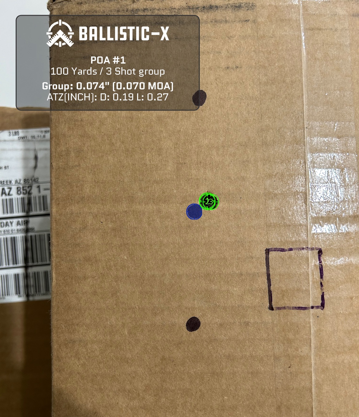

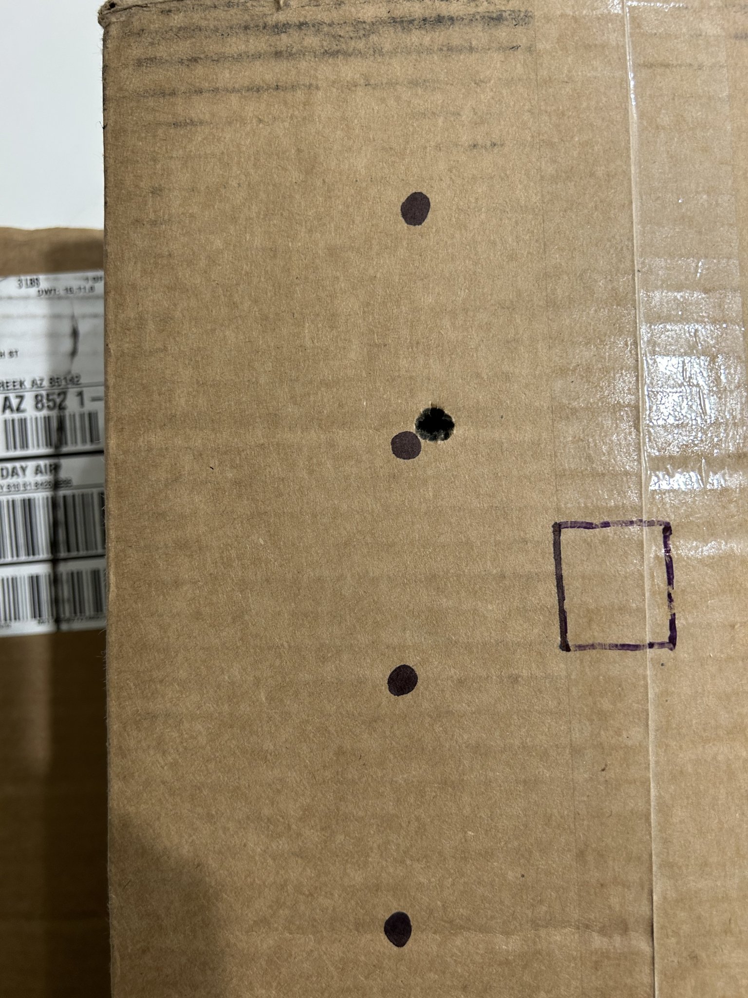

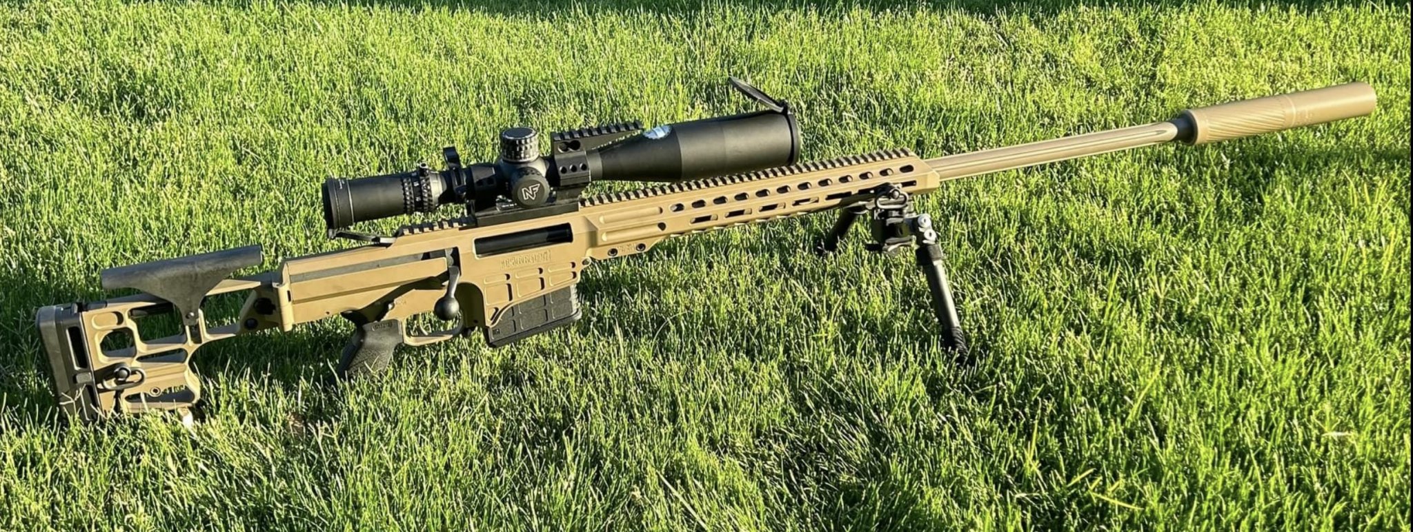

Barrett MRAD (newest generation manufactured in 2023) chambered in 300 Norma Mag with a Bartlein 1:8 twist barrel spun up by Southern Precision Rifles aka Bugholes.
Factory Norma 230 grain hybrid ammo.
18 rounds fired in total at 100 meters.
Three, 5-shot groups measuring in at an average of .327 MOA.
The last group fired was a 3-round, .07 MOA group seen attached.
Very, very happy with the results.

RESULTS:
Congrats! Gotta love Bugholes!!! Their barrel making skills rock. I've told this story before but when I did training with Chase Stroud he kept asking... "now who did this barrel for you?" He was super impressed with the accuracy.

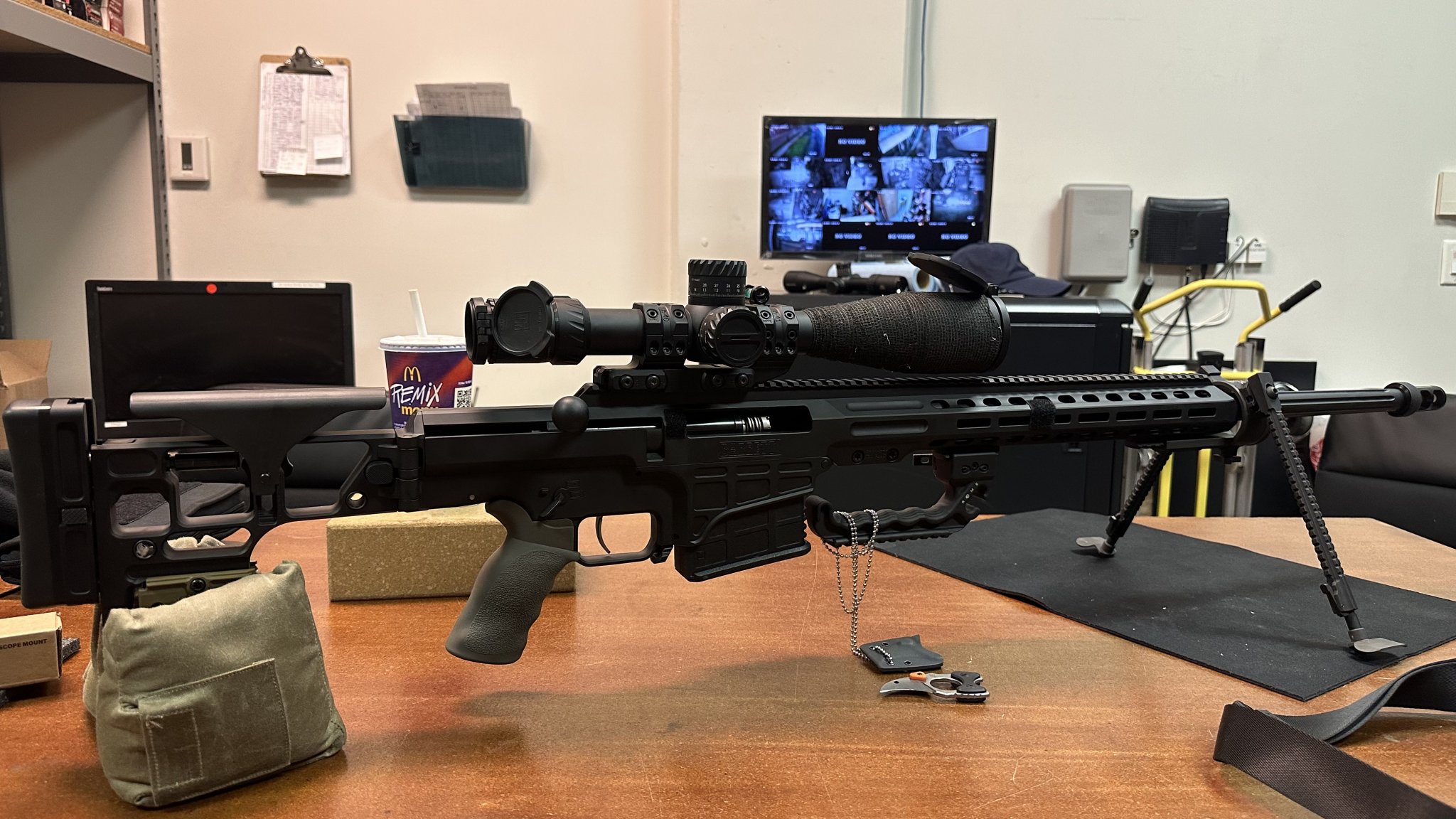

I received the rifle yesterday and wanted to shoot it right away. Went to a local gun shop and picked up a set of Nightforce 34 mm ultralite rings 1.5" high with a six screw design. I appreciate the Badger C1 and Spuhr recommendations. Thanks

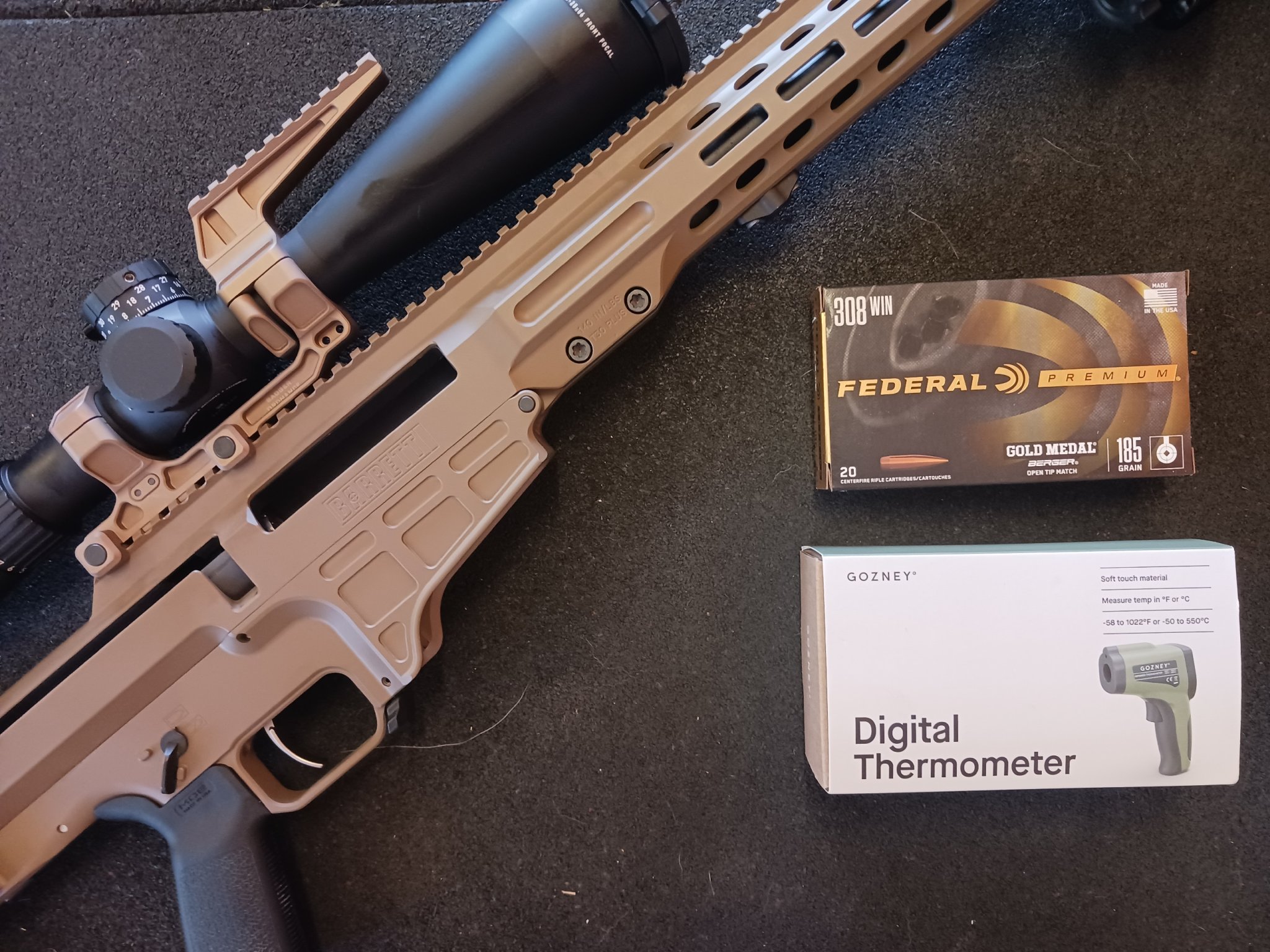

308 Bros, how does this shoot with 1:8 twist? That sounds mighty fast of a twist for most 308 loads.
Zero issue running the 1/8 with 308 bud.
Haven't gone lower than 168gr at this point though but shouldn't be any issues.
We are running 185gr FGMM ammo and it's insanely consistent for factory ammo. ES/SD is sitting at 8fps on average for nearly 200 rounds now.
Ours has the 17" barrel and we are still making reliable impacts on MOA targets at 1000y with it.
Couldn't be happier with the performance.

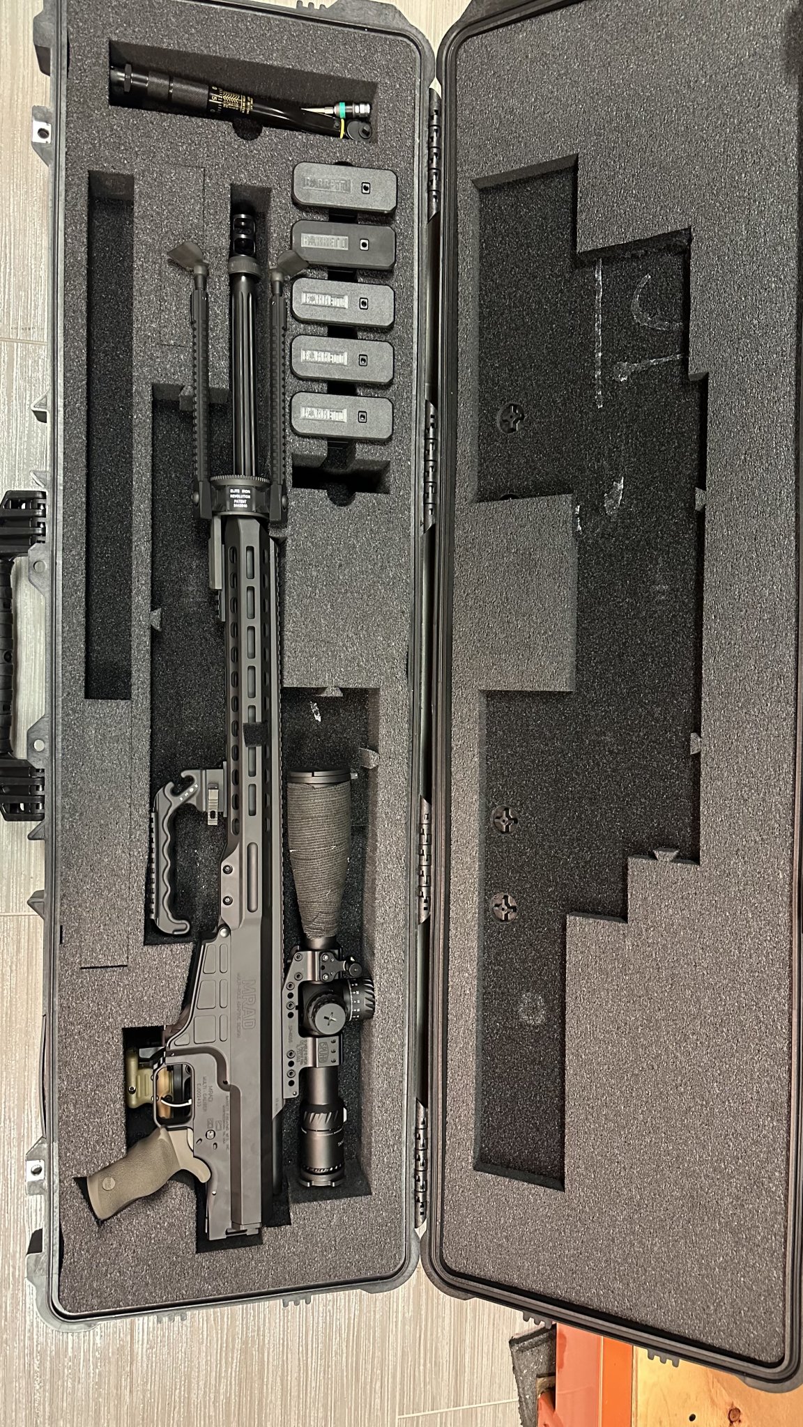

Oh, you're perfect! What's the OAL with the stock folded? I was looking specifically at getting a 17, but not sure if it will fit properly in my big case. Ideally it's small enough to fit in there with my wife's rifle with a folder, allowing us to just take one case on trips.

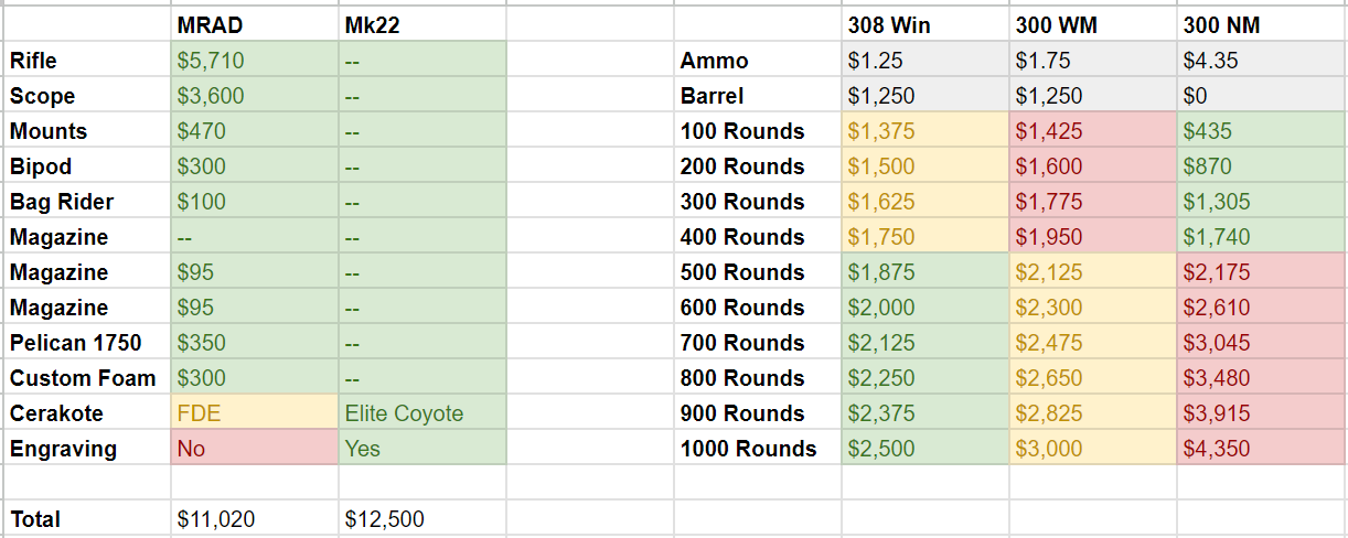

I've been contemplating selling a bunch of rifles and gear and just going full out Mk22, but I'm also thinking I'd be just fine getting a standard MRAD, adding the bag rider, and then cerakoting everything (including the barrel) to match the slightly darker FDE/Coyote hue of the Mk22. At that point, I would assume that literally the only aesthetic difference would be the Mk22 markings on the receiver.
And at that point, despite the fact that the AM338 is ever so slightly different than the AML338 (no locking mechanism, 0.4" shorter, and 0.1" less in diameter), if the whole thing is covered in the issued suppressor cover, it's not like you'd be able to see it anyway.
These are the thoughts running through my head anyway - I'll mostly likely never have a need for 300 or 338 Norma given the lack of super long ranges in my AO. Seems like a Mk22 (turning a standard MRAD into a look-alike) in .308 is the way to go and going the route I mentioned above is sounding more and more appealing and WAY less $$$.
You end up talking to Barrett about this?

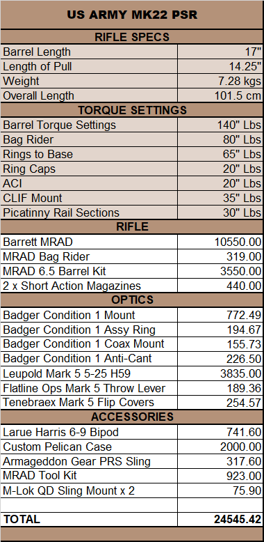

I ran the same exercise a couple years back. Prices have changed since then but I was looking at the parts that come with a complete Mk22 vs building one. In 15+ years, I have yet to regret paying a premium for clone correct and went Mk22 myself considering the difference. Hell if you don't need the engraving, you could consider buying the Mk22 kit and parting out the Mk22 receivers/barrel/mags on Gunbroker for like $9-10k, keeping all the accessories and come out ahead after buying a vanilla 308 MRAD for 60% of that.
thats a crazy price
I ended up little less than 10 000usd
Rifle , bagrider, bipod, nightforce f1, spuhr , B&T silencer , 3 barrels 338lm , 308 & 6,5cm
You sure you got a $5500 rifle, 2x $1500 barrels, a $2-3k+ Nightforce, then all the other stuff for less than $10k? That's 10.5 with a cheap Nightforce, before another $1-2k in other parts!
