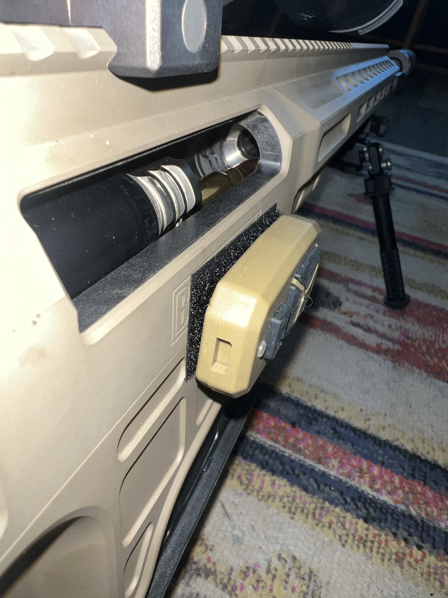

Weirdly enough 1 round in the magazine chambers perfect anymore it hits the extension before entering the chamber

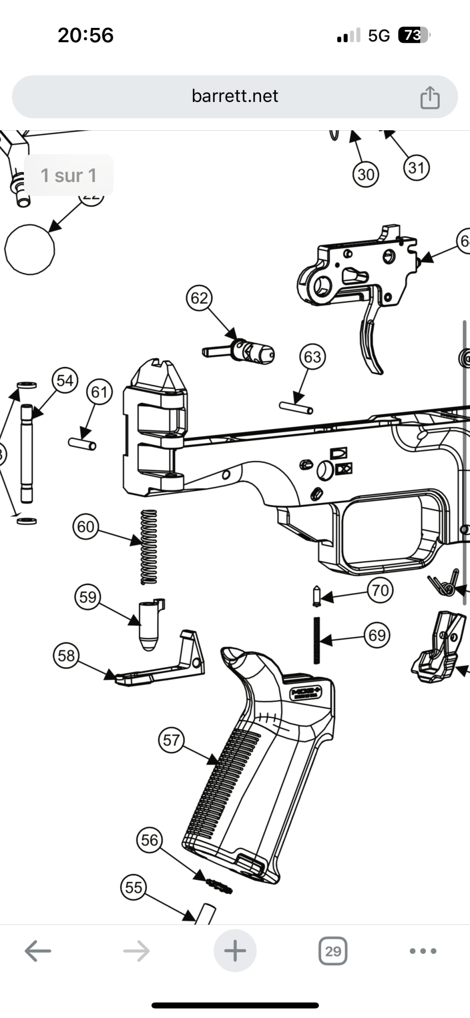

Hello,
I m planning to Cerakote my MRAD in E-190, I search a solution to remove those pin here. (61 and 63)
Thanks
View attachment 8440590View attachment 8440591View attachment 8440592
The first pin you pictured doesn’t need to be removed. But it’s up to you.
The receiver latch pin will most likely need to be “pressed” out with a hydraulic press. That’s how they do it at the factory. I have legit seen 3-4 people hammer on one for 20-30 minutes and it doesn’t budge. They are slightly oversized now due to the MK22 contract spec. This in theory, is to prevent any accidental unlocking of the latch. If you try and hammer it out… you might get it out, but probably not.
Taping it off is fine, but if you use bake on cerakote, and any paint gets in there. It bakes the paint and the latch may or may not work. I’ve seen that before and a guy had to send it back to Barrett for them to remove the latch and clean it up and reinstall the latch.

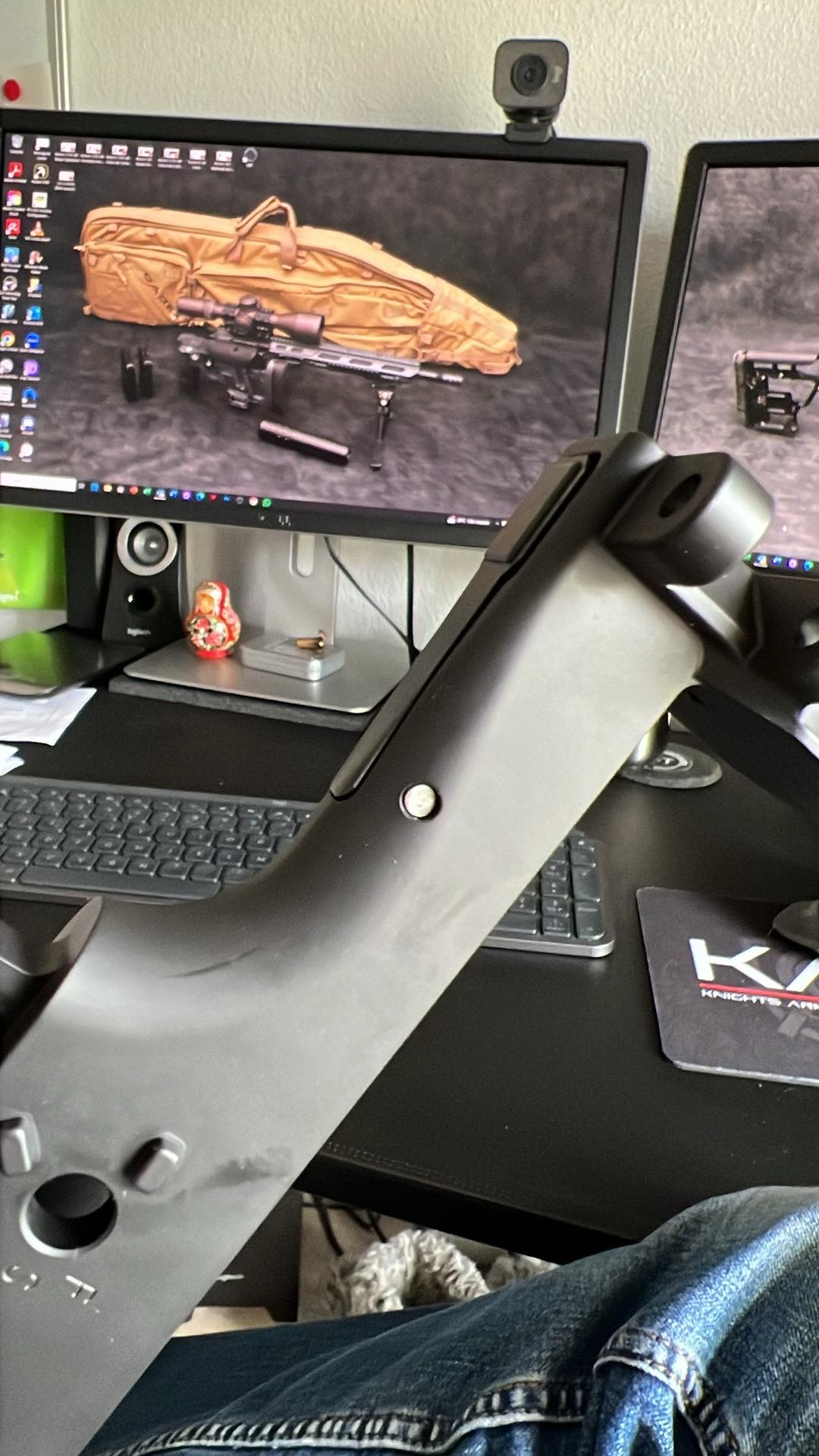

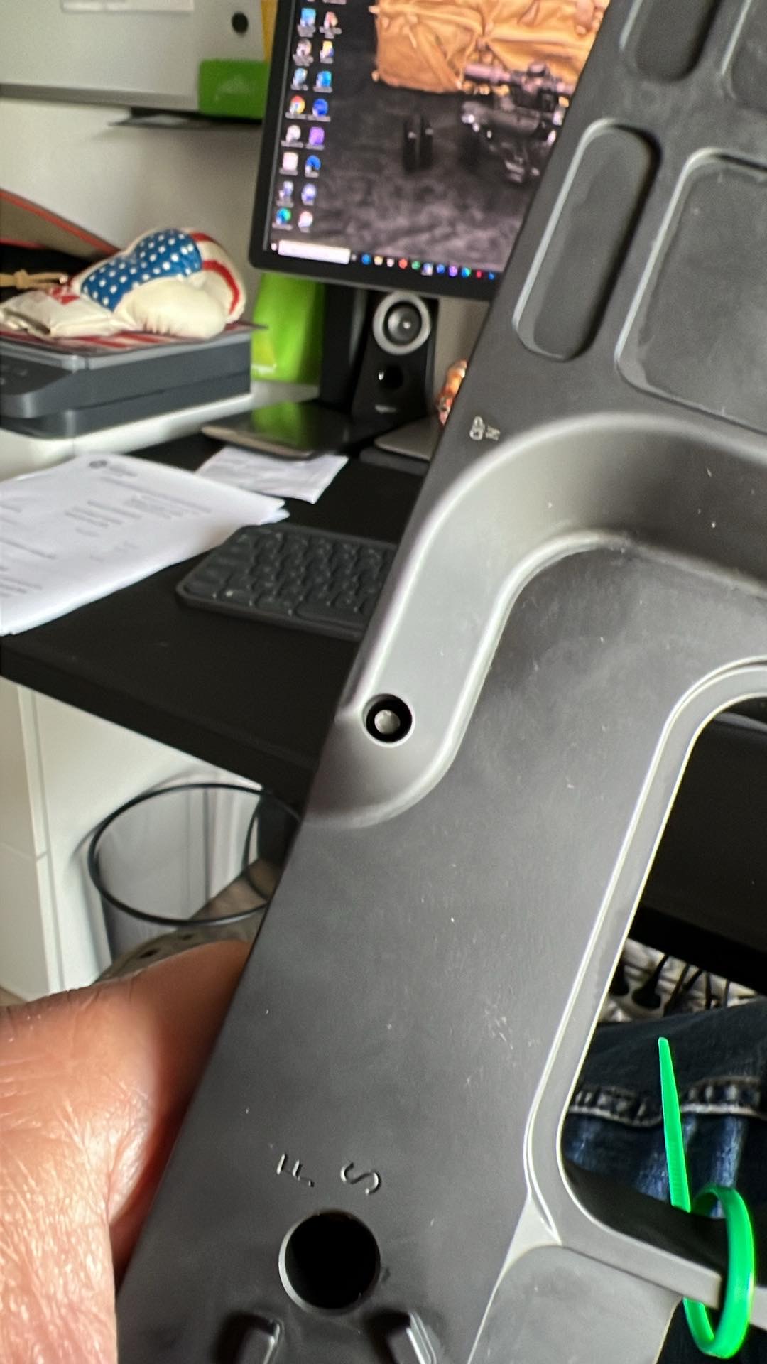

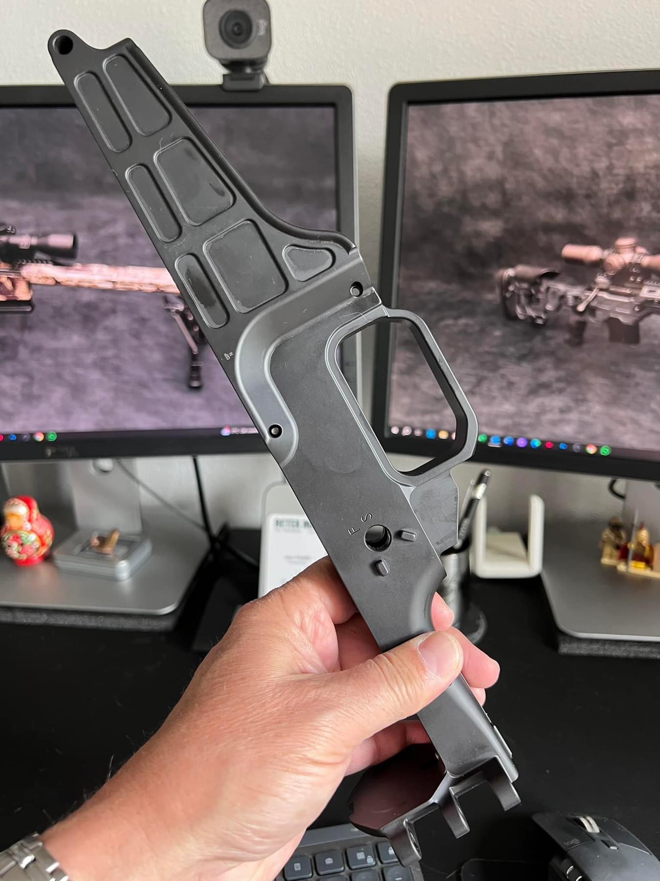

I'm going to answer my own question because I found the answer out - the QD cups cannot be removed. I have the bag rider fastener/screw pointed out as well above, but I (somebody can correct me if I'm wrong) believe that can be removed, so no issue there.
I suppose the only option then is to somehow cover them, or just cerakote over them, but it does appear that there are several black parts that are basically just permanently buried/affixed to the chassis with no way to remove them.
Does anyone know if the buttstock folding button can be removed? That could be another one that would be tricky if not.
@Patch98 Whomever did the cerakote job on your MRAD, were they able to remove the folding buttstock button in the process? Or did they just cover that with something and cerakote around it?
Removing that is a testament of thumb strength. It’s just like a AR15 magazine r button install.
Those QD mounts are pressed in at the factory. So really no way to remove or install easily.

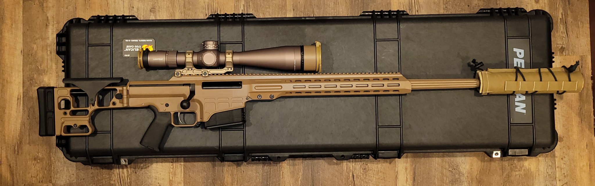

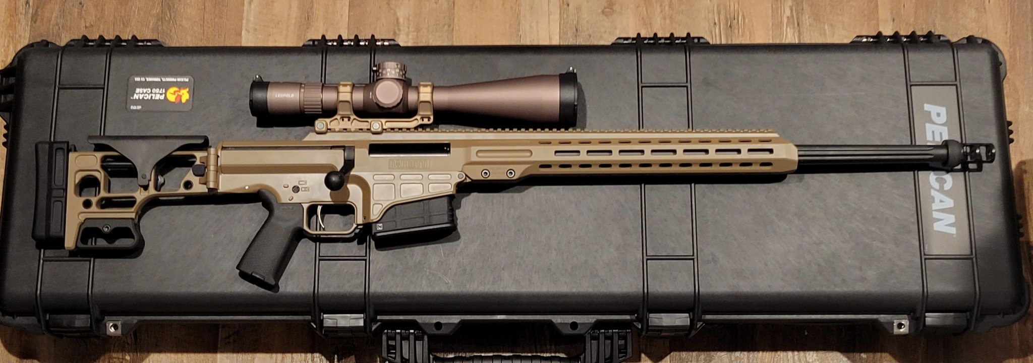

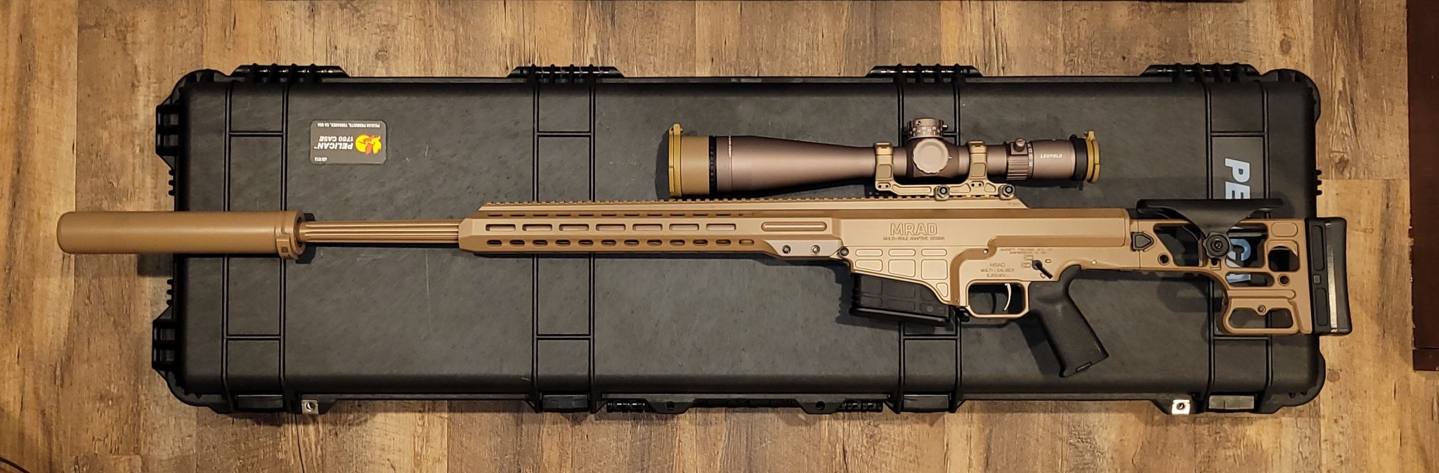

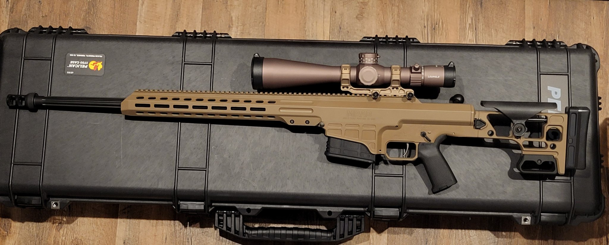

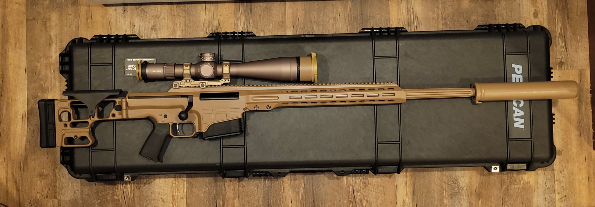

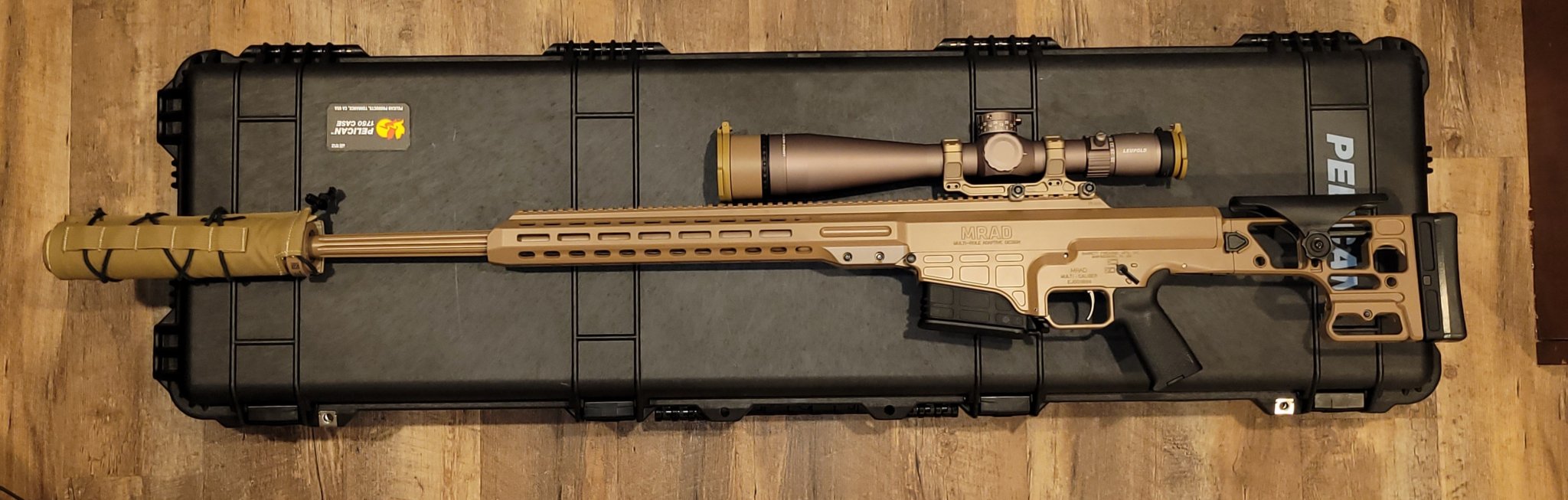

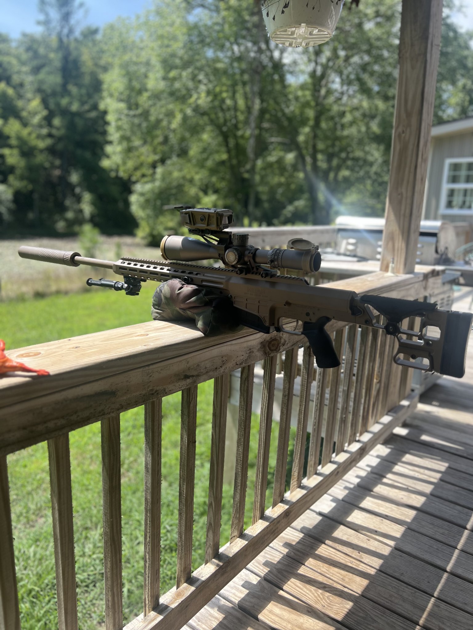

Commercial MRAD to Mk22 Clone Transformation:
Before:
After:
The bipod is on backorder at Larue - once that comes in I'll throw all the mlok 1913 rails and bipod on and that should really complete the package. In any case, I was going for the Army version with this, so it's going for that look.
Before:
After:

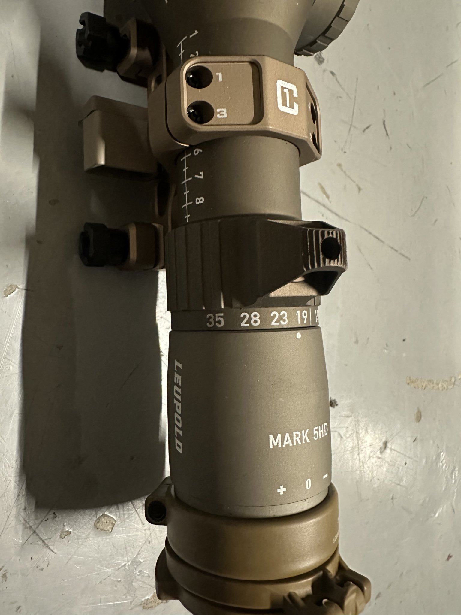

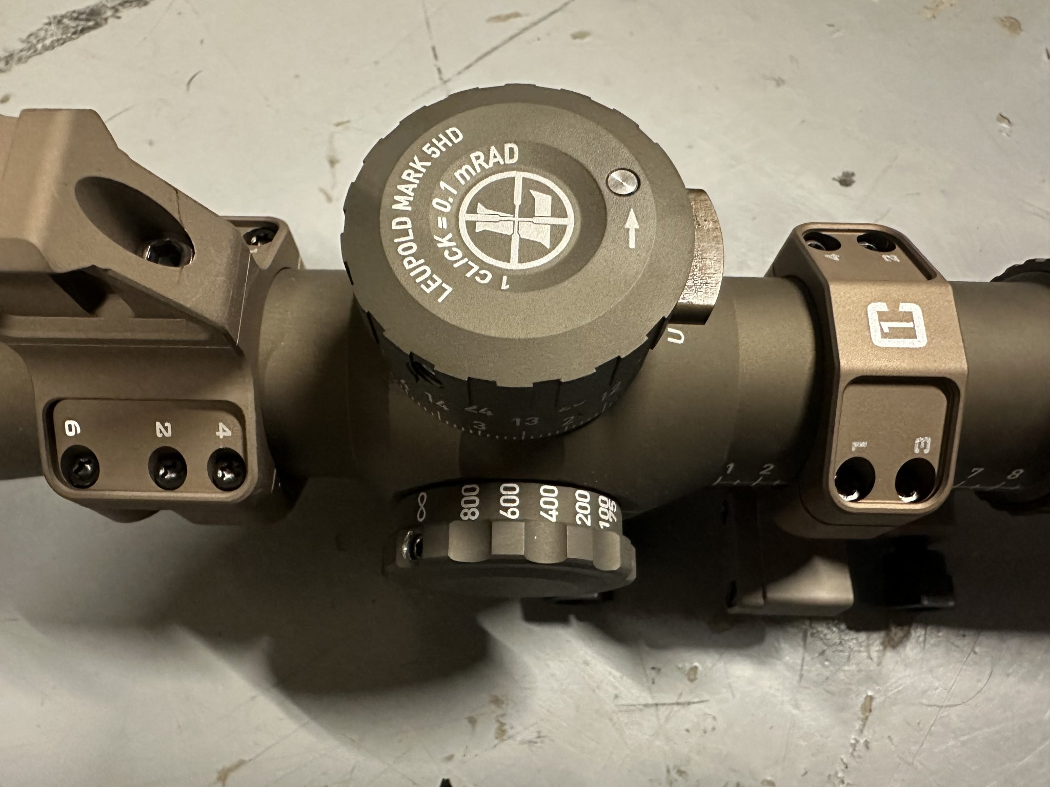

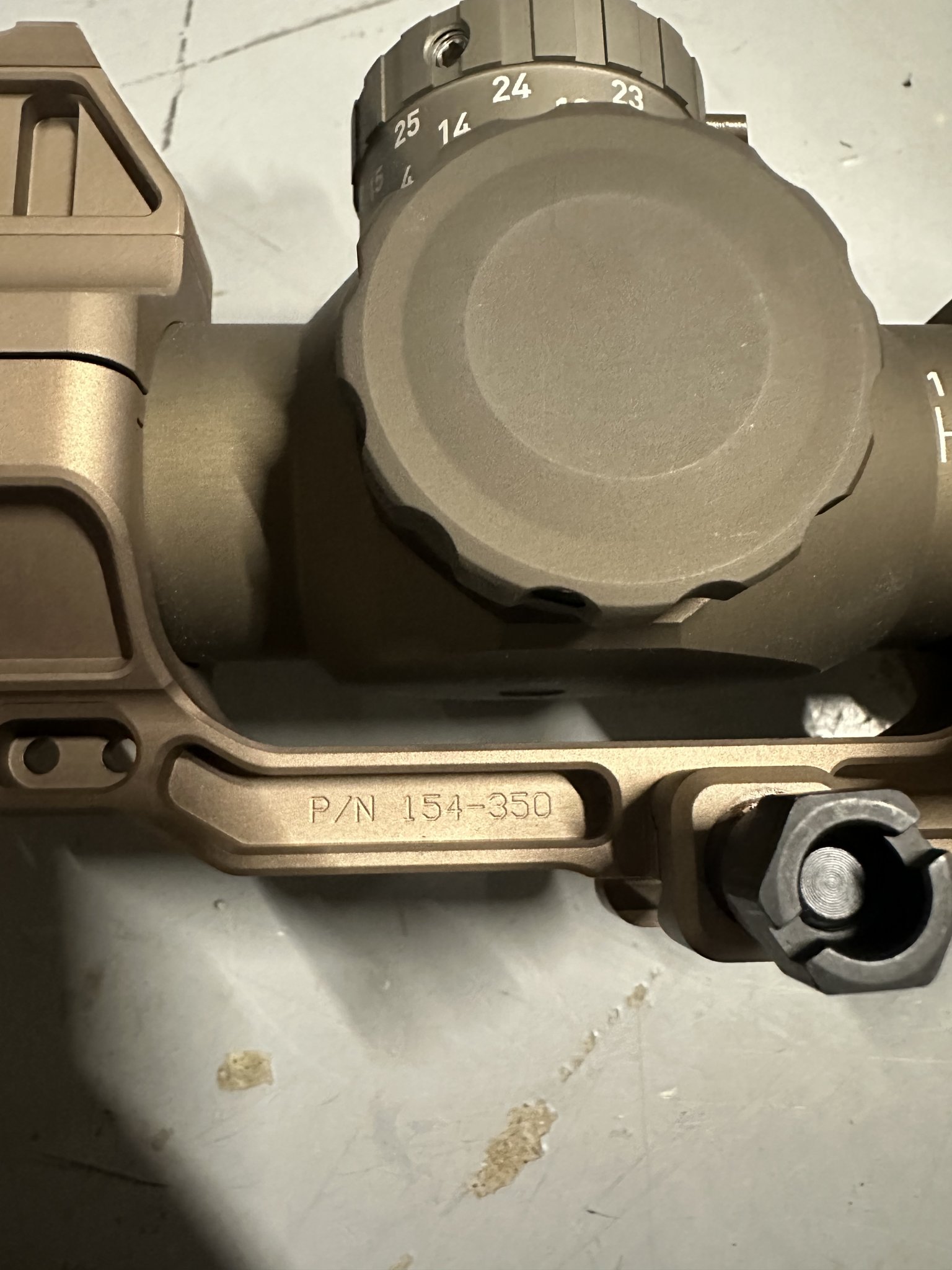

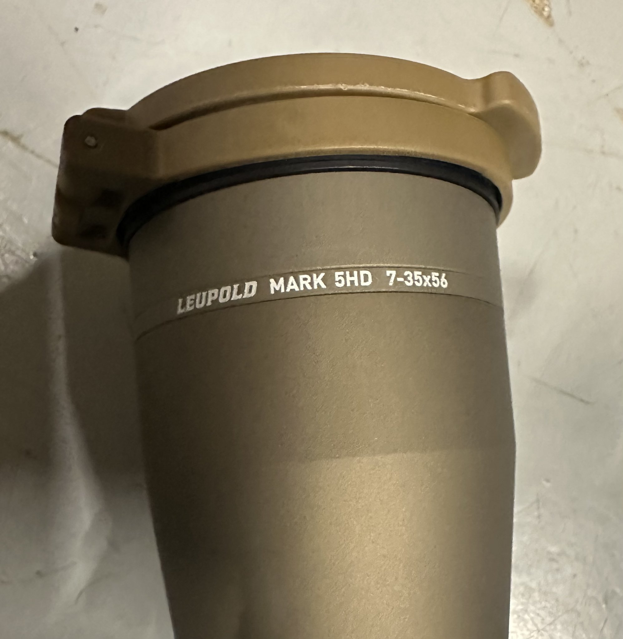

Whats the forward cap on the Mk5?
