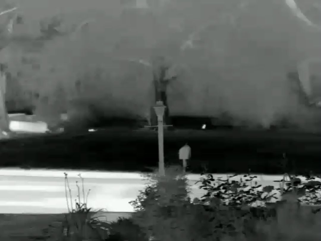

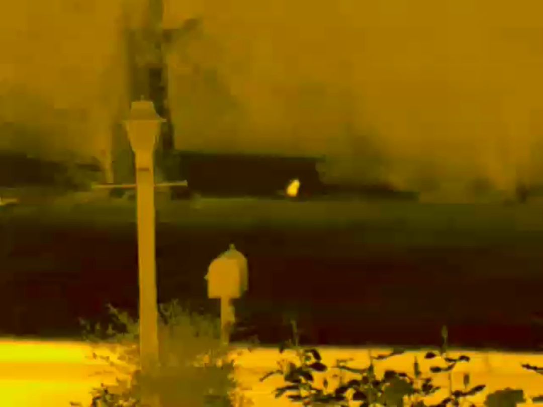

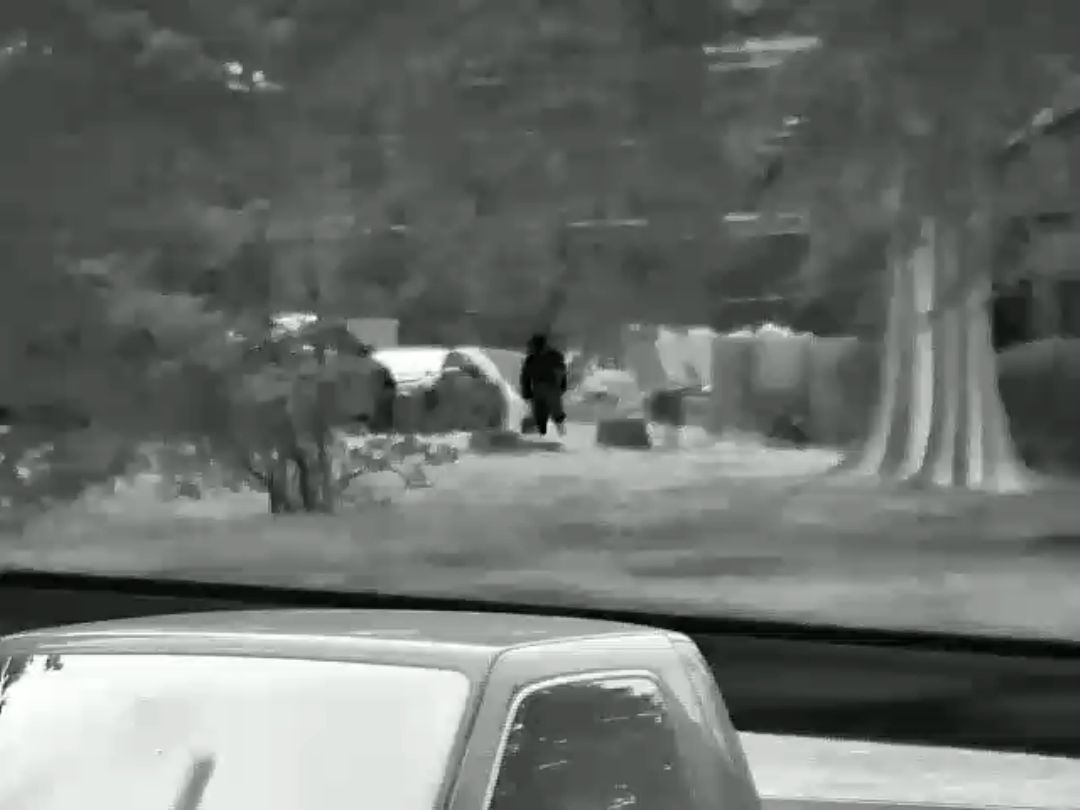

I know this is the c35 thread but since they are essentially the same here's some pics of the s35. These were taken through the Steiner Connect app, so I'm not sure if quality is degraded as the picture is compressed and sent over wifi to my phone. The first three pics are of rodents or squirrels or something across the street.

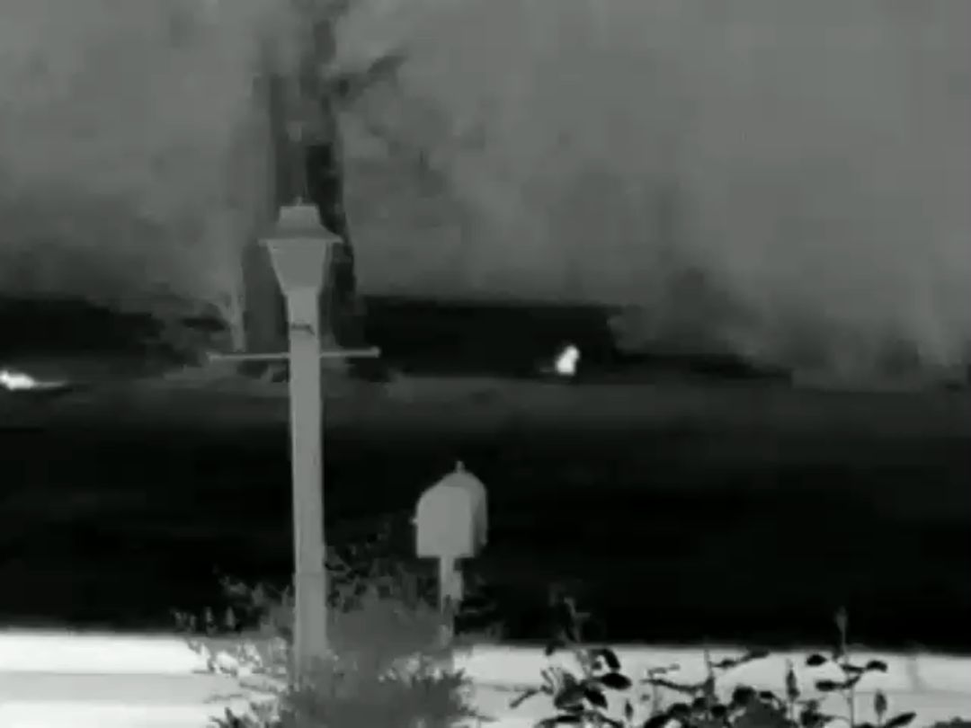

This is an image after thermal crossover of an individual across the street maybe 150-200 feet away I believe at 1x (i was drinking so don't remember)?

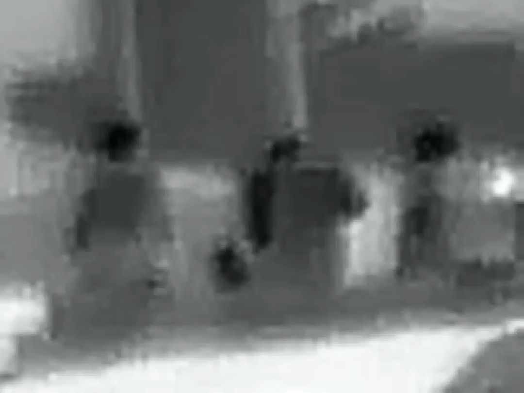

These were three individuals at max zoom (8x) probably 300-400 feet away?
My settings for the unit was sharpness on and I was manually NUCing every minute or so to keep the image clean (again these pics were taken before, during, and after crossover). I think at 1-3x it seems ok however past that the image really becomes degraded. Those three individuals who were maybe 300-400 feet away were completely unidentifiable, i could tell they were human but other than that I could get no further detail. Even the picture of the person across the street was unidentifiable. I think maybe I'm still not using the best settings or not too smart on how to best operate it. Also my only comparison is using cooled thermals that hang off airplanes and are able to positively identify a person from extreme distances, so maybe my expectations were not fair. I think this thermal is a cool toy and should be able to detect animals out to "medium" distances but I'm pretty disappointed in the quality of the image.

I know this is the c35 thread but since they are essentially the same here's some pics of the s35. These were taken through the Steiner Connect app, so I'm not sure if quality is degraded as the picture is compressed and sent over wifi to my phone. The first three pics are of rodents or squirrels or something across the street.View attachment 7871397View attachment 7871395View attachment 7871396
youre having connection/bandwidth issues.
I had a buddy take both out last night and compare them, those were his exact words. He said that the C35 had a clearer picture at higher magnification with sharper details. He believes it is due to Steiner's image processing software and extensive settings as he was able to use settings to make the image very sharp and detailed. He also didn't see any POI shift when putting it on multiple guns. However, take this with a grain of salt and wait until I can post tangible evidence.

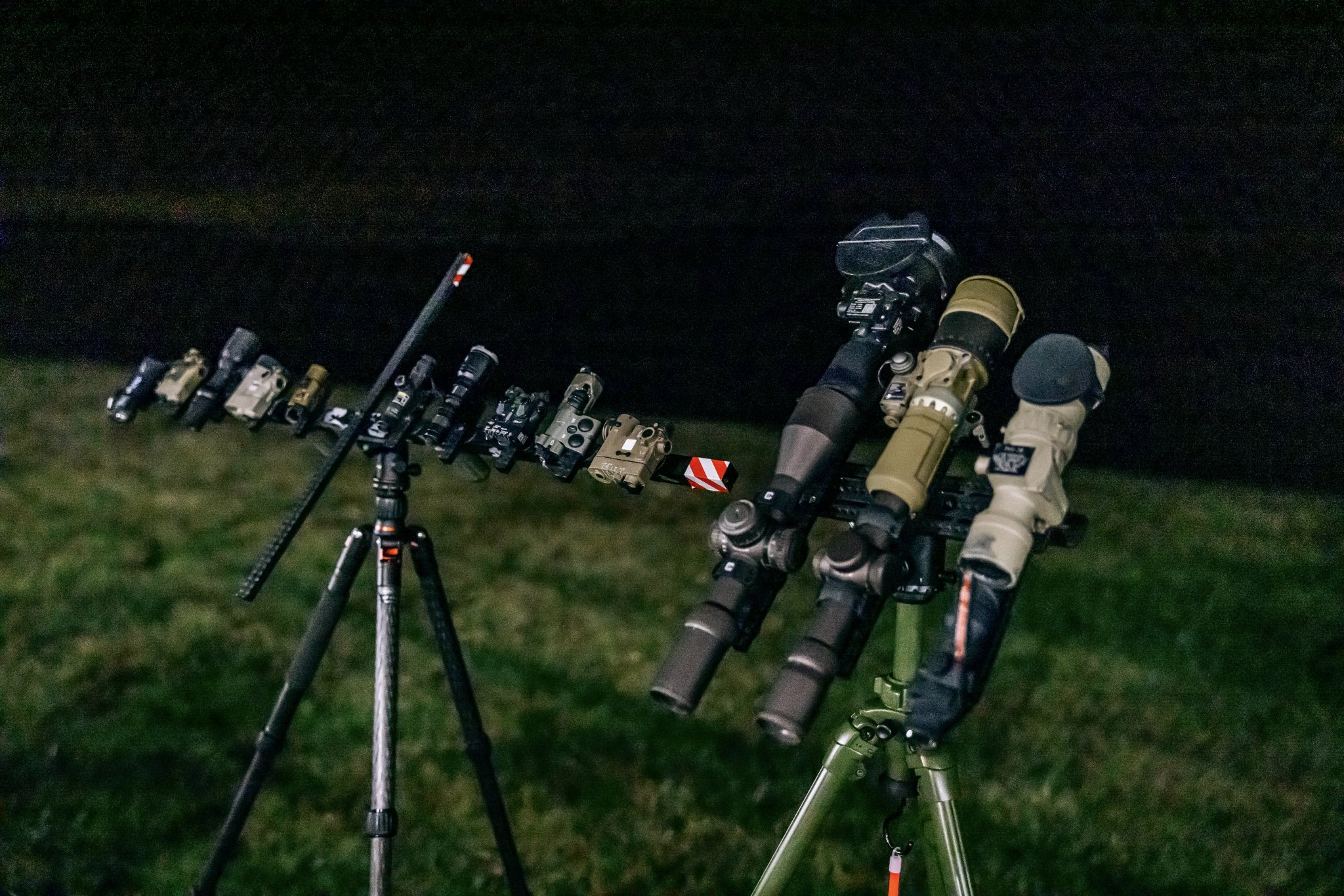

All that said, I took out the “Stable” to compare — wondering just how close the RH25 and C35 are to the Big Dogs that cost 3-5x as much. I was out at about the time of the dreaded “Thermal Crossover.” Both the C35 and RH25 really struggled to show a clearly defined steel plate at 100 yards. It just about completely melted into the background, even with the gain and contrast cranked-up and regardless of color palette. The Voodoo-S, UTM-X, and UTC-Xii could easily present a well-defined plate without having to crank-up the image setting and, with a quick turn of the eyepiece, everything came into razor-crisp focus and there was basically zero POI shift.
Are the Big Dogs worth the extreme price differential? To most, probably not. To me, hells yeah!
