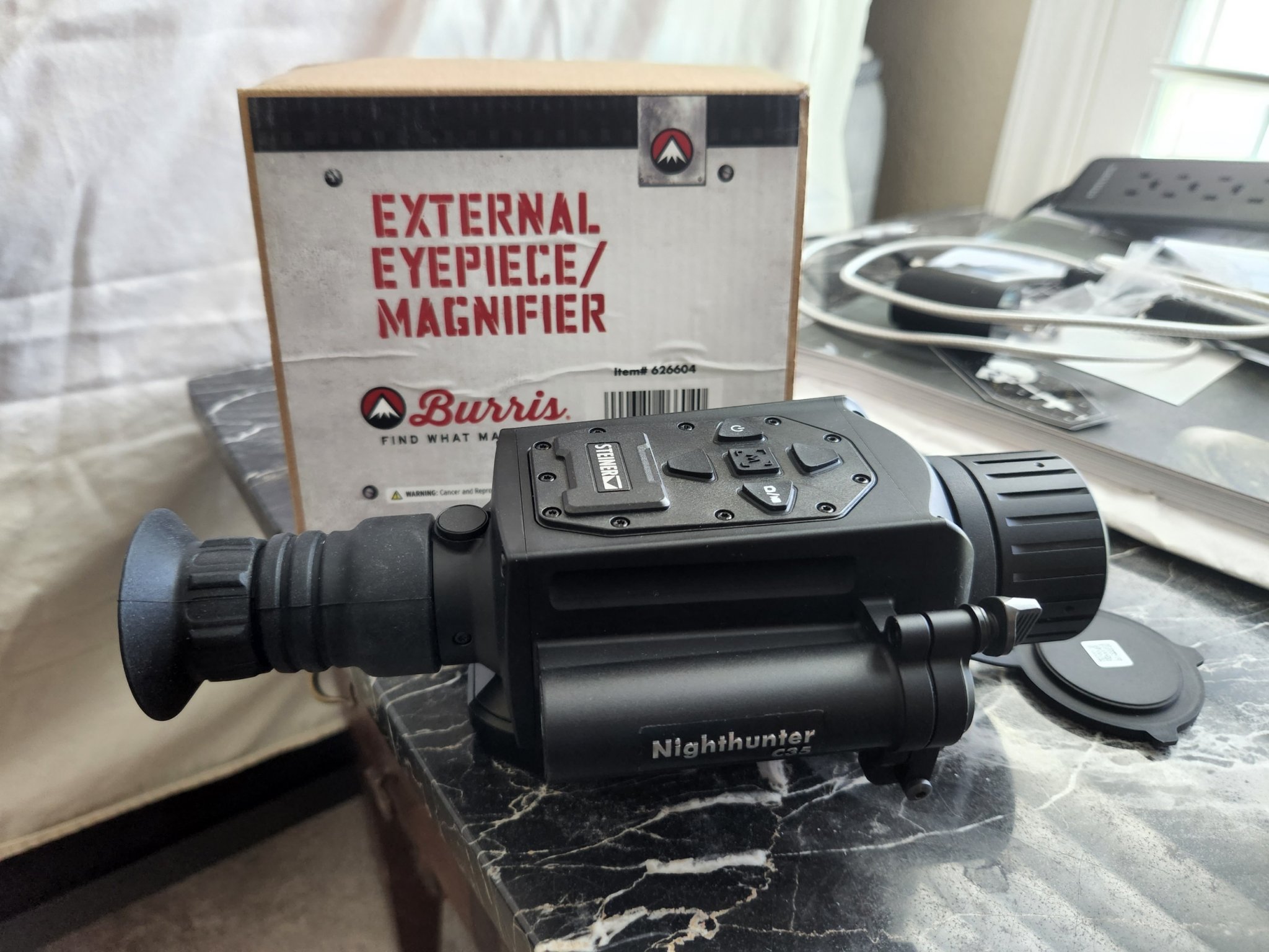

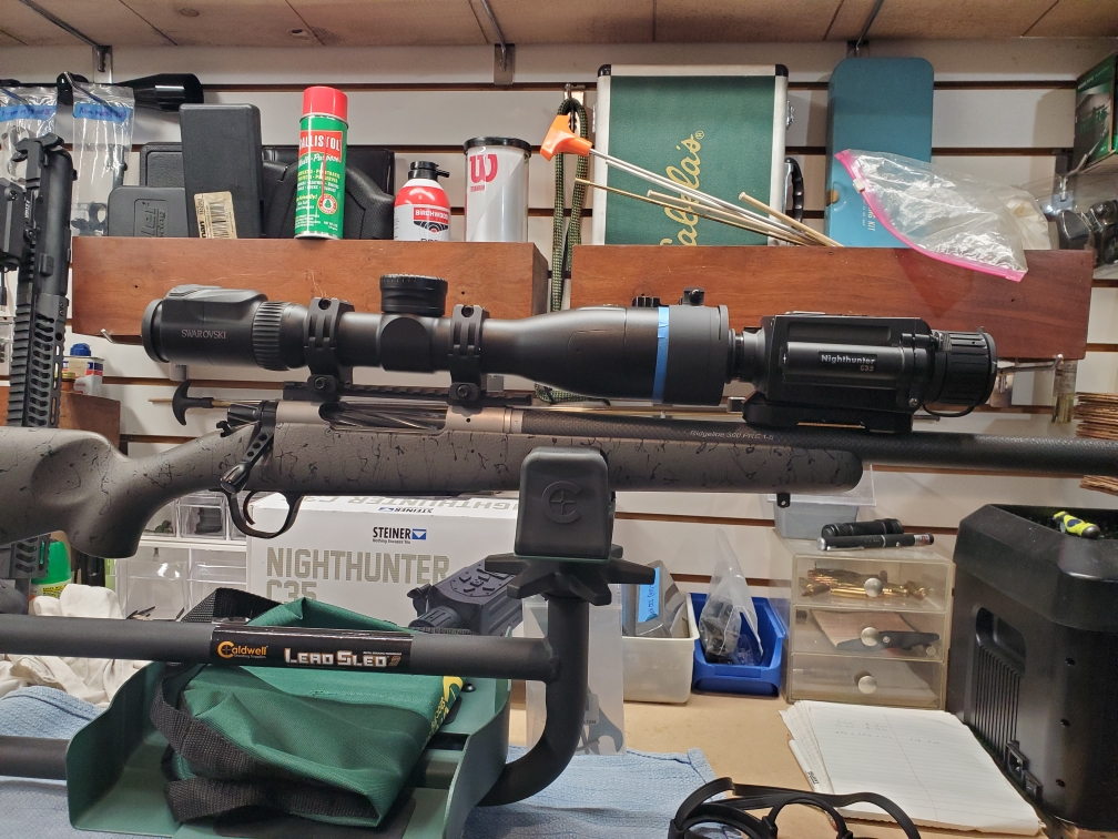

It takes the Burris Clip On Thermal Adaptors. I need to get higher rings but it works.
