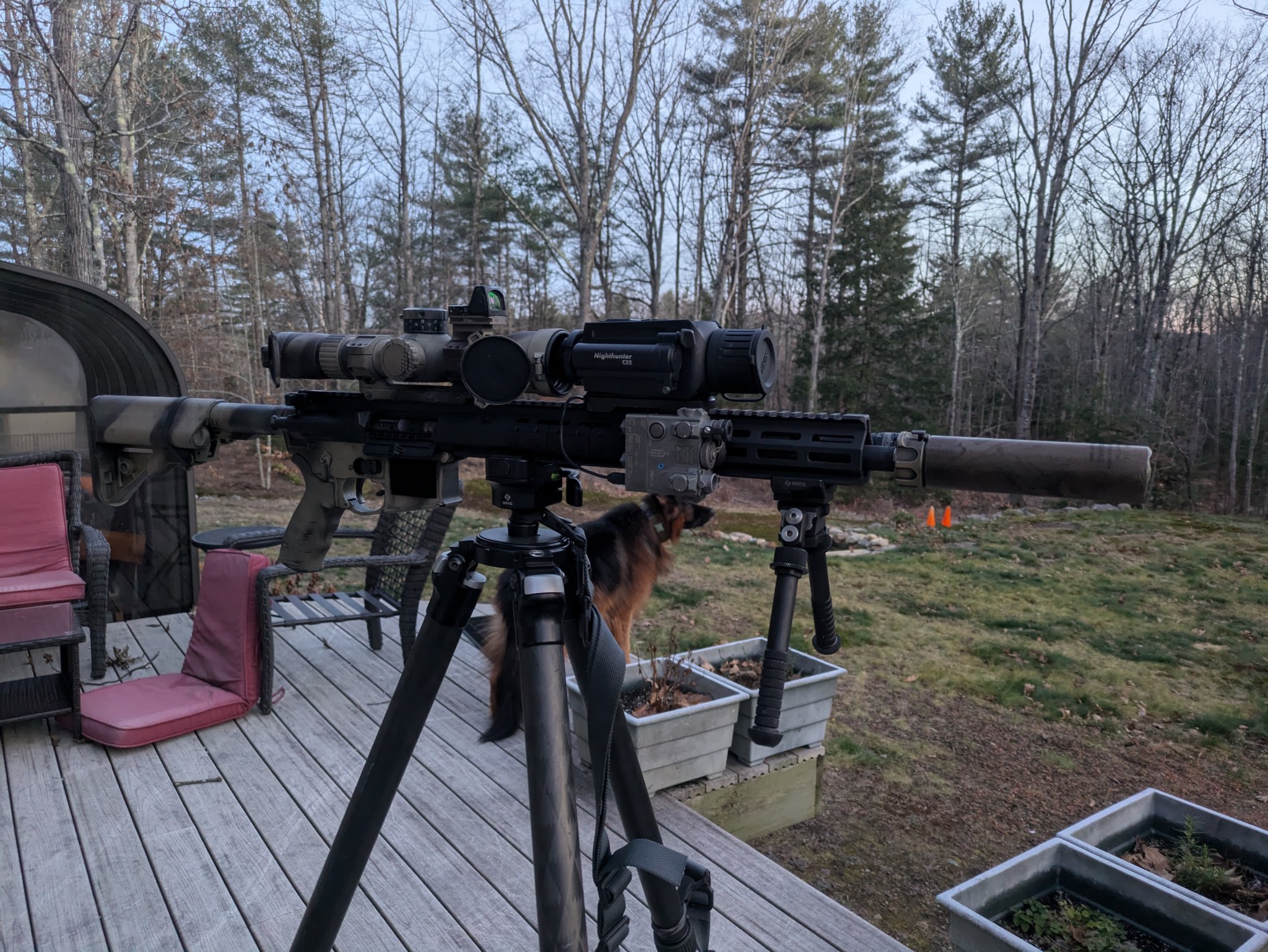

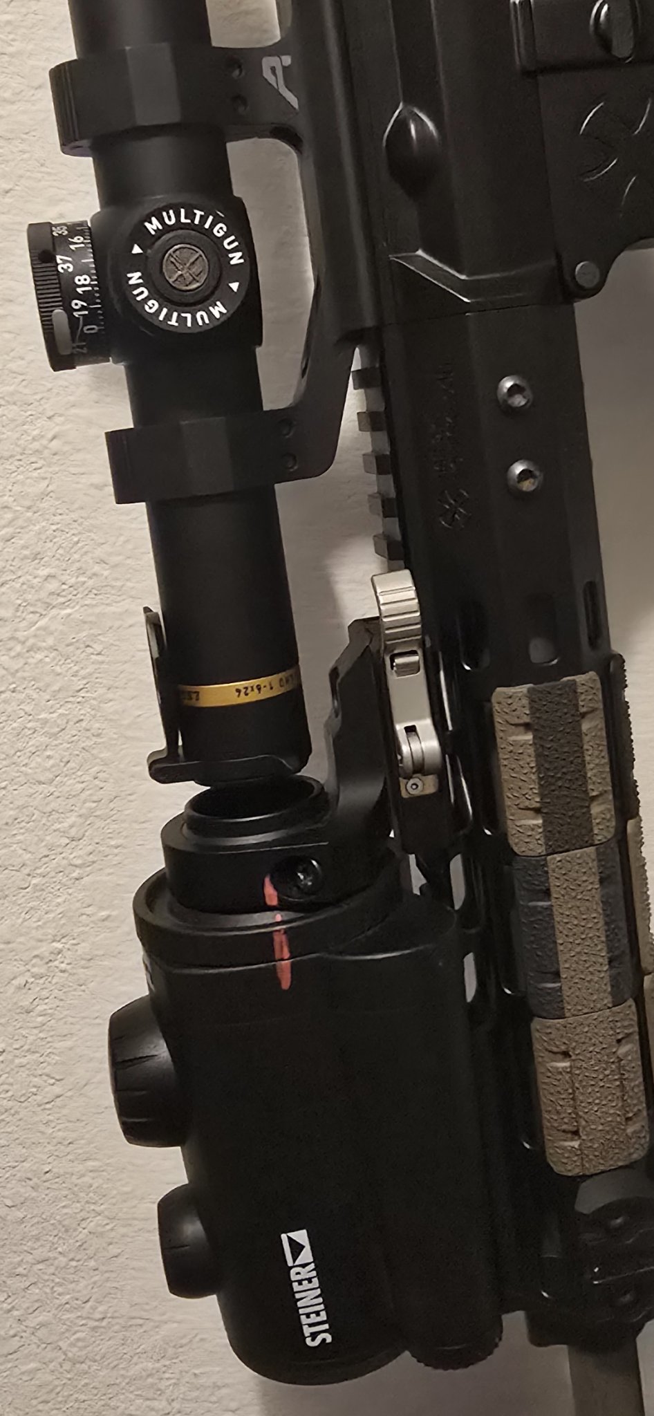

Got the temp mount in until the new one is released. Works well with the Steiner 2-12x42 which is on my 308 gas gun. My mount is 1.54" but I'll be switching over to a 1.5" with that scope.
I tried it on my POF P415 which has "optional" top pic railing. It opens up some possibilities due to there being more room for something like a flip to side type mount. You'd have to bolt it on but it'd be slick. Other than that, with a rail bolted down, my PA PLxC 1-8 is perfect with the PLX mount (1.5"). I have a One Hundred Concepts pro cap with flash hider and there is no room between the scope and the thermal. I can't tell that there's a flash hider when looking through it either. So that's the easy button
I'd likely just use the 1-8 on the 308 gasser but it's nice to have options. I have a neoprene shroud on the way as well. I'll try to get some better pics in the near future. Zooming in at 8X is not a problem at all, can barely see the screen pixels.
P415 gap.
w/flash hider in place
Gap without flash hider. If I clearance the mount, ever so slightly, I could get it flush.
Curious how this works, Guide’s new 1280 clip on seems to use a similar mount but I don’t know if I’d want to hang all the weight off the ocular?
I have wondered this myself how much flex could happen under recoil. The gen2 is a lot less weight than gen1 but it still seems awkward to have to hold the whole unit in place from one end.
Reactions: rlsmith1
The threaded ocular is actually fairly beefy. Add the adapter ring that screws over the top and it's pretty solid. But I hear you, if I were to design something. I'd at least have some sort of rubber foot support underneath at the front. But most of the weight on the Gen2 is at the back, not out front. Anyway...this is just a "I'm impatient" and want to get a mount. Waiting for the aftermarket mount, specifically designed for the Gen 2, to be released. Also...the scope adapters do the same thing, it's all on the ocular. But as is, it's definitely usable and actually kinda bad ass.

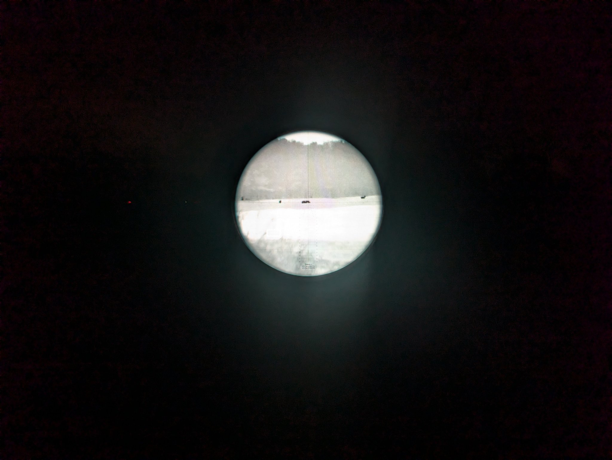

Took a gen 1 c35 out last night. My first thermal clip on. I was very impressed with the image. Easy to identify deer at 500+ yds.
I heated a piece of steel next to the wood stove all day. Then my buddy brought one that he had outside. I could easily see both even with a heavy fog, but mine stood out great.
I printed a 6" group off a tripod at 450yds with a Ridgeline upper, with a few extra that went high and to the right to turn it into an 8" group. That's with 15-20 rounds.
The fog was so bad it was almost impossible to use I2 night vision. When it got that bad, I lost all the terrain features from the thermal but still easily saw the targets.
The gen1 is a great tool for your kit. I anticipated it being bigger and a brick but compared to a Pvs27 or 30, it was smaller and lighter so color me happy.

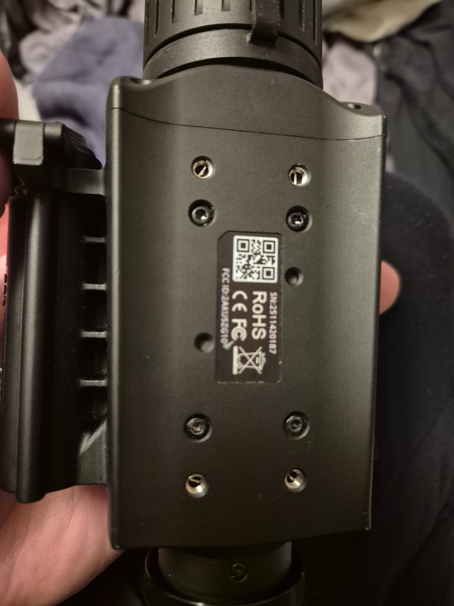

Are the holes in the euro c35 the same mounting holes as the us version? If I cant get a hold of a mount somewere.
I will try to fabricate a alu baseplate with a adm style mount to it. Have some rusan ocular adapters on the way bit would rather have a solid rail mount.
Yes they are the same, If you are able to source a oem mount it screws right on there in seconds.
