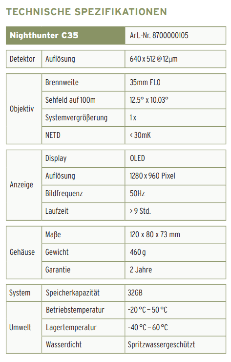

460g (16 oz), 12.5 deg FOV (sounds like 640 sensor), HD screen (1280x768), 3,000 euro which is pretty close to $3,000!

Pulled from the gen 2 manual below. 640 sensor with 12.5 deg FOV so 53.3 pix/deg, not bad at all. Just wonder if its still a chinese core.

The weight of the Gen 2 is listed as 460 grams, so that is a significant reduction compared to Gen 1.
Sensor resolution and pixel pitch have stayed the same 640x512 @ 12 um, but NETD has decreased, supposedly below 30mK now (50mK for Gen 1).

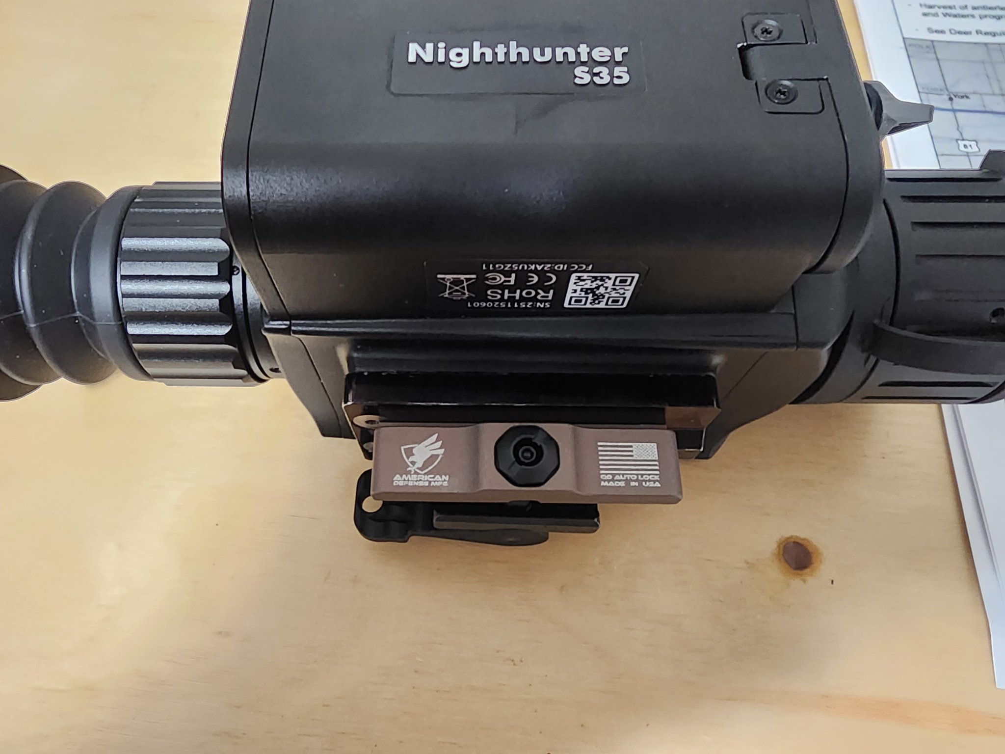

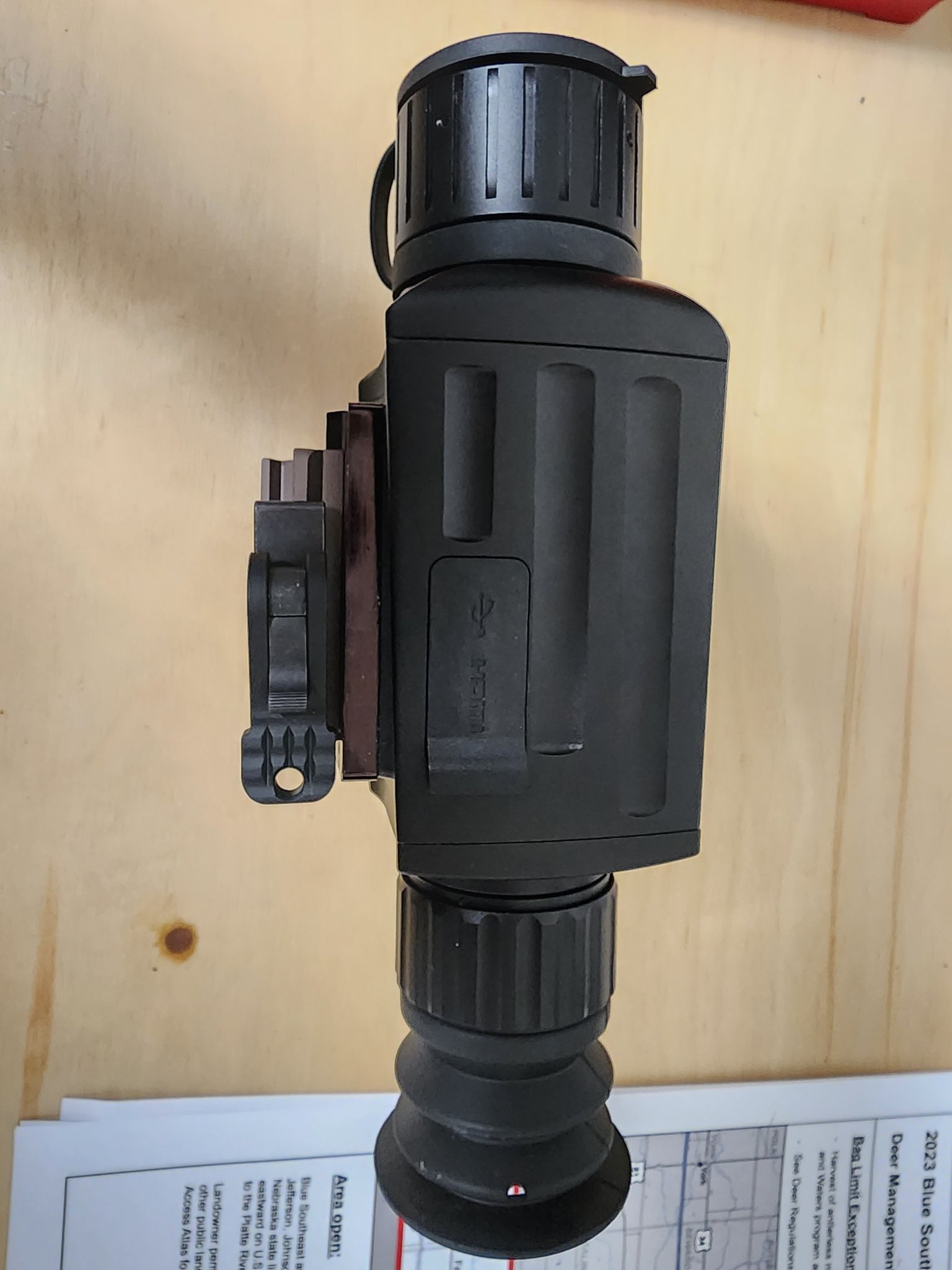

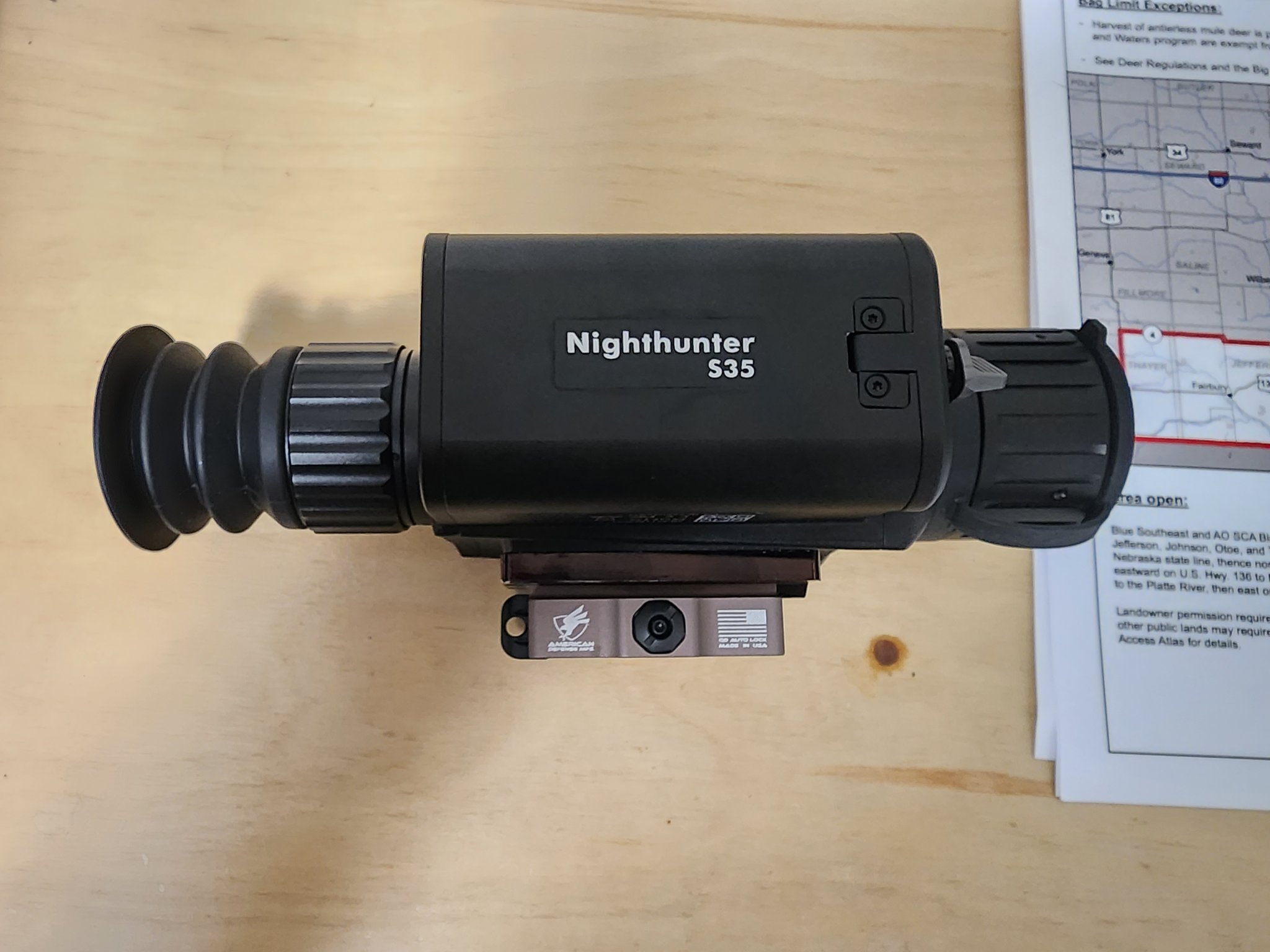

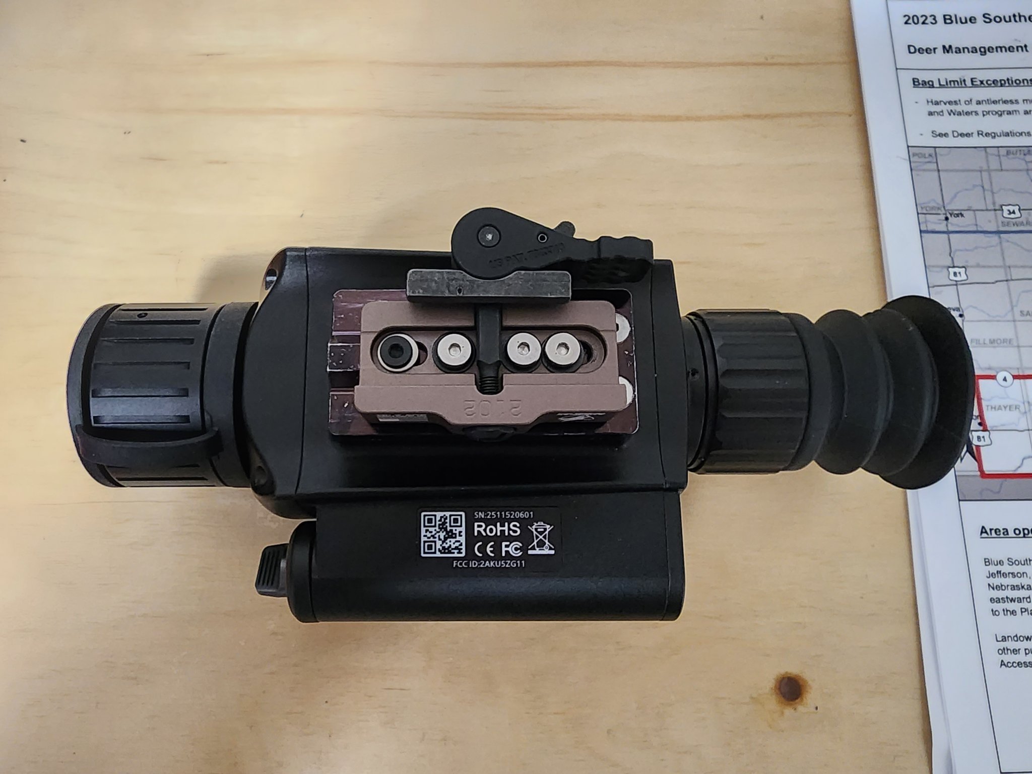

I've been designing/testing the beta versions of a mount adapter that adapts the S35 mounting system to an ADM mount. Other than moving everything forward to bias the scope to the front of the ADM mount, I think I've got everything else figured out. I've used my prototype a few times now and everything seems to work nicely.
I've been using xometry to get my one-off parts. If anyone knows of a shop that can make these for a decent price, let me know. I'm tired of paying 200$ a piece after 3 or 4 iterations.
