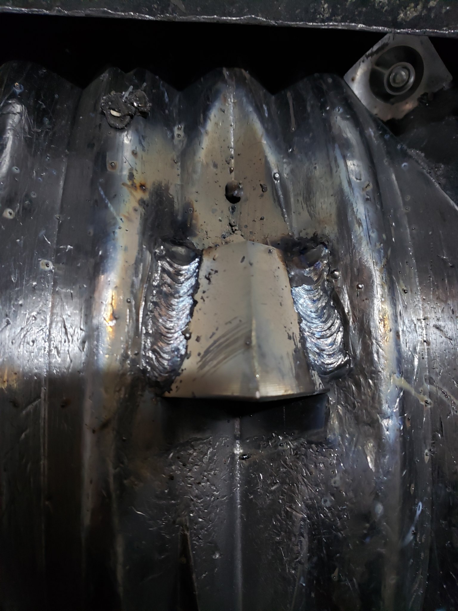

What is it?
It's a holder for a 40mm sq cutter. 72 of them in an average shredder. When customers are dumb and run large pieces of metal into a shredder setup for document destruction they either get torn up, bent, ripped off.
150 to 200 hp motor turning a 5' to 6' long rotor about 16" in diameter at 120 rpm.
Cutter engages a bed knife.
They have to be cut out and welded back in within a 1/16 for proper clearance. Root pass 7014 then 3 with 7018 and a cover pass.
All in a steel box the size of a vw

Ahhhh, gotcha. Haven’t looked at one of those up close before.

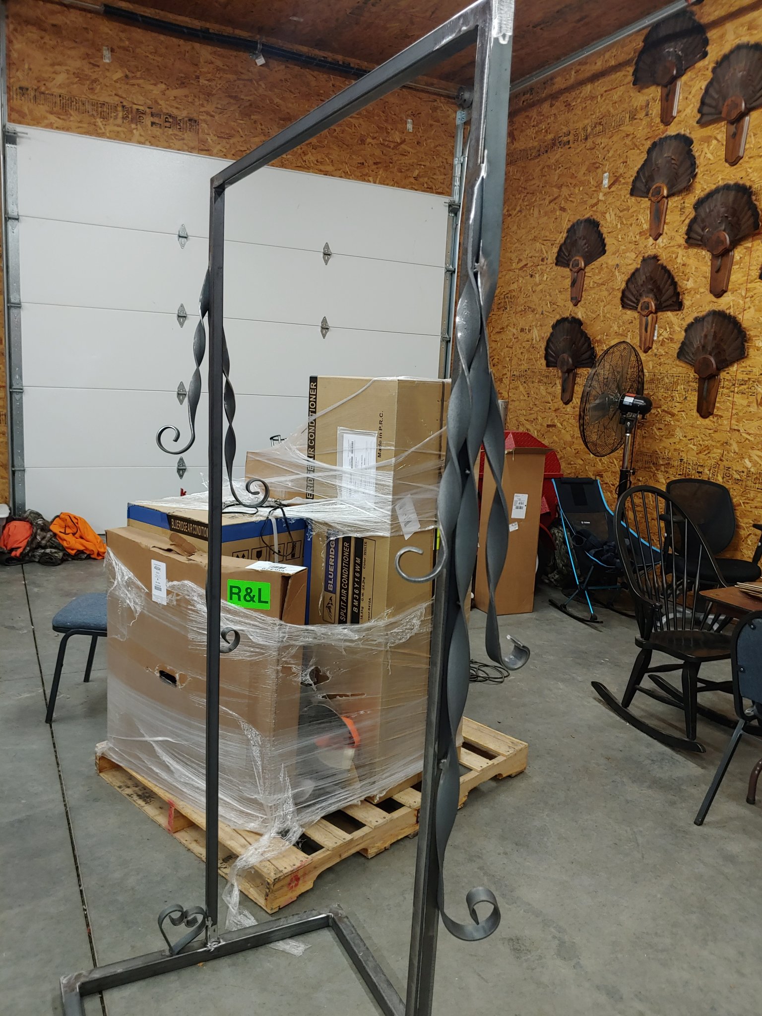

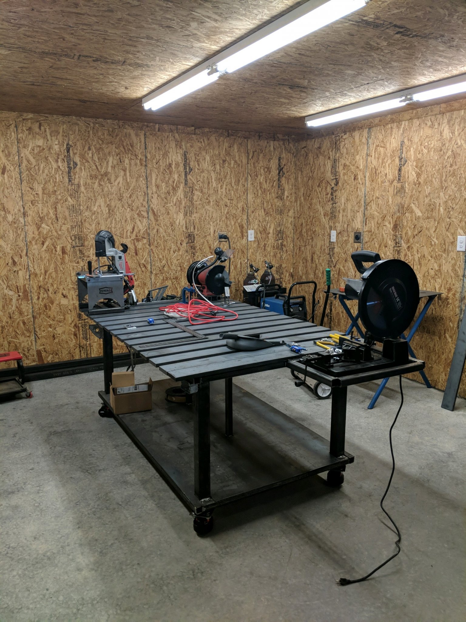

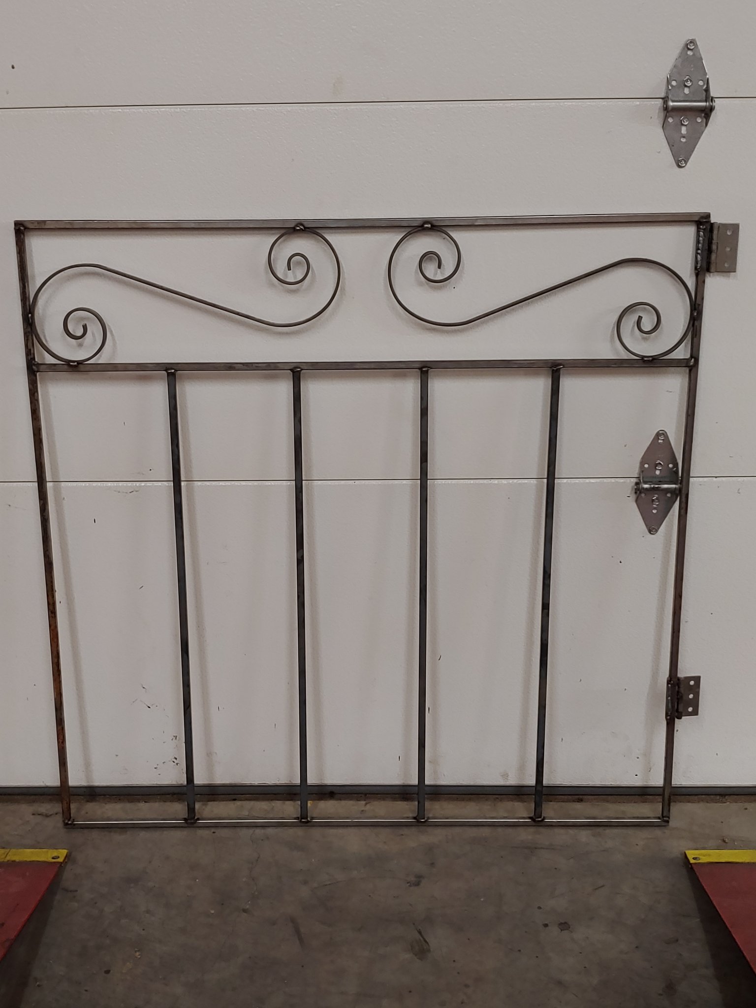

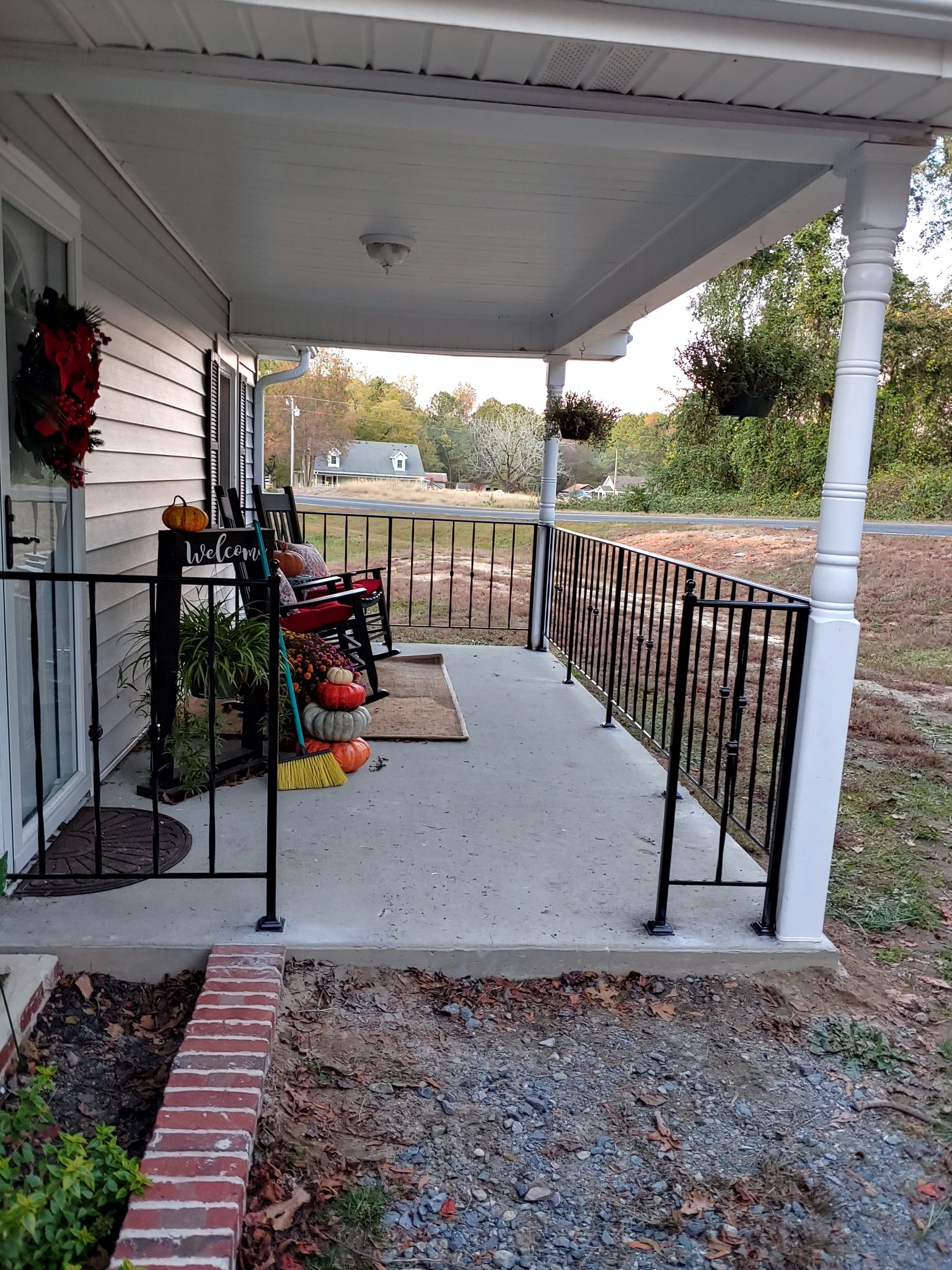

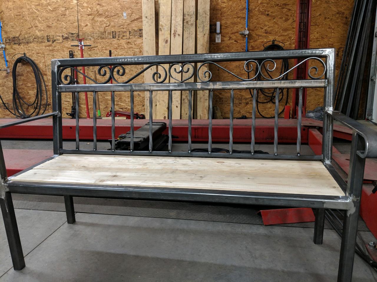

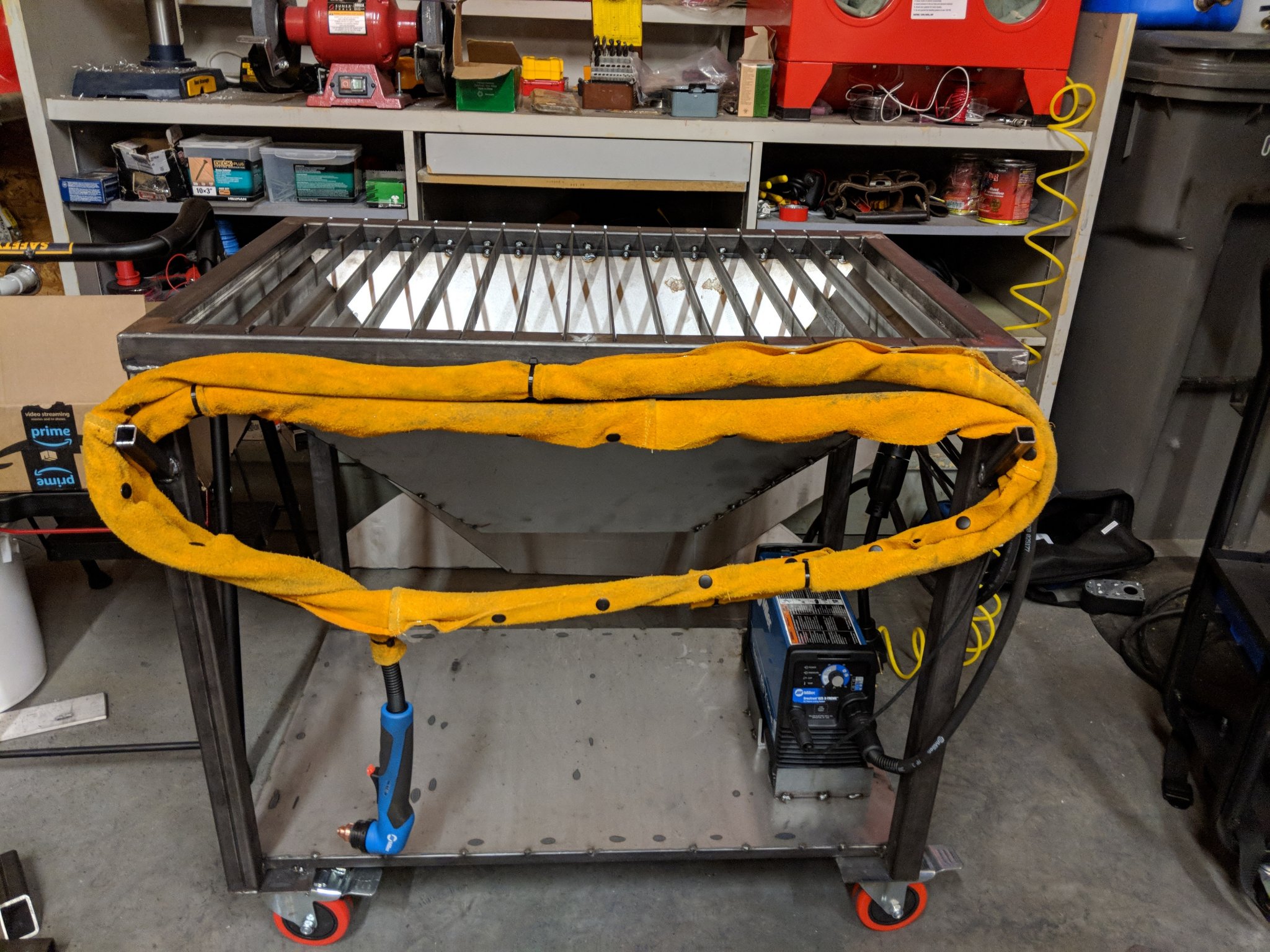

I enjoy metal. work. Decided to but a Mig/Tig machine and a plasma cutter about 3 or 4 years ago. I have always done enough dirty farm welding with stick to get by when I had to but I wanted to be able to make stuff easily. I am completely self taught, just started welding and the more you do the better you get. Here are a few recent things from the last 10 months. One of the best things I have ever taught myself to do. There is always something to be done with a welder and plasma cutter around the shop and farm. I really get into fabbing things and have all kinds of stuff around here I have made.
Gate for barn fence here at the house
Plasma cutting table
Bench for the wife
Fabrication table on wheels for my chop saw and small parts saw

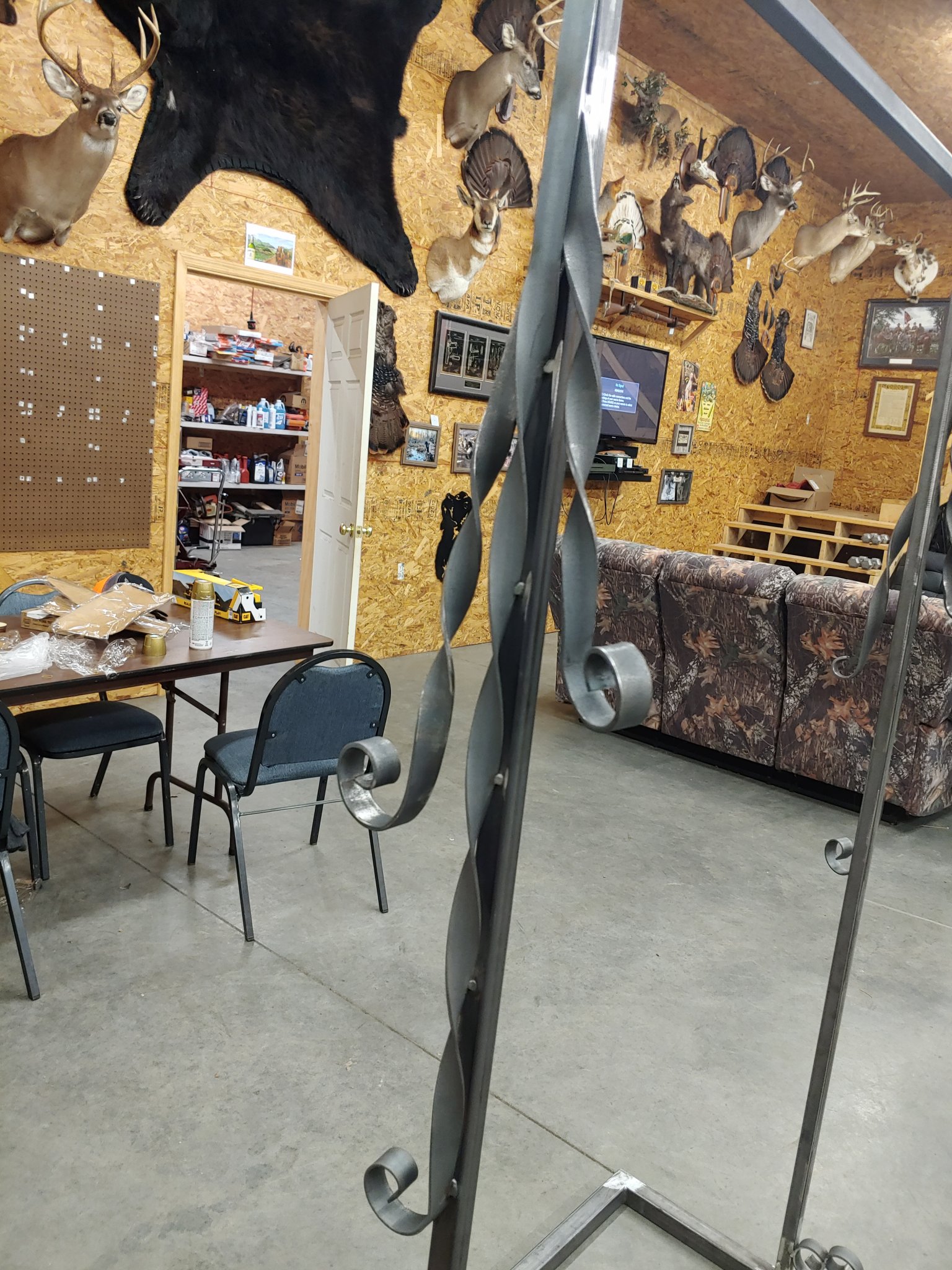

Decorative porch rails for my daughter with twisted pickets

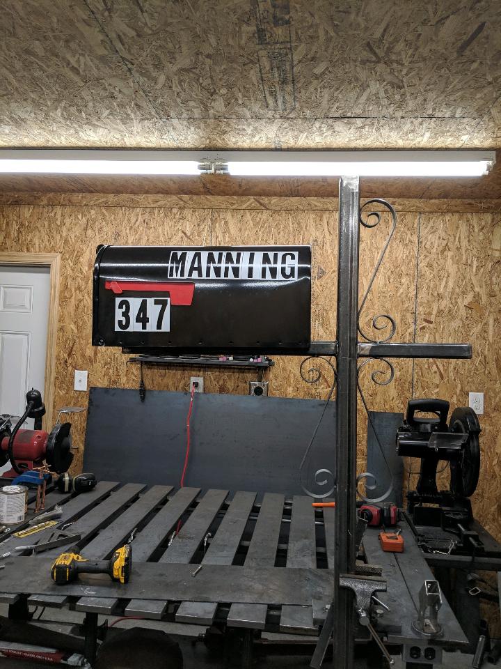

New post for the mail box

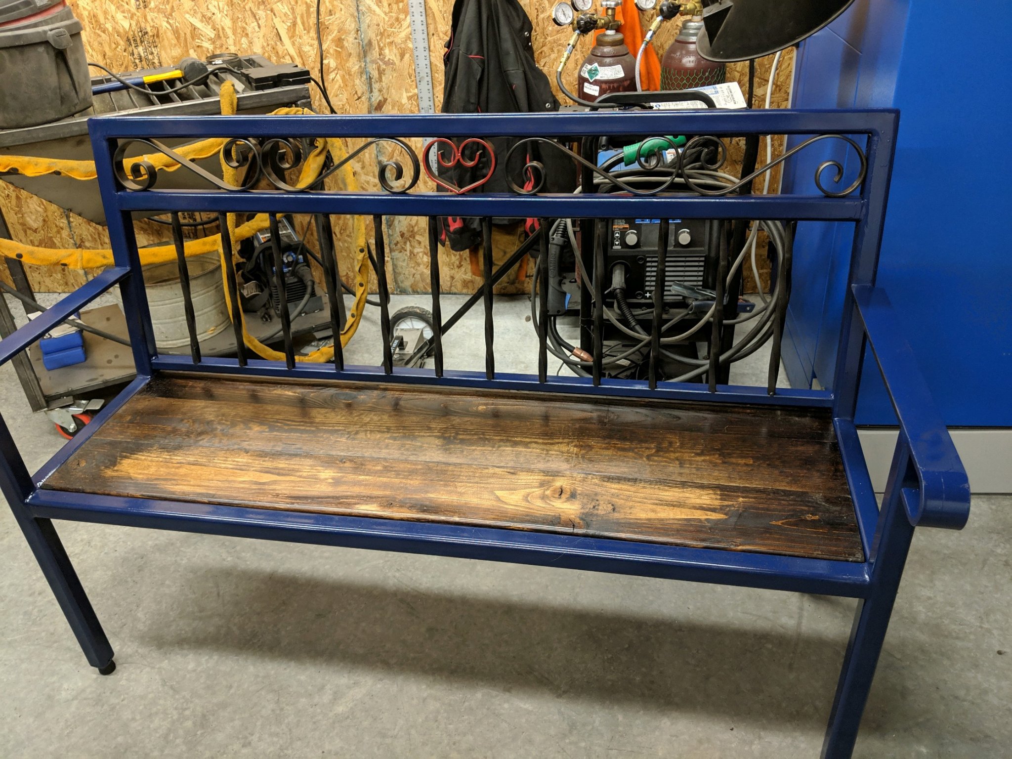

I do. I have an ornamental bender and roller that will bend up to 1" flat for decorative and twist up to 1" flat and 1/2" square. I built a press bender for heavier stuff like the arm rails on the bench out of a cheap bottle jack press. Works well. The ornamental bender will do all manner of scrolls, circular bends and twists.
Bench after paint and stain

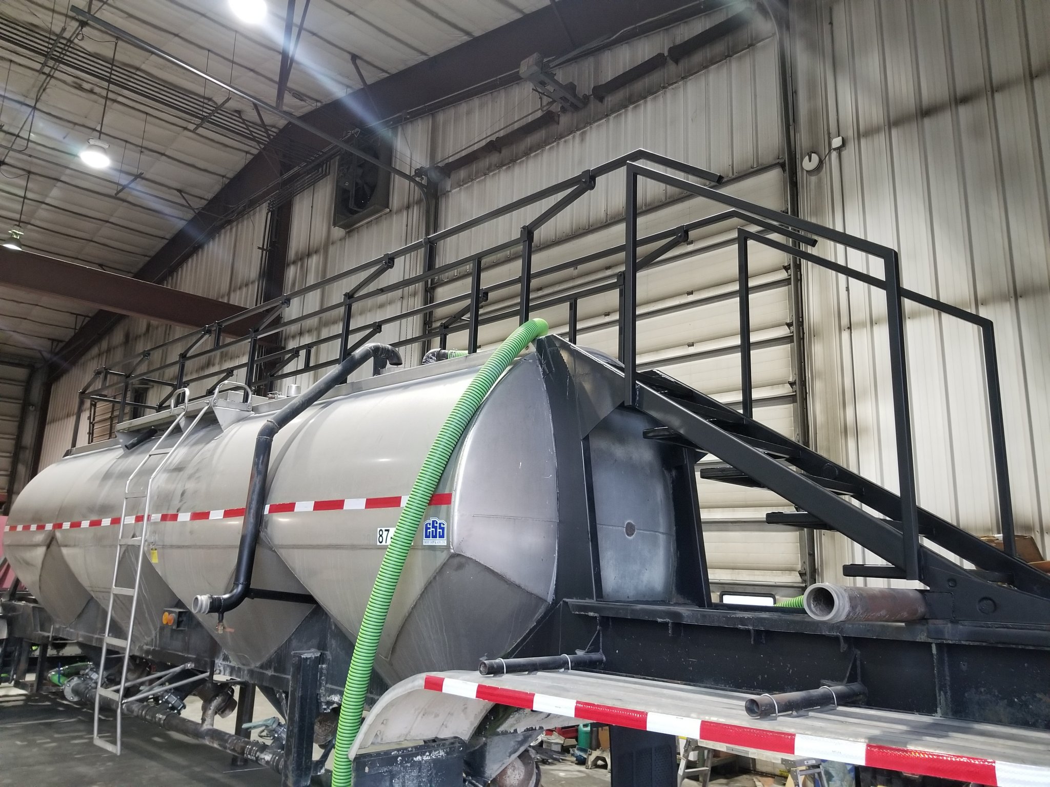

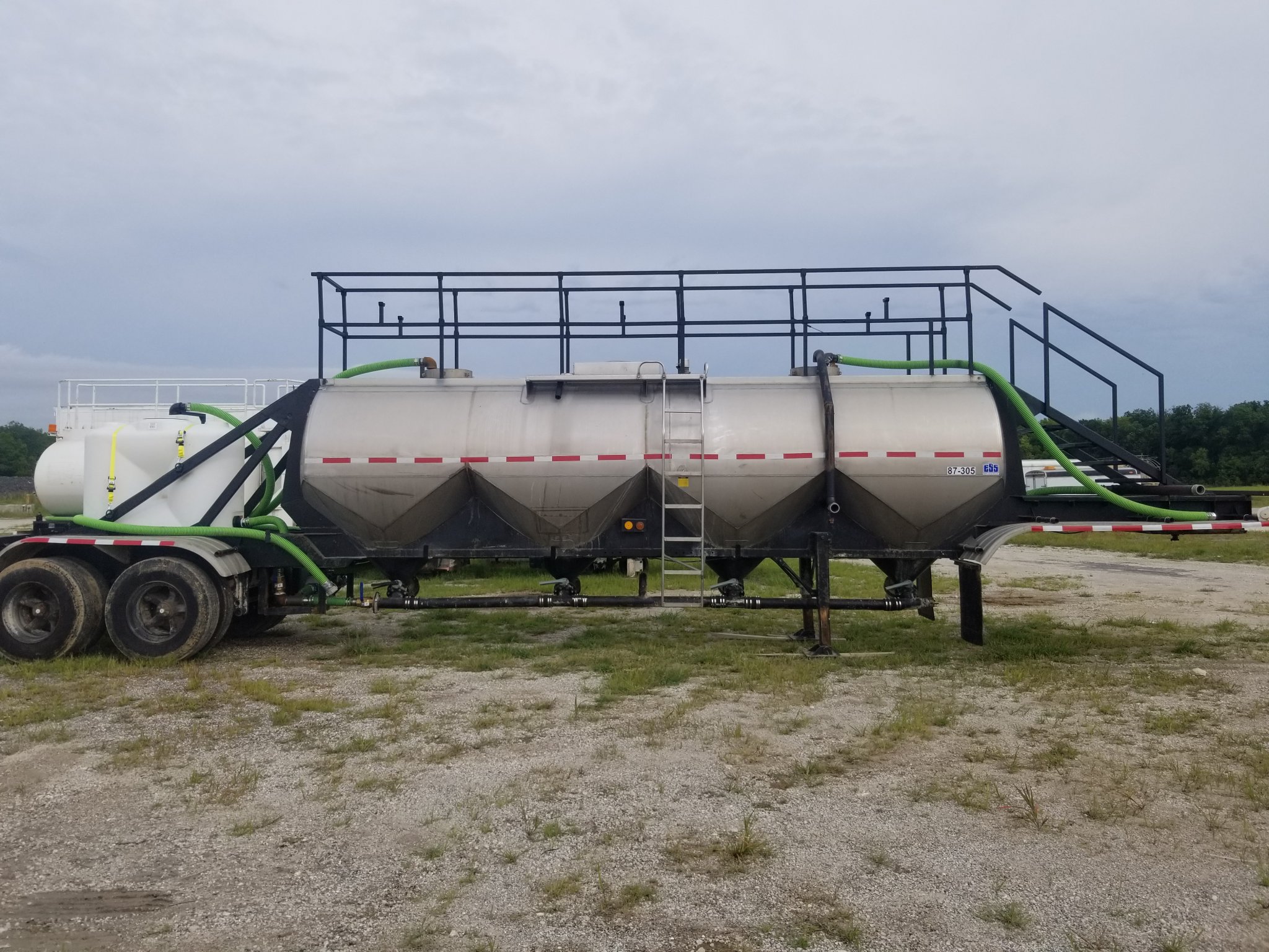

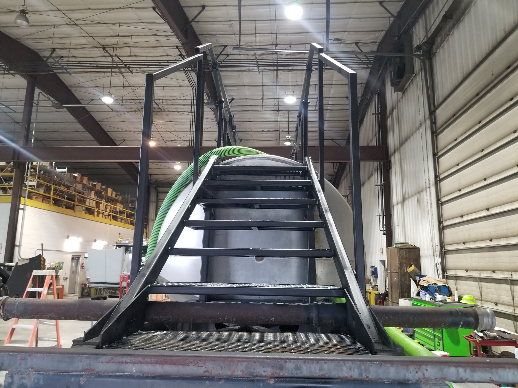

I was going through some pictures on my computer and don't think I posted this project. I built the hand rail and stairs on this slurry trailer so it would be safer for the truck drivers. I made the top rail collapsible so it would be under 13' when folded down. Fun project but took longer than I would have liked because the shop bandsaw sucked so I cut everything with a portaband and drilled all the holes by hand for the hinge points.
How does it secure in the up position....pins? I assume the trailer is aluminum....how did you attach the uprights to the trailer? A lot of skill getting all that square without jigs. Good looking work.
Thanks, I really enjoyed projects like this. It's a stainless trailer so I welded the uprights to the trailer. The top railing has a strong gas shock that assists in raising it and it has a stop to stop it at 90⁰. I originally had two shocks on it which made it raise very easily but it was everything I had to pull it down. I wanted to run a pair of air cylinders but they didn't want to spend the money.
I used squares from Fireball tools to square up everything. If you do any fabricating, they aren't cheap but worth every penny.
You use cast or aluminum? Whats your most use square from them? You are getting ready to cost me some money:)
I used the 8" cast iron. The 90⁰ triangle was my most used but the second link is handy for when the other wouldn't fit inside of the part. They are like an extra set of hands when trying to hold something on a mark to tack it. I tried various magnets and didn't really like them.

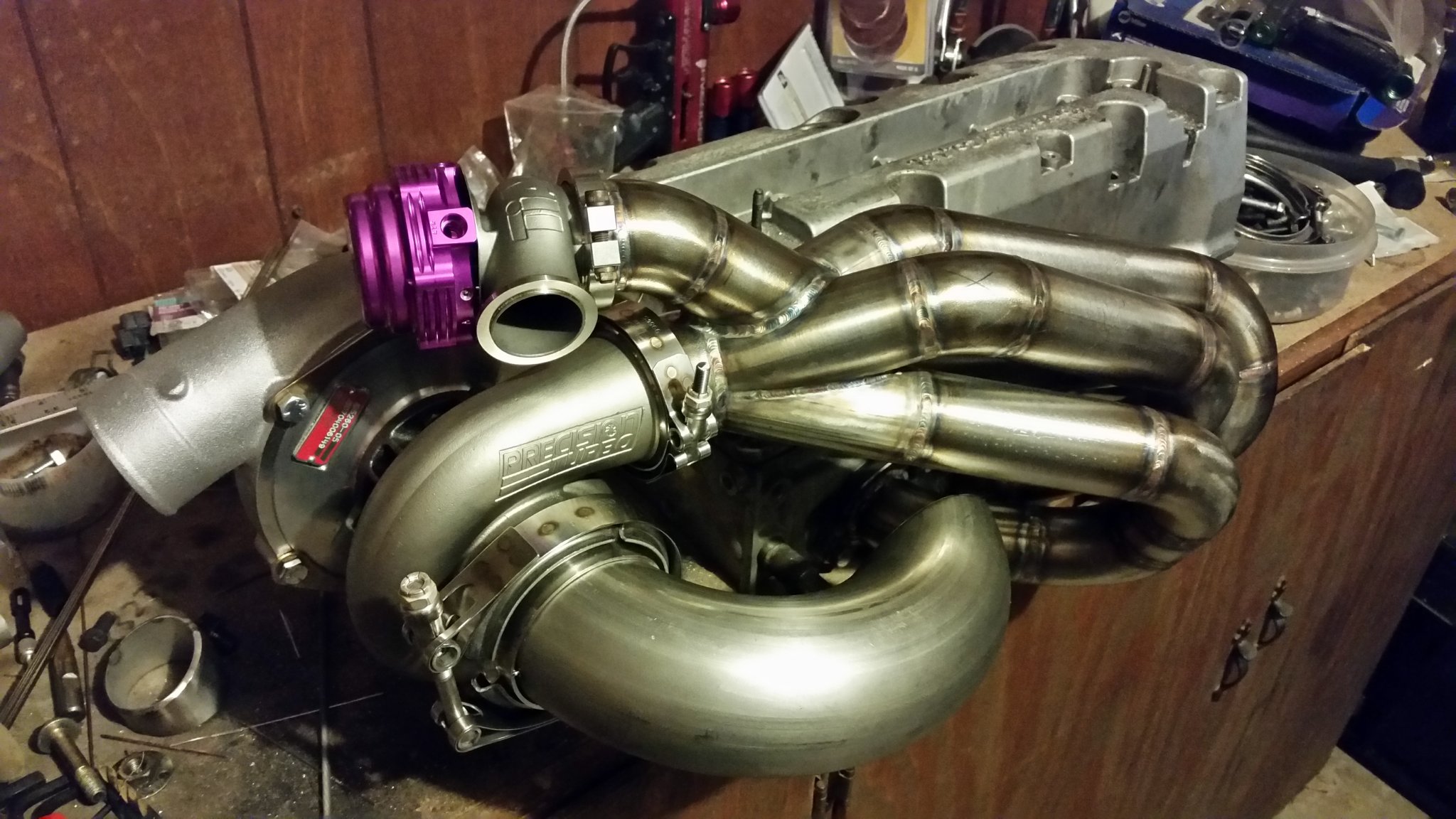

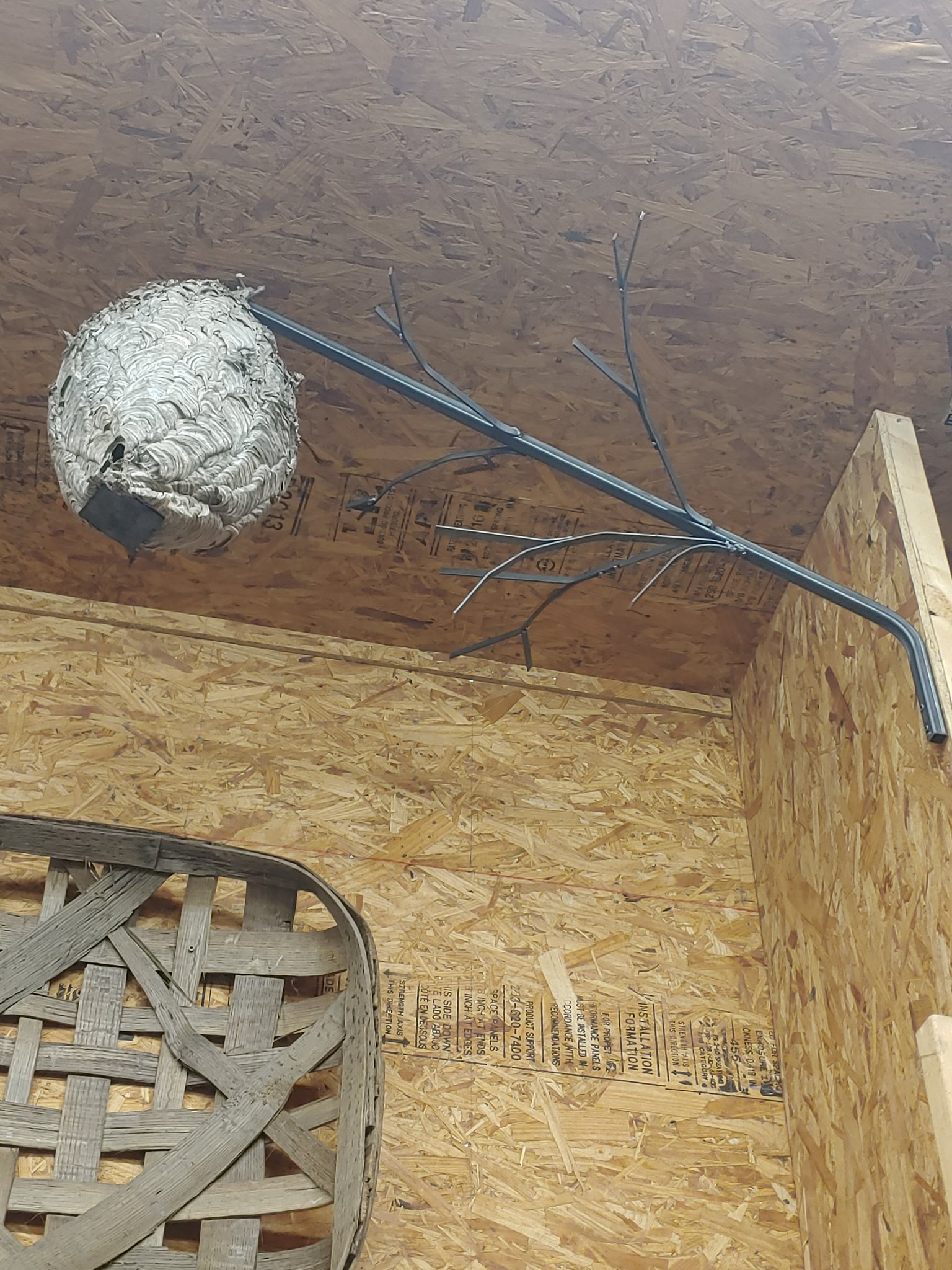

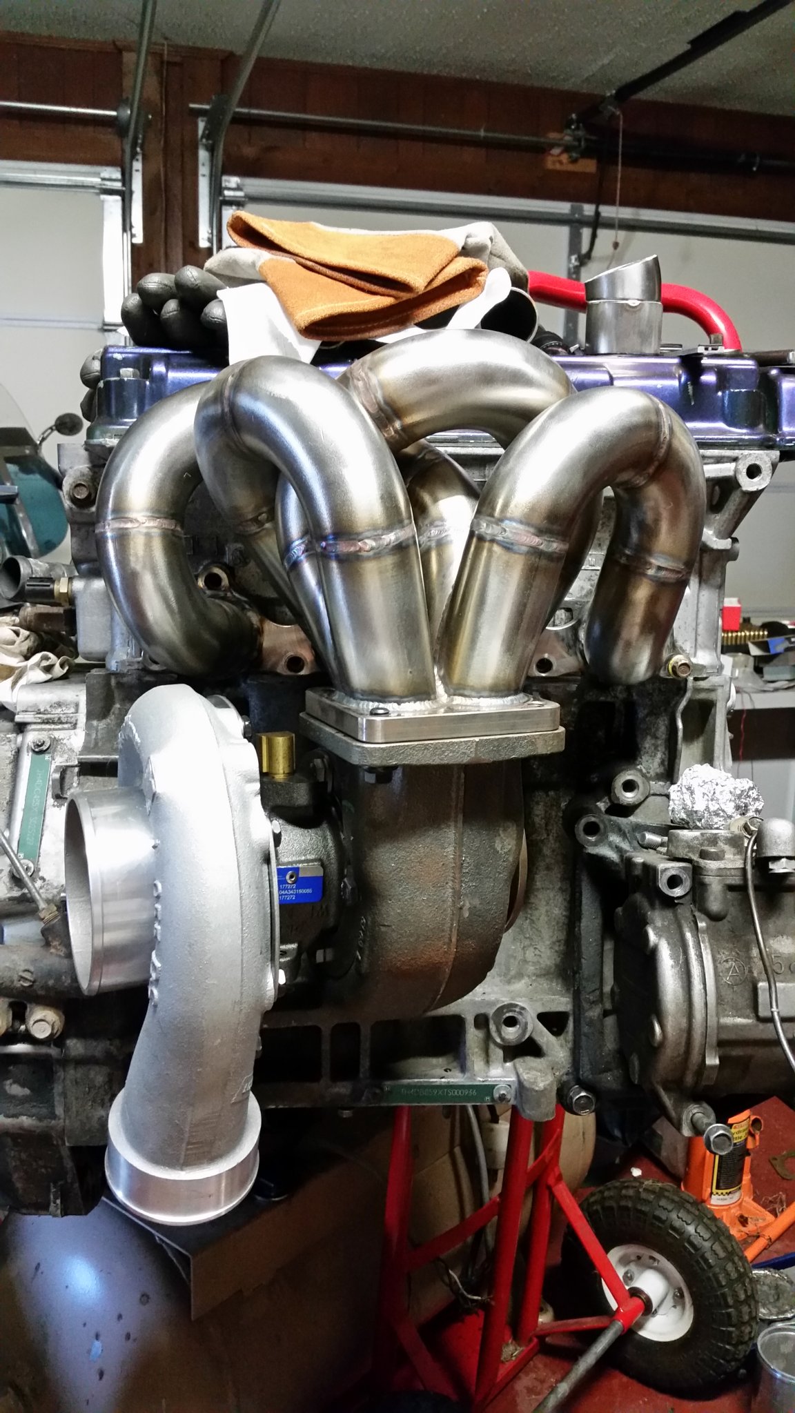

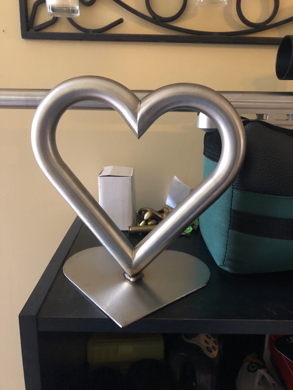

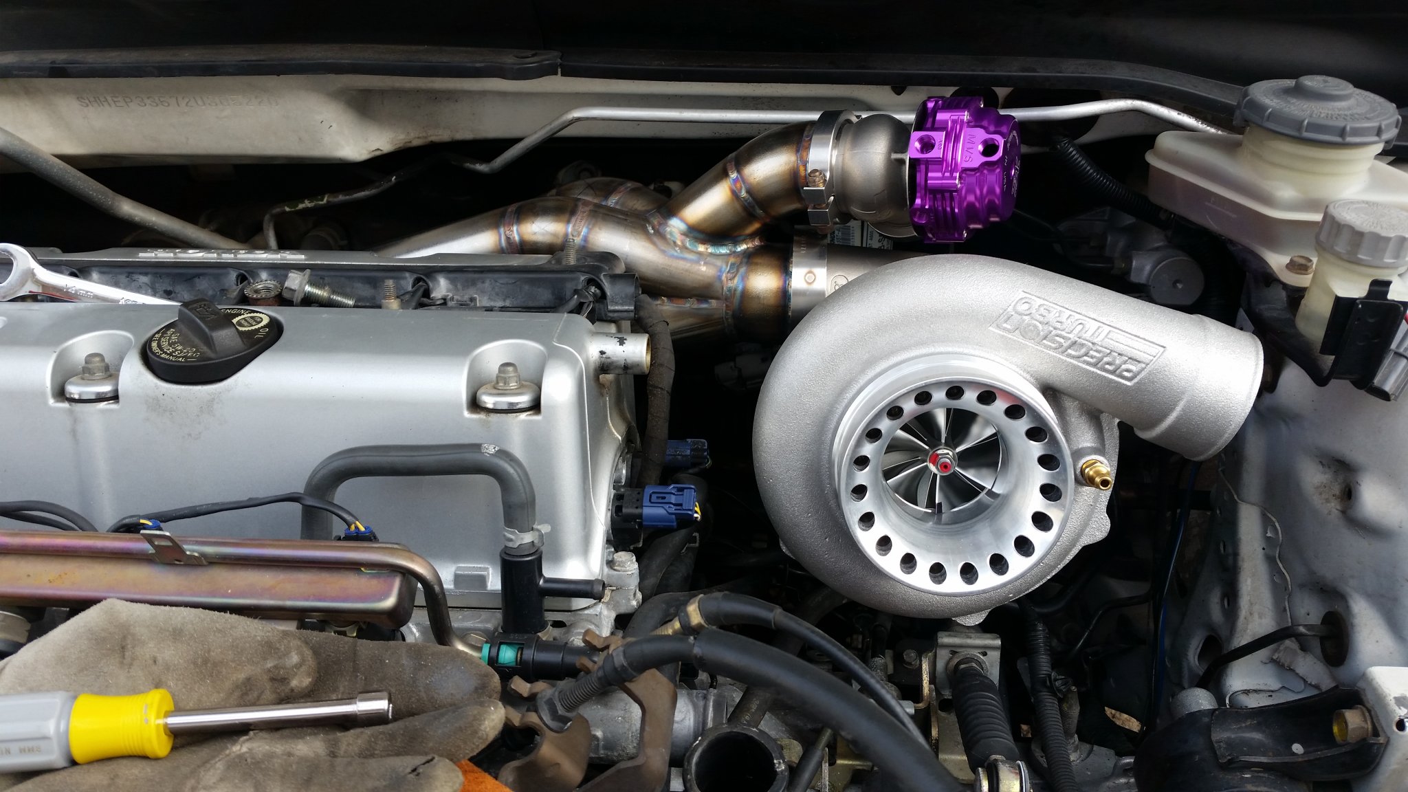

I can't run a bead around a round tube to save my life, but I still love building turbo manifolds. I'm much more fitter than welder.. The last one was a recent project for the wife that sat in the foyer for two days before she noticed.View attachment 7246602View attachment 7246605View attachment 7246609
Some of the welders for the exhaust systems are in a whole different league than most. Your work looks good, I haven't done much tig so I know I can't do that well. I was planning on buying a tig until I had breathing problems. I really wanted to try to get to where I could fab and weld cages and different suspension parts.

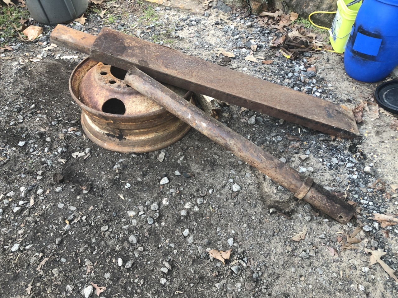

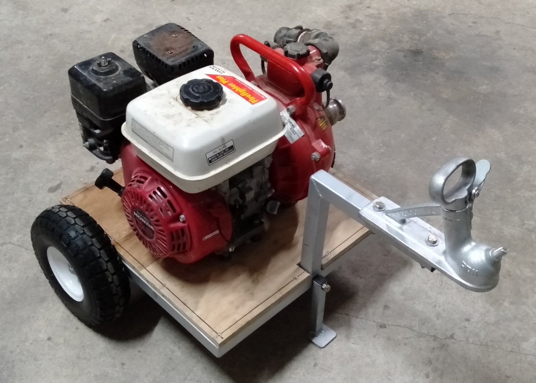

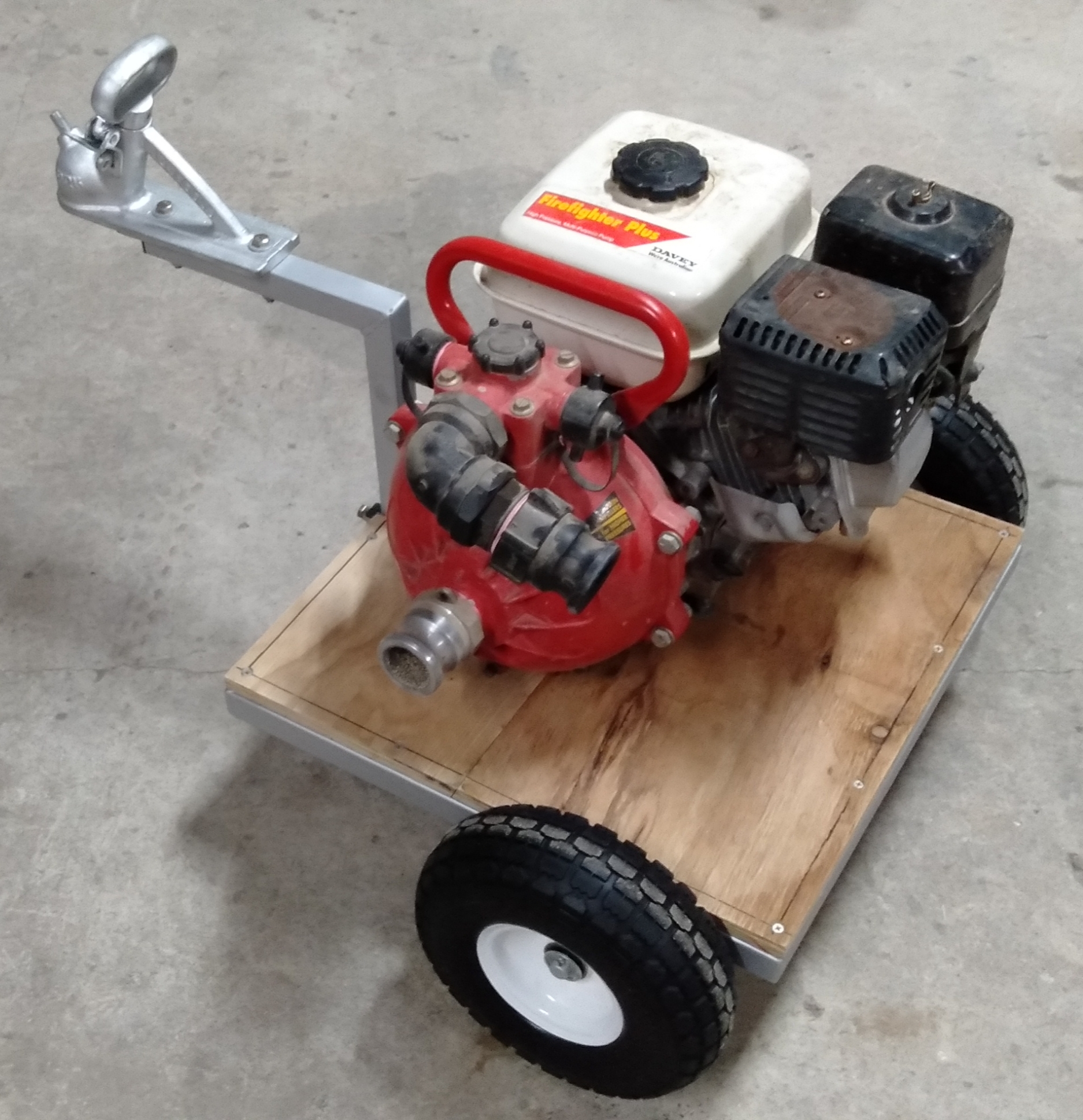

Thought I'd help the old man out with building this tiny trailer to get his water pump around the farm and save him from lifting it on and off the trailer. Haven't welded in years but it's like riding a bike.

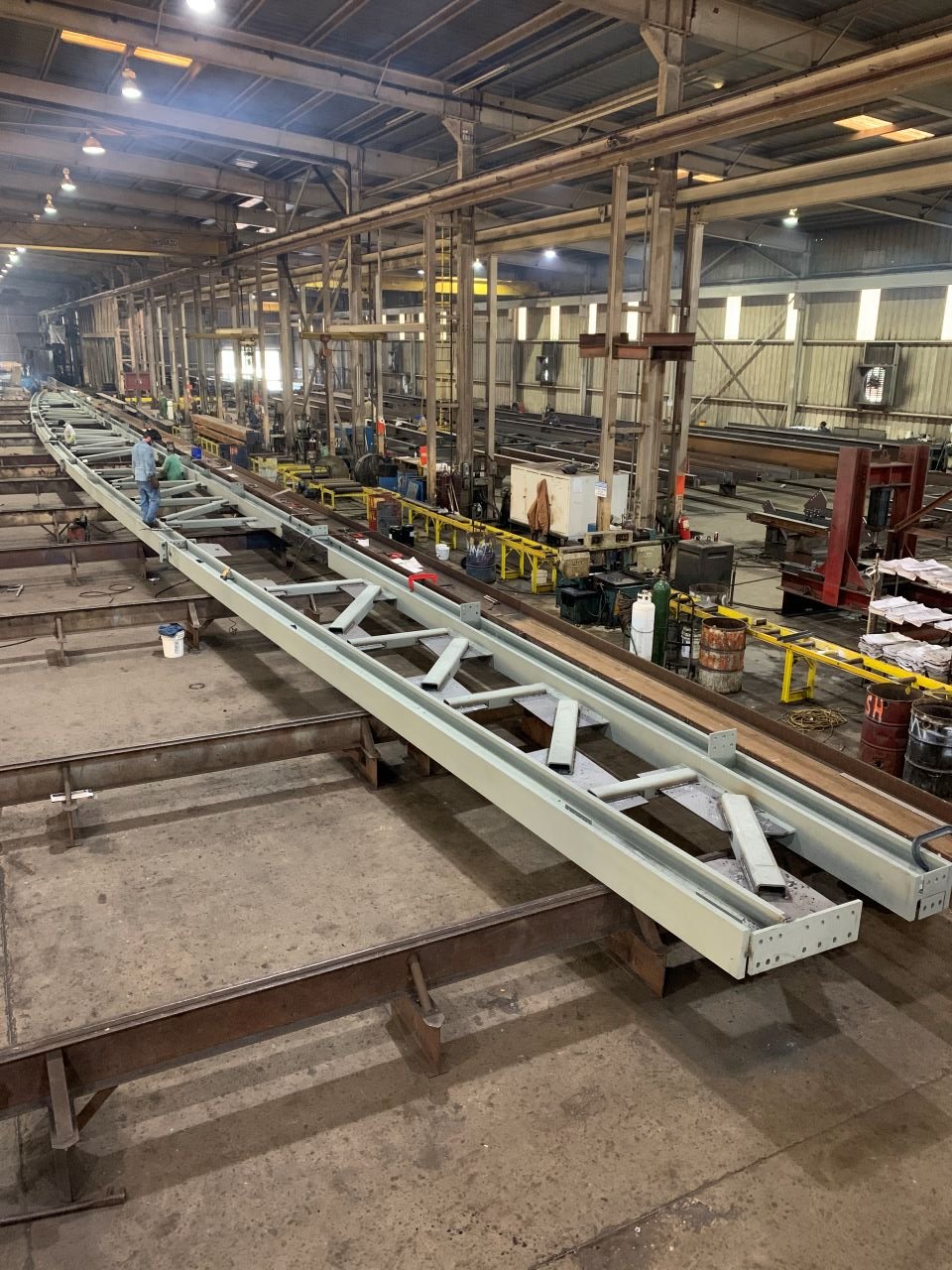

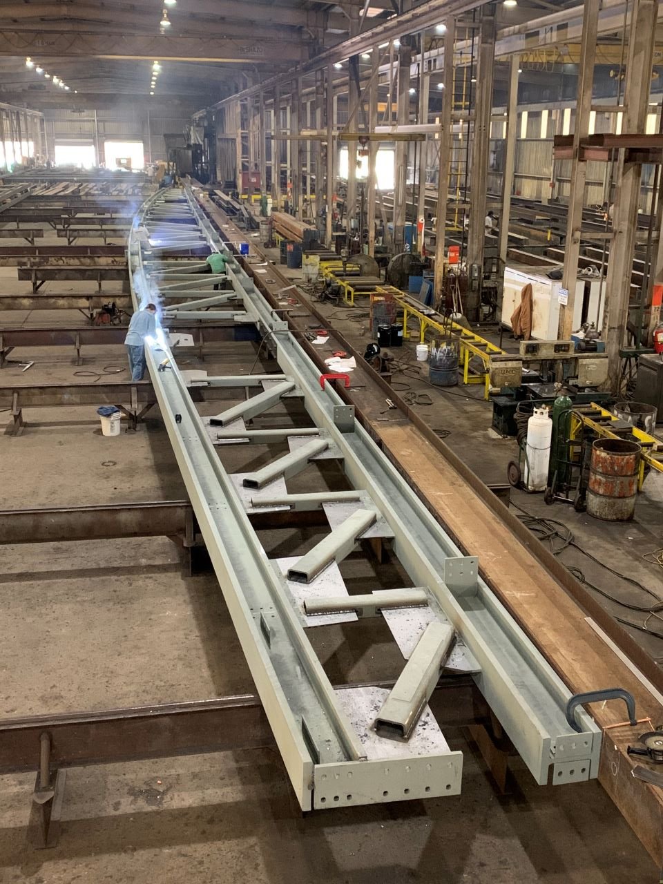

As I've said before, the vast majority of the stuff we do is pretty boring....beams, columns, frames, etc.
We've had a couple cool projects come through the shop recently. This happens to be a hangar at a military base in Maryland. Most of the framing is pretty boring, but here are some photos of the trusses.
The "smaller" trusses are 220' long and 10'-6" deep midspan with 9-3/4" of camber. The larger trusses are 220' long and 17'-0" deep at midspan with only 2-3/4" of camber.

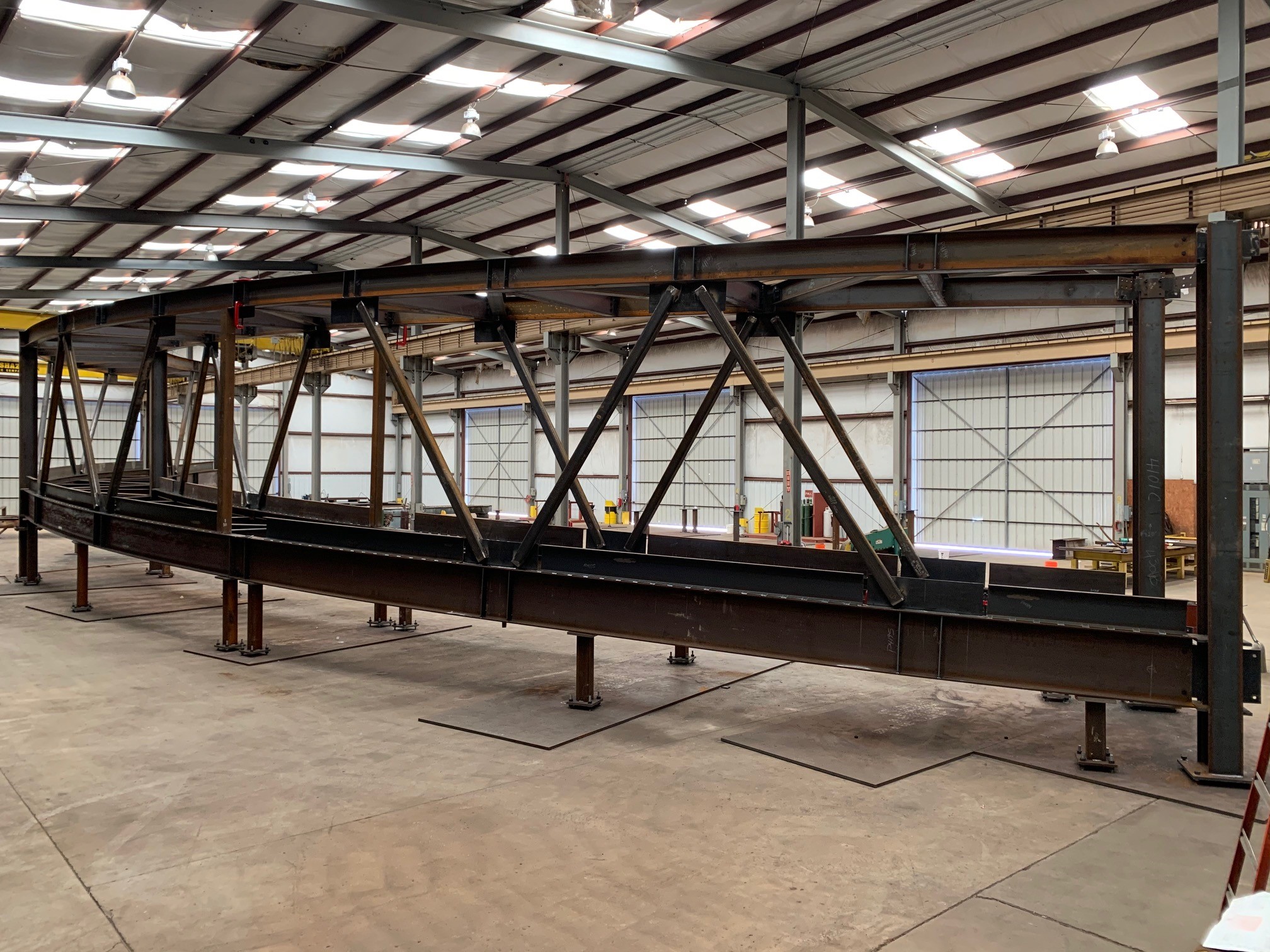

Next up, I have a pedestrian bridge headed to the University of North Carolina Medical Center.
It is really cool because it curves. I will share photos once it is mocked-up in our shop.

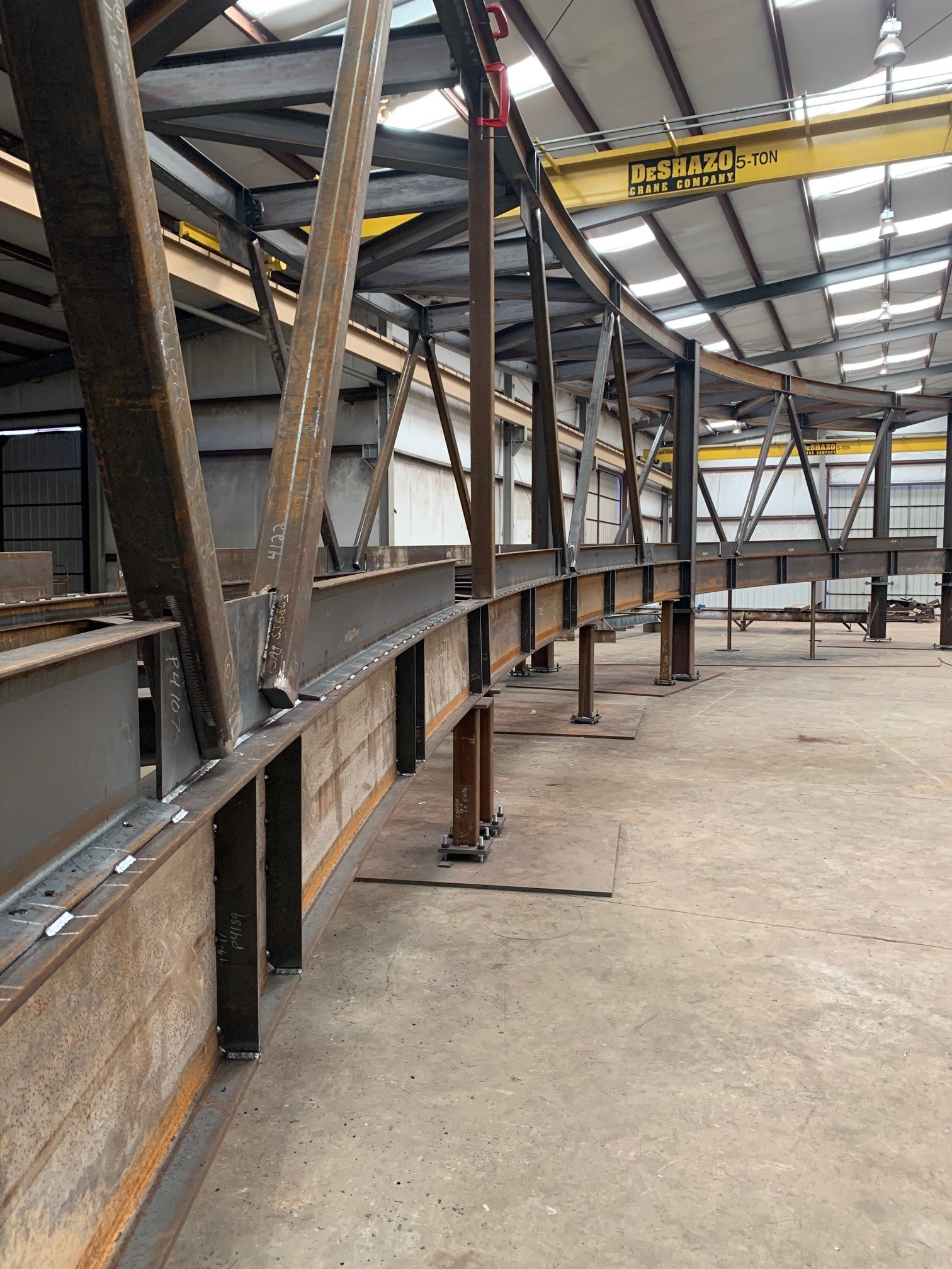

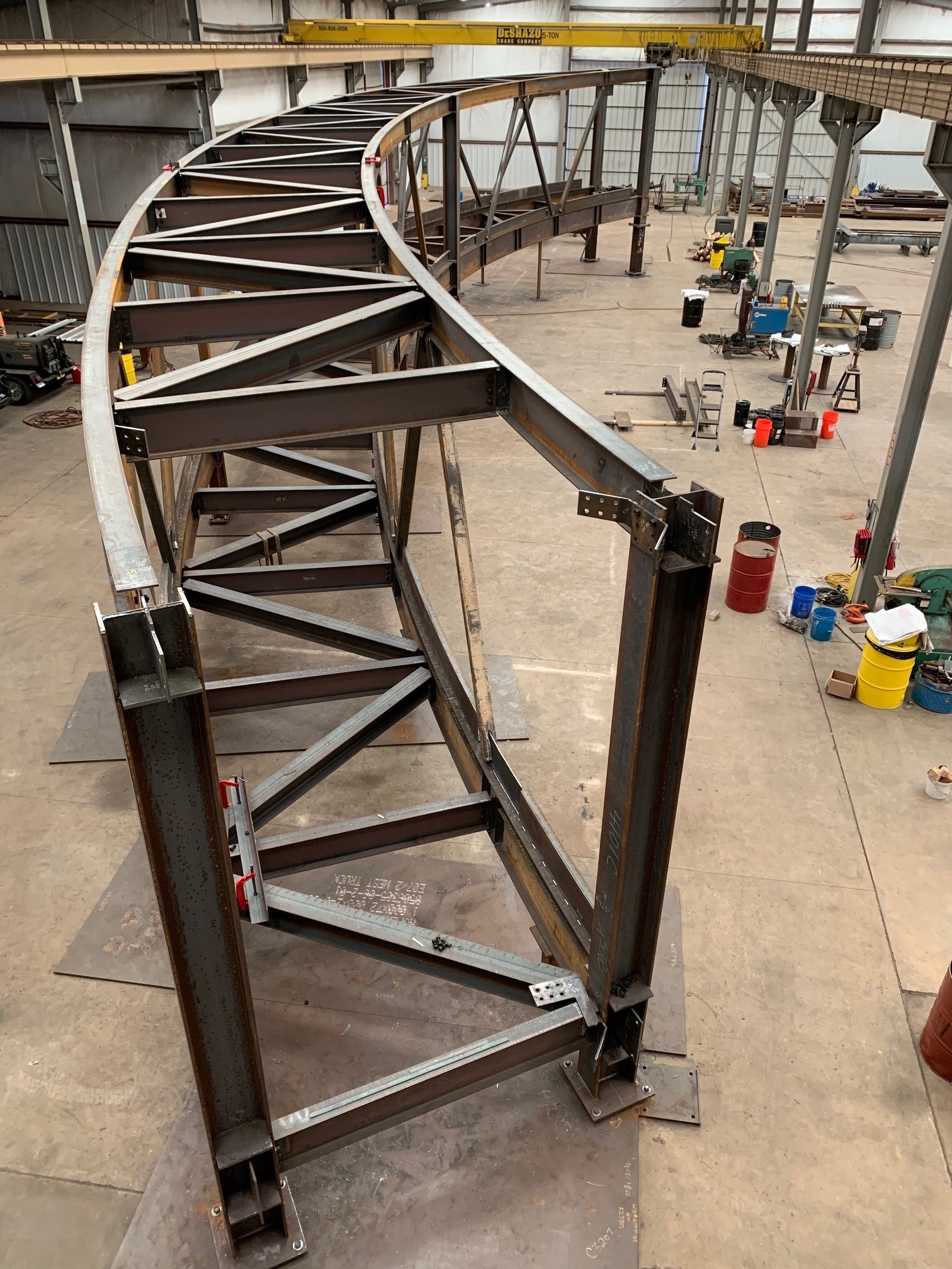

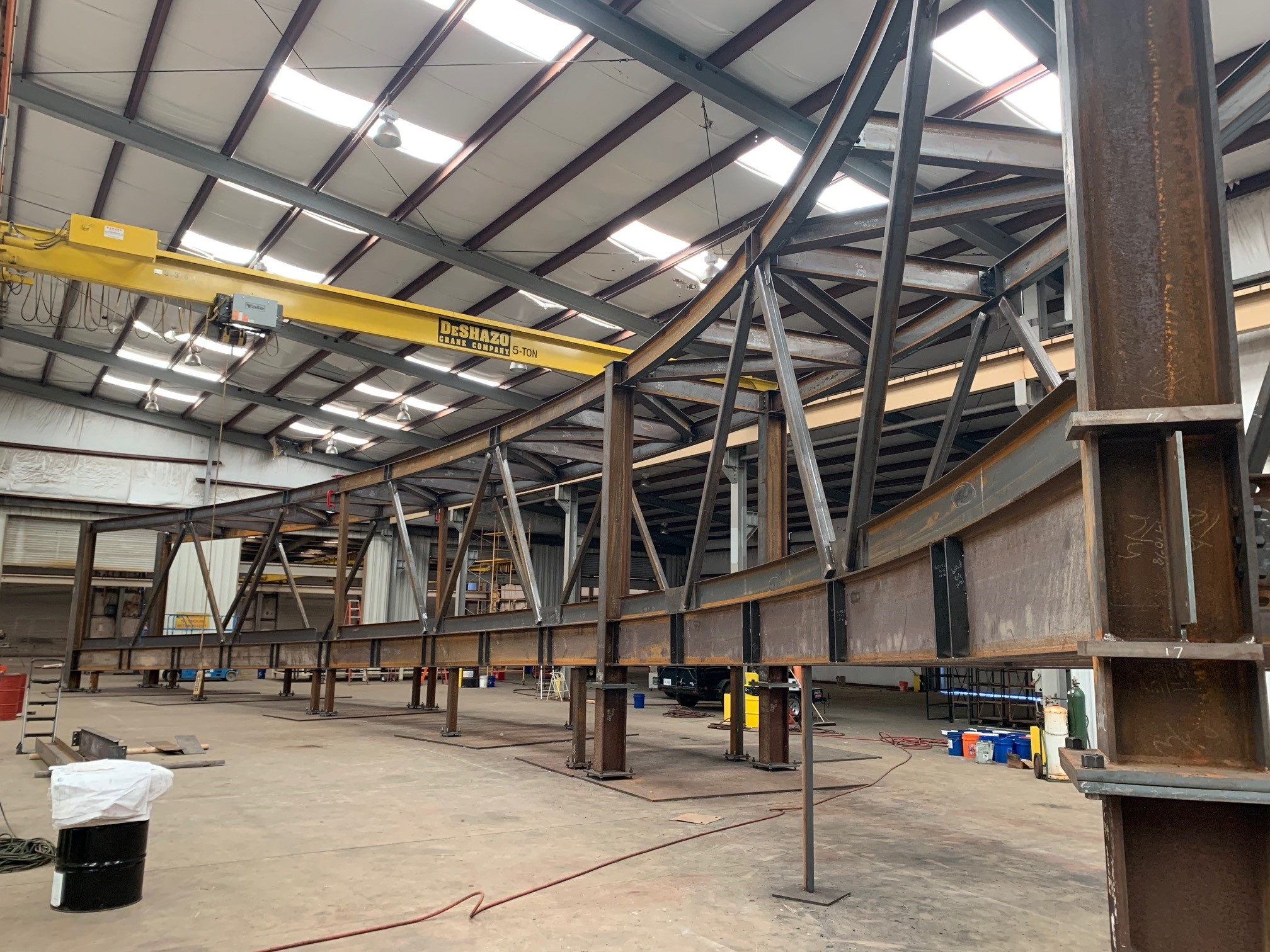

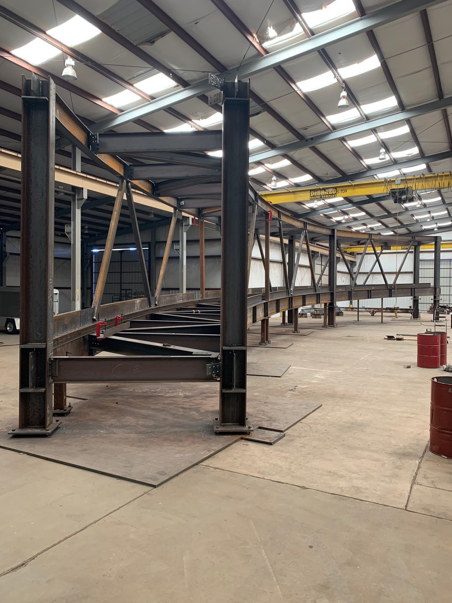

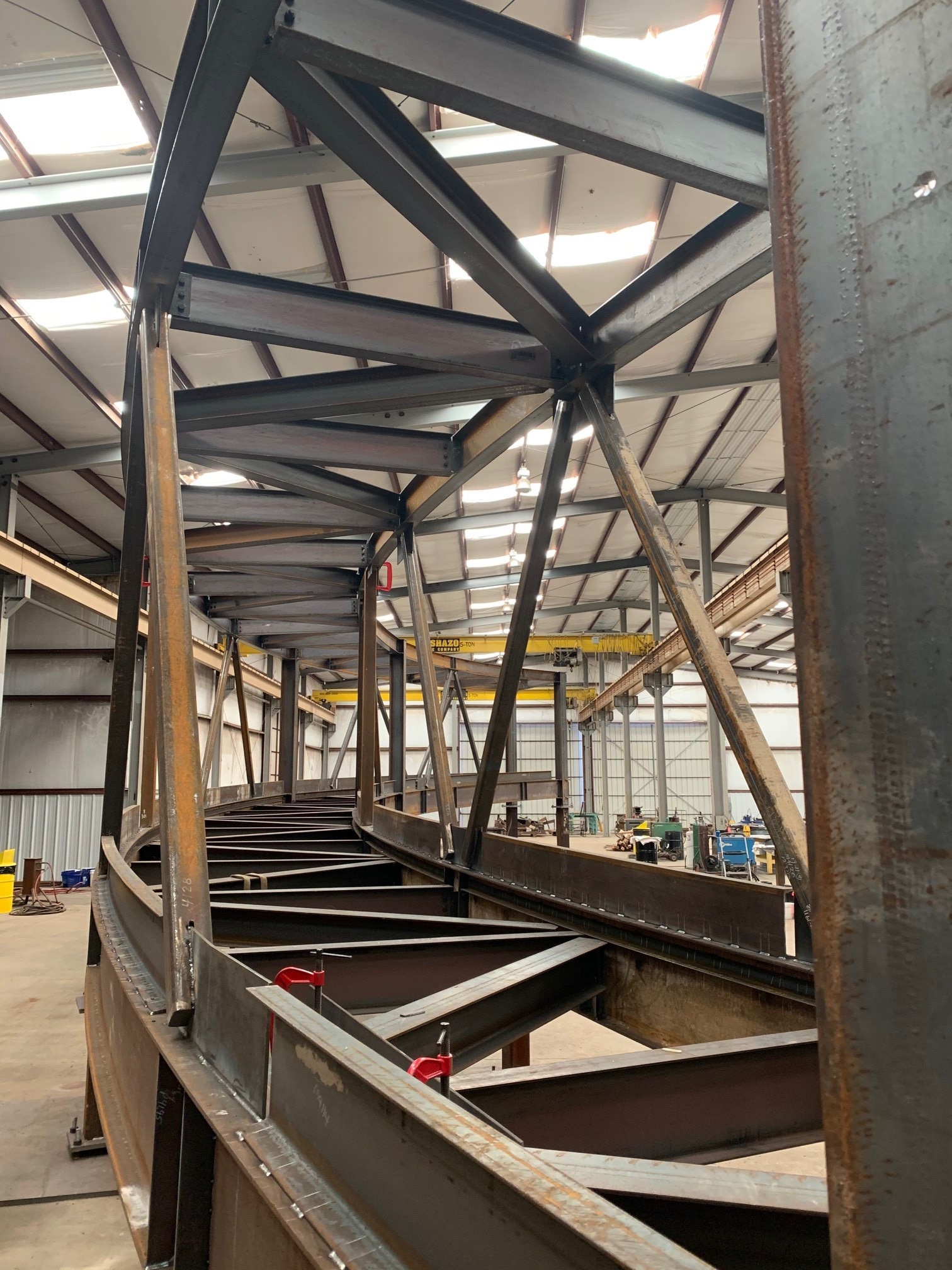

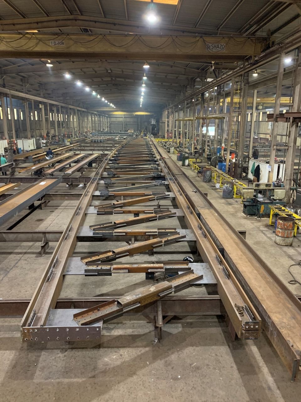

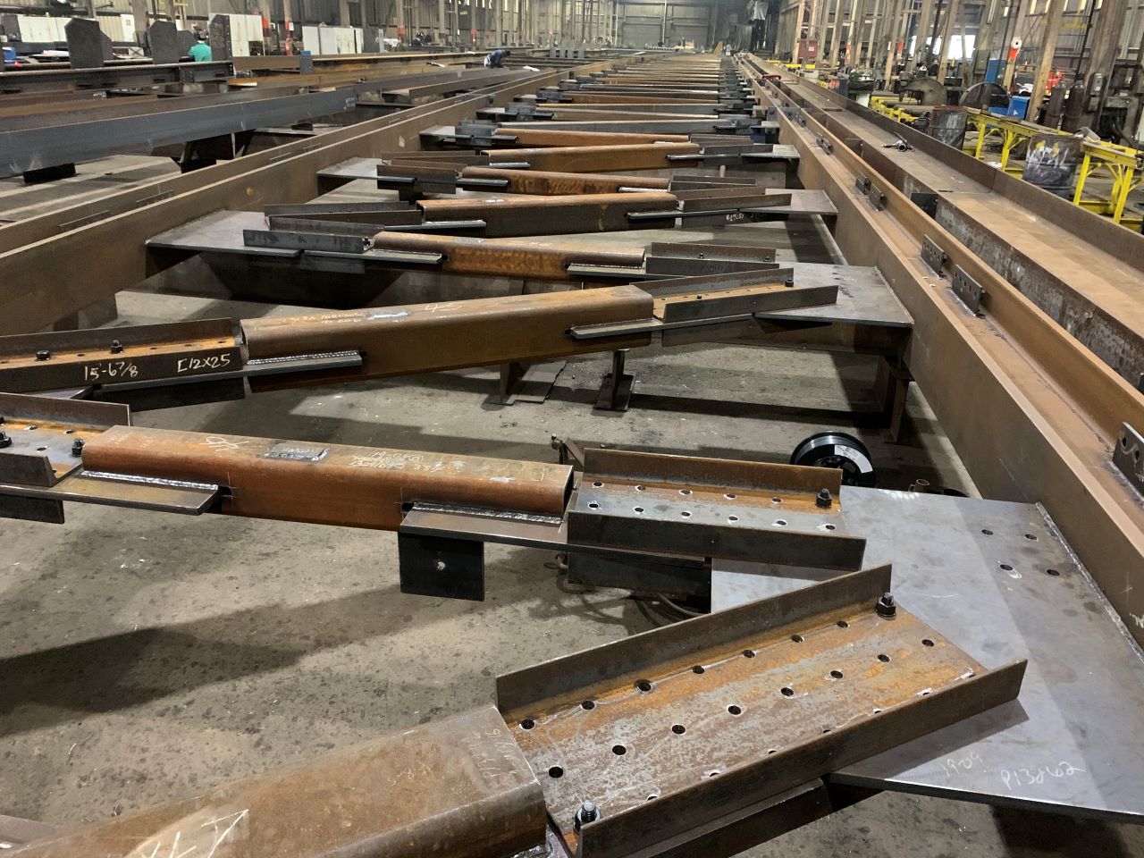

As promised in an earlier post. Here are some photos of a pedestrian bridge we are building for UNC Hospitals in Chapel Hill, NC. If you are a UNC fan, or know the area well, this bridge will cross Manning Drive and West Drive. It connects an existing parking garage to the oncology clinic. This bridge we are building replaces a bridge that (I think) did more or less the same thing except it wasn't curved. The original bridge has been demolished and this one takes its place. This is one of 5 total sections of the bridge. The other sections are straight....so not quite so interesting. This bridge is complicated in that it both curves and changes in elevation. Sounds simple, but it really isn’t.
As you can see we built this thing on shoring posts to replicate its final position (the change in elevation, etc.). Essentially, this is just like its final resting place other than it will be 20-ish feet from the ground. For something like this it always pays to shop-assemble it prior to sending it to the site. I'm sure you can only image the problems something like this would create if it got to the site and didn't fit....we'd have a pissed off CM and ironworkers. Always better to bite the bullet and do it right the first time.
