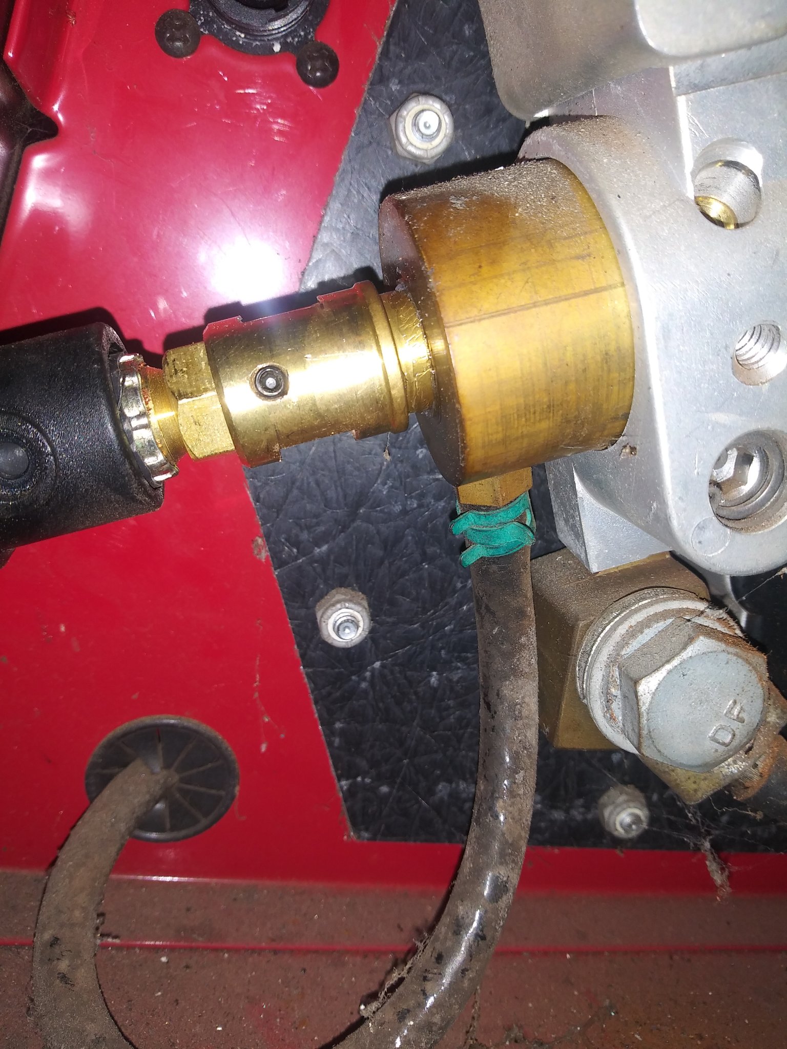

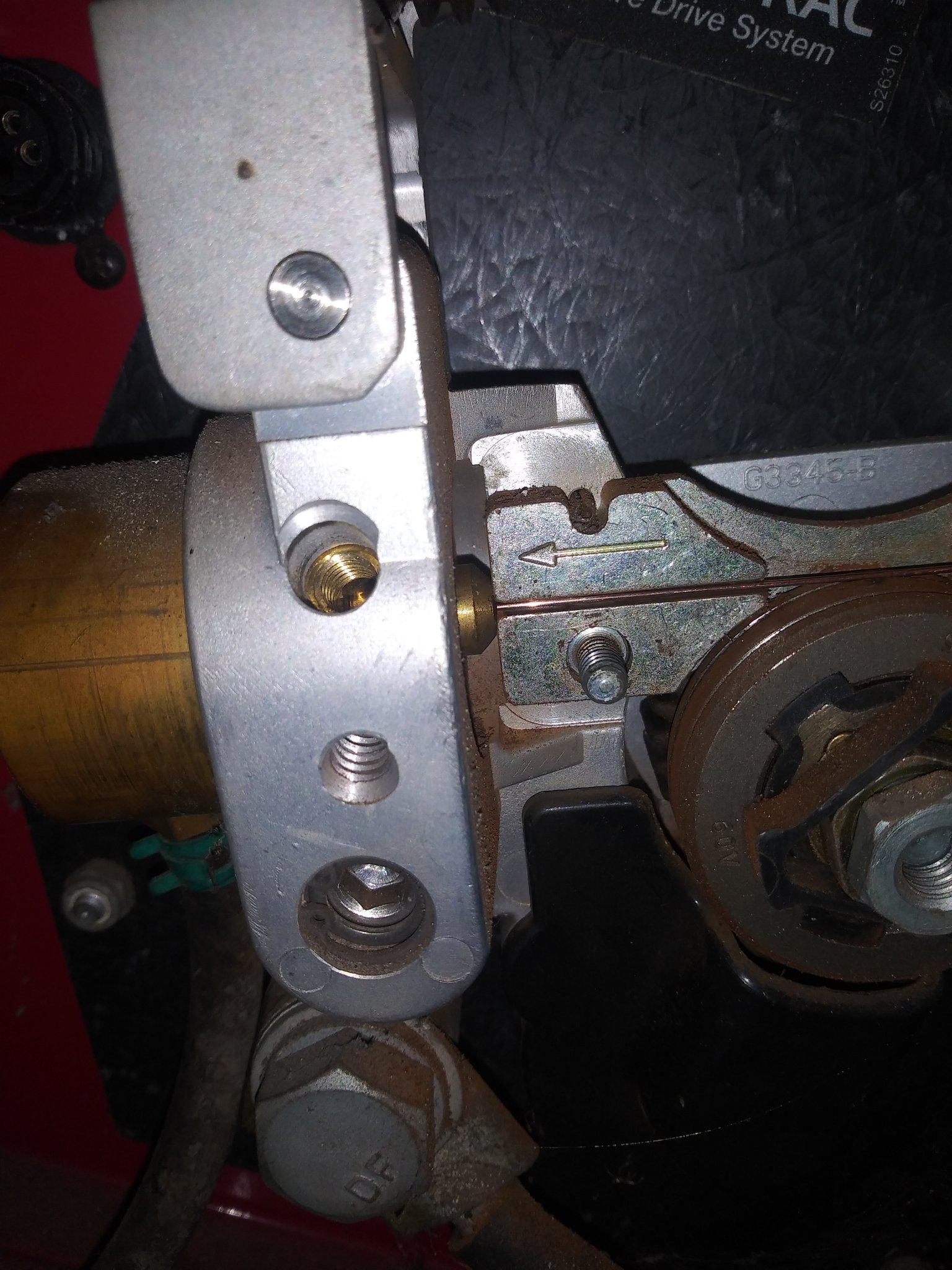

I'm pretty sure I found the problem, wrong torch set, or a wrong fitting. So I changed tanks, stretched out the lead and started by disassembling the gun, went to the other end and found a missing set screw and the hose partially unscrewed from a fitting, fixed that and checked o-rings. When I put it back together the fitting bottomed out on the wire feed preventing the other end of the fitting, w/o-rings, from seating all the way into the gas block. Can this fitting be modified? Will air-gass have a fitting that would be compatible without buying a whole new torch kit?

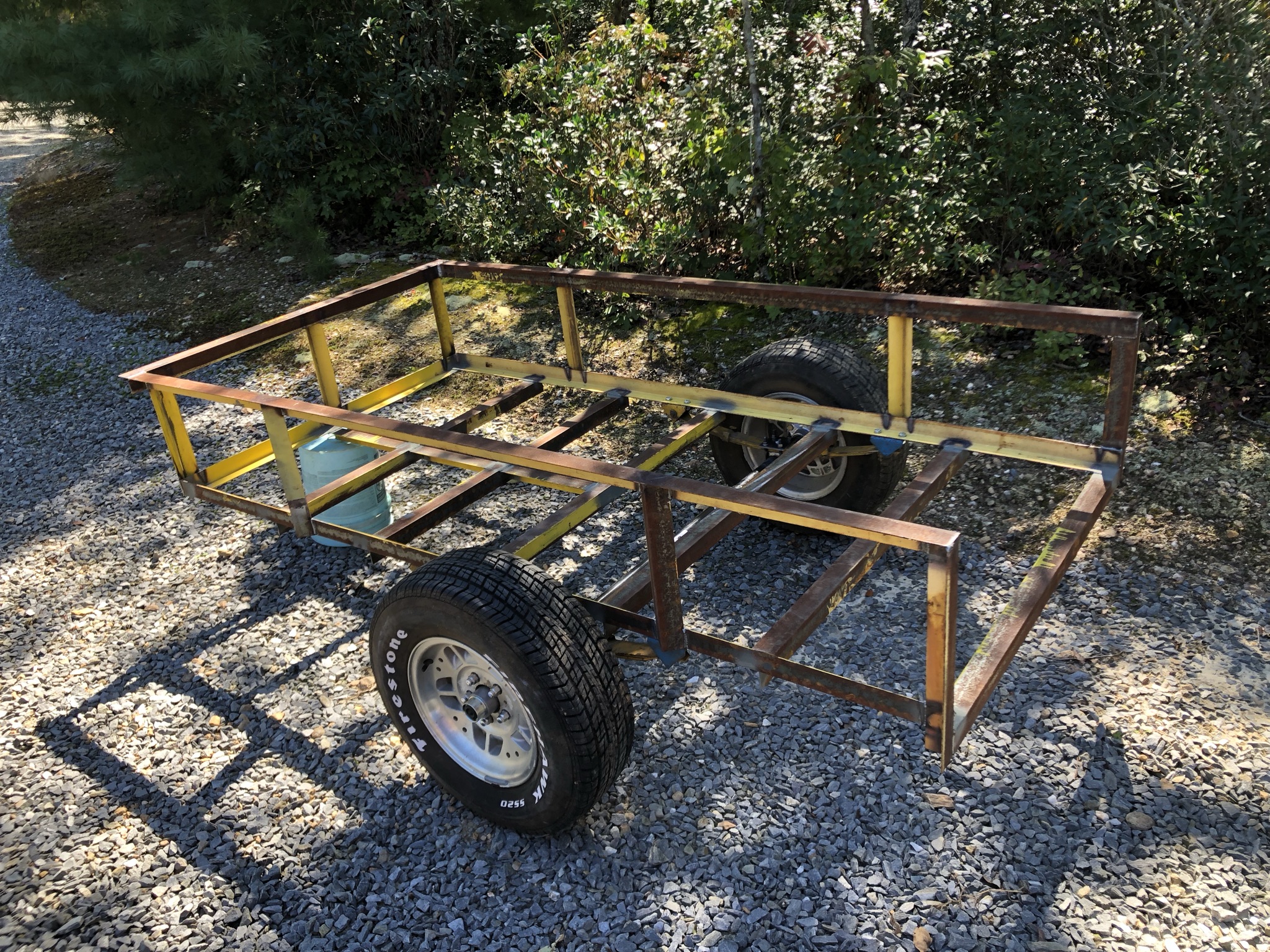

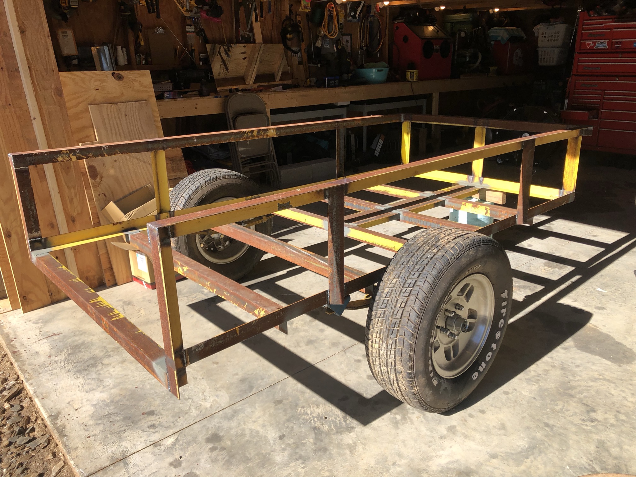

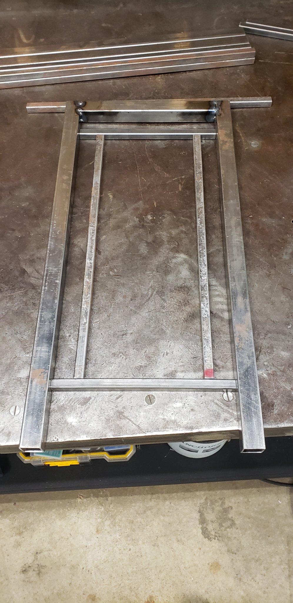

I got some nearly free steel and went to work building another trailer specifically for the garbage and trips to the waste site.
Still in progress, have a few more uprights to do and a tailgate to fab up. Floor and sides will be expanded steel. Tongue will be 2x3 tube. It’s 4x8 with 16” sides, tilt style in case it’s needed.
Wheels and tires were gratis locally, I bought the axle and hubs. Springs and hangers were free from a buddy (just happened to also be yellow). They were a 7 leaf pack! from air compressor trailer that I reduced to 3 leaves. Axle is set 10” rearward from center.
Trailer prices are crazy right now, I have very little in this. Plan to have my local guy blast it when it’s done and get some paint on it.
So is the power pin contacting the drive rollers prior to being fully seated? Who is the manufacturer of the mig gun and need to check if the power pin is compatible with the 255XT.
I didn't get to witness the un-boxing, guessing Radnor. I remedied the problem with O-rings. It hadn't welded this good since the torch had been replaced!

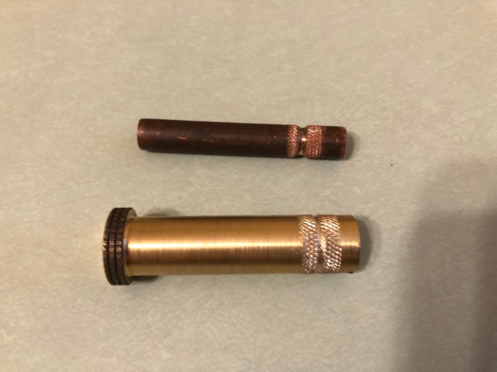

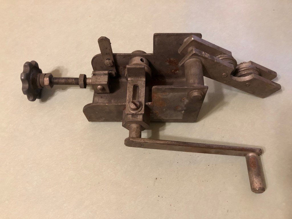

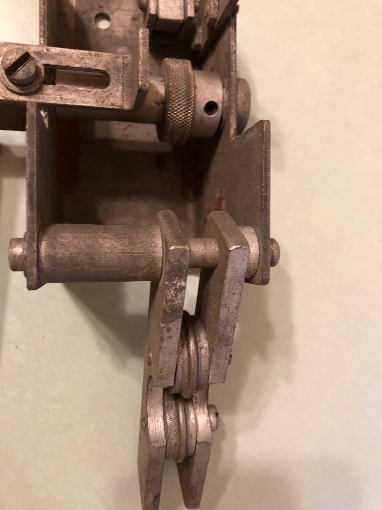

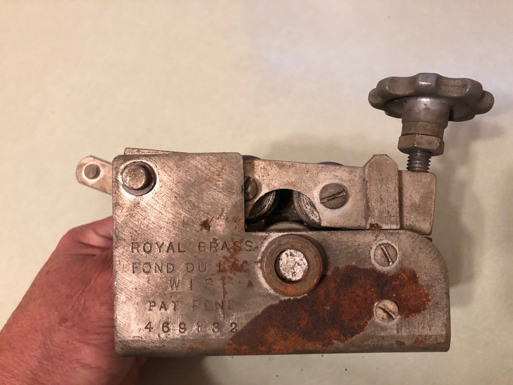

Anyone know what this is? Picked up at swap meet today in box full of other stuff. Best I can come up with is some type of tubing goes in and it rolls a single indent into it. Maybe for crimping ferrules on rubber hose or similar? But there are other, simpler tools for that.
In the second picture it look like there was a label or badge under the handle. Can you make out anything in that area???
I used to do all this by hand
I could not find old tools on thier site.
First thought was flaring tool but rollers looks like it would only form an indent.
Where it looks like label was is just that, where a label was. Whole thing is galvanized so that area is just a little brighter.
Patent Pend # is 469132.
Also found Royal Brass in Fon du Lac in google search. If I can't figure out what it's for I'll try to get in touch with them.
Just curious.
View attachment 7735913View attachment 7735914View attachment 7735915
It’s a knurling tool of some kind. Exact use… looking now….
Got it. It’s a hand knurling tool for doing knurling without a lathe. You kind of use it like a pipe cutter.

Hand crank knurling tool was also an early guess and it might do that but Royal Brass is still in business and does a lot of tubing stuff. May stick something soft in it and see how it does but it looks like the two top rollers will take out the knurling in the middle. An old roll groover also seems plausible and more along the lines of what I was thinking.

It’s very possible that the knurling was for pipe fitting. You might want to put a knurl on something and then use that as a way to get solder into a joint.
Could also be to adapt copper tubing to rubber tubing.....the knurling holds the rubber tube and the groove give a place for a hose clamp to tighten down.
Automotive brakes maybe?

The "knurled" wheel is simply the 'driving wheel' is it not? As in, the knurling is there to drive the material being worked.
It is....but if you are turning softer material, you are going to end up with that knurl pattern being transfered, whether you want it to or not....
If the intent was to just put a groove, you could do that with 3 forming wheels and make it hand turned, so I suspect that knurl pattern is intentional.
....I could be wrong though....

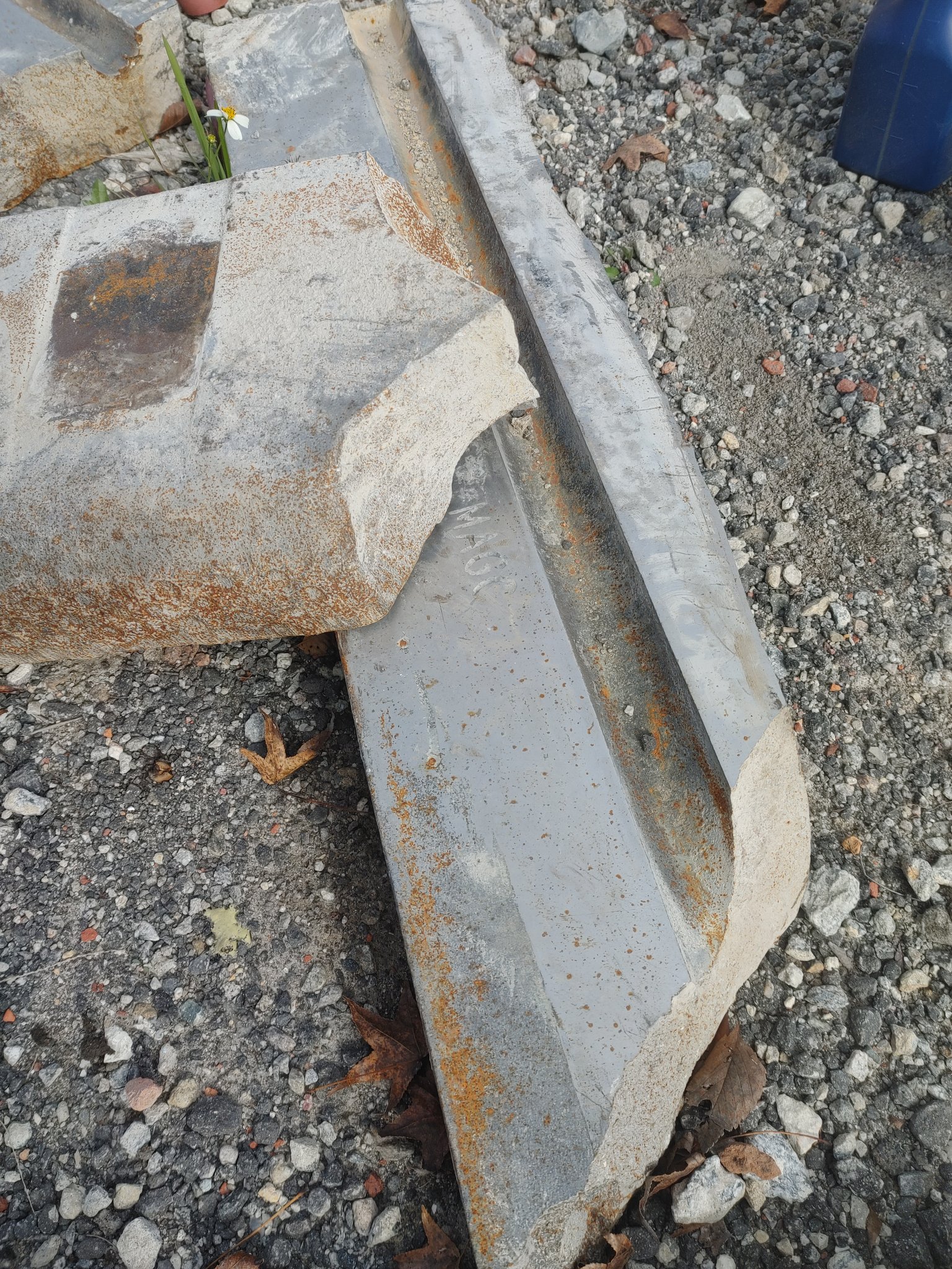

Bad day when you are breaking this stuff
