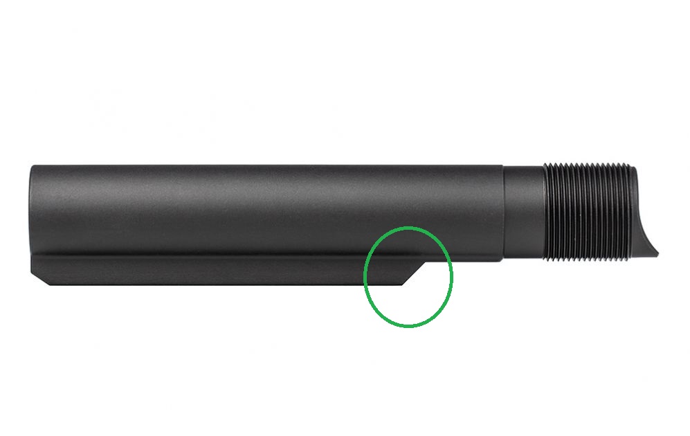

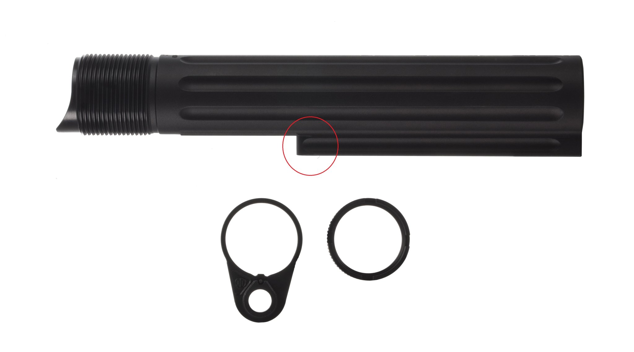

Got my lower all finished up. Found out this PRS Lite is not compatible with certain buffer systems even if they are labeled 'mil spec'. I bought a PWS Mil Spec buffer tube, end plate, buffer, etc and none of it works with the PRS Lite. First the end plate has a protruding QD socket. That's a no go no matter who manufactures it. Also the actual buffer tube doesn't work either. With the PWS buffer tube the channel that has the 6 position stops in it, it just drops straight off. Other buffer tubes have a slant transitioning from the tube to the channel. The PRS Lite indexes off of the slant to hold the stock snug up against the castle nut. With the PWS Buffer Tube the stock would slide around no matter how you do it.
I ended up swapping buffer tubes with another AR of mine so all is well.
The picture below shows one of the problems I encountered. The other picture is the kind of buffer tube you must have.

That is a non-standard buffer tube in a bunch of ways (square end, scalloping, curved end meeting buffer retainer pin? WTF who does that??). The word spec shouldn't be on the packaging.
They must pair it with a specific stock or hate their customers.

In their defense their buffer tube system works with every single other stock on the market. The PRS Lite is the only one that I am aware of that has an internal indexing point like they do. To be clear even the PRS Lite fits it fine. The problem is the way the PRS Lite operates, it essentially has more moving parts and parts that are supposed to be permanently stationary. The part that is supposed to butt up against the end plate is supposed to be stationary, but because there is nothing to trap the part that locks it into place you can slide it back until it hits the hard stop even after it's tightened down. Any other 'Mil Spec' stock will work on the PWS buffer tube.
The scalloping is quite popular these days. 3 of the last 4 buffer tubes I've purchased all have that. It makes installation very very nice. There are a whole bunch of companies doing that. The scalloping on the end in my opinion is an improvement in every way. Given though scalloping is probably not written in the military specs from way back when.

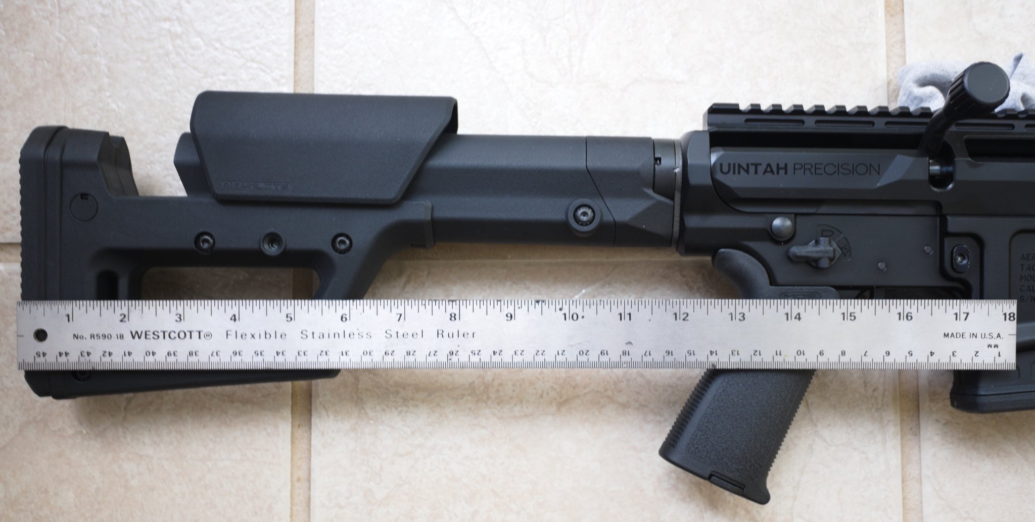

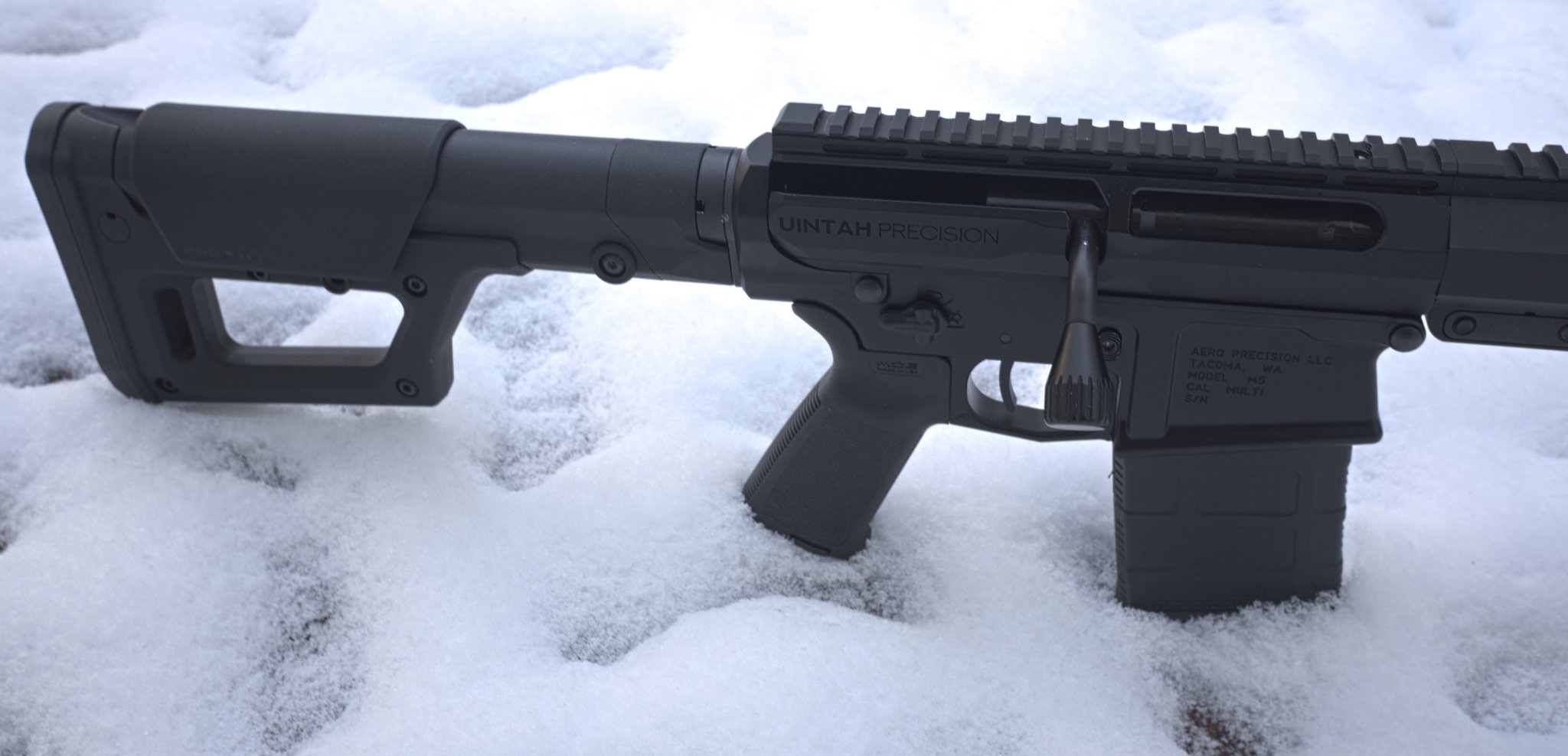

Hello. Just joined and this is my first post. FedEx delivered the PRS Lite from Magpul today and it went directly to the AR308 I've been putting together. Lower is Aero Precision M5/AR308. Upper is Uintah Precision UPR10 chambered in .308. Still need to get optics and ammo. My first .308 and first bolt-action. Can't wait to get this completed and head out to the range.
I don’t have a PRS Gen 3 to compare it to but the lock up on my PRS Lite has been solid on the two guns I’ve swapped it around on, I haven’t been able to detect any play or wiggle.
I’m hoping to take it out this weekend to get some rounds down range with it but so far playing around with it I like it, mostly. There’s a couple things that I’m not a fan of that just seem to be quirks of Magpul in general.

What is the length of pull?
