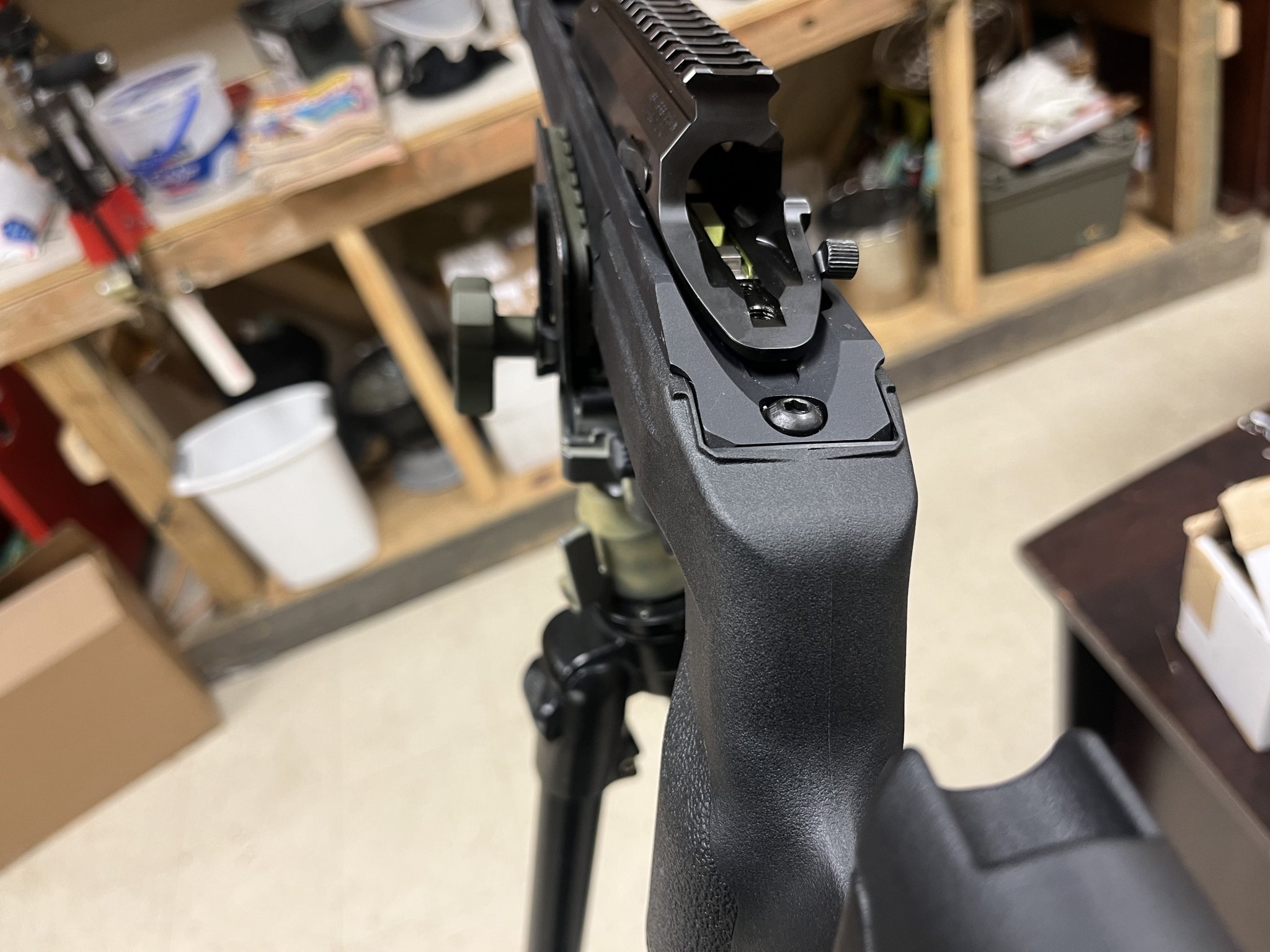

I’ve got a solus and a bravo in the shop. Want I should go see if it fits?

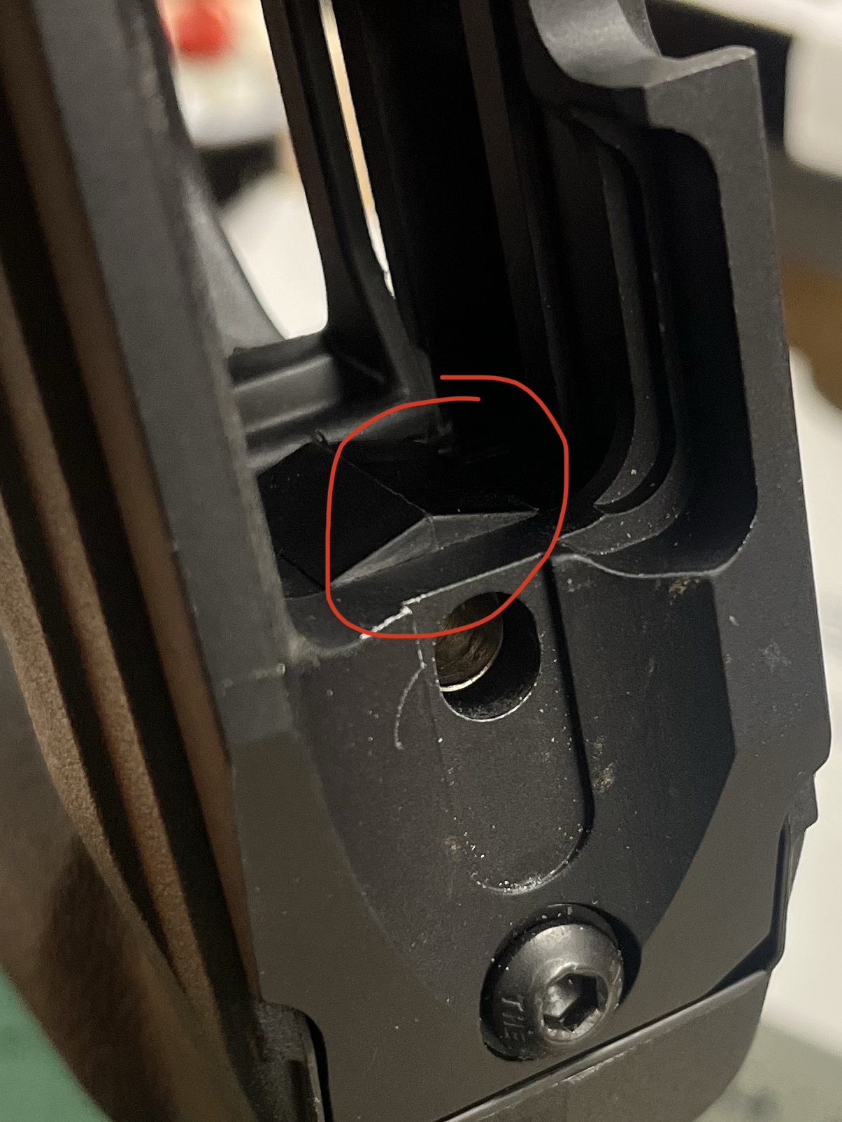

It won’t fit mine. The one little piece circled is in the way of the back of the hanger, and leaves the rear of the action too tall for the action screw to engage threads. Take about 30 seconds with a file to move enough for that plastic piece to make it work. I bet if you look at the rifle from aero, they have done this

It won’t fit mine. The one little piece circled is in the way of the back of the hanger, and leaves the rear of the action too tall for the action screw to engage threads. Take about 30 seconds with a file to move enough for that plastic piece to make it work. I bet if you look at the rifle from aero, they have done this View attachment 8330039View attachment 8330040View attachment 8330041
Your trigger seems to have a larger hump in the back compared to a TriggerTech, or a factory 700 trigger... Maybe that's what's hitting. Especially since the Solus rifles come with a TT from the factory... That could explain why yours won't fit where you marked it on the picture, and their's don't have any problems fitting...
Very possible. I don’t have a TT for rem700 on hand at the moment to check. I have a timney calvin elite in th box of parts, will see if the back looks any different than that timney elite hunter

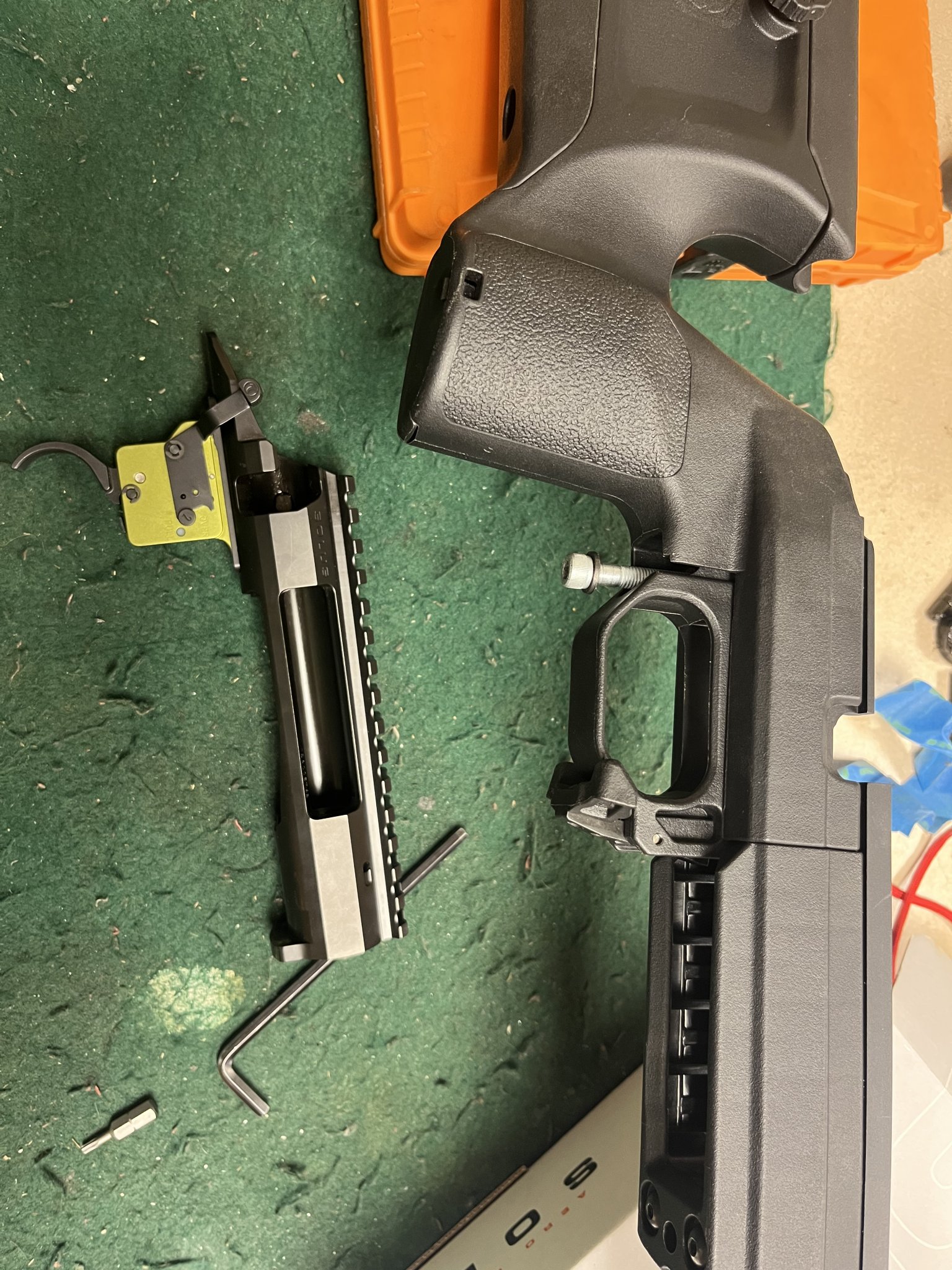

Went ahead and snagged a SOLUS action and separately purchased a KRG Bravo (Regular Rem 700 Inlet). With a TriggerTech Special it fits fine, no issues.
Also looks like the regular mag latch in the Bravo will work with AW mags and the SOLUS. With one of the lugs at the 6 O'clock position it can actually catch the AW mag follower when empty. A situation similar to what I've read about the CDG action.

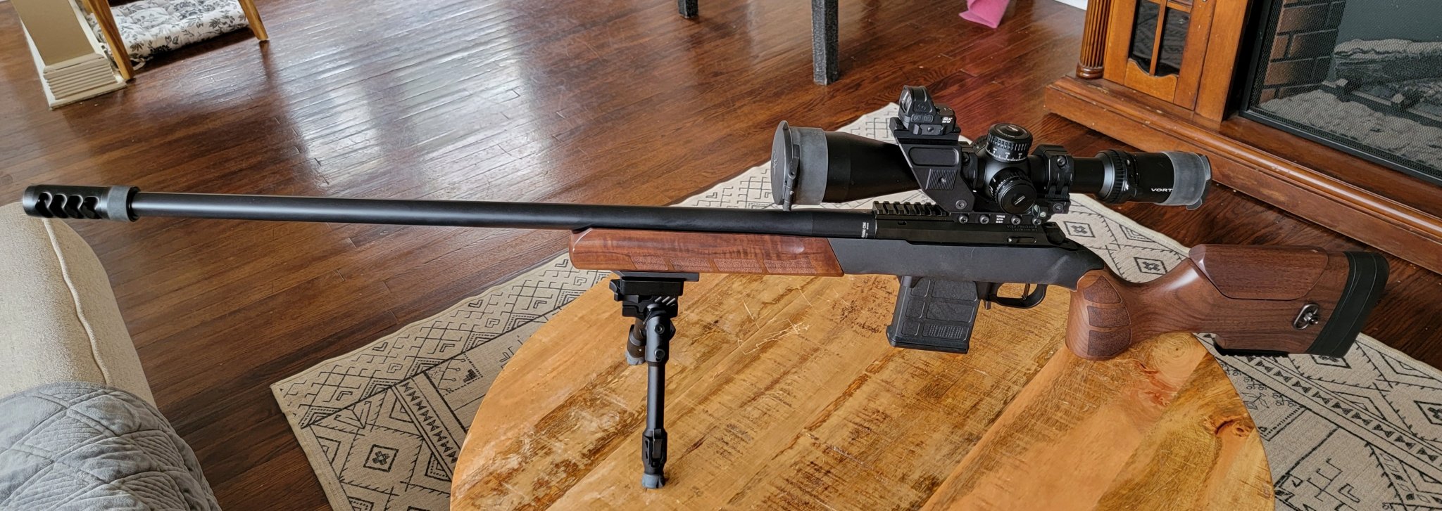

I took my factory solus chassis rifle out today and it is a shooter with hornady match 6mm ammunition. The action is nice, the chassis is nice, the magazines don’t bind the bolt even if you put the weight of the rifle on it. The Solus is my preferred traditional action now especially at the $600 they go on sale for. If a 60 degree floats your boat, they are hard to beat. I still prefer my Desert Tech rifles as my go to bolt guns though.
The nearest competitor with a short throw action is a coupe de grace at $900 and the next is $1500 curtis and terminus actions. All are good choices as well. I have had or had them all except for the terminus. I do like how the bolt basically closes itself on the curtis actions. Push the bolt forward and it snaps shut on it’s own. This is the only thing I like better about any of all three mentioned compared to the solus.

Mine fits with no mods…I’m running a trigger tech trigger.

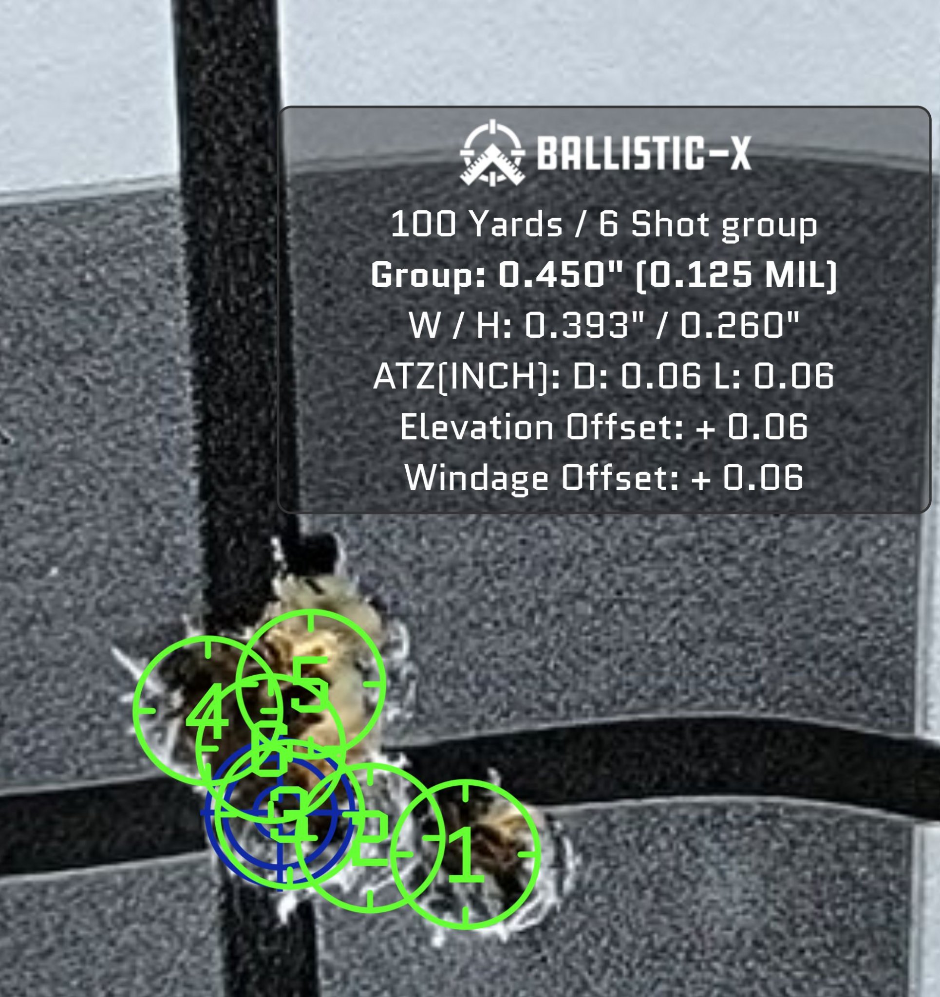

Ultimate Reloader used a BA blank on his 22 Arc build, he achieved .242 and .373 groupings out of the box depending on the bullet weight. Not bad for a barrel that so many people shit on.
I know BAs AR barrels can be hit or miss and for the price I don't expect anything more than about moa give or take. It appears more attention and QC goes into the Solus lapped barrels.
They certainly look a lot cleaner through a bore scope than most other factory barrels. Tikkas look good to. I know it's not a direct correlation to how they'll shoot but it shows extra attention was given in the process.
