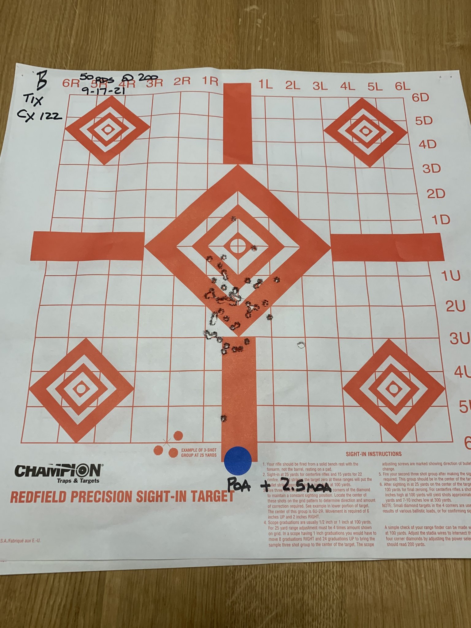

Hello all, I recently got a new lot of SK Long range match. My 20” tikka will shoot groups like the one pictured below at 50 yards, but averages about a 1.5” group at 100 yards…I was at the range yesterday and at 185 yards on a 4” gong I was only able to get 1 hit out of 10 shots with splash both low and high. Could it just be the lot and my rifle don’t like each other? It just doesn’t seem right that I can shoot so good at 50 but at 100 and over it goes to s***. I’ve tried action screw torque from 25-40 and ran patches with boretech rimfire through until clean. Same result. Keep in mind this rifle is well under 1k rounds probably 5-600.
.22LR is about good for 2MOA at 200yds at best, just due to statistical dispersion...Shoot 8in plat next to a 4 inch plate and see if you have better luck. In my limited expereince, the best way to test usable ammo accuracy is shoot paper at 200/300. Shoot 3x5 round groups, aggreate the results in an app/excell and do the math on the mean radius of disperion

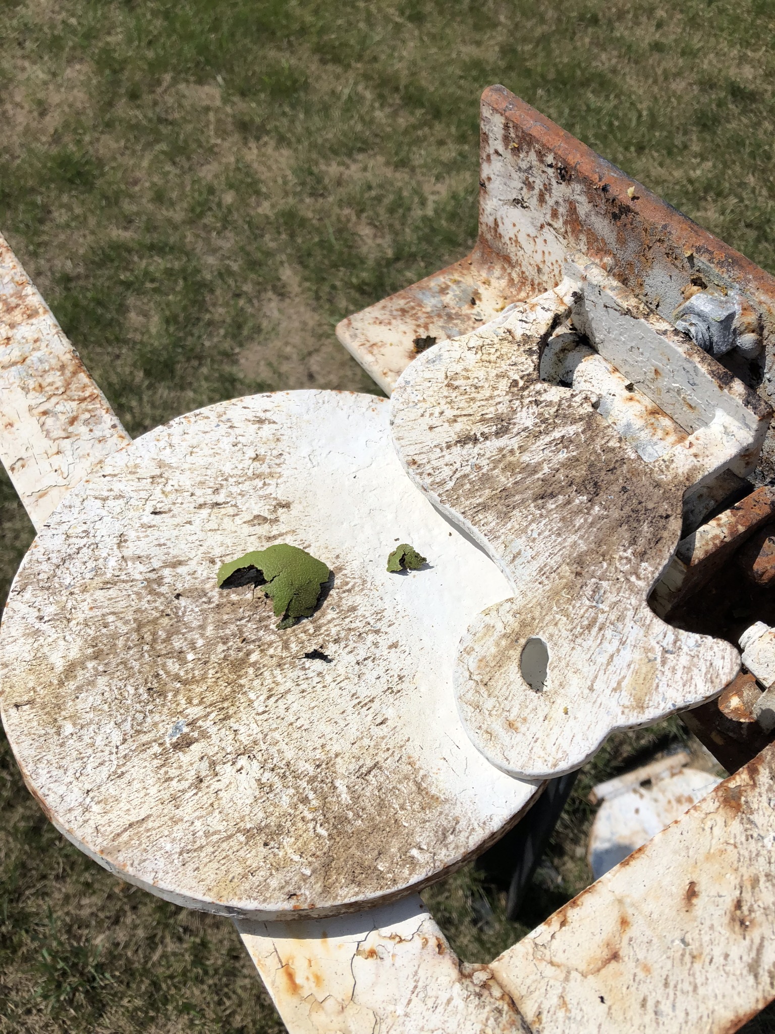

I took my T1x out at range on steel today. Bowling pin shapes at 323 yards were easy with no wind. 2/3rd IPSC at 411 really required being correct on wind; 5-16" between 1-3 mph. I attempted a 10" plate at 502, the effect of the ES was apparent there, hit maybe a third of the time and could see them going over and under the rest. Switching to a full size IPSC at 512 I went 8 for 10, the misses were wide from wind. No access to the targets and no fresh paint, so no way to get any group sizes at that range.

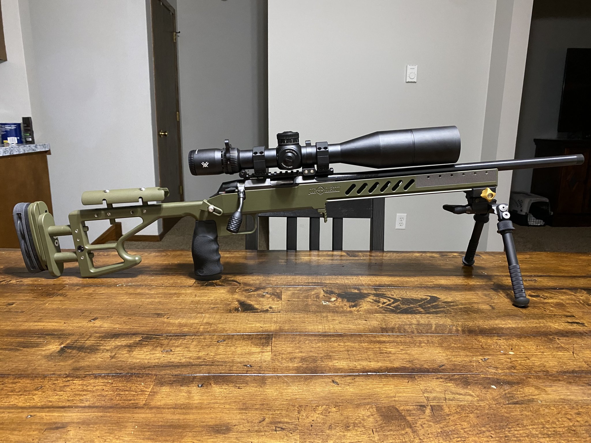

Built/assembled this for critter control in Hooterville. We live directly across the road from 20 plus acres of rough timber. With that fact established, it’s a steady stream of coon, opossum, skunk, etc... making their way over in the evening to eat cat food. My 22’s live on a steady diet of Wolf Match Extra, however, match ammo doesn’t drop critters the best. Typically low/ambient light, they’re moving quickly and I’m in a hasty field position.
Tikka T1x in 17 HMR. Area 419 15 MOA base, KRG chassis, trigger at 2.5 lbs, etc... Threw on a spare USO 5-25x56 I keep around in case a center fire scope goes down. So far groups run sub half MOA at 100 yards with some in the .2’s. So far have only run the Hornady 17 gr V-MAX. Have a couple CCI offerings I haven’t tried yet. Been fun so far. Time will tell.
After the initial sight in, and slipping the turrets, I confirmed zero this morning. It was dead on. I placed Walnuts on the plate rack at 100 this morning at it literally vaporizes them 😊.

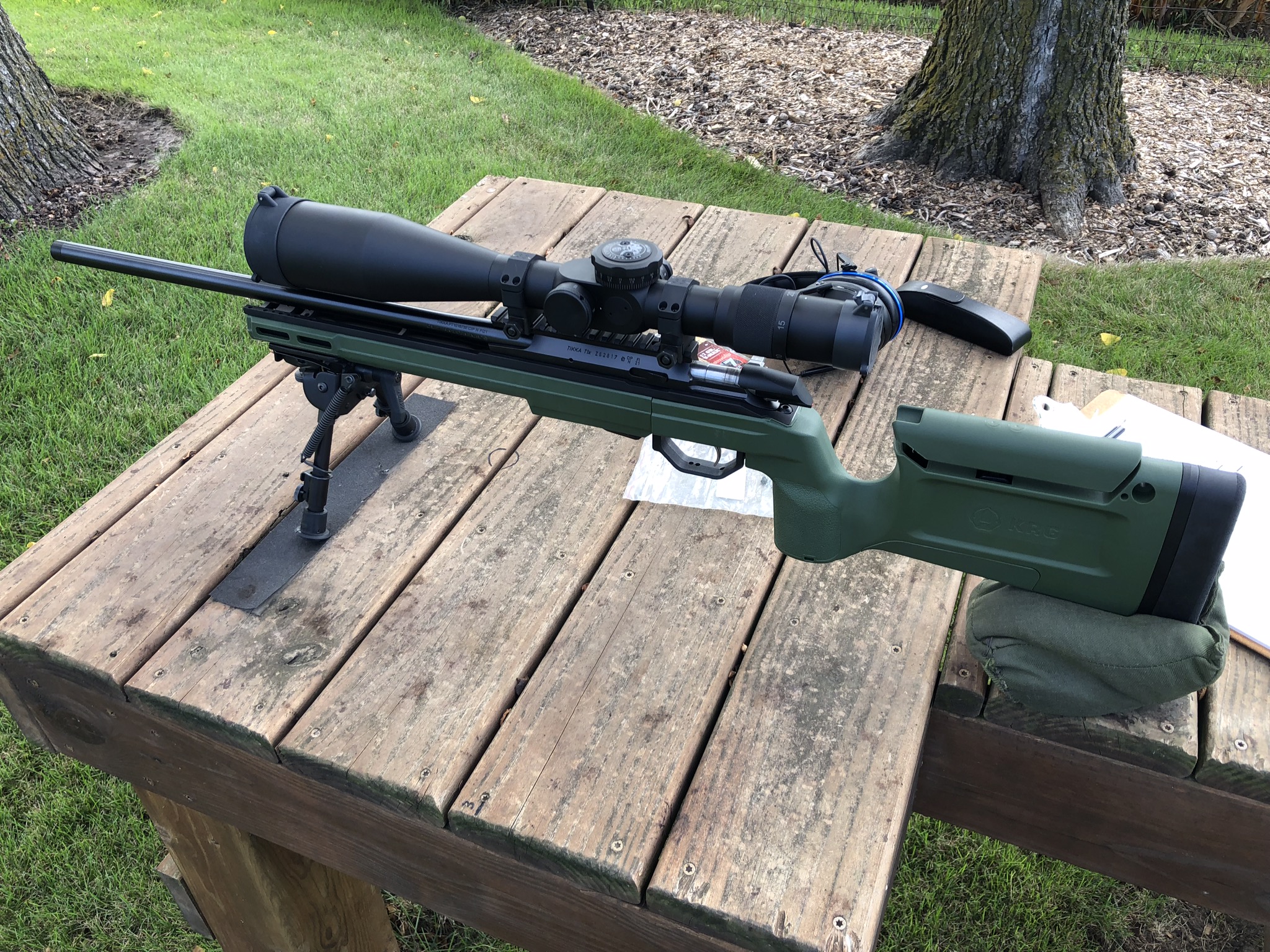

Got out yesterday with my dad to let him check out the T1x with my chassis and trigger prototypes. The smile on his face after shooting said it all! We both were keeping 10 shot groups around 1.5” - 1.75” at 100 yards with SK Std Plus. Seemed to be more vertical dispersion than horizontal though. Horizontal already was typically less than 1”. Sometime I’ll have to try some better Ammo and see if I can tighten those up more

Got out yesterday with my dad to let him check out the T1x with my chassis and trigger prototypes. The smile on his face after shooting said it all! We both were keeping 10 shot groups around 1.5” - 1.75” at 100 yards with SK Std Plus. Seemed to be more vertical dispersion than horizontal though. Horizontal already was typically less than 1”. Sometime I’ll have to try some better Ammo and see if I can tighten those up more View attachment 7694194

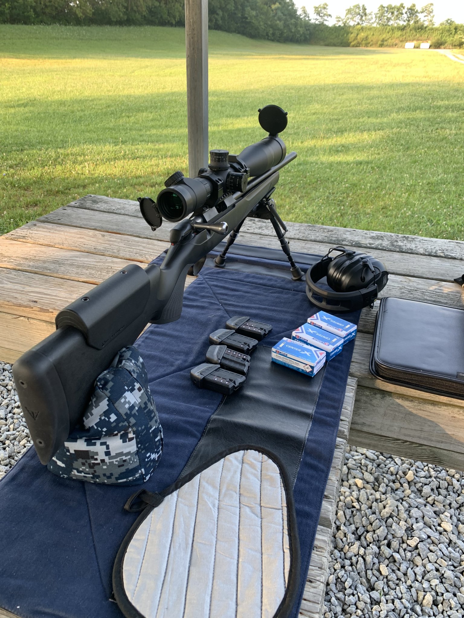

I got out this afternoon to shoot some groups. This was with SK Standard Plus at 50 yards. Other than the one called flyer, I don't think any of these are over .6"
I'm 6'5" and definitely need to swap out for a full size stock. And I think I'll adjust the trigger for a slightly lighter pull. Otherwise, I'm really happy with it.
I agree that at 200 yards it’s hard to claim a .22 being MOA all day every day as this target shows ( 50 rds at 200 using lot tested Lapua Cx). You can see most are pretty good but a few fliers open it up. But you for sure can put together good groups or even good 6x5 targets that would be MOA on that time and day. I’m just not able to get these all day every day as things just seem to conspire against me 🤪.

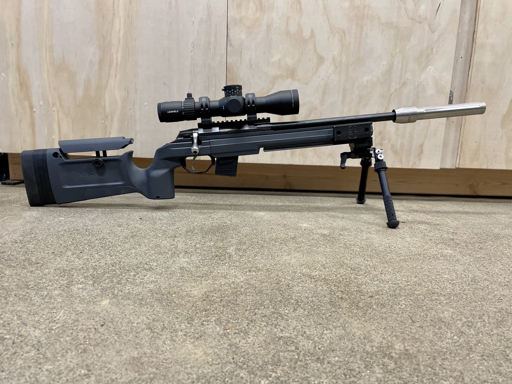

Just finished up this T1X. Set up for shooting NRL 22 matches. Currently weighs in at 15.5lbs. With SK Rifle Match it does about MOA or a little better at 100 with much of the dispersion vertical. I have some Midas + on the way that will hopefully arrive before a match next weekend that should clean up that group a little.

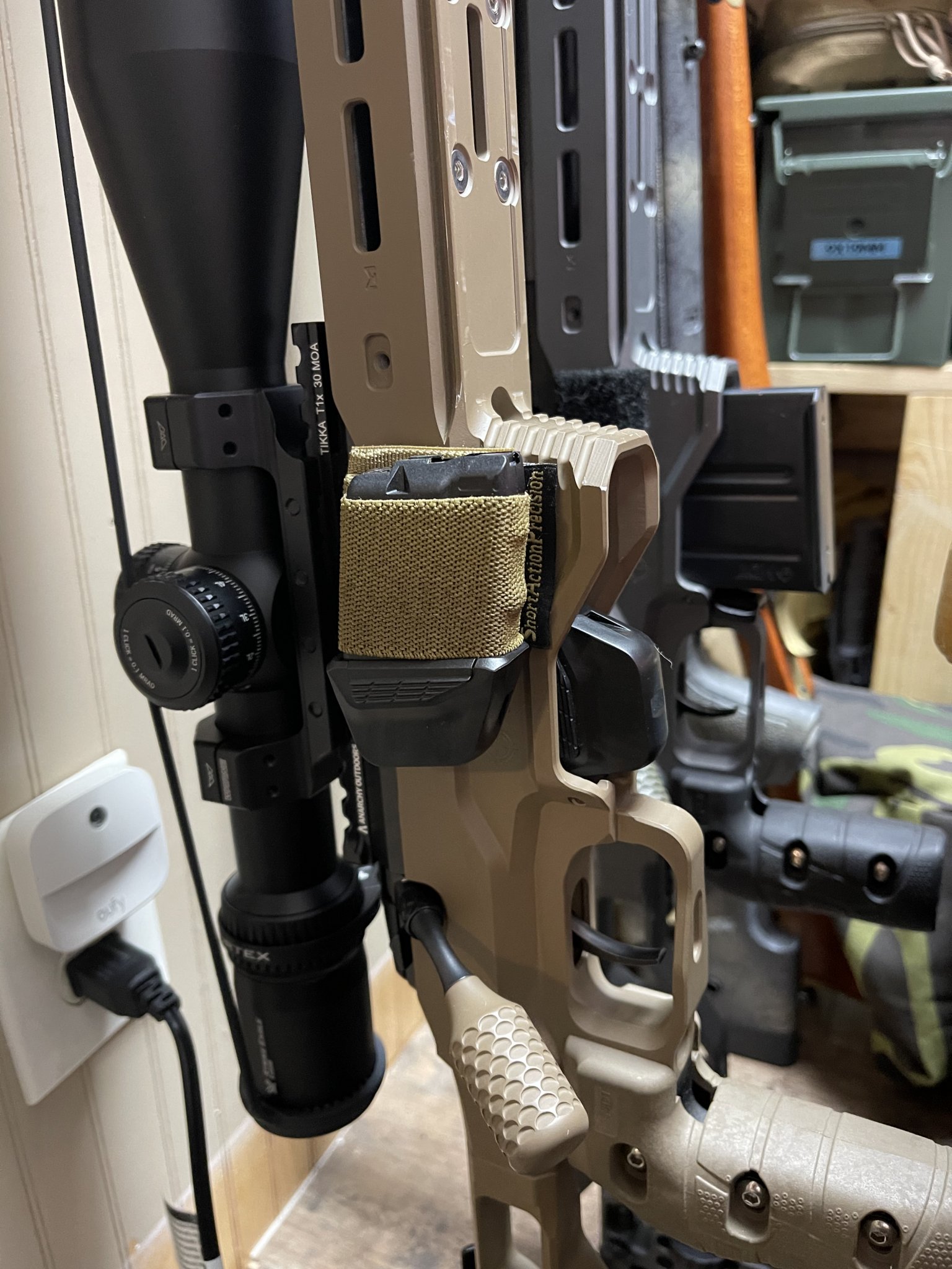

Does anyone have a spare mag holding solution? Either belt mounted or on the gun.
Jury rigged is fine as I'm not walking around the woods with it.
Digging in my pocket isn't cutting it for the local NRL22 matches unfortunately.
Works perfectly!
