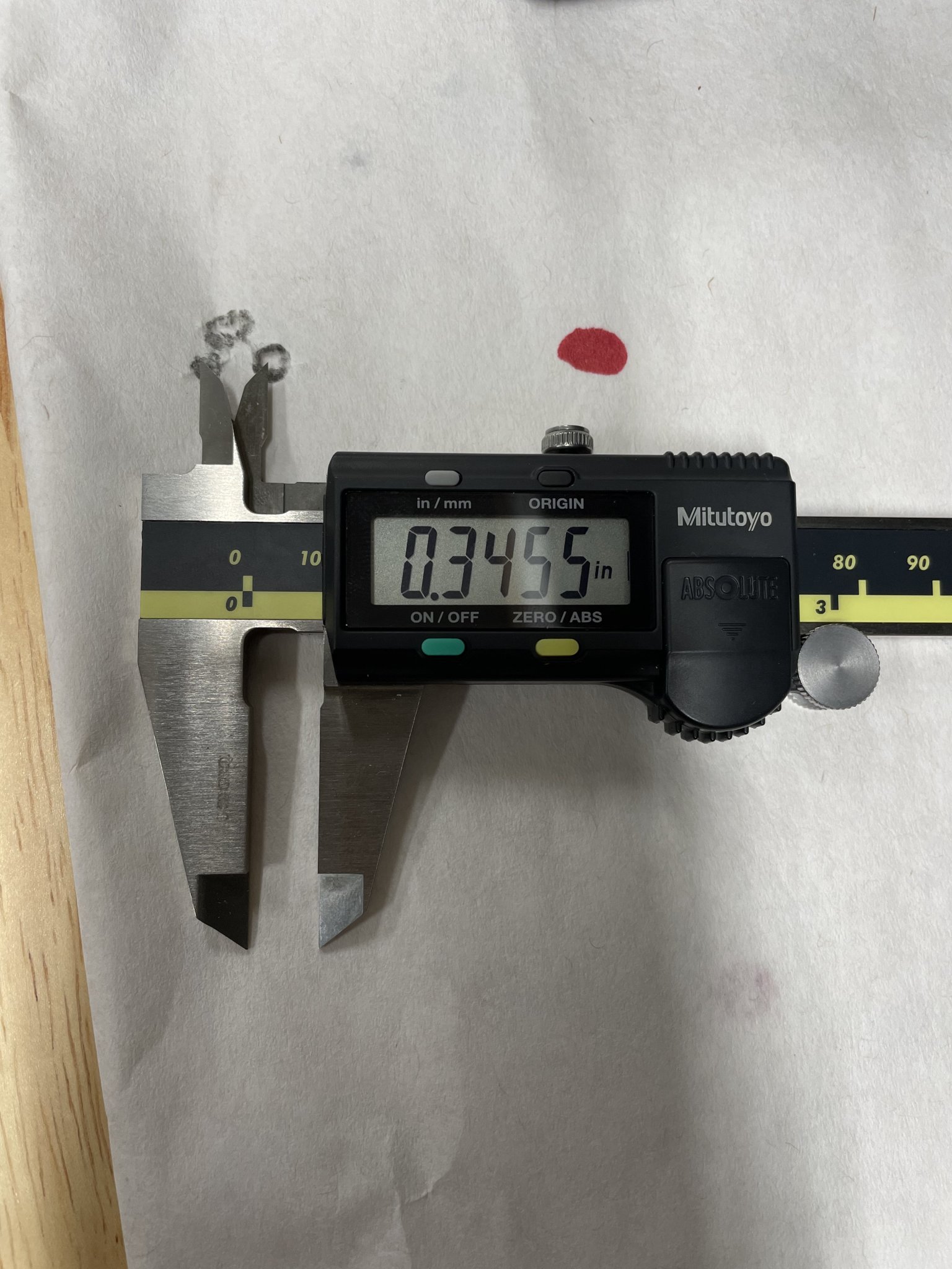

In a continuation from my previous post showing the way I have my T1X set up, here are some results.

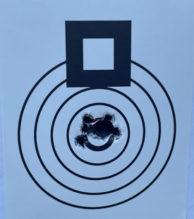

I switched to Midas + and have seen excellent results from it. Below is a group from my tuning session, 4 shots at 100 yards off a bipod and bag. Also chrono results from the following day.

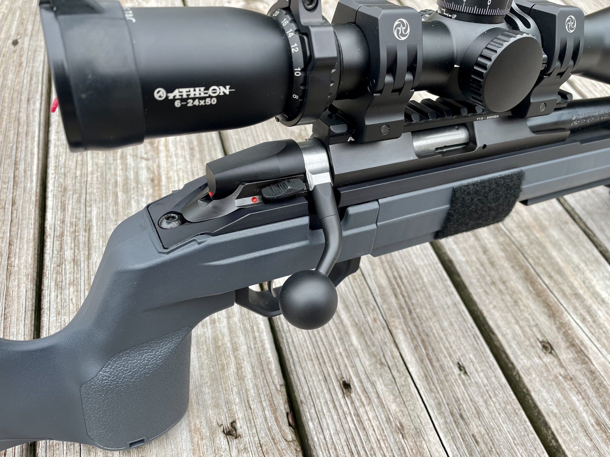

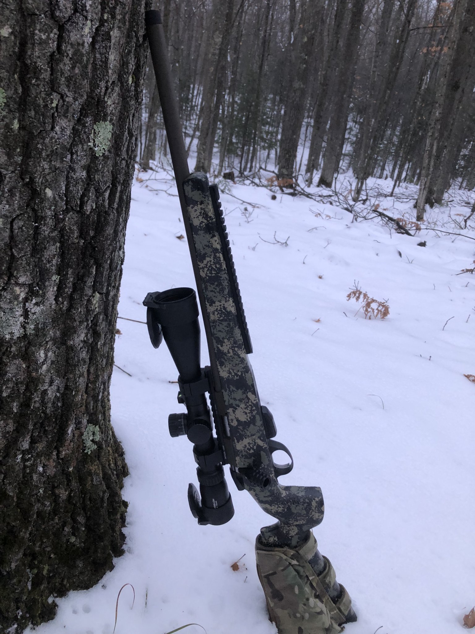

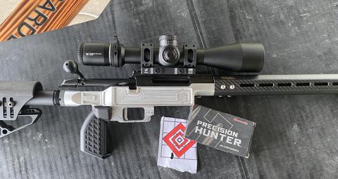

Well, after numerous people telling me I was just handicapping myself on glass with base class, I went all in.
20" factory barreled action in .22lr
KRG Bravo chassis with tool-less LOP
KRG heavy Arca rail
KRG Steel stop
KRG ARCA spigot mount, with Harris inline mount and Harris S-BRM 6-9' with S lock
Mountain Tactical trigger spring and extended mag release
DIP extended bolt knob
Area 419 30MOA rail
Athlon Midas Tac 6-24x50 in Athlon rings, MK Machining throw lever and scope level
Form 1 can from Nick at ECCO Machine and Fabrication
And some fun from south GA this past week with fellow hide member @Alarka. Went 8 for 10 on a 12x20 plate at 300yds with cheap CCI SV. This shit is too much fun!

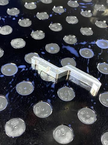

Anybody had both the spring and the timney. I have had 2 tikkas and done spring swap and thought they still sucked especially compared to the cz. Looking at Timney but the 2nd stage is a full pound.
KRG heavy Arca rail
KRG Steel stop
Area 419 30MOA rail

Toss one of my flat trigger shoes on there if you are in to that sort of thing.

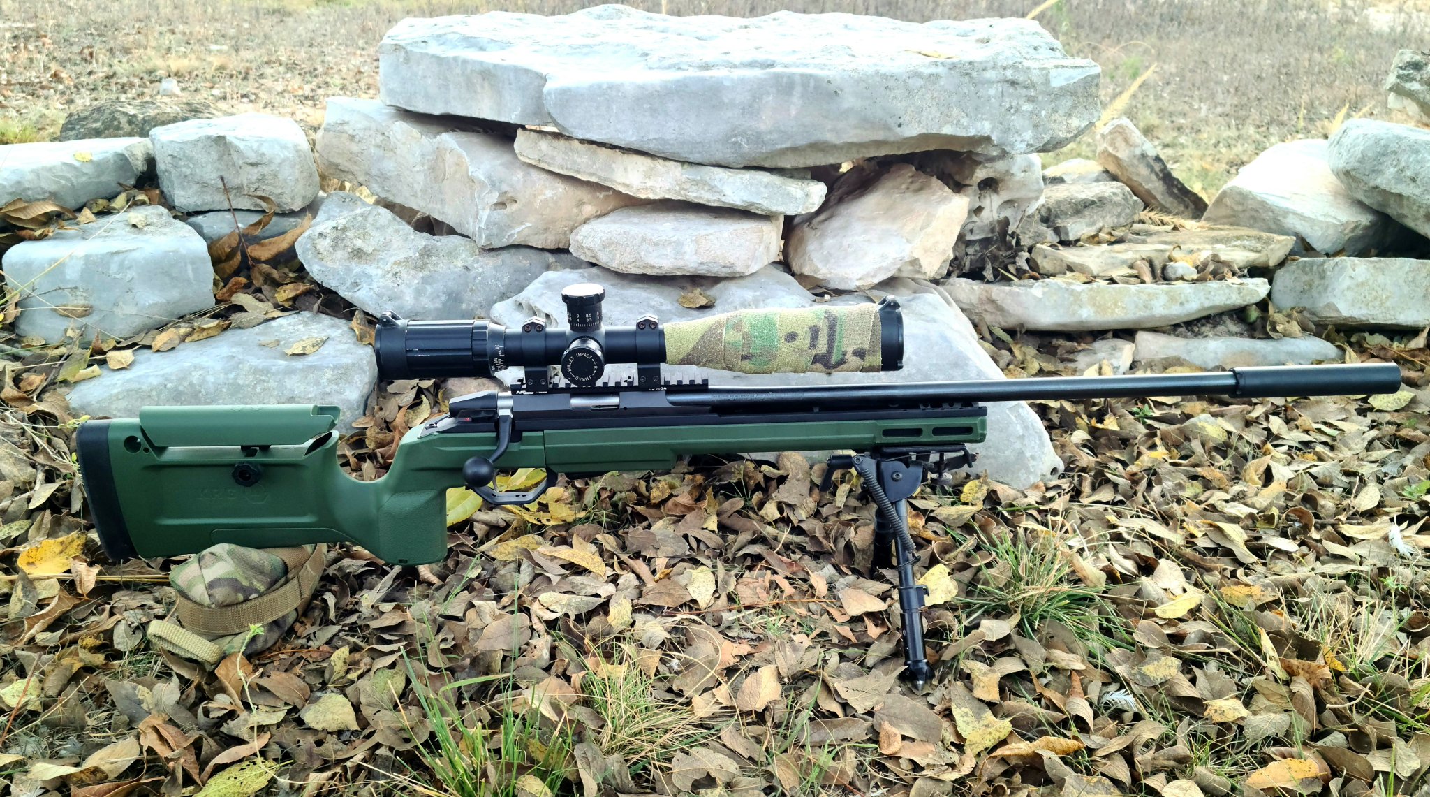

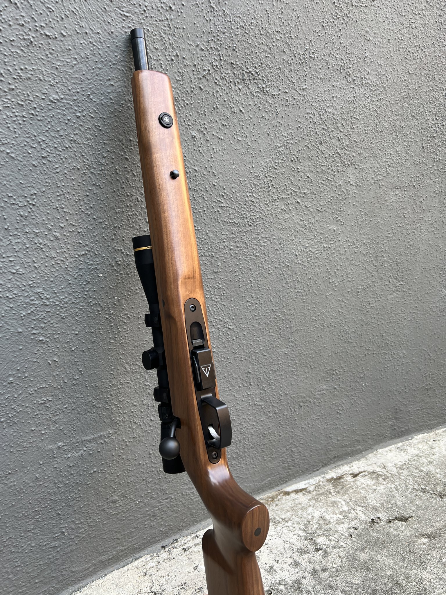

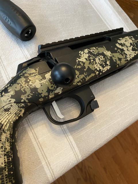

Finally got my Sterk bolt handle and shroud, so felt compelled to post my Tikka build.
Factory 16" barreled action
Mountain Tactical Trigger Spring
DIP trigger guard / bottom metal
DIP Mag bottom plates
Area 419 15MOA Rail
Sterk Bolt Handle
Sterk Bolt Shroud
Boyds Varmint Stock

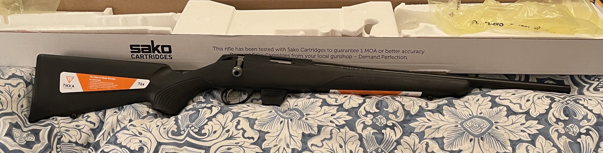

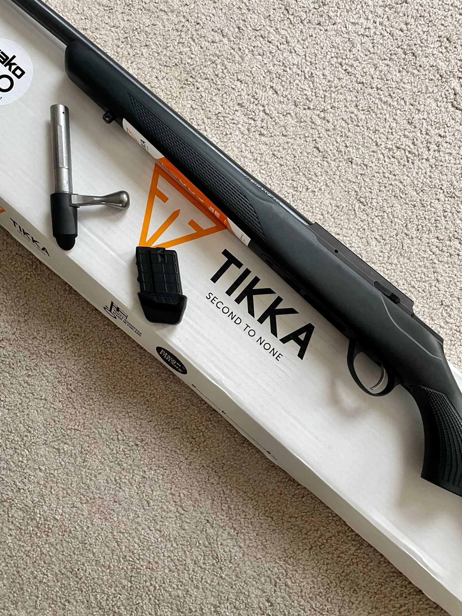

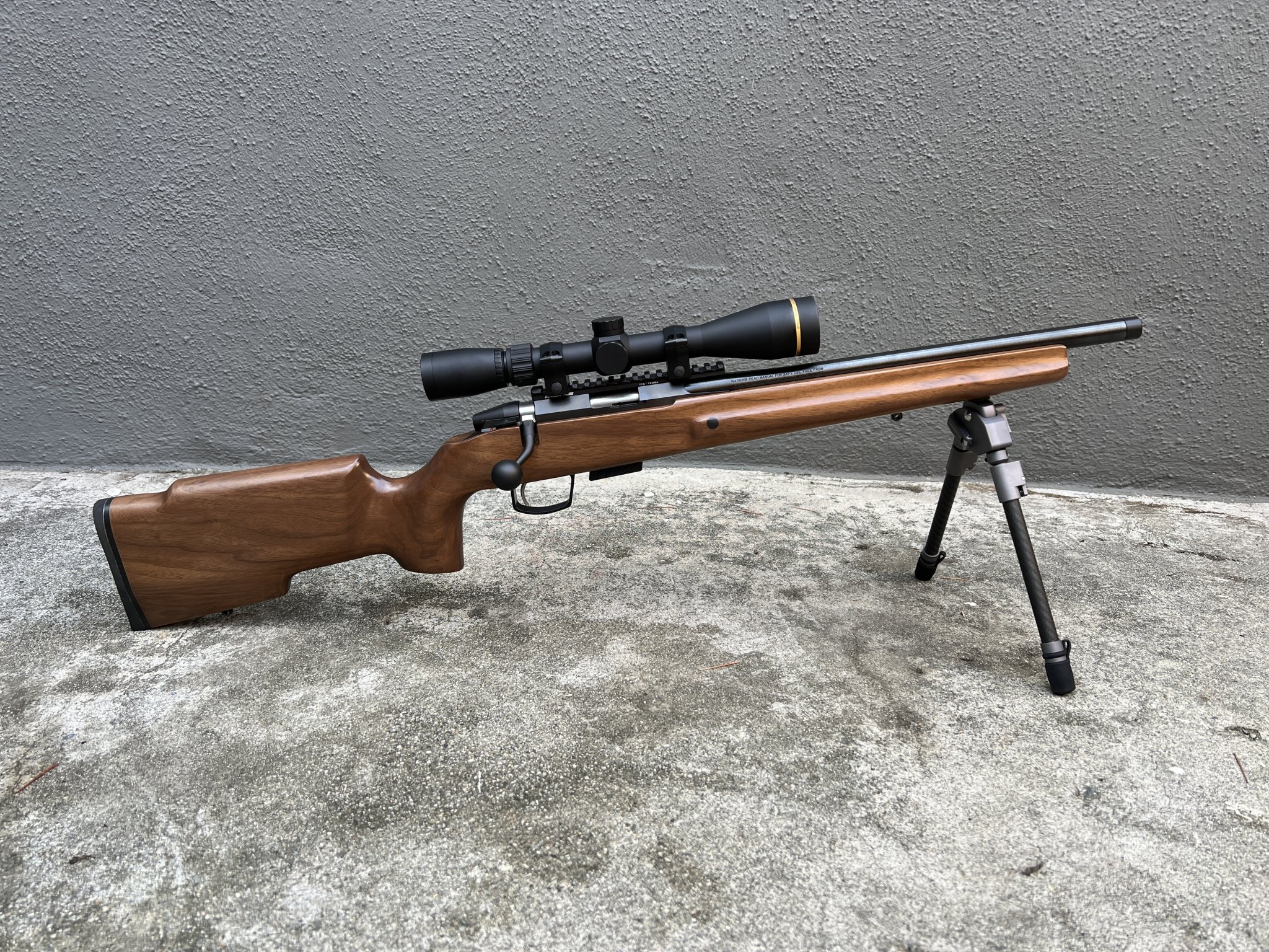

I've been wanting a 22 LR for awhile to practice fundamentals, shooting small game, and to have a cheaper shooting option for target plinking. I was looking at the Ruger 10/22 for some time, but thought a bolt action would be better for having something as close as possible to my 700 and B-14 HMR... so I've been on the lookout for a T1X (seems like the best option out there at this price level), as I also would like my next hunting rifle to be a Tikka. Their actions are ridiculously smooth.
Anyhow, I managed to find one yesterday at my local Scheels! Pretty stoked and excited to take it to the range. I just ordered the Area 419 30 MOA rail, seems like a good option? I might throw a KRG Bravo on it eventually.

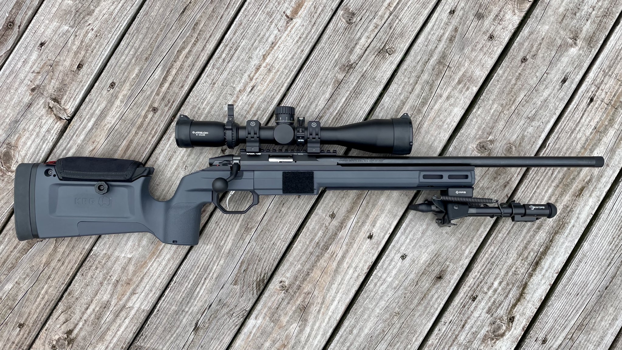

DIP 25 MOA Scope Rail
American Rifle Company Rings X-Low 30mm
Bushnell 6x24 Match Pro Scope
Tikka Vertical Grip
Tikka T3X Recoil Pad
Bore Tech Cleaning Rode Guide T1X
Bore Tech Proof-Positive Jag 22 RF
Bore Tech Proof-positive Bore Stix 22 RF
Wiebad Tac Pad
Atlas BT46-NC Bipod
Really Right Stuff Bipod Adapter (Atlas Bipod to Picatinny or Arca Rail)
Really Right Stuff 240mm Arca Rail
Edit: Forgot a few things
WeatherFlow WeatherMeter - Ballistic one has been OOS for months. I felt this was essential because I need something that tells me what X mph wind is like in real time so I can learn what it feels like and make calls. Anything else is just guessing and a waste of time.
Strelok Pro Ballistic app (works with the WeatherMeter)
Range Finder
Torque Screwdriver - for rail, scope rings, setting action screws
YoDave Trigger Spring - really makes the trigger put a smile on your face
