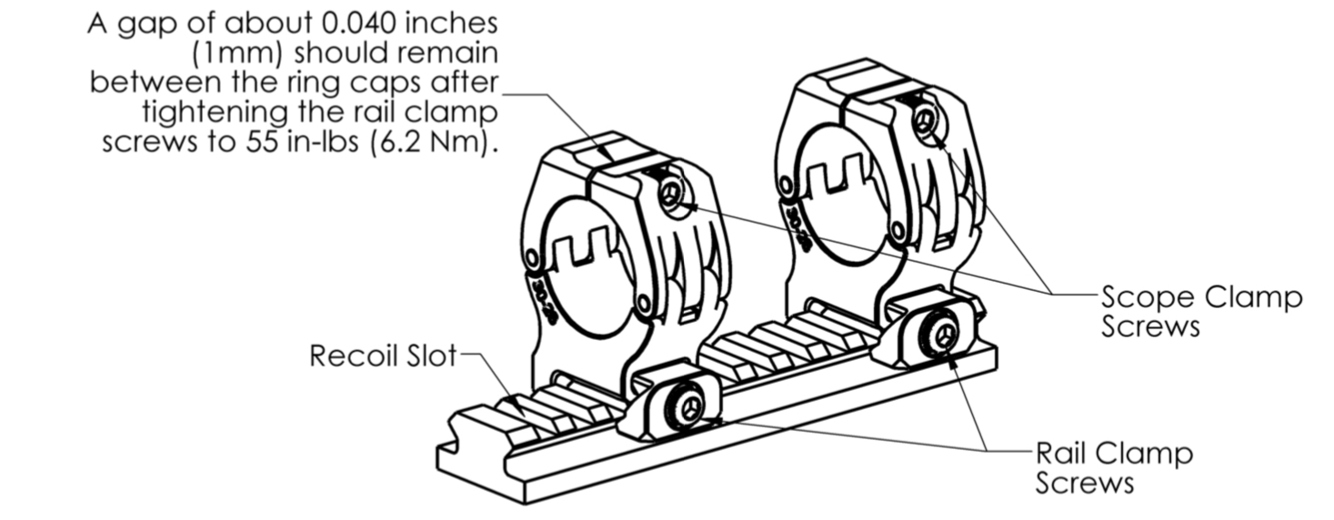

Yeah I’ve used these rings on every scope brand even up to 55inch pounds. Never had an issue. It’s weird for sure.
Every reference on ARC's site is as you said....a dab of oil on the threads and screw caps (per ARC) and then 55 in/lbs for both rail and rings. As far as I can tell, your M-brace incorporates the same basic ring design as the M-10 which I have on a 6.5 cm with a Mk 5 5-25 in them and I love them and never have had any issue. Building a new gun now and will put M-10's on it also...with an even more expensive scope ! :cool:

I understand the different tube part of the scope..... but if the rings had a slightly different height (either because of them or a bad rail) and with how solid of rings they are- could that be bending the tube and loading the scope enough that it would transfer to the ocular lens?

Still no word on what manufacturer, huh? $4k+ puts it in TT and S&B. If it was TT, their manual clearly says do not tighten the rings over 15lbs regardless of what the ring/mount specs say.
Actually this is fair. I did notice that sticker on my TT as well and wondered whether or not ARC was still acceptable, though Vortex tested years ago that 55in-lb in ARC rings was fine for their scopes.

Any of you geniuses want to point out how squishing on the main tube with a pair of rings puts any stress at all on the ocular lense?
I can. Forces travel through a structure way beyond the point of application. It is entirely possible for a compressive force applied in the middle of a scope tube to affect something else at either end.
I can't say for certainty that is what is happening here. I would need a very detailed 3D solid model of the scope and finite element analysis software to tell.
But I can tell you without a shadow of doubt that forces applied at some point in a structure do not limit their effects to the point of application. It's engineering mechanics 101

@Bsutton2010 - If I were you I'd firmly request they replace the entire ocular housing & not just the broken lens. I could see an imperfection or embedded debris in the housing at the glass edge causing a repeat failure.
There is a big difference between 1 screw torqued 50-55 inch pounds in a rigid cap verses 6 smaller screws x 22 inch pounds. The torque doesn't matter, clamp force is what matters. I seriously doubt Jeff Huber recommended torquing ARC rings 18inch pounds.
