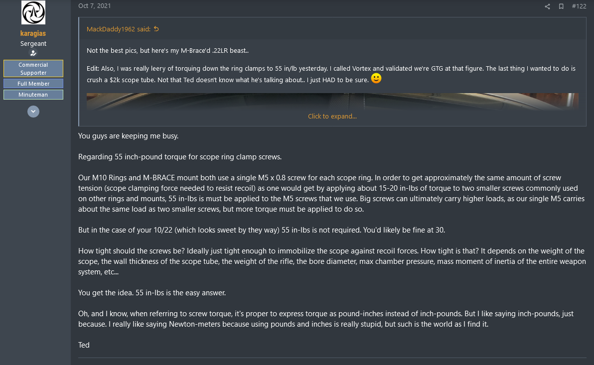

I'm with you 100% on this. I have never owned or used ARC rings, don't care for the design, just my personal preference. But even if I did, no way in hell I would be torquing the single bolt to 50+ inch pounds. In a previous post someone posted one of his emails where he likens tightening his single bolt to 55 inch pounds being equivalent to 25 inch pounds on a two bolt, traditional ring. If that's true, 25 inch pounds is WAY too much torque on a traditional ring setup. 15 inch pounds has worked perfectly for me on dozens of guns. Nearly every scope manufacturer on earth recommends 12-18 inch pounds MAX. Not sure what the equivalent would be on ARC single screw rings, but I bet it's a lot less than 55 inch pounds.
I'm still going with the OP over tightened the rings and damaged the lens.
People love to overtighten and break shit, it’s just about their favourite thing. 55 inch pounds is retarted and the rings are hideous.
Reactions: Tokay444
most rings don't have hinges, so i don't think we can assume 18-20in/lbs or whatever is typical for 2-piece rings.
i would guess it could be a dimensional defect in the rings (too small) or something as well.
Yes, let's ignore the ring manufacturers instructions. Sounds like a great idea.

Dang, lot of tards here that have no idea how bolt size or number relate to clamp force, but are damned sure that anything over the patented Vortex 18 in-lb limit is "Bad, M'kay".
Ironically enough, Vortex has acknowledged that the 55 in/lbs for the M10s are good to go.
@308pirate - hello my friend...you seem to have a good bit of knowledge about clamping forces, torque specs, etc.
Is there any way to relate a single screw at 55 in/lbs to...for example...a four screw cap ring at 18 in/lbs?
Or, I suppose, looking for relationship of number of fasteners to torque spec. Not sure I have defined the problem correctly but I think you may know where I'm coming from on this.

Would need to know fastener sizes and lengths for a rough calculation of clamping forces

Gentleman,
My apologies for the absence on this topic this week. We've been going through a few items and have obviously been very busy catching up from SHOT. I've spent some time consulting with our engineers and looking at some design stuff and just haven't been on here as much to check in on things. Again, sorry for the absence.
It is quite frankly impossible to provide one single specification on ring cap screw torque values to cover every single type of rings design and application. If we had to give a single number to cover as wide a variety as possible, our official recommendation would be 25 inch pounds. I understand the sticker in the box says 20, that's already in the process of being changed. There are just too many variables to take into account such as lubrication on the screws, screw size, number of screws, etc. to provide recommendations on every situation possible.
We will also go ahead and say that at no point do we recommend going to 55 inch pounds even on the ARC rings. We have been a huge fan of their rings since day number one however we prefer to use 35 inch pounds on these rings. That is our official recommendation for these rings specifically for our products.
Common sense ultimately must prevail here. The ARC, Spuhr, Etc. rings are widely popular and in use throughout the country without any issues on our scopes. They are a great match to our products and we recommend them all very highly.

Based on conventional split rings OK but the ARC rings apply clamping
pressure to the tube differently so unless you are a engineer and do the math you cannot
make that statement.
Mate some lads are just retarded, the single bolt 55inlb thing has already been addressed 900 times in this thread..
Best (and only) thing to come out of this thread is an official confirmation from ZCO that ARC rings should only be tightened to 35 in/lbs.
I’m still curious what ARC has to say about the 35 in/lb recommendation, but I’ll be sticking to that guidance.
