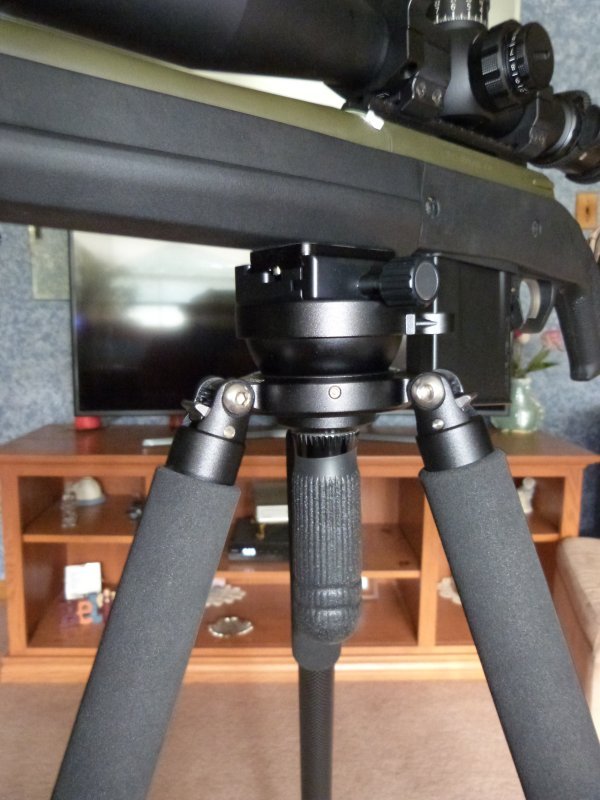

Here is the Calumet tripod with a fluid head with the TriClawps saddle attached with a Rem Mod 7. The gun weighs 8 lbs and the tripod setup right at 7lbs....not good for humping, good for long range stability.

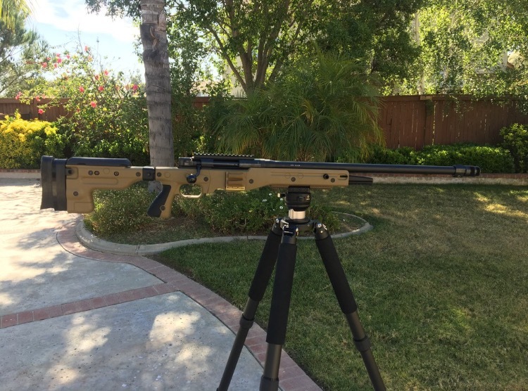

I have the Feisol 3342 ($388) with Feisol leveling base ($80) topped with a $20 clamp (from Amazon) that adheres to the ARCA Swiss standard.
All in it's 3.5 lbs exactly. Bison Tactical gave me the 5% SH discount and free shipping on the Feisol stuff.
Initially I considered the 3372 but there are quite a few shooters using the 3342 with success so I figured I'd pocket the money and weight difference.
I have the RRS front handguard piece (with integrated dovetail) on my AIAX and an $8 dovetail plate (Amazon) screwed directly to the Magpul 700 Hunter stock that holds my TL2/Bartlein 223AI barrelled action.
With this setup both rifles are impressively rigid. It's a really comfortable platform, and I keep my support hand on the "handle" under the leveling base and apply a little preload to add stability. The legs are long enough and can be folded flat enough to cover pretty much any height I could need.
One thing I did not like about the Feisol leveling base is the lack of grip available on the handle. It can be difficult to loosen the handle if it's tightened a little too much (the difference between dynamic and static torque) so I dipped mine in rubber tool coating with some sand mixed in and it's plenty grippy now.
I also picked up a pig saddle (little brother to the hog saddle) and the difference between a leveling head/dovetail mount on the chassis setup and the same rifle in the pig saddle is night and day. The small amount of movement afforded by the rubber grip inserts on the pig saddle is enough to make it really challenging to keep the rifle on target, even braced with a sling.
I also have an adapter to connect the dovetail mounts to a full size Manfrotto CF tripod with fluid head. It's not as rigid as the leveling base but better than the pig saddle. It's about twice the weight of the Feisol setup, too.
I'm pretty happy with the Feisol setup.

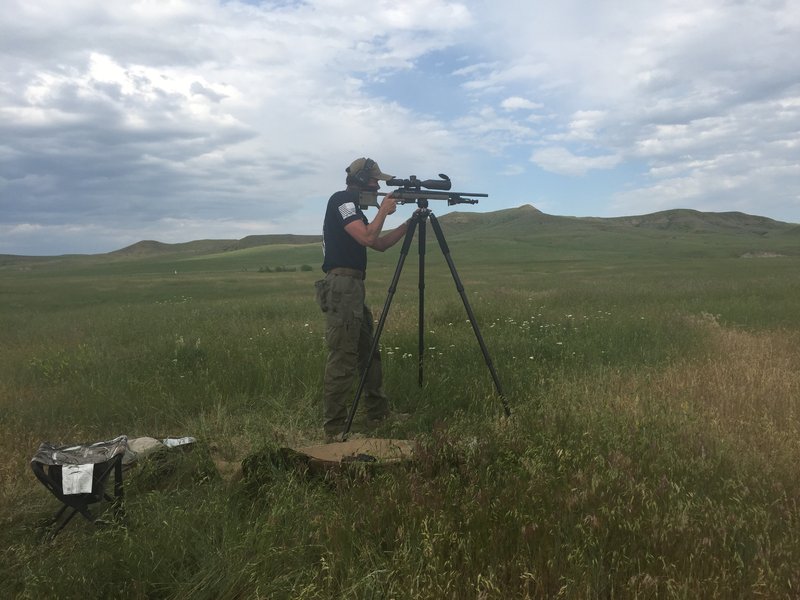

I tried a LOT of options when I was getting my setup. I was determined to do it on the cheap - I was constantly disappointed. In my humble opinion, I feel like I came up with the perfect balance of weight savings, cost savings, and stability. My setup is as follows:
Feisol 3342 tripod (https://www.bhphotovideo.com/c/produ...id_Tripod.html)
RRS Universal Leveling Base (https://www.bhphotovideo.com/c/produ...base_with.html)
RRS Arca plate directly attached to rifle stock
This setup is really solid for me. I tried a ton of lesser leveling bases and ball heads. Ballheads in general don't do anything for me, I like the leveling bases much better personally - mostly due to their compactness. I took advantage of a lot of return policies. Honestly, no matter which tripod you go with - you need a RRS leveling base. STAY AWAY FROM THE FEISOL ONE. I also tried a number of tripods in the budget tripod thread - returned them all. Some guys had some great luck with them, but I did not. The only other tripod I would probably recommend in the same price range as the 3342 would be the PRST sold by the Hog Saddle guys. Great tripod - but it has 4 leg sections instead of 3 like the 3342 has, and I found the 3 leg section tripods to be quite a bit more stable.
Another thing you need to know is that shooting off a tripod is not as stable as it looks like when you watch someone do it in videos. I just want you to have realistic expectations after you spend all that money. Don't expect to shoot your best groups off of it. It's a great choice for hunting and steel targets. In my last picture - it is a full downward rotation of the leveling base. It may not look like a lot in the pic, but it's been plenty for all of my situations - even coyote hunting in the Cascades so far. You may find a situation where you need more down or up angle - and you can easily adjust the tripod legs to give you what you need.
Lastly - if at all possible - skip the HOG or PIG saddle, and mount an Arca style plate to your rifle stock. My smith did it for me - but it's not a difficult job if you are comfortable working on stocks. It's also a LOT cheaper than a HOG saddle.

@devldog, I'm happy if I can shoot 1 MOA 5 shot groups from my tripod setup. Can't quite do it standing, but kneeling, seated, or prone, I can. I don't think I could shoot 1 MOA in any position with just a pig saddle or support, though... it's all in the rigidity added by solidly coupling the rifle to the tripod.
@anchor, The Feisol leveling base is either locked or loose, there's no in between with friction or drag.
I loosen the handle, reposition the rifle, then snug the handle.
RRS claims their leveling base has fluid motion when unlocked, so maybe it is worth 2.5 to 3 times the price of the Feisol unit, but I'd have to try one before I'd spend that kind of money on it. Their use of the term fluid may just be describing a small amount of drag that their unit has inherently (from the weight of the equipment) since the aluminum inverted dome moves in a plastic cup (at least as I understand it) whereas the Feisol unit is hard anodized aluminum sliding in hard anodized aluminum which has practically no friction at all when unlocked.
Nice looking rig DevlDog....for the fellow Jarheads here, I had the honor of attending the wake of Capt Aurthur Jackson, USMC, a MoH recipient today https://en.wikipedia.org/wiki/Arthur_J._Jackson
