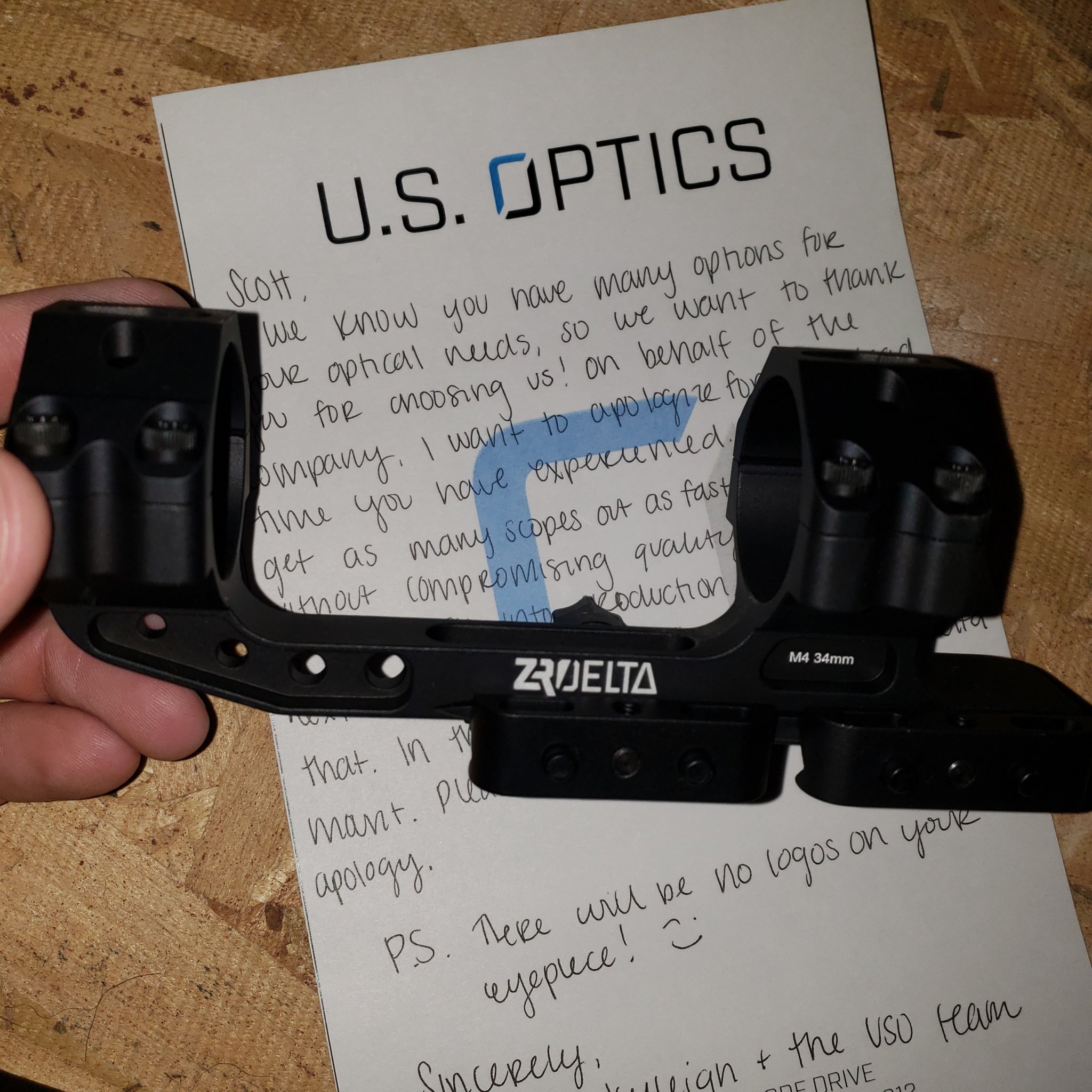

Sounds like production will be going in 2 weeks. They're off to a great start with me ? FDN17 logo free with MGR reticle.
I just got a shipping notification last week that they were sending me one of those mounts. I was a little confused. I was too busy with work to look into it deeper. I didn't know if it was a mistake, but I suspected it might be a bonus for the long wait. Looks like you confirmed it for me, since mine has not arrived yet.
Reactions: D loop darrell
It should soon. I have a Warne Skyline mount already. I like em both. The zro is definitely a step up. But if you want flush mount, Warne is great.
I actually called them like the morning they were gonna start calling folks with b17 orders. So she took all my info when I was on the line.
Well, that's pretty badass!! I already have a set of Bat rings and flip-up caps waiting for my scope to arrive.
I noticed that note is signed by Kyleigh! She's a down-right pleasure to talk with on the phone! I suspect she could sell icewater to an Eskimo, without even trying.

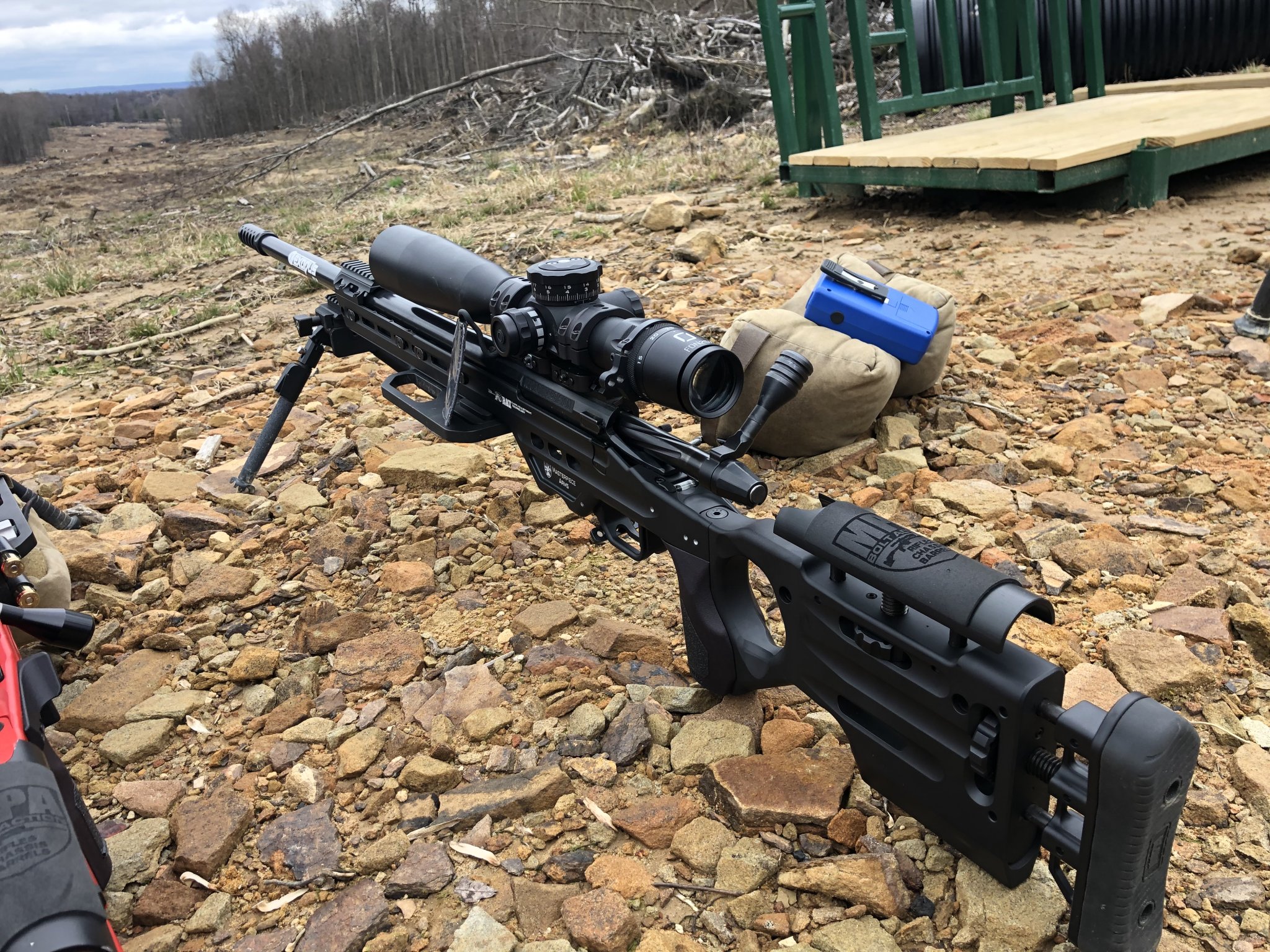

Awesome optic. Didn’t spend a ton of time staring through this comparing it to other optics but I spent enough tome to aee
It’s good darn good glass. I mounted it and went straight to shooting and testing out the tracking. Scope performedFlawlessly

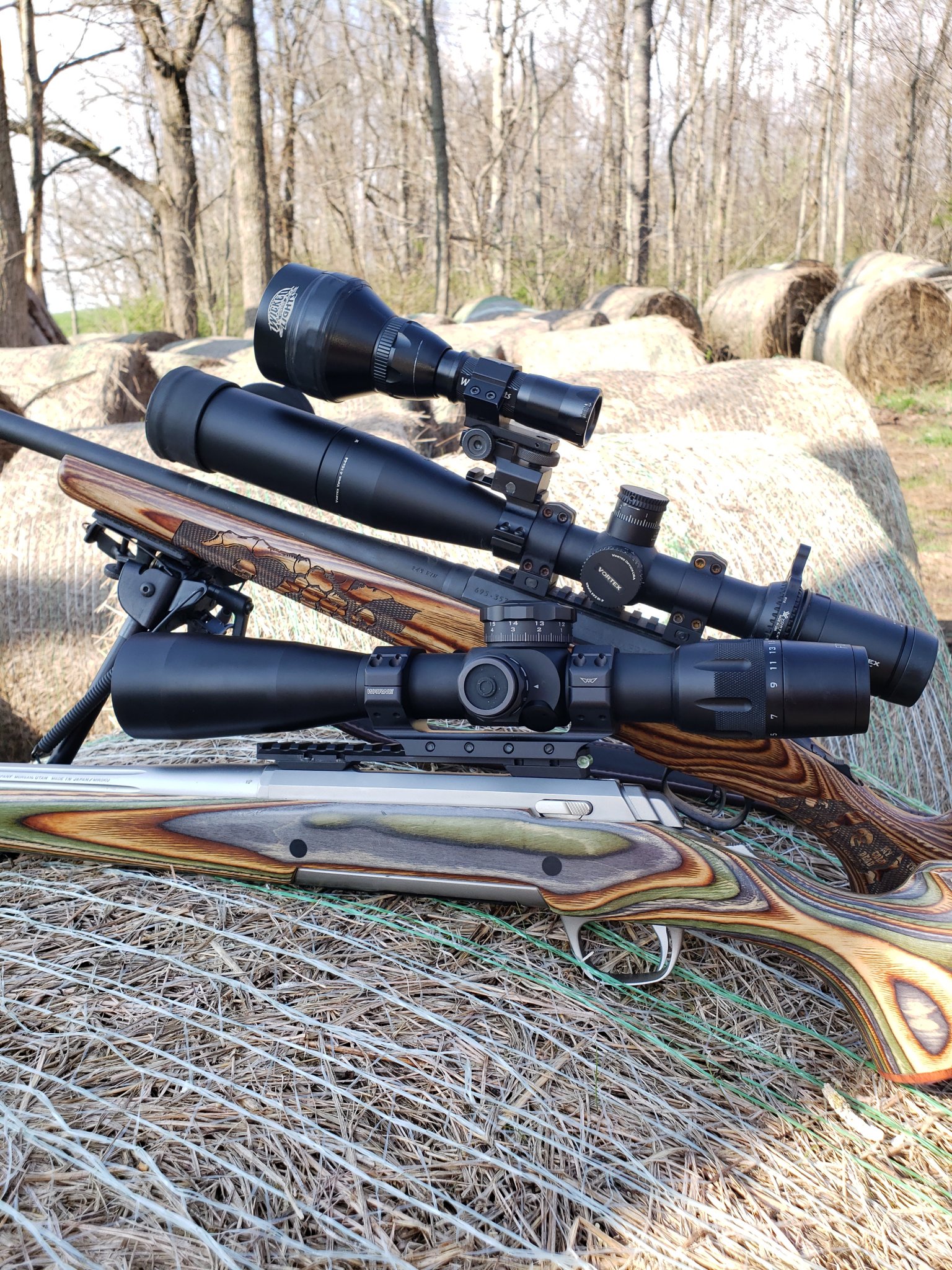

Got my FDN17. I put it on a 20moa rail and all I had to do was go 2 clicks up. Glass looks good to me. Looks much brighter than my cheaper scope. I can't really say if my RZR hd lh is as sharp or not. It's close ya know. I love the feel of the elevation knob! The mgr reticle looks great. I love a floating dot. Hella tuff feeling. I mean, this is meaty scope. I put it in a Warne Skyline mount. I like it. The battery compartment is odd. It works. You just have to push down on the center and screw the cover on. It tripped me up at first too.
Update 1, at night the illumination is dead on. I mean absolutely perfect. I'd have to bet set 1 and 2 work with nvg. The, oh geez... focus knob on the left, I was kinda eh about it. But at night, it's so easy to see if there's any light. 200 yard shots with clear night skies and some moon light are gonna be easy. I'm gonna have to put it on my 243. How loud do clicks have to be? Isnt the goal to be quiet? I can hear them. Sounds great feels great. I knew I'd love the big knob! Oh. The larger numbers on elevation make it super easy to read without moving of you're shooting with both eyes open. I dont have much ti compare besides the razor sharp vortex razor HDLH. If all I cared about was weight savings and sharp glass (which reminds me) get the new HDLH v2.0. That extra sharpness comes at a cost. Anytime I've ever tried using the HDLH with the sun behind me, a garage light, or a bright moon, the eyepiece would severely reflect that light. I noticed it right off the bat. I was looking through the FDN17 and switch to the HDLH and as soon as I looked through it I noticed a much stronger glare on the glass. I'm super glad I got it. The HDLH is on my 22. But if I had to pick one to keep forever and destroy the rest, id pickup the FDN17 and smash the other ones. Can't wait to get up on the hill tomorrow. Best quarantine thing yet.

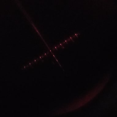

Uh oh! Mine is going back. Illumination and reticle not lined up. Mgr reticle. You can get below where you can see through the scope and line up the stuff. For something so hands on it kinda burns worse. Nobody there saw this? Idk man. Boxed up. 2and poc is taken well below where my eye would be.
That's unfortunate! That should definitely been spotted by QC.
Hopefully they will get you taken care of quickly. It would be a shame for them to burn the last few customers willing to take a chance with them.

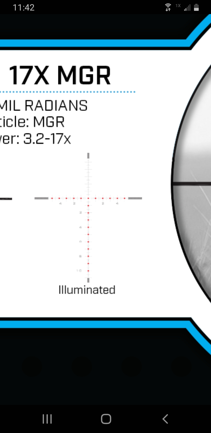

Really trying not to be salty about it. But as soon as I ipenes8it the illumination wasn't coming on. Replaced their 3v GI battery with an energize and walaa. Illuminated. I was happy! Then, the more I looked... I realized it wasn't even close to what they advertised. If they couldn't see that that was wrong idk man. It didnt jump put at me at first. Mostly because you cant see the illumination in the daylight. It's the first day I've really had it. I feel like they sent me a used scope tbh. Just trying to pawn one off because I got a veteran discount. Just because I like to make sense of things ya know. I just cant imagine anyone who knows what the mgr reticle illumination should look like would send that out the door.

Hi there,
I'm sorry to hear that you are not satisfied with your MGR reticle's illumination. The MGR reticle illumination is designed to only illuminate the dots. By doing so a back light is seen across the entire reticle. It can be seen prominently in high settings from the right side (where the LED is located). The reticle and illumination are not misaligned, and this does not reflect the quality of the scope’s functionality nor does it imply a mechanical defect. Any of our reticles designed to partially illuminate (i.e. IGR and MGR) appear the same. We do offer many reticles that are fully illuminated that illuminate much clearer across all settings. We apologize you are not satisfied with your reticle, but it is my understanding that our team is already working with you to ensure we meet your needs and expectations. If there is anything else you may need, feel free to shoot me a PM or reach out to our team at 828-874-2242.
Hi there,
Update! Everything Maggie said is exactly what I see. Josh called me this morning and was willing to change the reticle. I put my scope back on my rifle and looked through it into the pasture, today, with gloomy conditions, it looks really good ? I just wasn't really sure if it was misaligned. It isn't. Other than that small hiccup. This is an amazing freaking optic you guys ? Hated getting upset about that. Now that I know what I'm seeing and why I am a very happy FDN17 owner. Buy Carnival cruise stocks!
Hi there,
Thanks Maggie. Everyone was really helpful and understanding. I really didn't wanna send it back because I absolutely love it.

It's always been standard practice that when using an illuminated reticle, or when using a red dot such as Aimpoint or Eotech, to reduce reticle bloom by using the lowest setting that allows you to clearly see the reticle.
So, if you take the scope into a reasonably low light room and set the illumination on the lowest clearly visible setting, does it look clear and sharp?
