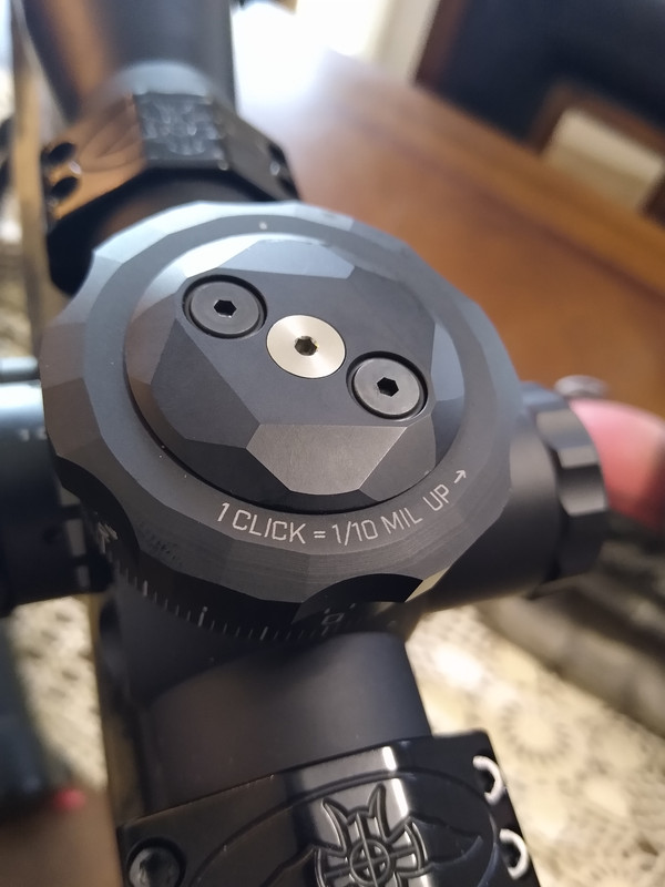

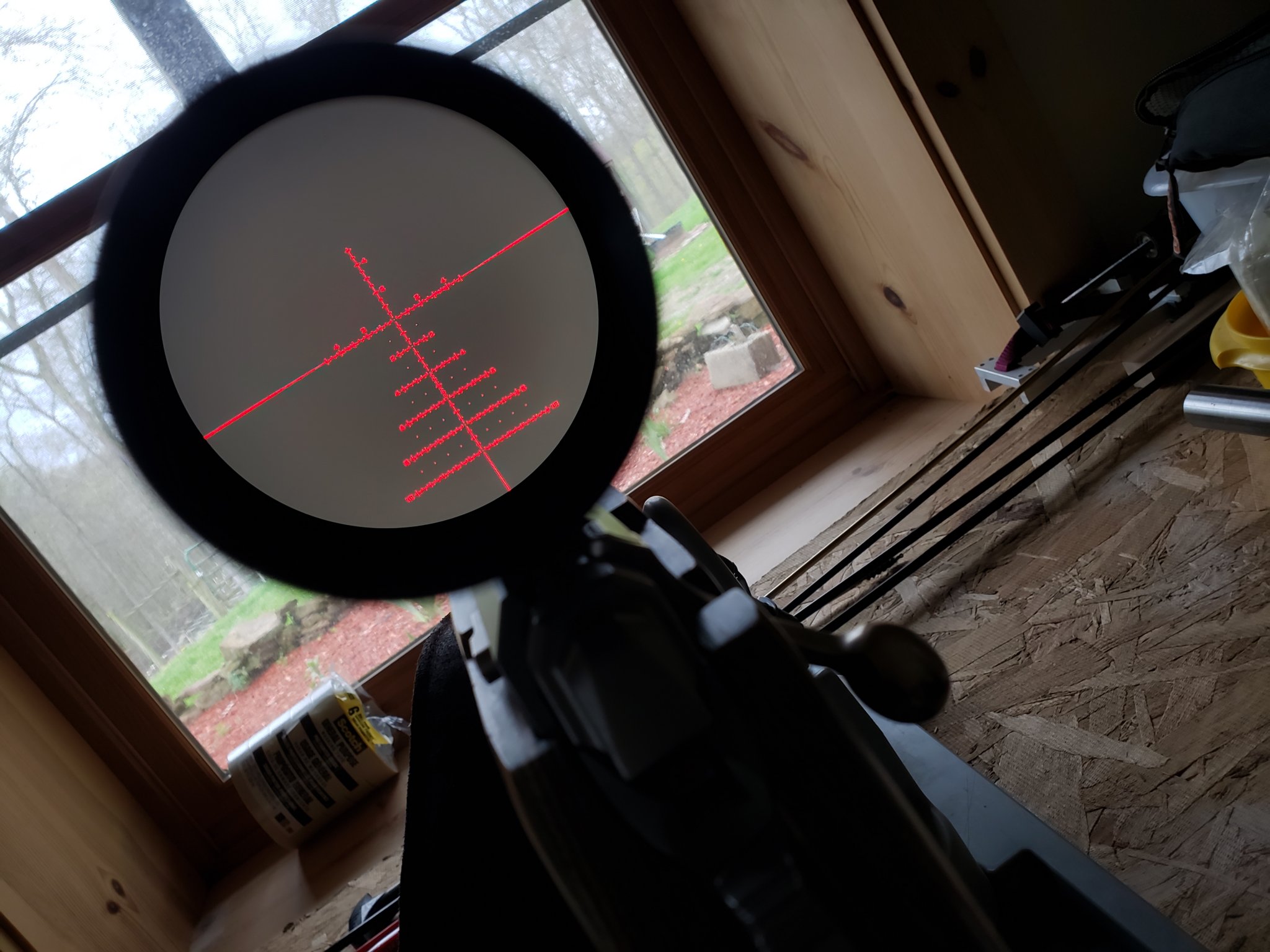

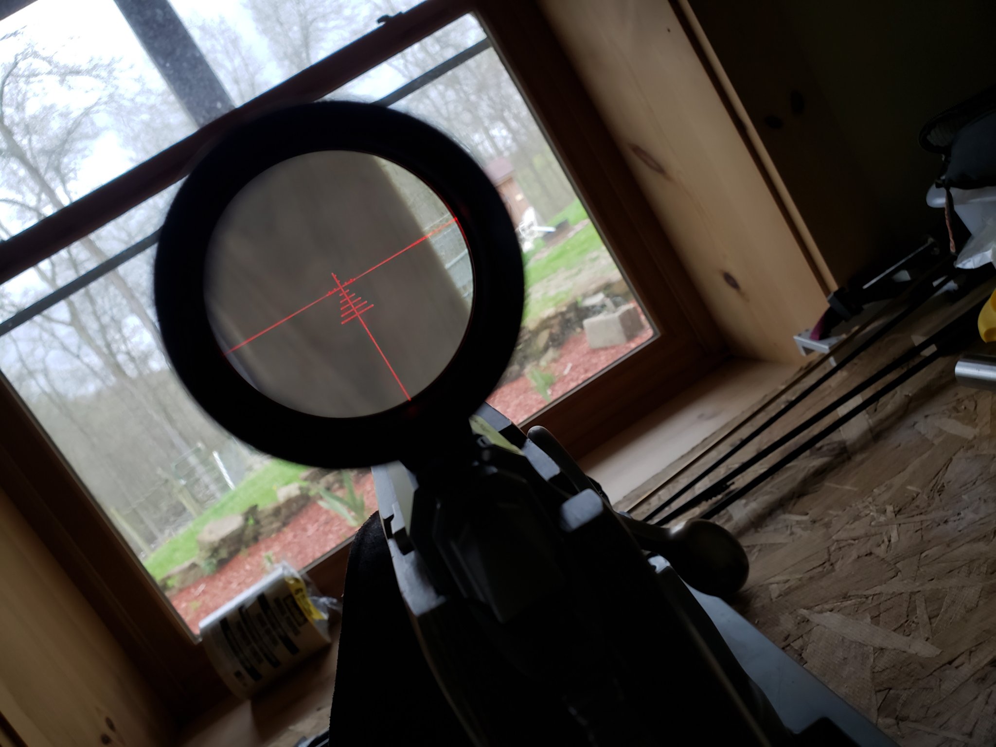

Update! I had no issues or surprises today. Unboxed scope, illumination looks great. The JVCR reticle is really nice. Again, first thing I noticed is the muted glare on the eye piece. Sun is directly behind me and I was trying to make it reflect hard, like my cheaper scopes do. There's hardly any reflection at all. My other scope has damn near blinded me a few times. I'll update in awhile. I have to put my steel out to 600 and get things setup. I dont forsee any issues. I have 1200 yards here behind my house to shoot. I am a happy customer now!

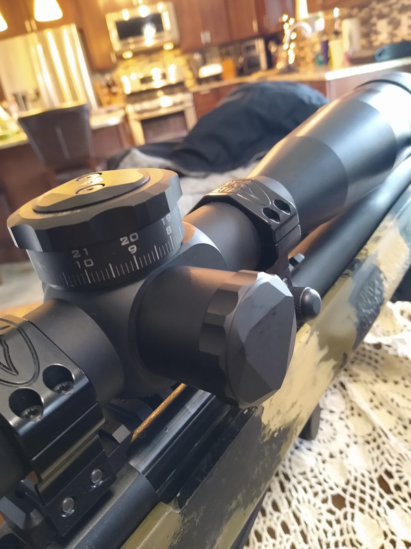

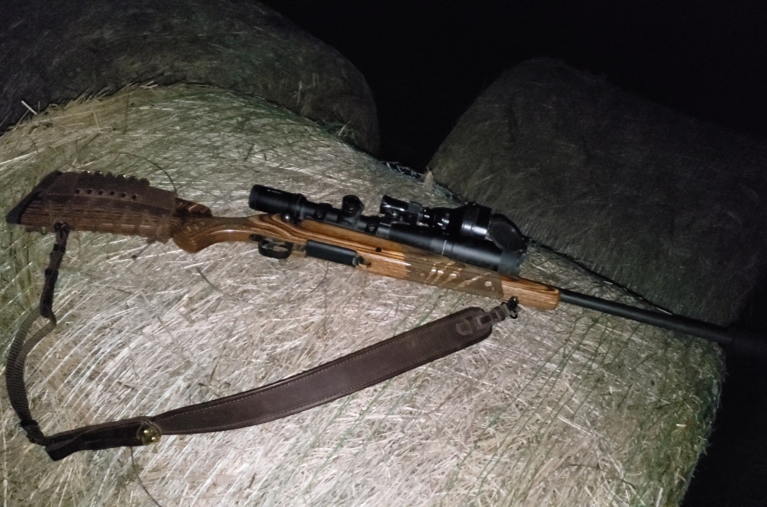

I like it! Instagram link Shot it yesterday but left my bipod at home. Shot today out back. Ran out of bullets. I have a box of super match grade stuff that I'm not using for zeroing. It's sharp as hell 👍 Zeroing it is different. You remove a cap screw on top, then adjust the elevation using an Allen wrench. It's stupid easy as long as you dont drop the non magnetic center cap screw. Seems to track well for the little bit I adjusted it. Oh what else... The illumination is great! The drip down subtensions with a floating center dot. Is great. I have 30 mils of useable elevation. It's cool man. I like it. Plenty of windage adjustment. Two full rotations (clockwise) and some change to bottom out elevation into the scope. So, two full rotations back is my windage zero. I bought it for all the features that I enjoyed today! Dony lose the center cap screw... photo is the center cap screw 🤣
Reactions: ken226
30 mils useable elevation? That's a good bit more than listed for this scope on thier website. That's significant!
Are you using a 20 moa base, and Is that 30 mils useable, after zeroing or before? I was expecting like 24 or so, total.
So, after zeroing , with a 20 moa base, I was expecting about 17 mils useable.

I have 30mils, from my 100yard zero. No hold over, just clicks. The way you move the reticle independently from the turret, allows the scope to use nearly all of the elevation. It was one of the main selling points for me. I am on a 20 moa rail. Now, I haven't shot to see if it accurate. I have just dialed it all the way up and counted. It's like a 9 ft hold over at 100 yards. Meaning, if I dial 30mils, I have to hold over 9ft to be on target at 100 yards. Been thinking of ways to check the elevation at that extreme without shooting far.

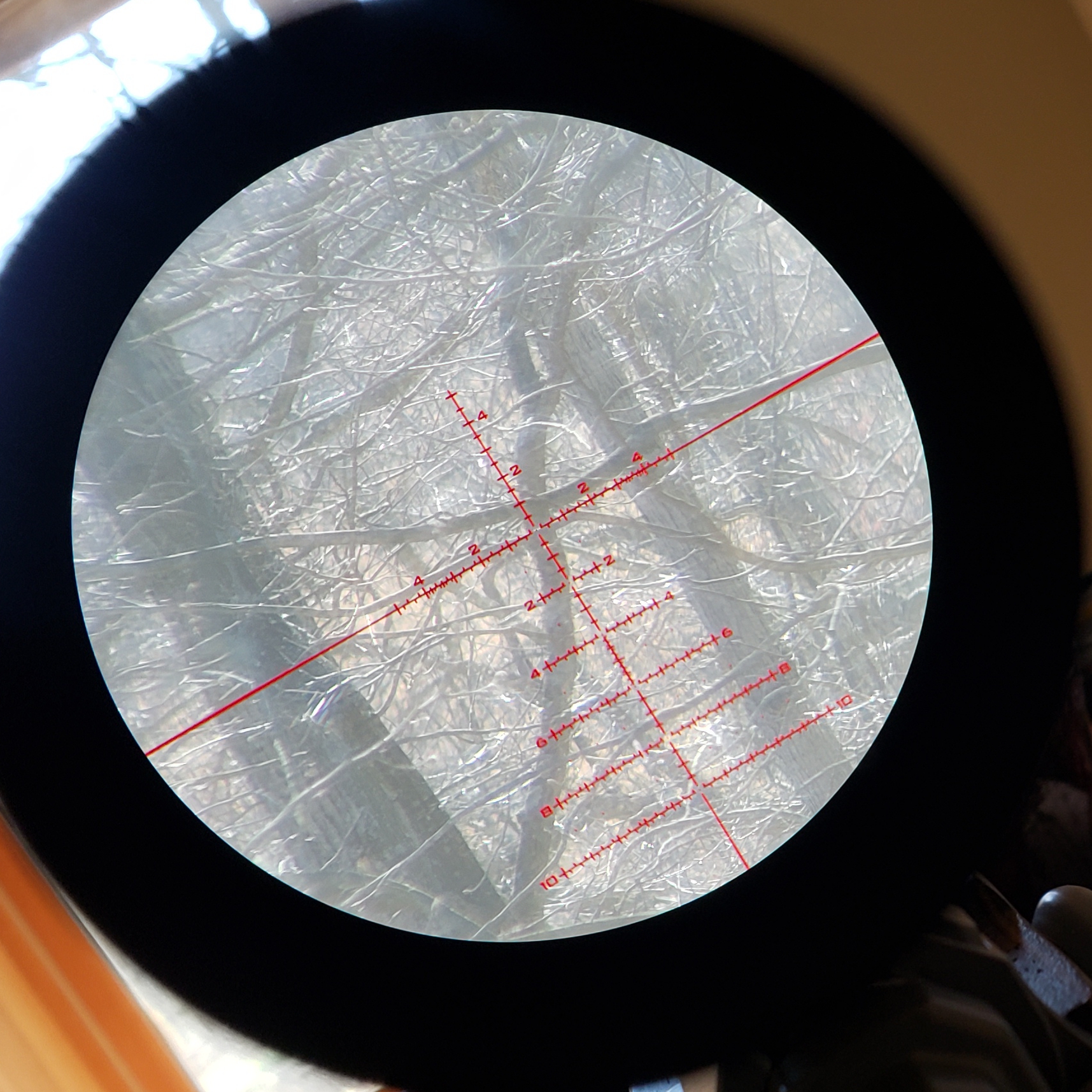

Tunneling is there. 3x to 5x. It's just a black ring on the edges of the sight. Its thickest at 3x and gone by 5.25x. Does absolutely nothing to the super sharp image quality or reticle sizing. Illumination does show as a ring at those levels, but it's really muted and gone by 5x+. Huge non issue to me. Just looked at it again. Doesn't show in photos much. It's nothing imo. Thicker edge. It resembles a tunnel. But not in the glass. No distortion in glass. Very good! Would buy again.

This is 17x. No tunneling at all past 5.25x. Once you see it and understand what it is and isn't, it's something folks wont care about. I love at like 8x and above when I'm out. Oh! Get a one piece mount! You can drop a red dot on your rifle and carry it to your camp. Then mount your optic. Cuz lazy

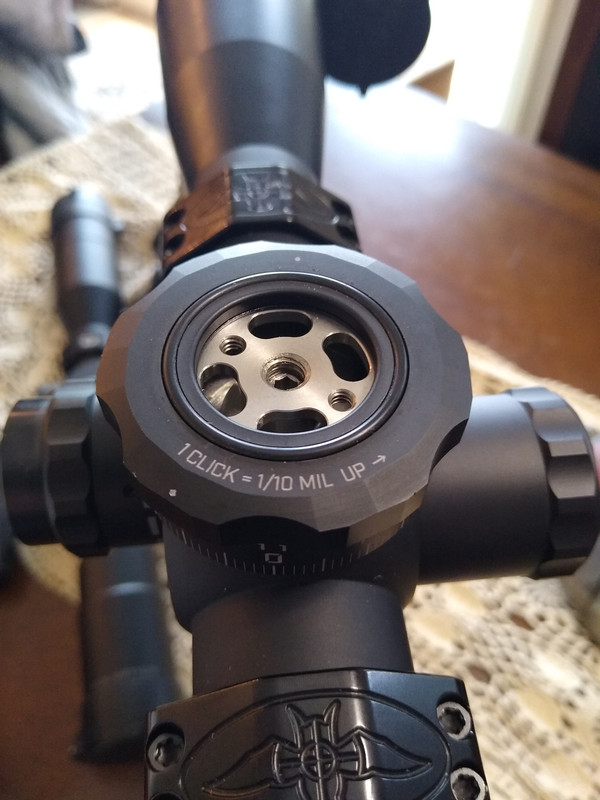

The new Er3k turret zero-stop is feature is interesting. I havn't seen any design even remotely like this before. I really like it's simplicity.
The zero stop ony has 1 simple part, a ring which engages a raised boss on the scope body. The zero-stop ring has 3 tiny grub screws around the circumference, which -can- be used to secure the zero stop ring to the turret. Those grub screws are unnecessary and should be loosened out a turn, then forever ignored (maybe even removed and thrown away).
That zero stop ring sits on the turret and rotates freely. After you've zeroed the rifle, you simply position the zero-stop ring on the turret, and rotate it clock-wise until it is stopped against the raised boss on the scope body. Then you put the knob on and float it to zero. Once the top cap is tightened down, the zero-stop ring is pinched between the turret and the top cap. Any clockwise movement past zero is halted by the raised boss. When dialing couter clock-wise for elevation, the turret/knob/cap threads up and on the next rotation the zero-stop ring is above the raised boss, and clears it.
I like to set my zero stop with .5 mils available under my zero, so i can adjust between my suppressed and un-suppressed zero. That was easy to accomplish on this scope. Simply zero, then turn the turret 5 additional clicks clockwise. Remove the knob and cap, set the zero stop and float the turret to the -.5 mil marking. Tighten everything down, and go the 5 clicks counterclockwise back to zero.
Overall, i really like the zero-stop. Its easy to set, and gives a very solid stop.

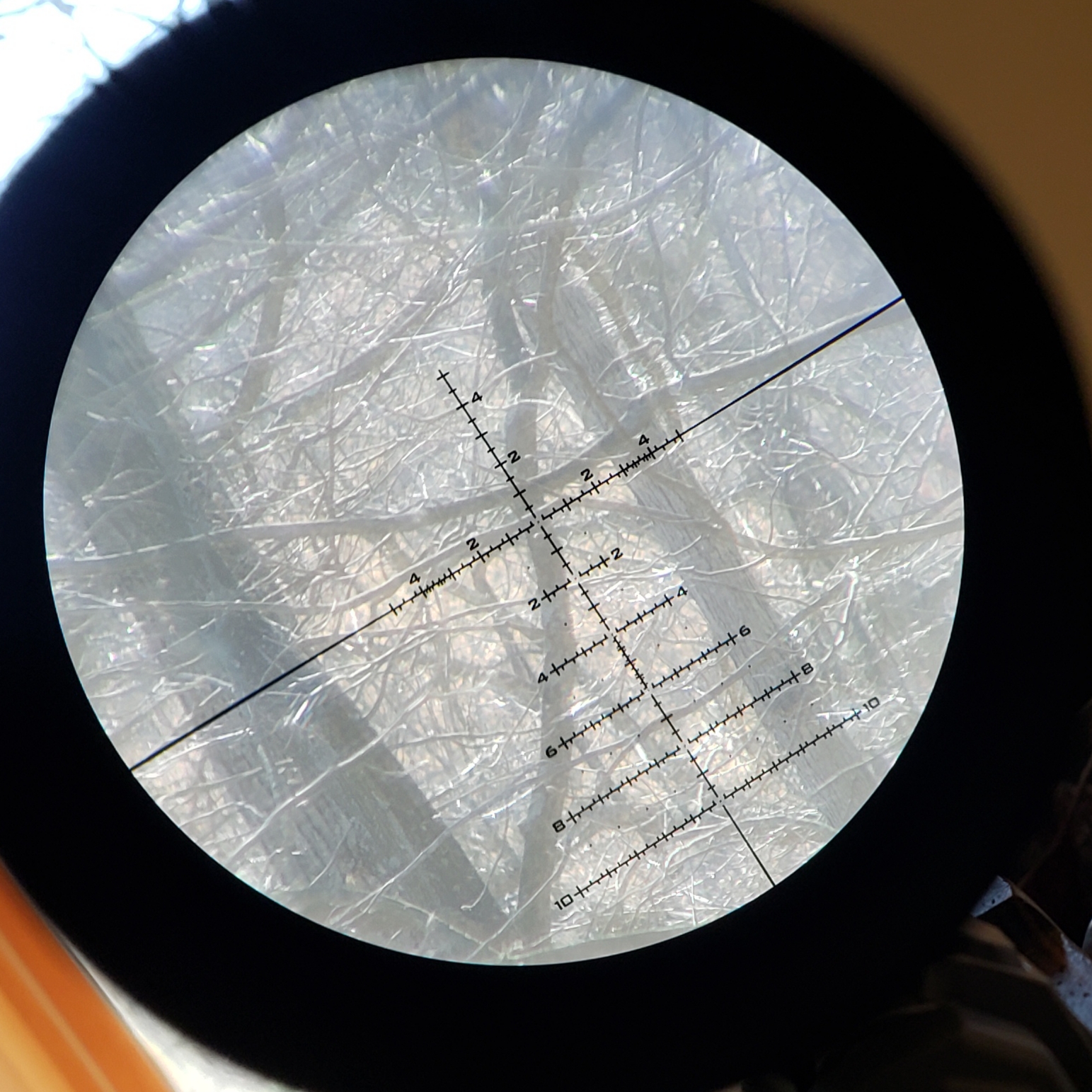

I took it out today and did a tracking test.
All my through scope pics turned out to be crap. The target was bright and clear through the scope, but in the pics, it looked too bright to see the markings. I ended up with one pic that just barely showed the target markings.
u
The target was a grid of 10mm dots spaced 10cm apart. The horizontal lines are 1/16 thick and spaced vertically 2cm apart. I set up my tracking fixture @ 100 meters.
Starting with the 10 mil reticle hold at the top right dot on the target, I checked the tracking through 17 mils of elevation and 5 mils of windage in each direction.
The tracking and reticle subtensions were spot-on. If there was any error, it was less than I could detect with my eyeball and scope fixture.

@koshkin, I'm glad you mentioned the battery box. That made me consider the possibility that the 3 button rheostat from my older USO might work.
I swapped them out, and it works perfectly, but rotated 90° clockwise. It's still a little odd in design, to change the battery, but I'm getting used to it. The older 3 button rheostat works in the FDN, and gives the option of leaving it on a specific brightness setting then using the on/off button to deactivate it.
Apologies, I should have worded that more clearly. Burris states 3.5 to 4" from the max (18x) to min magnification. I meant that the difference would be "about" or close, to 3/8" or .375" @ 17x. I think when the term about is used, Sheldon allows rounding to one significan figure :). Sorry, when I try to joke few people ever laugh.
I stated "about", because I haven't tried to calculate it specifically for the Burris @ 17x.
I'd try, but linear interpolation would only work if the change in eye relief with respect to magnification was linear. I'm not sure if it is or not.
And yes sir, I am not a fan of the battery compartment. My ST10 has a better illumination setup than the FDN. I may try them for interchangeability.
Edited to add:
