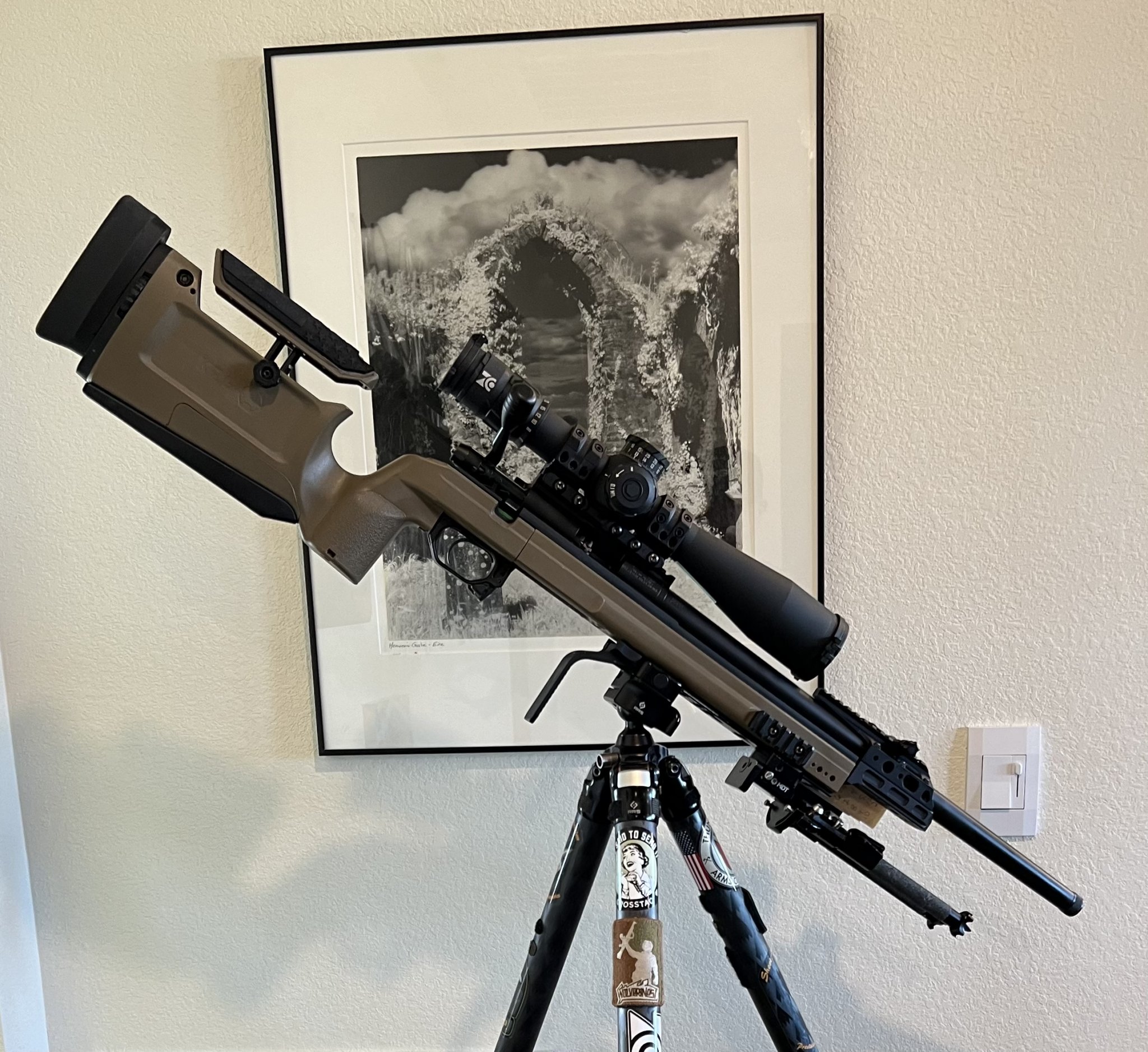

I'd like to get my Vudoo barreled action into a KRG stock. KRG says on their site they have extended mag latches for it but they don't guarantee proper function of the Vudoo in their chassis systems it seems. Is it likely to be a pain in the ass to get it working properly?
Womfat on Youtube has his Vudoo 360 in a KRG C-4 and didn't seem to have any issues with it. Not sure which KRG you were looking at, but it definitely worked fine for him.
Reactions: bnaples
My Vudoo 360 is in the KRG W-3 Chassis. When I ordered the barreled action from Vudoo, I was told to get the extended magazine catch for it from KRG.
I had to do a little filing but not much. IIRC, it took me about 15-30 minutes and after that it has worked great every time I've shot it.

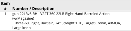

Just ordered my barreled action 🥳
Went with the 360 with a 24 inch 1.2" Straight Bartlein Barrel. They said it could be 3-4 months depending on Bartlein's delivery times for the barrels, but I'm excited and should have it in time for spring!
It's not difficult to get the Vudoo to function properly in a KRG....nothing at all magical about it.

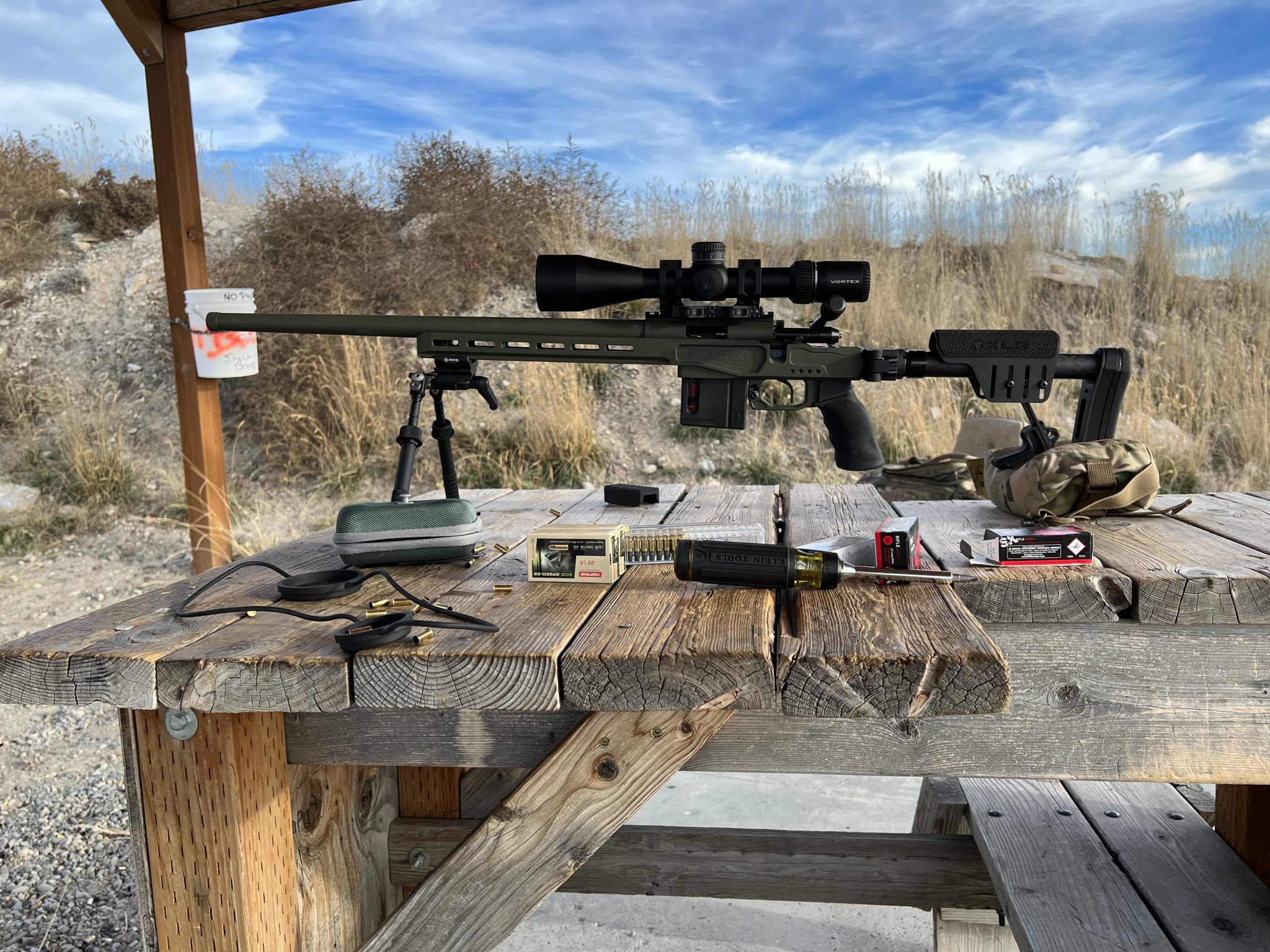

Just finished my new build. Next week I take her to Lapua to do some lot testing.
Vudoo "Three 60 Action"
Krieger 1.25" straight barrel finished at 25" - 1:16 twist
Modacam Custom Rifles barrel fitting and ignition tuning
Masterpiece Arms Matrix Pro - Anodizing by Outlaw
TriggerTech Single Stage Diamond
American Rifle Company M-Brace Rings
Zero Compromise ZC527
MDT Send It Level + Brandt Ocular Housing
Total build weight comes in at 19lb 13oz and balances just in front of the mag blocker

Beautiful rifle! Are you using any of the internal weights?
