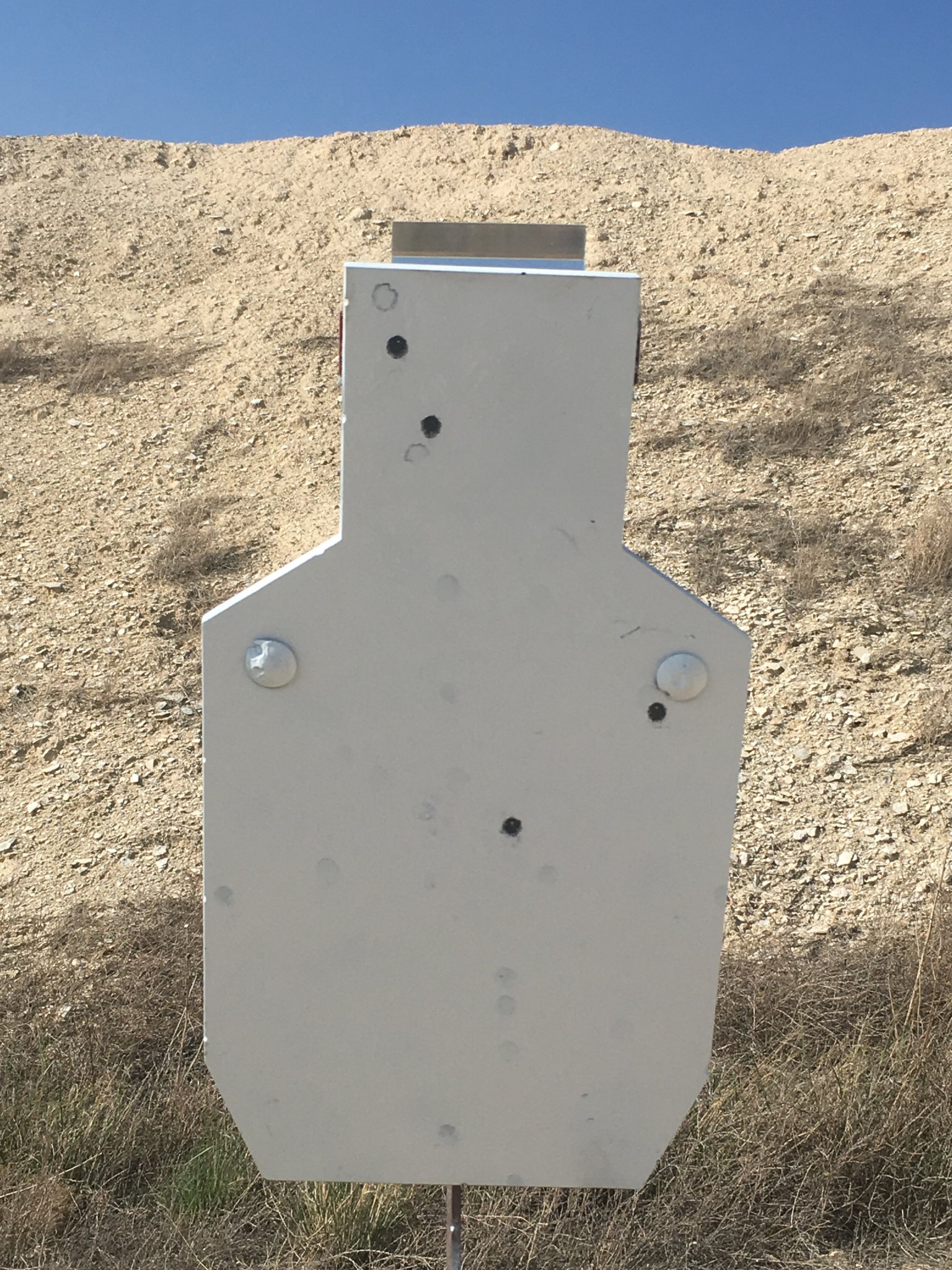

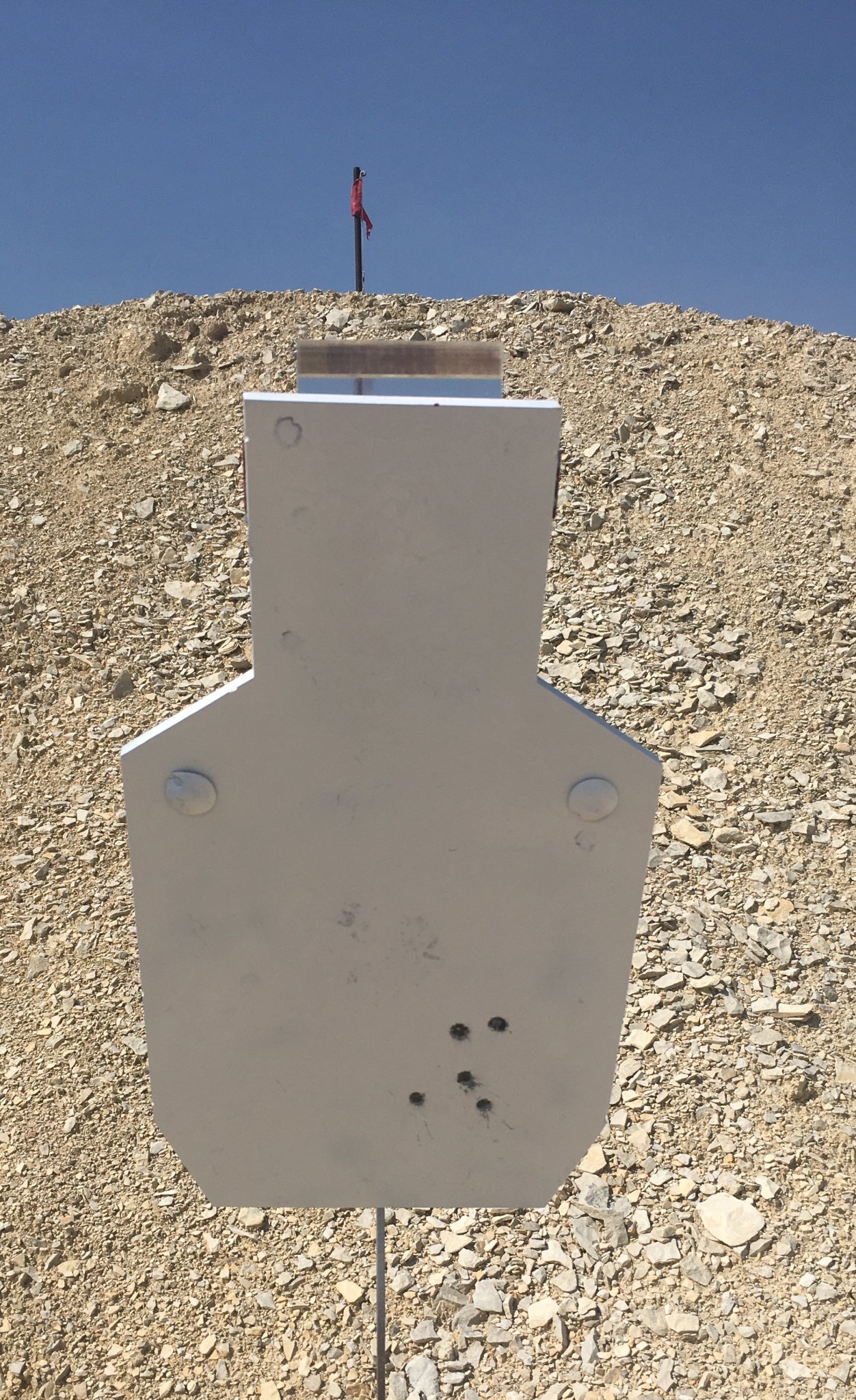

How far did you stretch out the good stuff?
400 and 600 yards. Eley red.
This target is about 12 wide and 18 or so tall.
Nice round group at 400. 4 out of 5 connected at 600. Not a clue where the missing shot went.
