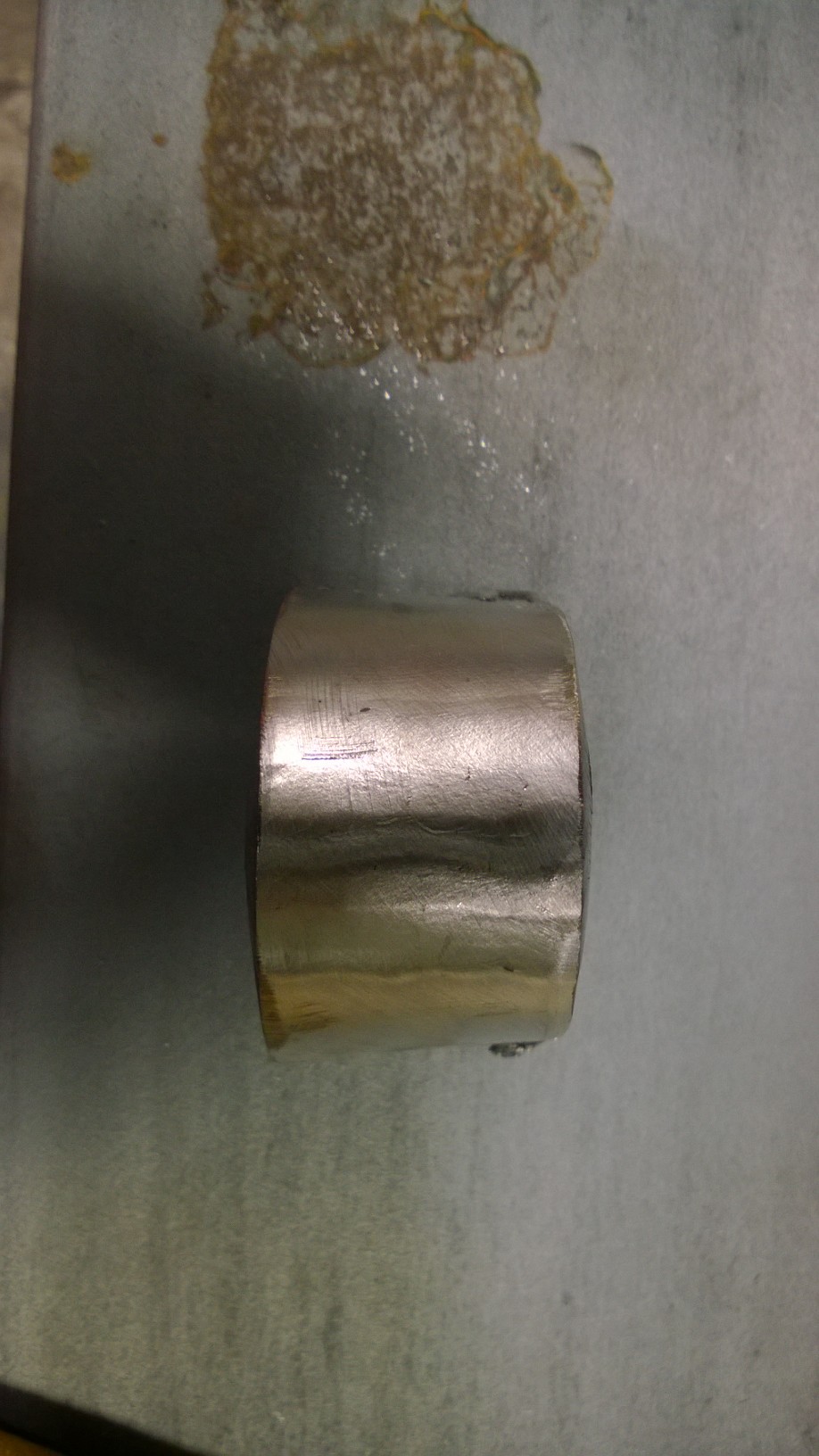

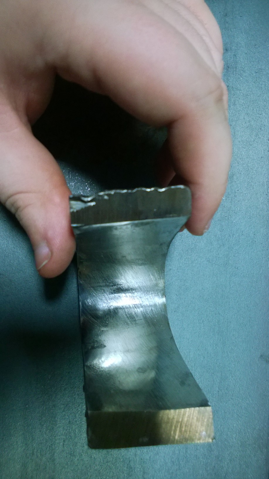

Photos weld bend test i just did

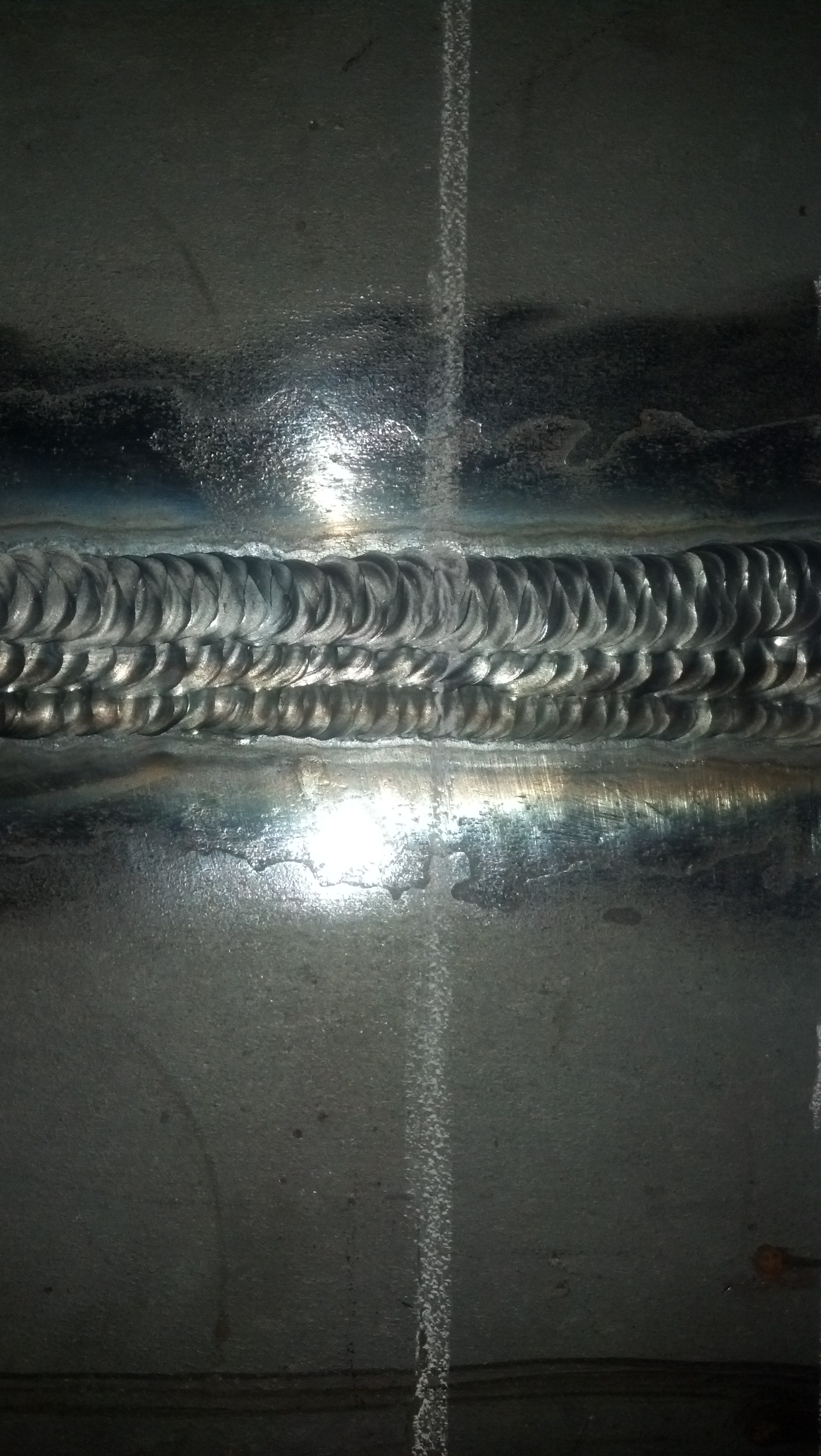

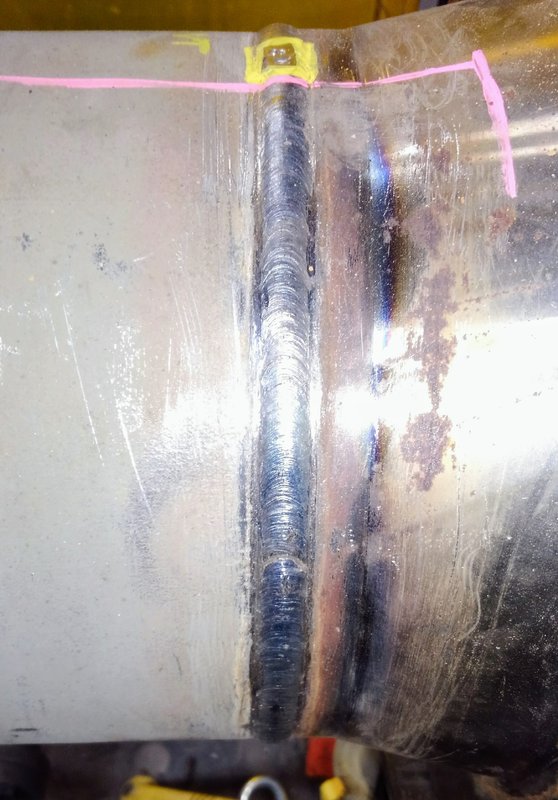

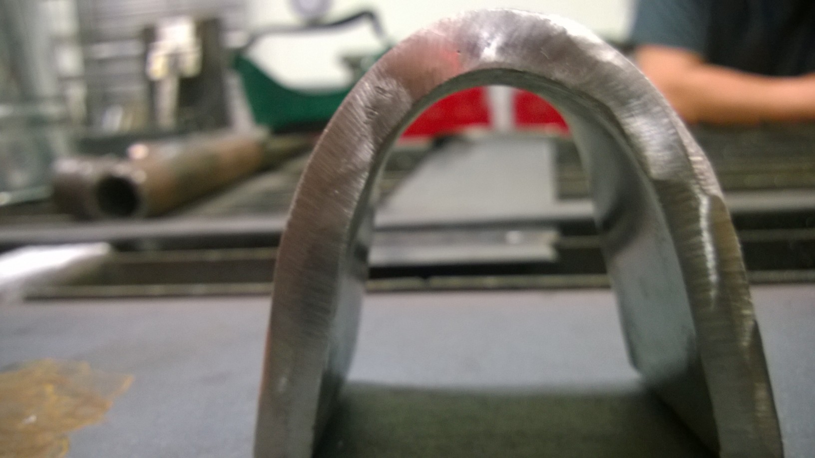

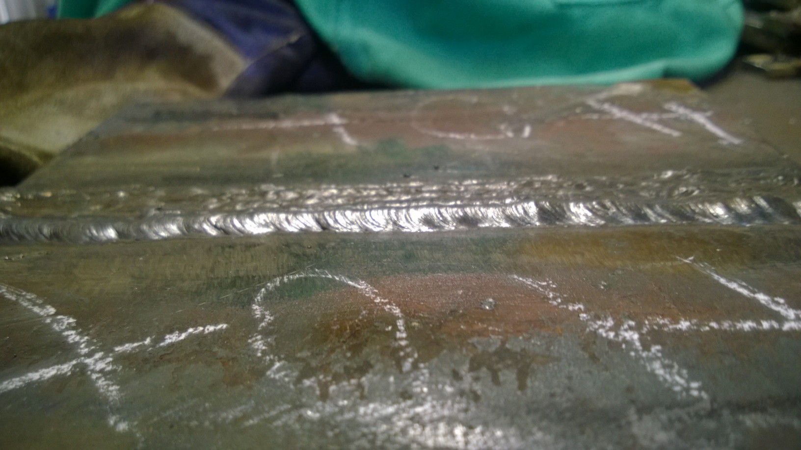

3/8" plate, vertical uphill stick, E7018 1/8 rod, Double stringer root pass 103 amps, weave hot pass 95 amps, stringers rest of the way out 97 amps with a 5 stringer cap. In-house bender system we use roughs up the edges abit.

Your plates look good.
Did I see some pin holes from the side view?
Bend test is good for structural stuff next is radiography where nothing can hide!
Good luck.

Looks like a few little spots in his cap and 2 in the side view of the bend. Not bad though.
I had a little trouble with my overhead letting my arc get a little long with one of my plate tests. I was tiging the root and hot pass and then 7018 out. Maybe run the brush over it a little more to clean up between passes and pay attention to keeping the arc length perfect and those little voids will be gone. Looks pretty good though.
I remember doing the bend tests when learning to weld with oxy/acetylene. I was just to the point of stick welding pipe when I gave up on my plumbers apprenticeship due to lack of work. It was the best thing I got out of the schooling and use those skills to build mechanics trucks and lube trucks. I wouldn't mind doing it full time if there was more money in it without traveling on the pipeline. I worked as a mechanic on the pipeline for 3 1/2 years and know that there is a lot of money to be made as a welder.
the one who you can see really good on the side is actually from were i took a metal scribe, and put a mark on it so i knew were to place it on the bender, the one on the cap is actually from a spot were i had slight undercut, and i din't grind enough down into it, i ran my last stringer fairly hot and abit to sharp of a again burning into the previous stringer, but the CWI said it passed visual so thats good i reckon. as this was just a in-house bend so i din't really care which way the grind marks went, which they say if it runs with the weld it gives it a greater chance to fail. i used a wirewheel to get all the slag out - yea i know thats cheating-

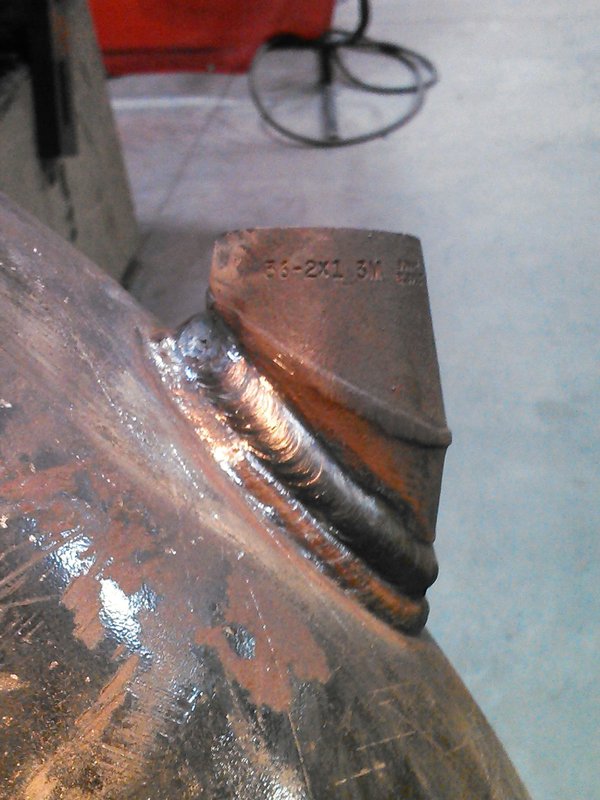

I started tig not too long ago. This is a pic of my first overhead just before cutting my bend test tickets out. Once you start tigging, you will almost never want to pick up a rod again. Haha

Thanks for the kind words. That's with a full week of time behind a tig machine. Haha. Passed the bend test just fine but it is nowhere near what most of the guys with real time under the hood can do. Not too bad for an engineer though.
