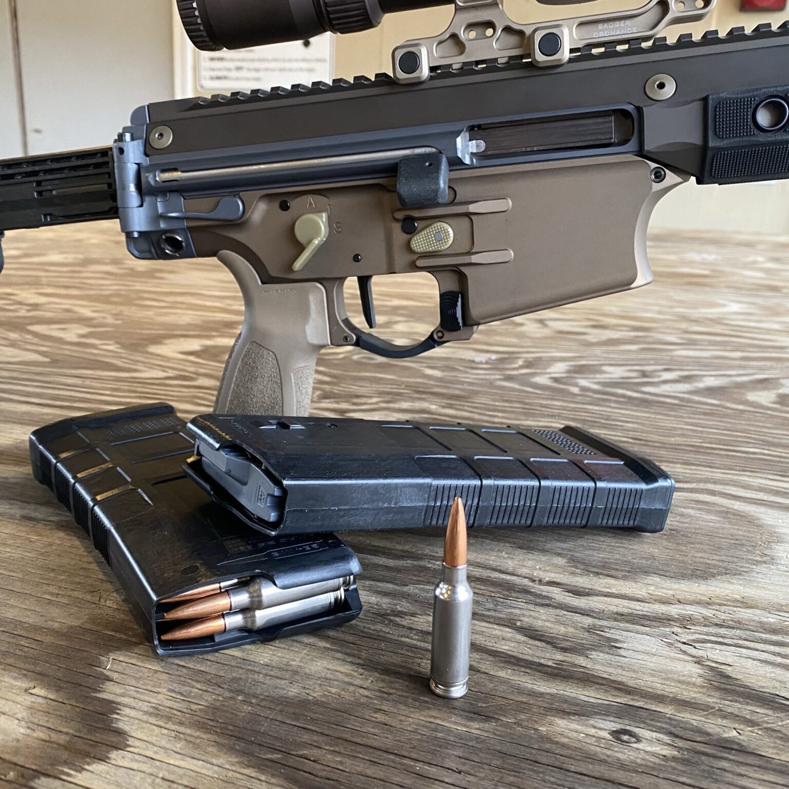

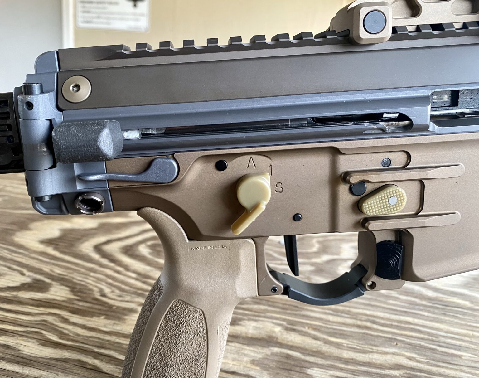

From the photos I don’t understand how the non-reciprocating charging handle works. It looks like the slot it travels in has some sort of cover running the whole length - but there doesn’t seem to be a place for it to extrude out the back along the stock. Any one else understand how they keep this area of the firearm sealed but still contained with in the reciever?
Cover is probably pushed up as the handle is pulled back.
Ah thanks! I see that now. Found some photos of SSD with it pulled back seem to show it a bit better.
Also, does it look like a 3 piece receiver system to you all as well? Tan lower, blue-ish rear-center, and then dark grey upper-rail? Seems complex.

Good point on the charging handle slot, hlee.

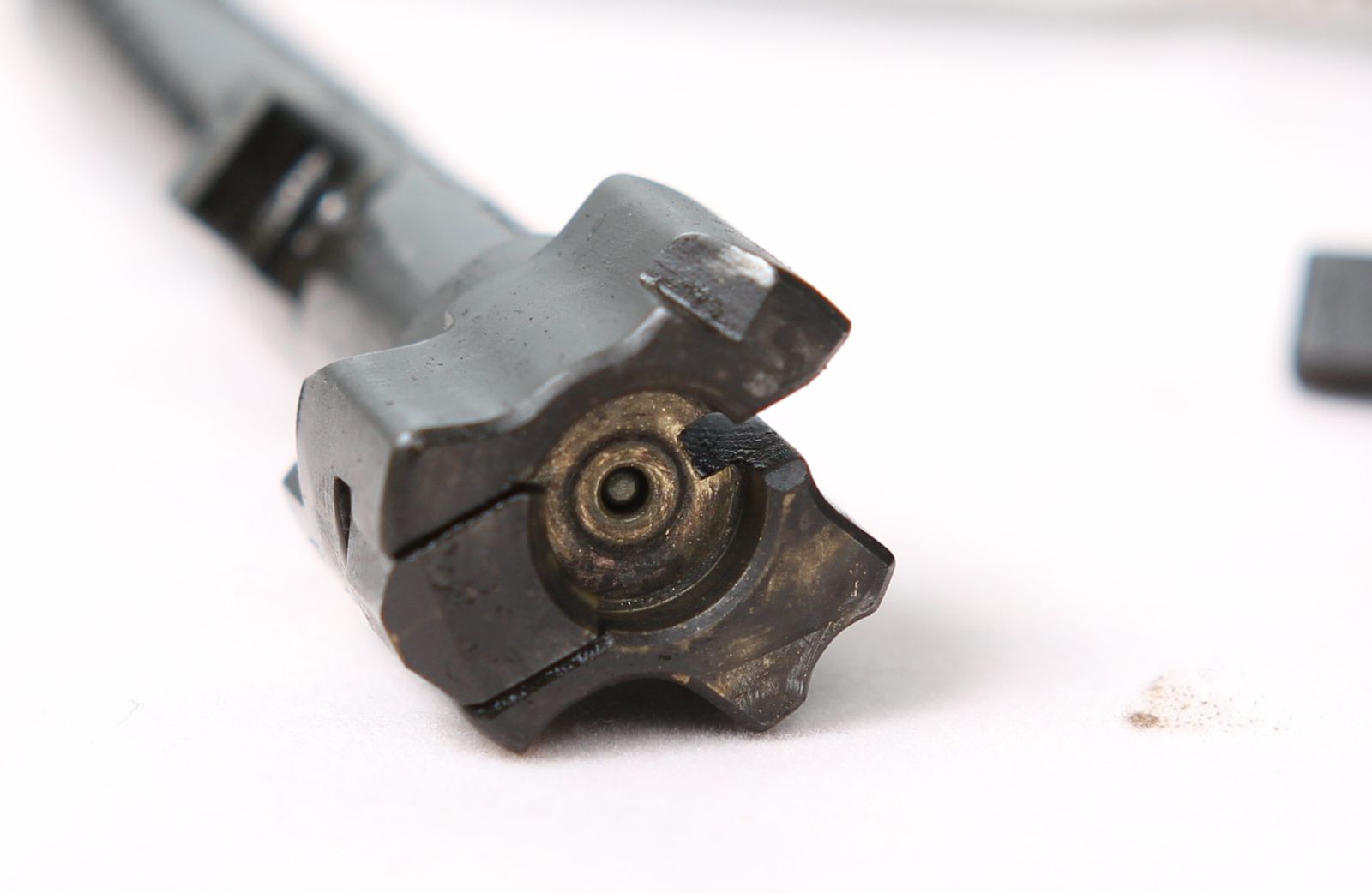

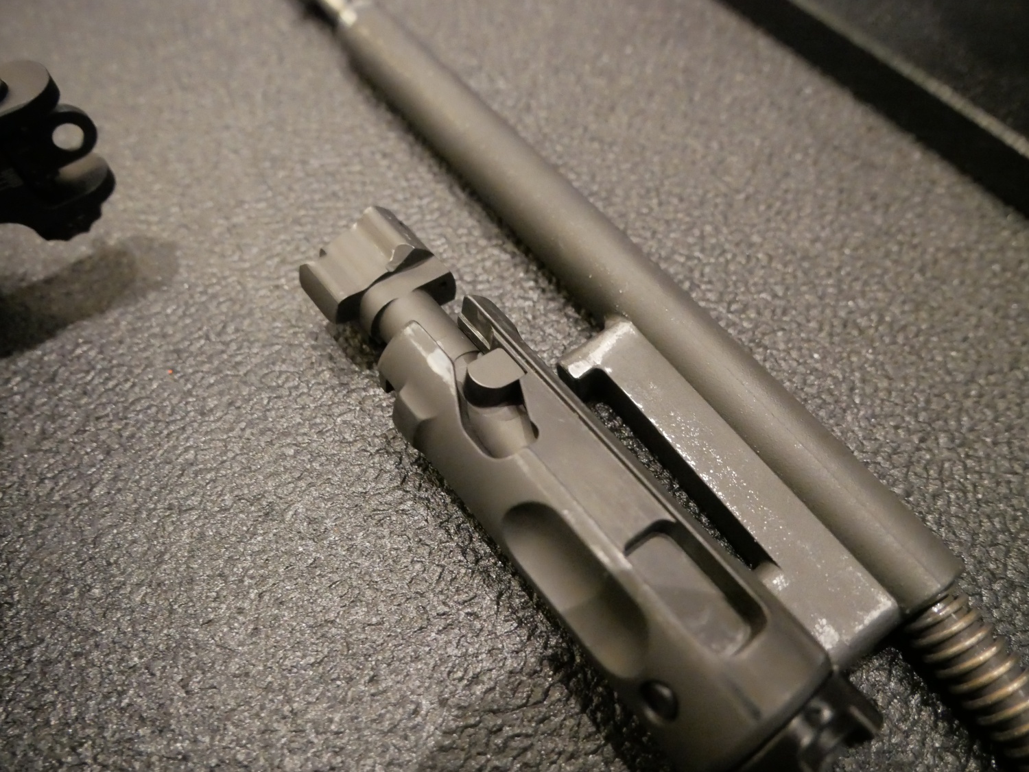

I'd also like to see their three-lug bolt. Interesting departure from the multiple lugs on the AR15 and AR10 these days.
I’d be surprised if it was significantly different than the internals on the XCR. Its also a 3lug bolt, long stroke piston system.

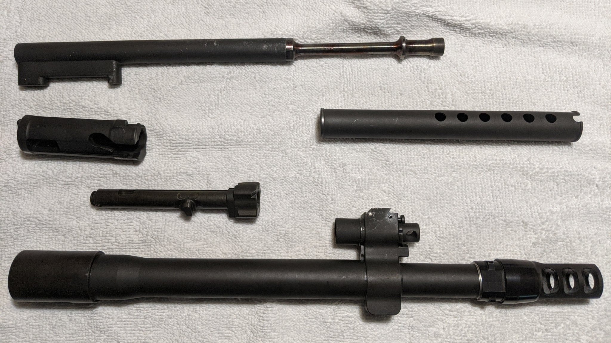

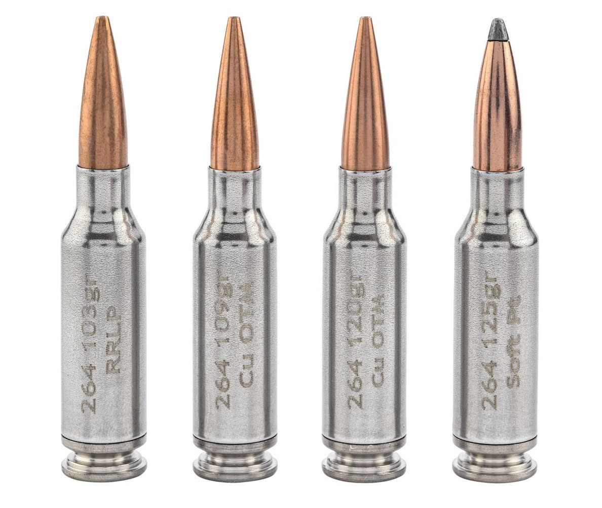

Figured I’d add some pictures:

I love that the bolt head is very Tikka like. 3 lug.

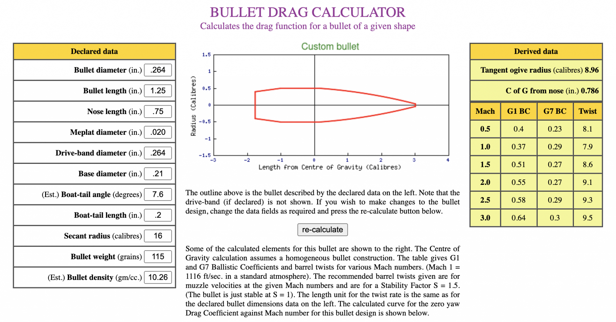

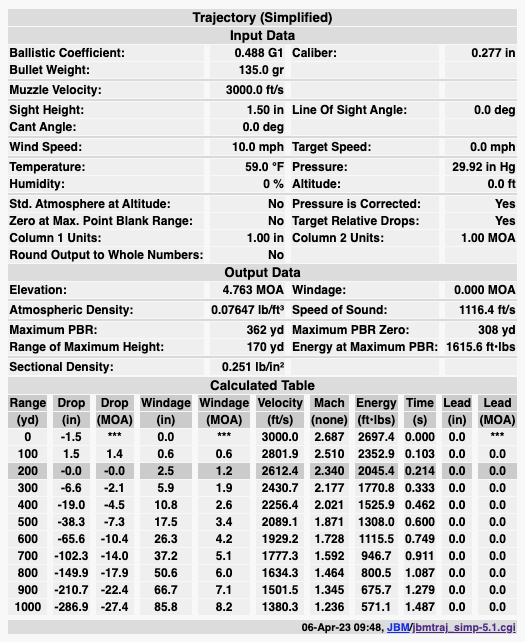

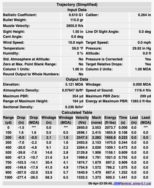

Nobody knows what the .264 LICC can or can't do relative to Level IV body armor at various ranges. You'd have to have a program to develop specific projectiles and loads.
The 6.8 NGSW cartridge is said to get 3,000 fps from a 16" barrel at 80k psi with a 135gr bullet with a .488 G1 BC. Bullet would have a sectional density of .251.
In .264" (6.5mm) a 123gr bullet has a .252 sectional density. I think that's slightly heavy for the .264 LICC case so I'd propose a 115gr with a .236 SD and a .610 G1 BC at 62k psi doing 2,850 fps from a 16".
So, yes, all things being equal a bullet going slower with less sectional density is going to penetrate less. However, a higher BC helps gain back velocity at range.
Using the JBM Ballistics calculator, I calculated the trajectories of the two cartridges and the results are attached. (Note that numbers are educated guesses, so take the results with a grain of salt. We don't know what SIG's ammunition will achieve in the real world vs. their claims, and we don't know what the .264 LICC could achieve in the real world vs. my hypothetical load.)
How are you going to get that high of a bc (.610) out of a 115 grain .264.
That sounds unrealistic. Highbclowgr is that you?
Reactions: Constructor
I have nothing to do with this.
Wait...
You could just put air or aluminum or polymer in it.
The 115 is dayum temptin. Dey....temptin.

This is how you do it if you want to see a Grendel or 6mm ARC in a military rifle. First off call Magpul and get them to design a mag specifically for those cartridges. Design an AR lower around those mags and machine new lowers but the uppers will need to be wider also. Copy my Titan bolt or design one stronger and put it all together. Or get Sig to make a MCX Spear LT in whatever flavor and talk the military into testing it.
I estimate a .610 BC from a 6.5mm 115gr by punching in numbers in the free online bullet drag calculator from Geoffrey Kolbe.
I'm including a screen shot of my hypothetical bullet. You can check my work.
The bullets shown by FN at SHOT Show 2023 are not bad in the ogive department, as it is. Here's the photo again from post #1.

What happens when you change the density to match that of a steel core? ThenTungsten will be near twice as heavy as a copper jacket/lead core. How will that effect the overall weight and form factor?
Better send that to Berger and show them how to make bullets, as it is their 130 is the only one close to that.
Funny. Discussed it with Brian Litz at SHOT Show 2023. He said, "If it happens, you can be proud."
Hint: It won't happen in this present manufacturing climate....
Punch in some numbers and let us know. It's free for anybody to use — unlike your Secret Squirrel "forum."
