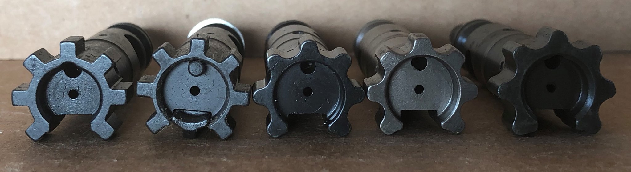

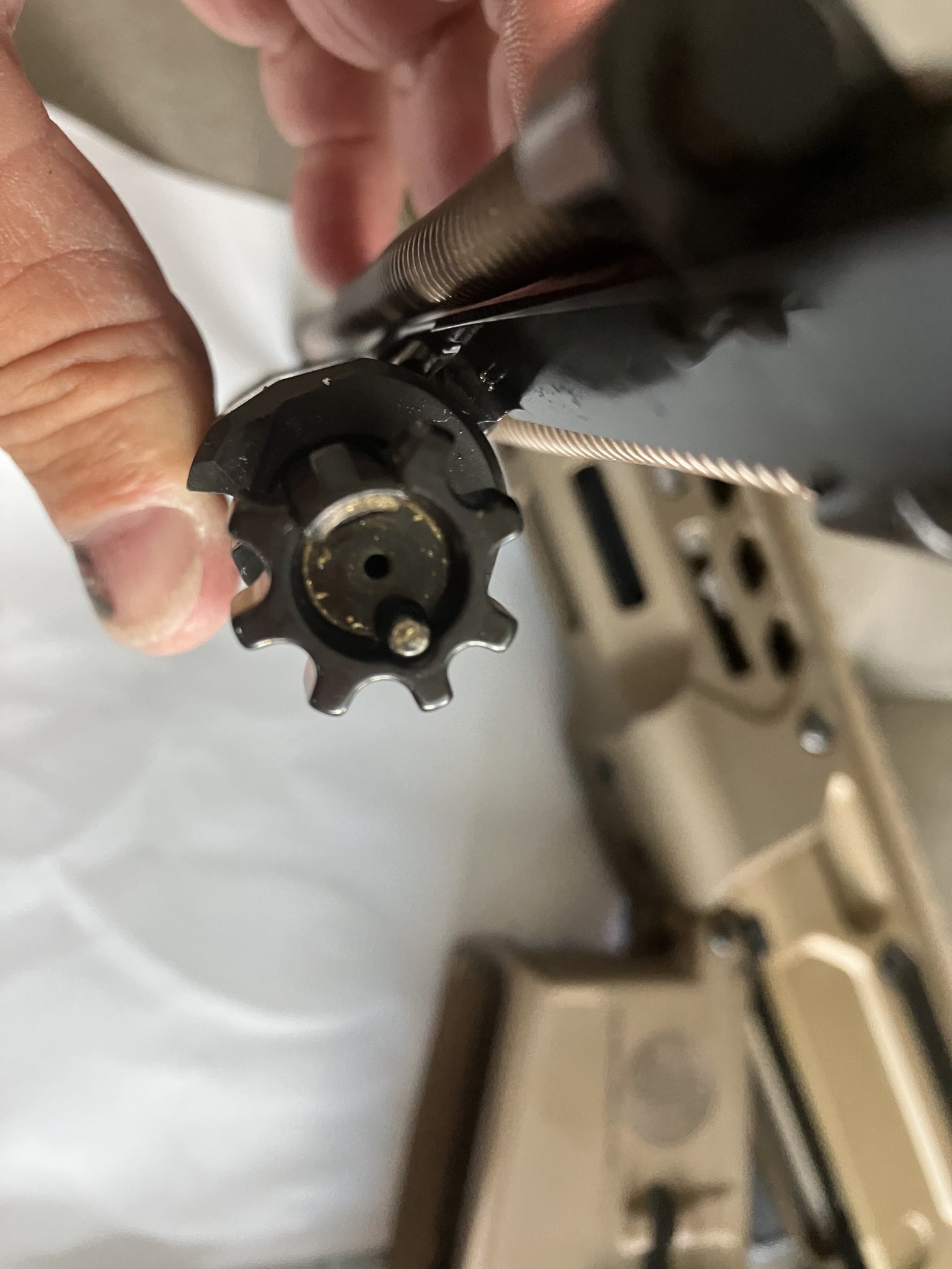

This bolt that came out of my SIG is like the Titan bolts I made. It is very close to the KAC E3 which was made for the 5.56, I designed mine a little differently for the .441 case head.
Titan is the middle bolt, Super bolts in 6.8 I machined is 2nd from left, 750XD and 800 series 4th and 5th are for .473 cartridges in a AR15.
I love that 5th bolt.

He knew about them as well as Murray. Murray contacted me about making a few bolts to convert a MG42 to his 7mmUIAC. He was on the right track IMO, I wasn't personally interested in the 7mm but he had a good reason and knew what he was doing. You know how the military works, they take parts of your good idea and spin them into a political nightmare of who pays the largest kickbacks. Personally I think they should have enlarged the AR15platform a little and stayed with a smaller cartridge for the main percentage of troops then used this NGSW for special groups and GPMG.

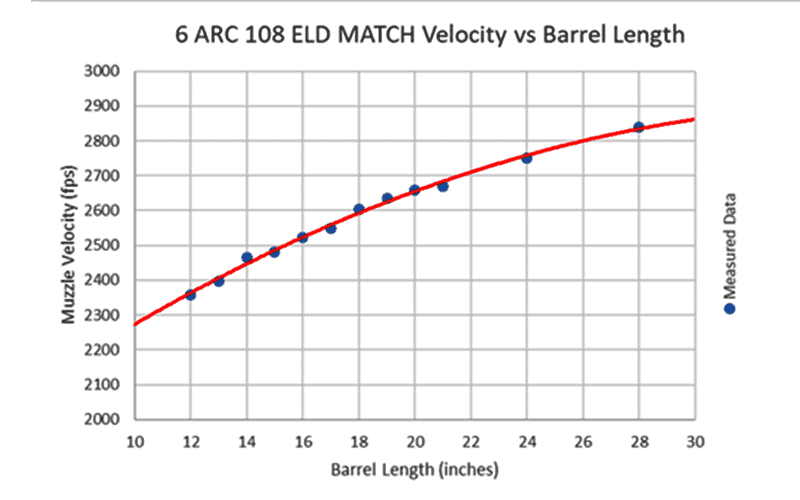

6mm ARC 16-18” velocities
You’re looking at 2408-2590fps from Hide members’ real world data with 103gr-108gr out of 16-18” ARs.
