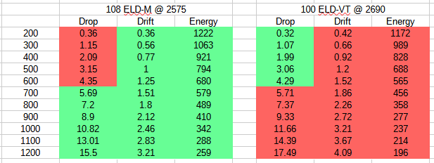

The 100gr ELD-VT at 2690fps beats any of the 6mm 103-110gr class at 2575fps, flatter, more impact velocity, less wind drift.
Don't spew easily disproven nonsense:
Values pulled directly from 4DOF (STP, 10mph crosswind)

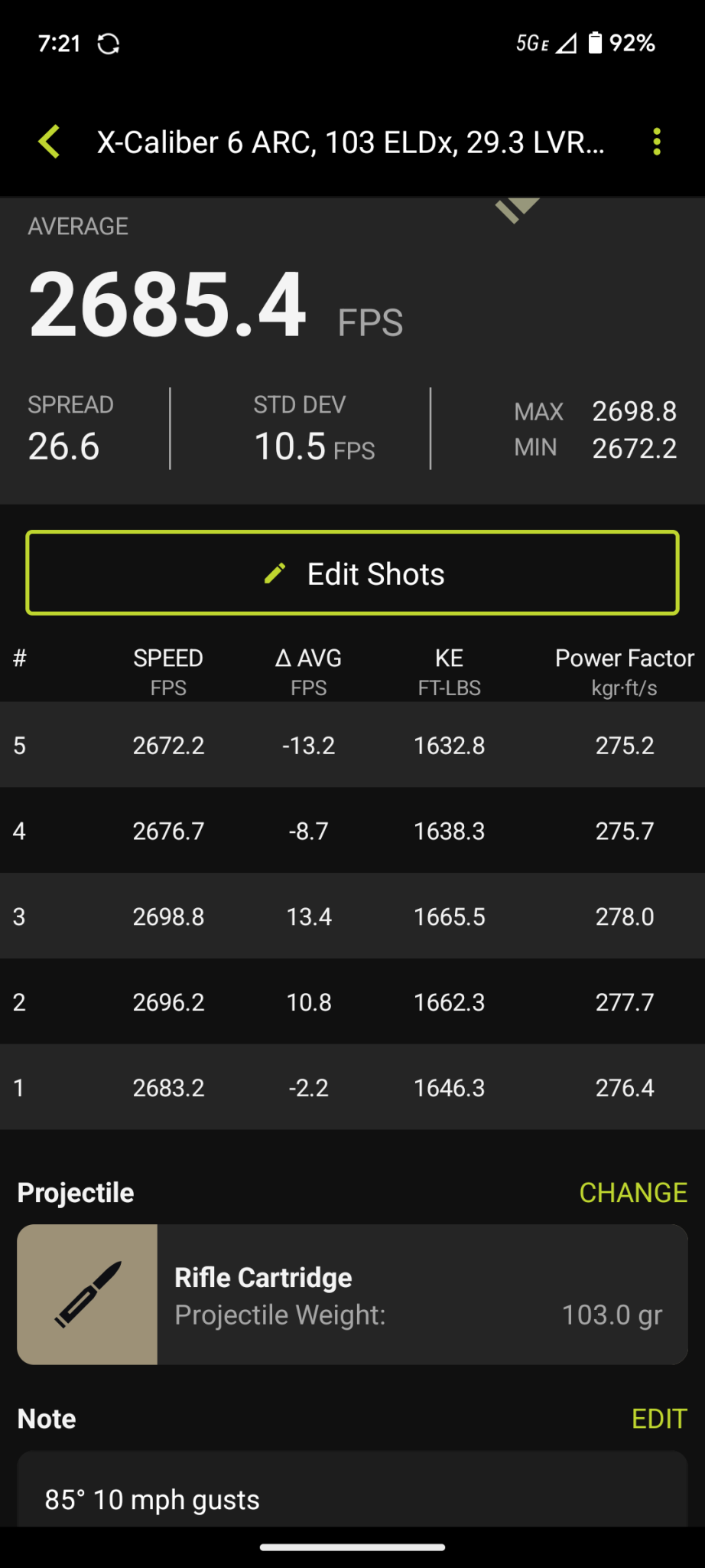

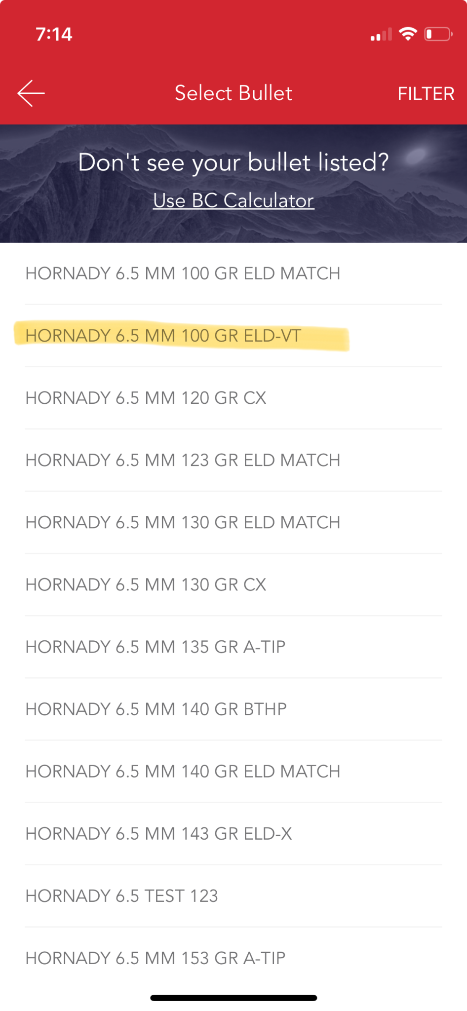

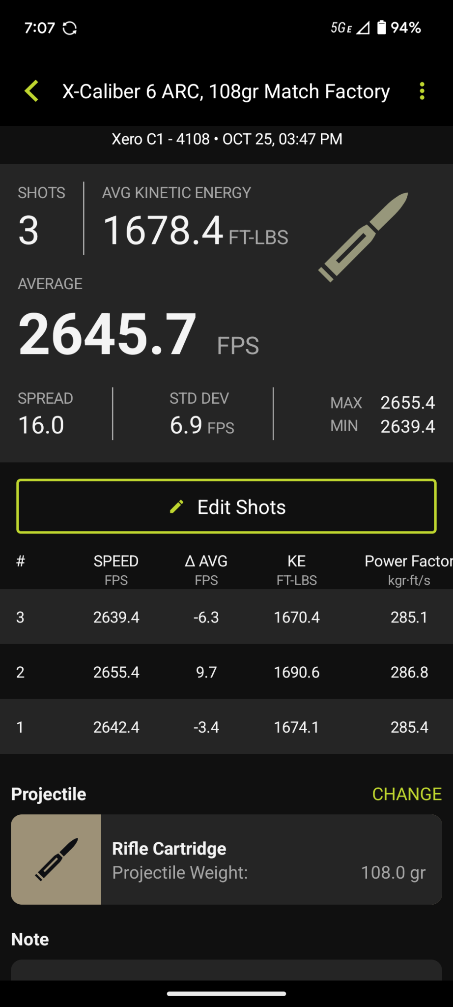

It wasn’t on Hornady’s desktop program. I just checked it to see if they had added the 100gr ELD-VT and it still isn’t there. It is on the Hornady phone app though.
Don’t assume malice. That 4DOF program does match my 1k drop dead-on though. I was holding less wind.
I’ve been using G7 for the 100gr ELD-VT in the absence of the 4DOF. Those are different results for sure.
If the data shows I’m wrong, I’ll own it. It didn’t make sense to me either because the BC advantages are clearly in 6mm favor until you step up in weight with 6.5mm, but then trajectory gets more 175gr SMK-like.

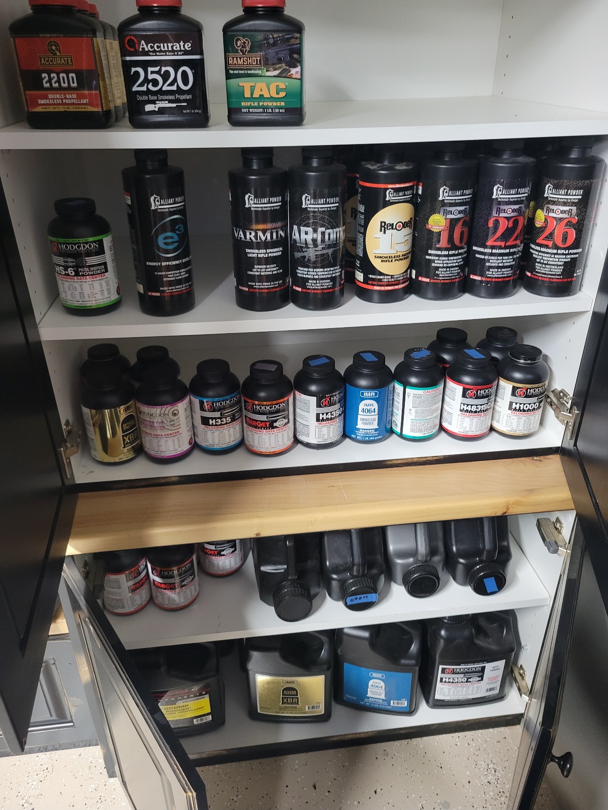

One pound reference containers for load development, does not include the bulk.
You're doing better than me at streamlining the powder shelf, I've got too many oddballs from past experiments hanging around.

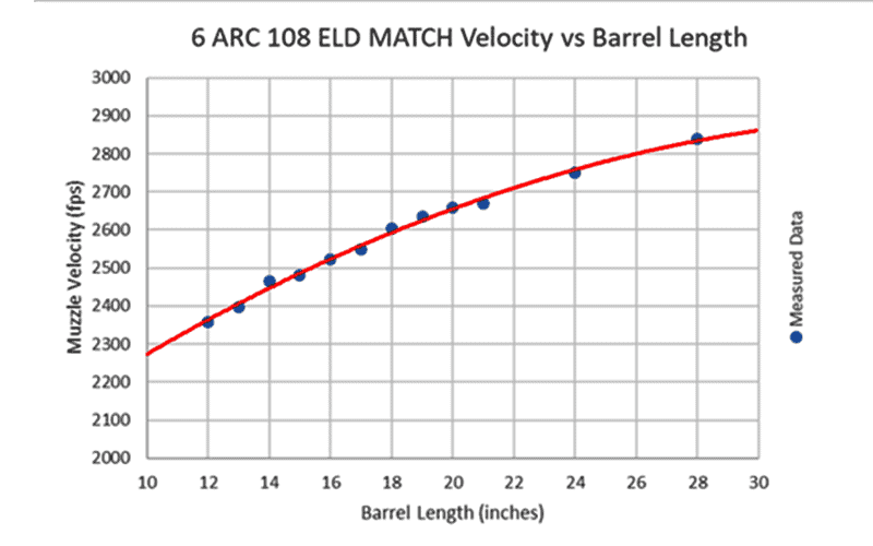

Hornady 6ARC is the outlier in all of the 6ARC load data and measured velocities. All other 6ARC load data sources are in alignment.
I don't think this is true. What other published sources for ARC data are you referring to beyond Hodgdon and Hornady to make this claim?

The original question was why would someone want 6.5 100ELDVT going 2600 when they can have 6mm 108 ELDM going the same speed? The answer is, ignoring pressure, you wouldn't. The 6mm 108 going the same speed is ballistically superior in every way. The factory 6ARC goes the speed you say it does.
If you're comfortable with the pressure then 6ARC is the clear winner. You can push up the Grendel pressure too, if you want but, it really doesn't matter. If all you care about is factory ammo that makes legit velocity, the Hornady 6ARC does it.
I don't think continuing the conversation in private is necessary. You're welcome to do whatever you feel is best.
2690fps from Grendel w/100gr vs 2550-2575fps for 6mm w/108gr. Looks like the only advantages are drop out to 600 and barrel life for Grendel. Trajectory is within an inch for both of them to 600, while wind and energy go to the 6mm.
At 600, you’re looking at 1.3 mils drift for 6mm and 1.5 mils for Grendel with 100gr ELD-VT.
If you shoot the 123gr SMK or 123gr Scenar in Grendel, it really tightens the gap but puts more energy on-target and is louder when it hits.

The factory 108ELDM is either over pressure or it isn't, which is it? If both are going the same speed, ignoring pressure, the 6mm is the obvious choice. The factory 100gr ELDVT isn't as fast as the 6ARC. It's right on Hornady's site. But, You can lean on the 6.5 the same as the 6 and then the 6mm is no longer an advantage. The factory 6ARC ammo is going the speed everyone is claiming though.
It's incredible watching everyone waffle back and forth. Hornady s own published load data says their factory ammo shouldn't be going the speed it is to be safe. It's like 6ARC is everything to everyone while being safe but not.

I do know that 100gr ELD-VT is running 2690fps for me and others from 18” barrels in ARs (mine is 17.6”), even though the box and site say 2730fps from a 24”. I should be getting more like 2598fps, assuming their barrel has the same bore profile as mine (I’m shooting Lilja 3-groove, very lightweight.)
What I just did notice is that the Hodgdon’s data doesn’t match Hornady’s published gas gun data. CFE223 under a 108gr or 110gr A-TIP maxes at 29.1gr in my Hornady 11th Edition, whereas Hodgdon’s says less:
110gr A-TIP
HodgdonCFE 223
2.260"25.32,39738,200 PSI28.22,64950,500 PSI
HodgdonLEVERevolution
2.260"25.42,41038,600 PSI28.2C2,66051,200 PSI
The Hodgdon’s and Hornady data is really close with 105gr BTHP and 107gr SMK though, within .2 grains.
Speeds seem to jive correctly for Hodgdon’s 24” vs Hornady 18” gas gun data.
