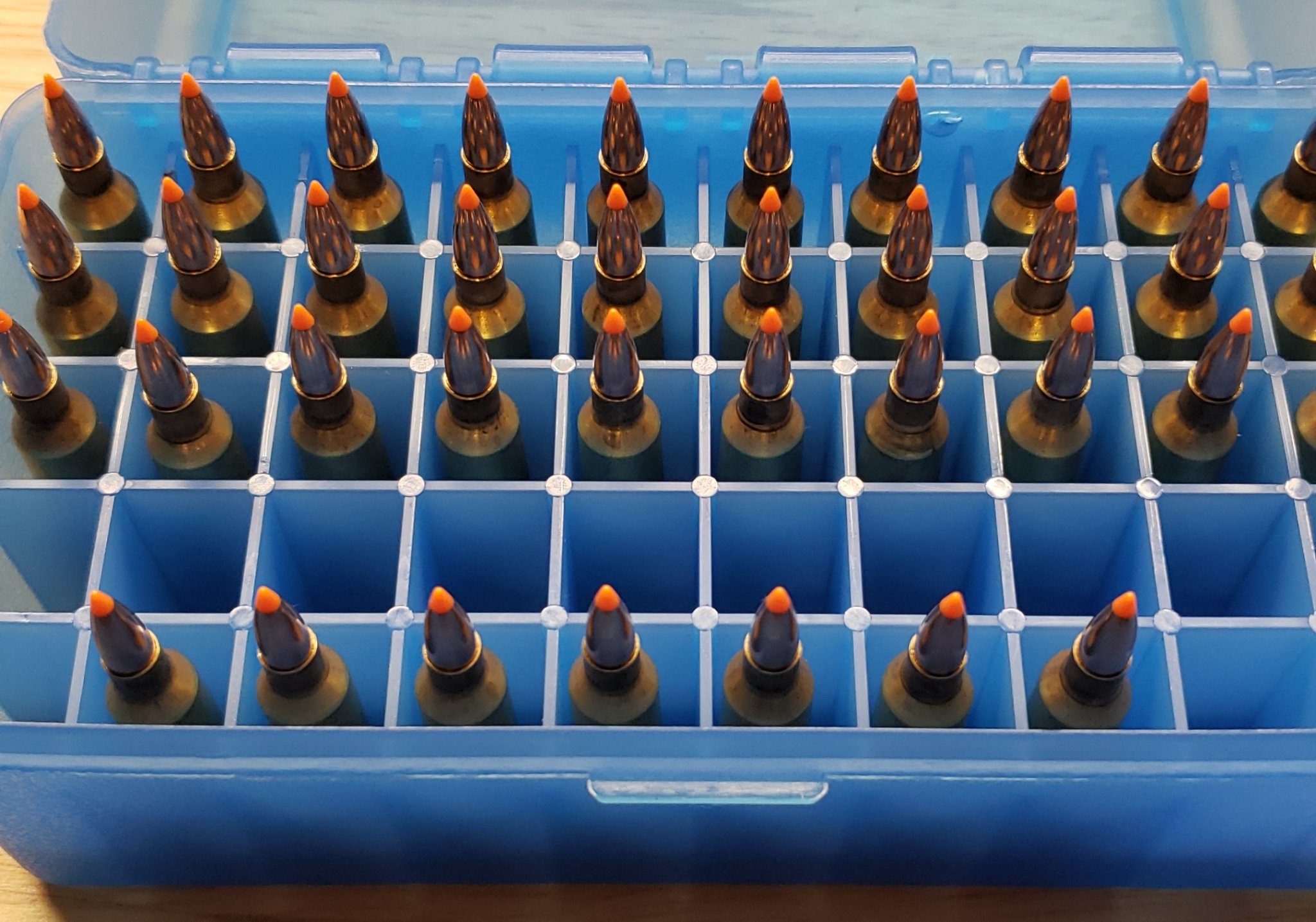

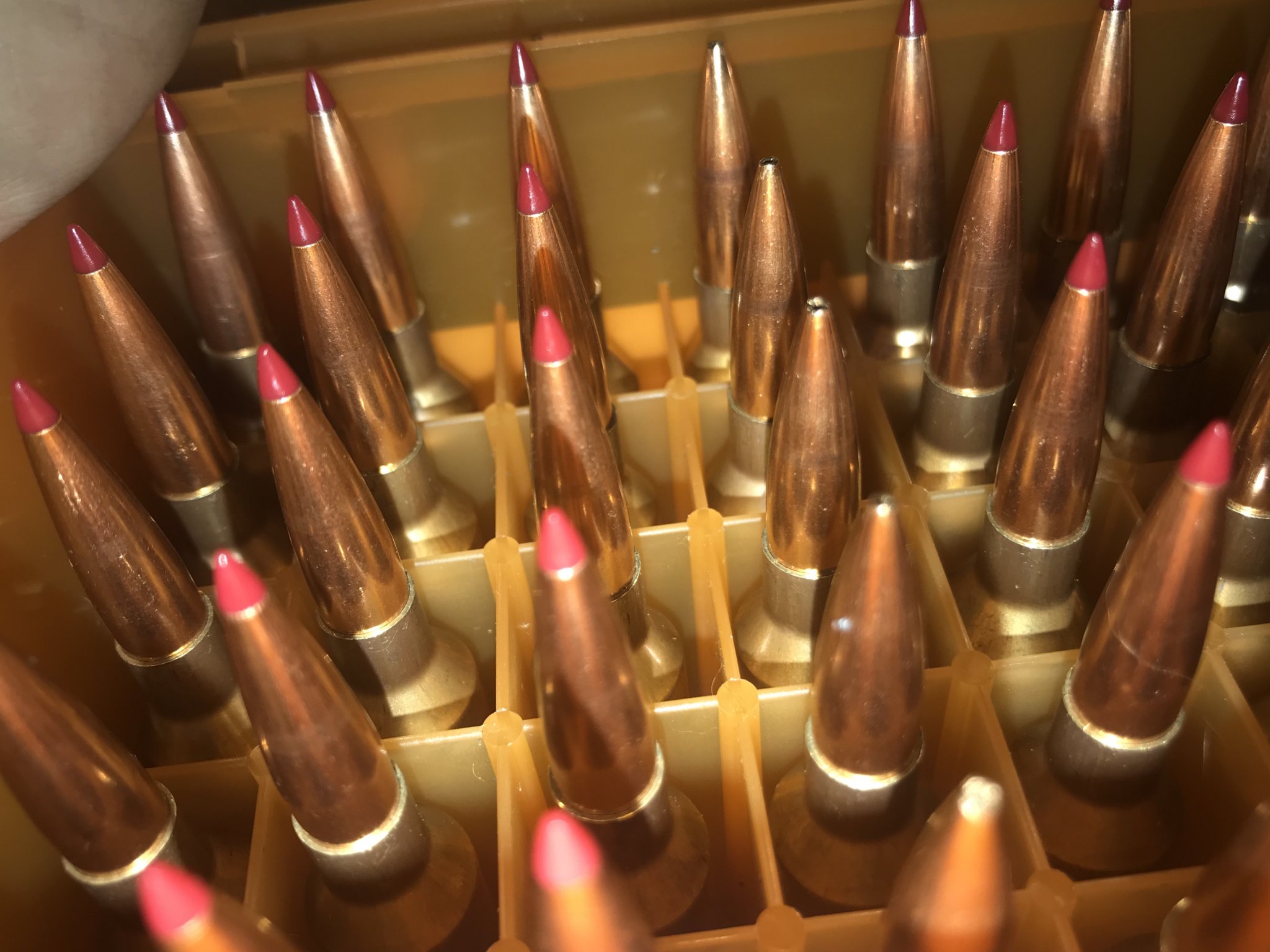

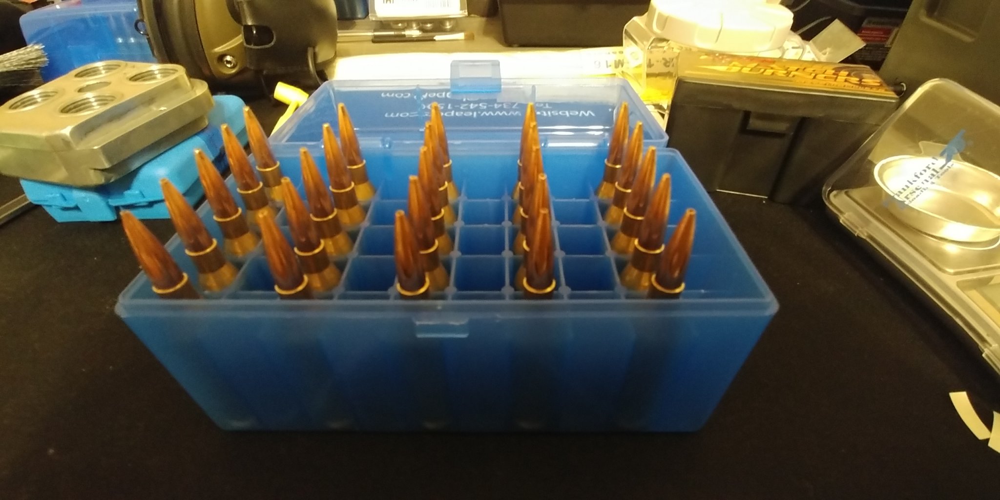

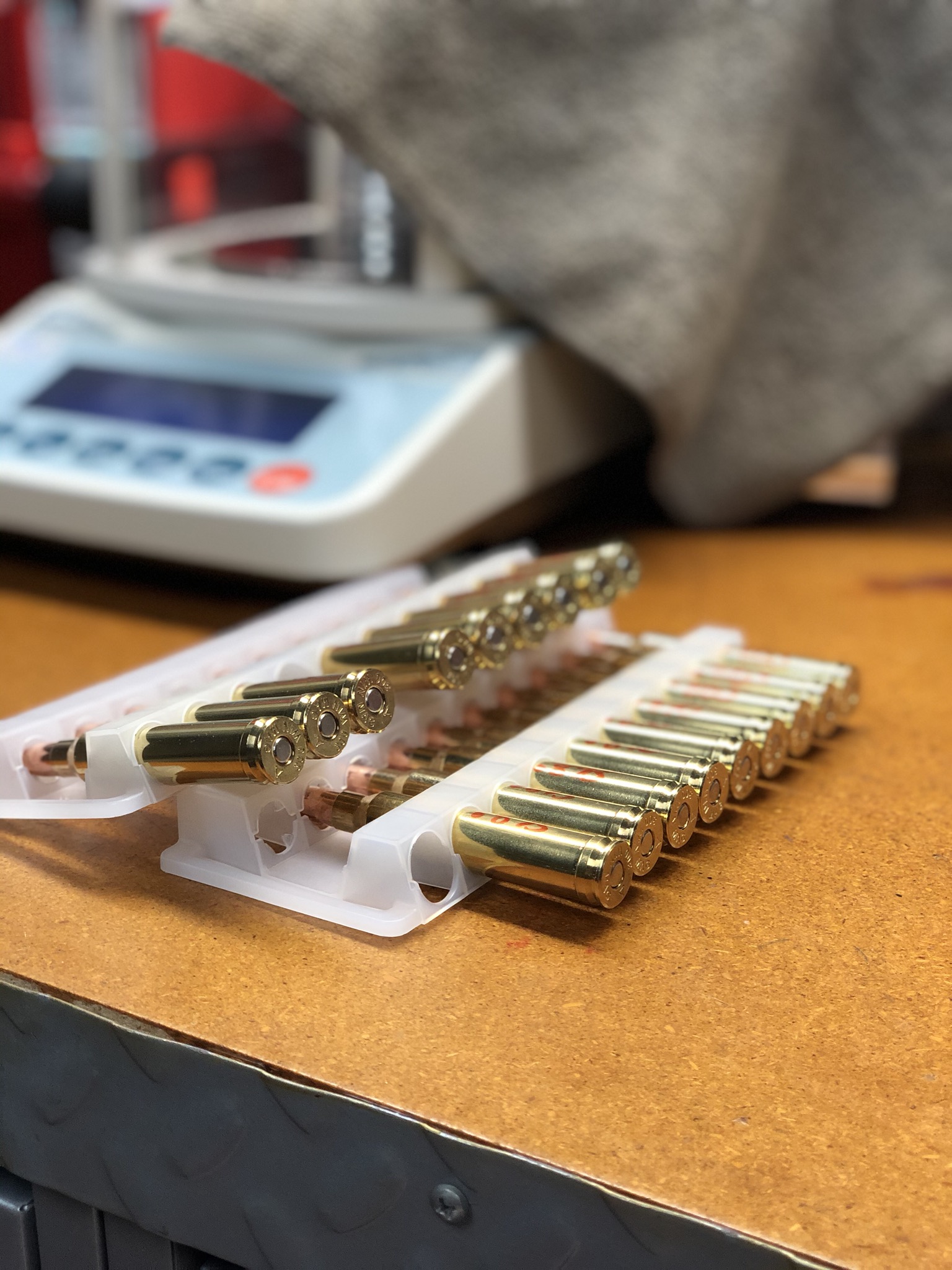

Worked on tuning seating depth on a 300WM load.

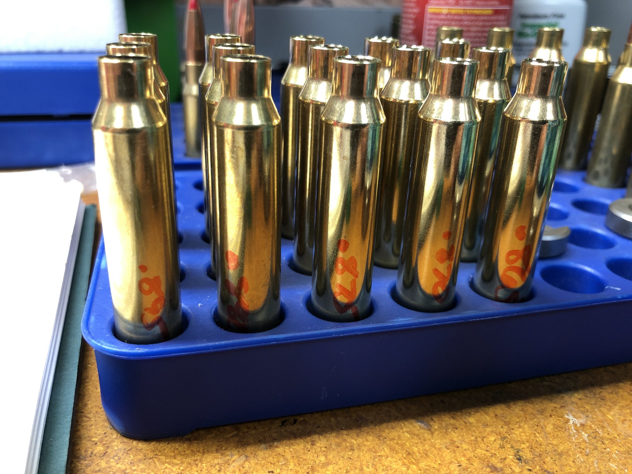

Finally got around to loading up some back burner projects.
300 Blackout subs 200gr SMK... trying out a ladder of IMR4227 to see if I can make something quieter than 1680
223 Seating depth test for the trainer. Old load is kinda meh, want to see if can tighten it back up some.
223 subs for the bolt gun, ladder of Trailboss behind 69gr SMK. Should be super quiet, just for grins.
Pulled out old Dasher barrel #1 @ 2400 rounds. Curious if DTACs will shoot in it, loaded up a ladder. Thinking I'll mess around with them as trainer rounds for something with more recoil than the 223.
Gonna be an interesting range trip later this week.

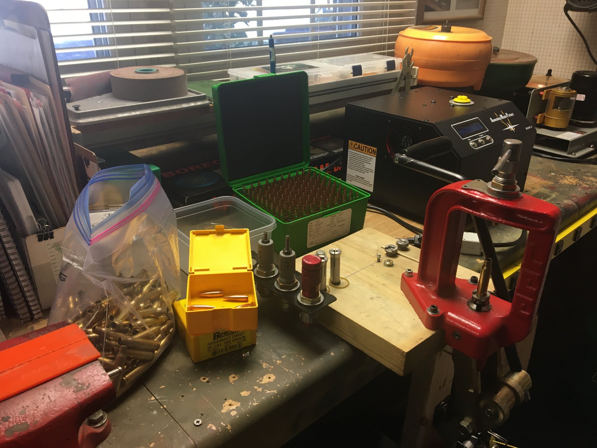

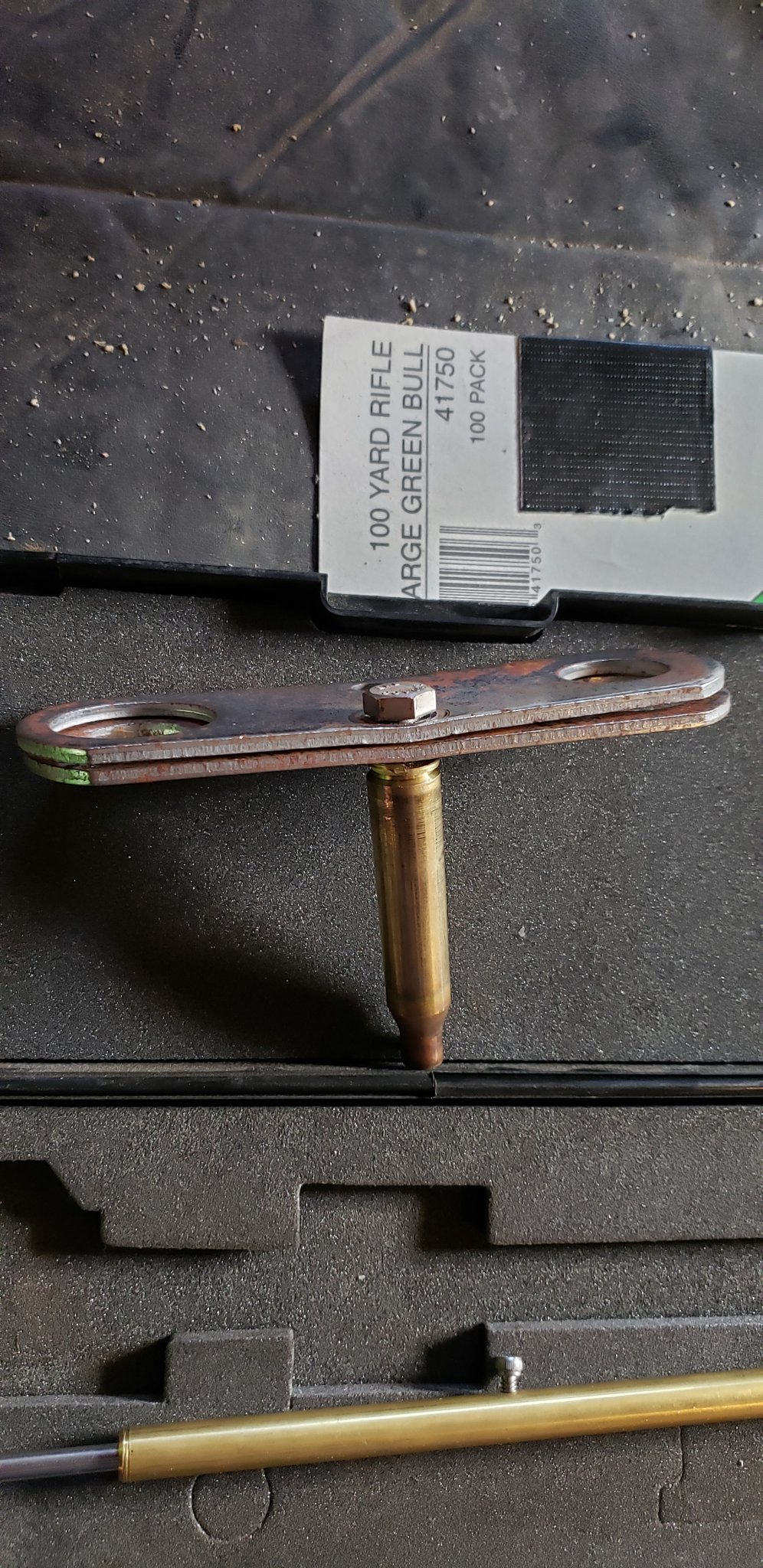

I got my first case stuck in the die. 338LM. Didnt have enough lube at the base of the cases. Crap. Anybody have a 338LM FL die they dont use anymore?
RCBS Stuck case remover. $20, totally worth the money. Saved my bacon a time or two.
Got it. My problem is definitely not enough lube at the base of the case. Sprayed some cases then just rubbed the lube down to the base of the case with my finger and 338's felt like 223's.
