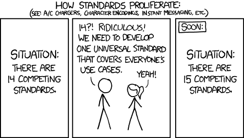

This concept applies everywhere. Nothing against you in any way.
Source: xkcd #927

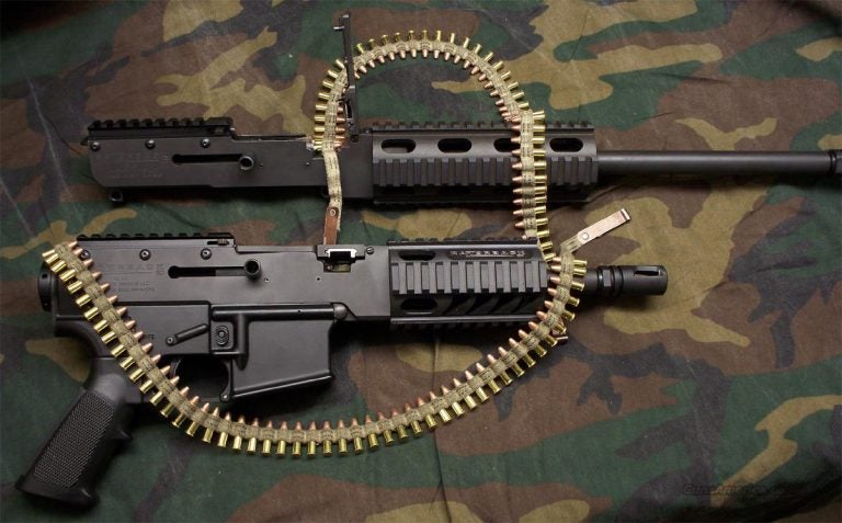

Already been done.
My point was it would be cool if the belt was able to be loaded into a mag (in manufacturer-made short sections, 3, 5, 10, 30, etc), so you could swap quickly and carry it easier. And you don’t look like this with a belt around your forearm lol
It’d save time loading mags, and maybe help with the consistent loading issue due to mag fit.
Maybe I’m misunderstanding how the gun in your pic worked? Looks side-loading vs bottom feeding via a mag.
But then they would limit belts to those certain lengths. Only. All guns can only have 5 round belts.
You would also have to load the belt after you are done with it. Which would you rather load? A magazine once, or load the belt and then load it into the holder?
Dude, you're hilarious but you're actually not far off either. The closest thing to what you're describing is the rotary magazine, which, in my opinion, is the best package ever devised for ammo but the worst mechanical solution as it relates to how the ammo/bullet is treated.

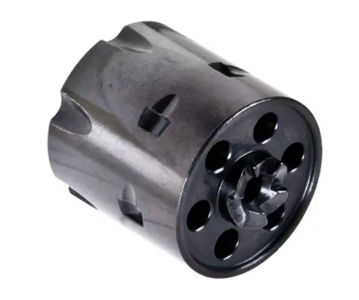

Or that. While we're on wild and exciting ideas, what about a new type of rotary magazine that treated the ammo/bullet with sublime gentleness? It might require some sort of moving chamber design but I think it could work.;)
