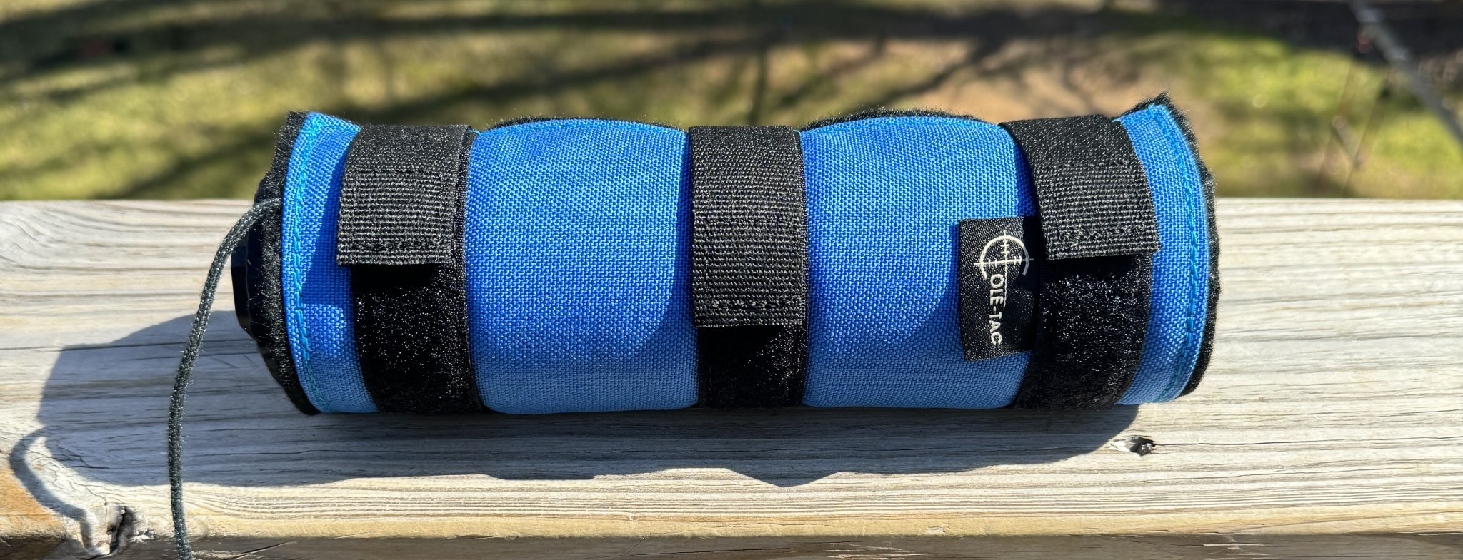

Hey, @GBMaryland - you're famous now! Check out the pic of you at Mifflin with the wood bipod steps I made for us. Told you that you should have painted it Marine red! haha

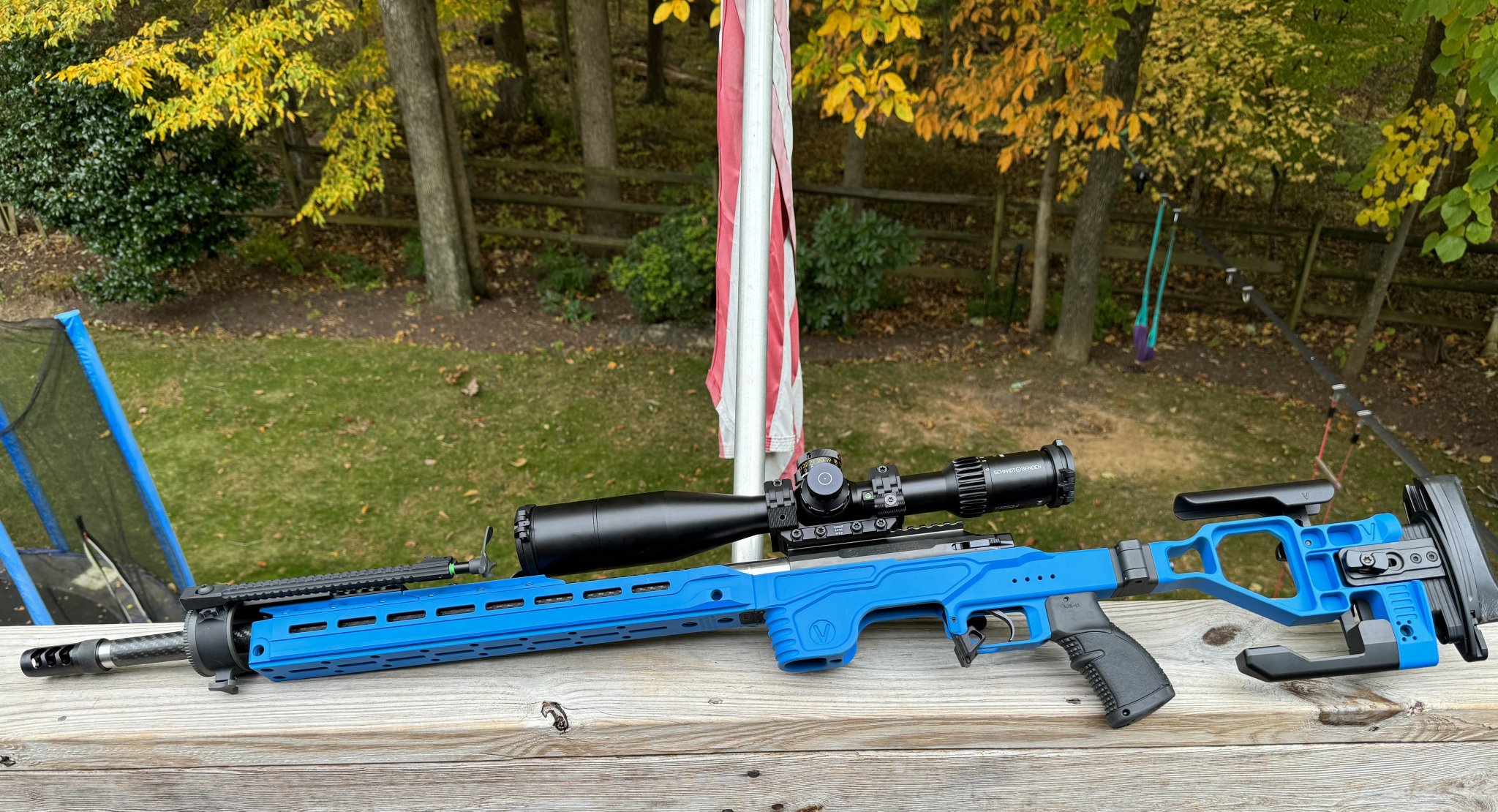

Nope, went in the blue direction…

No, you bozo (haha), I was talking about the wooden bipod steps that you threatened to paint Marine red. LOL :) And I'm glad you liked your AI blue Vision so that I could buy the Cobalt blue one from you. Mine is prettier! hahaha
