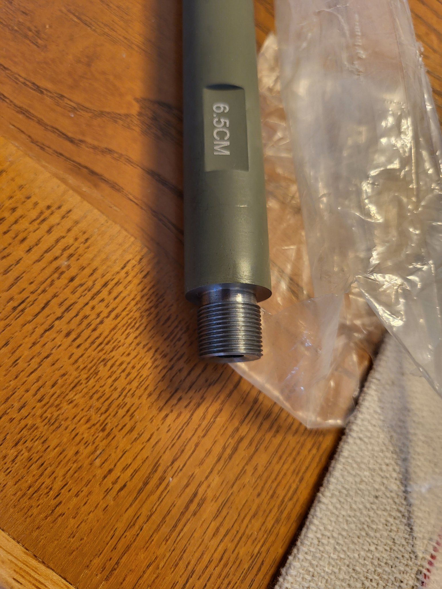

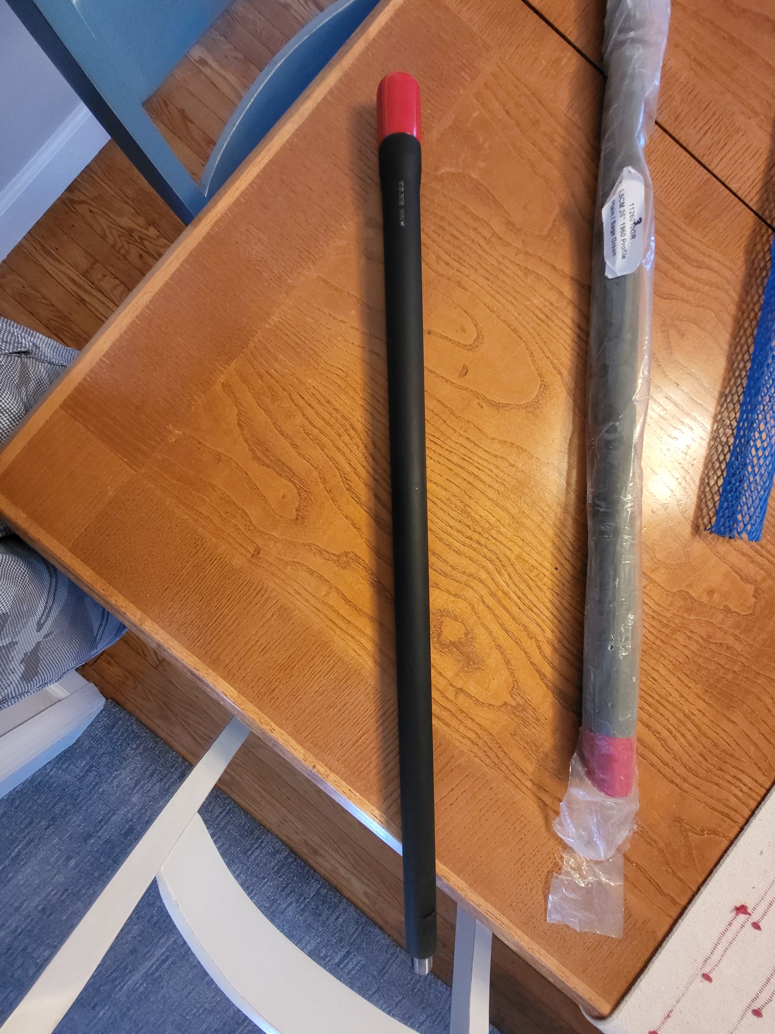

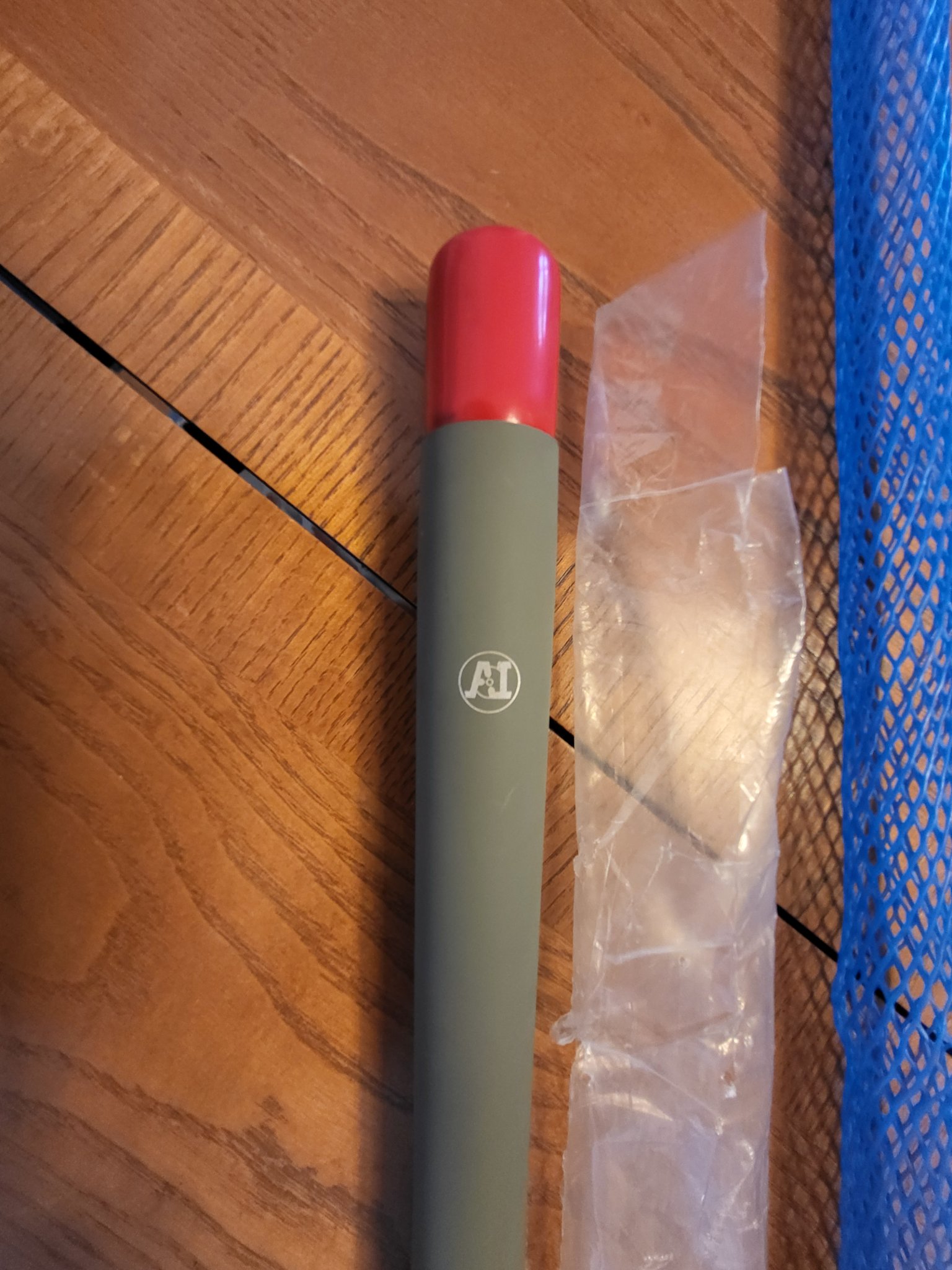

Accessories SOLD Two AI AT/AX new barrels for sale 308 & 6.5 cm
sold the rifle - but have these new barrels I had purchased from eurooptic. the first is a (SOLD) 26" sage green 6.5 cm tube with 5/8-24 threading . the second is a 24" black 308 barrel also threaded. looking for $500 each plus $35 for shipping. thanks

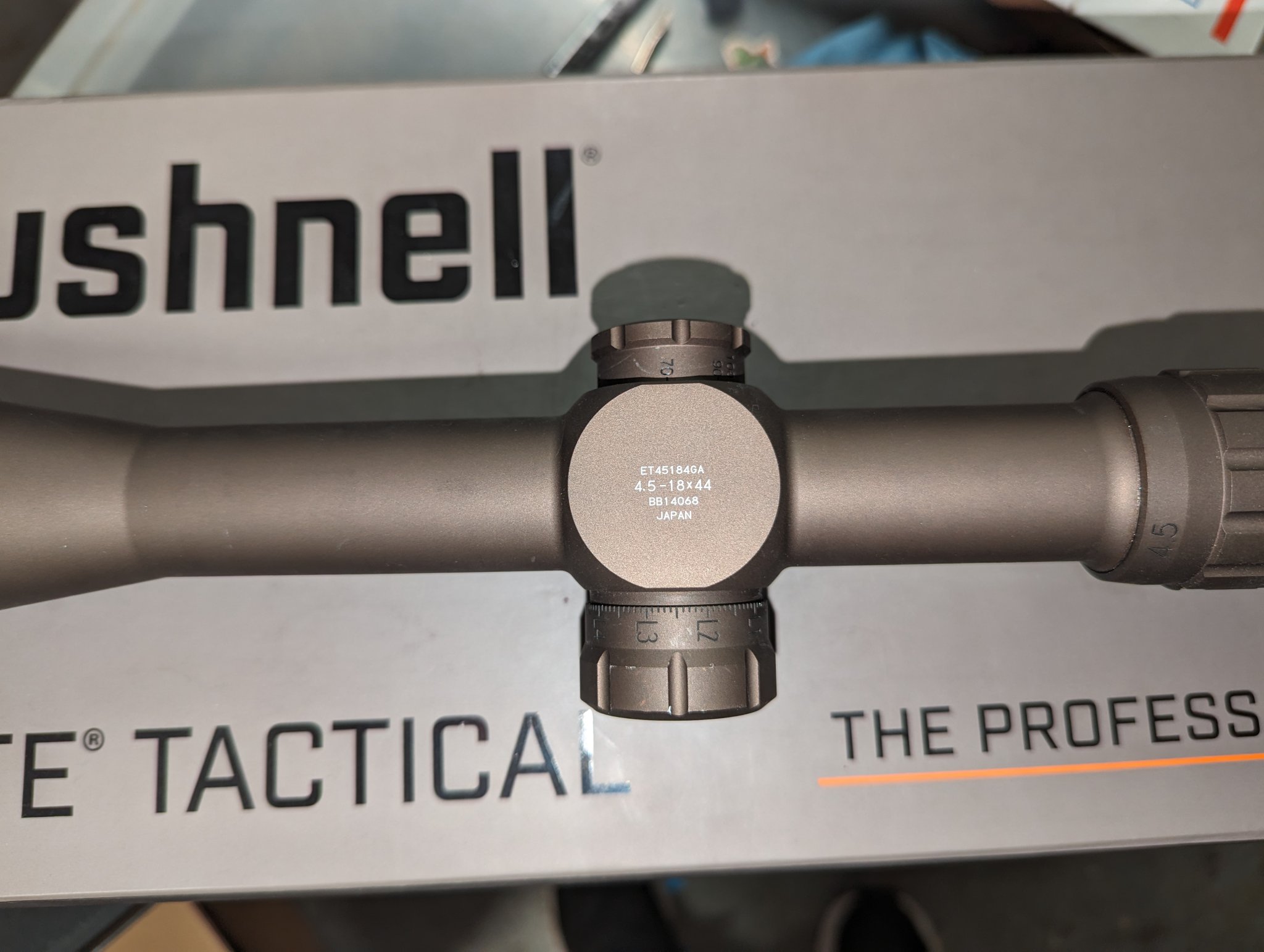

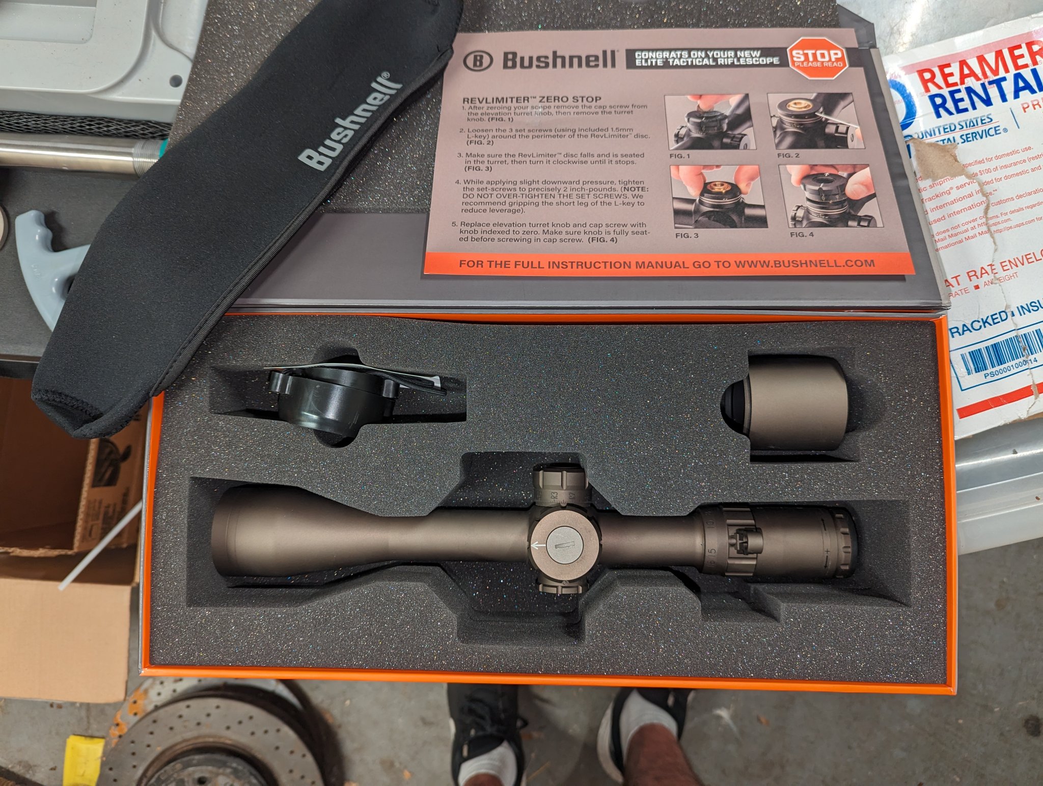

SOLD Bushnell LRTS 4.5-18x44
Scope is in great condition and comes with the box and all factory accessories.

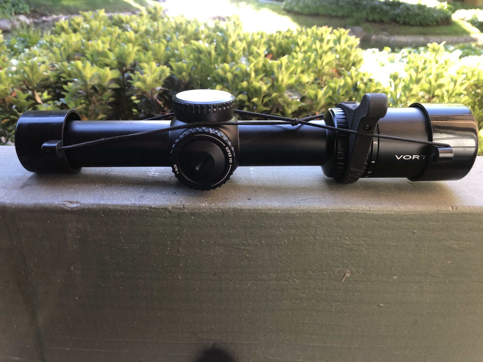

LNIB Vortex pst gen 2, 1-6x24. VMR mil reticle. Box paperwork and the mag lever inc. used for two range trips. $475 shipped

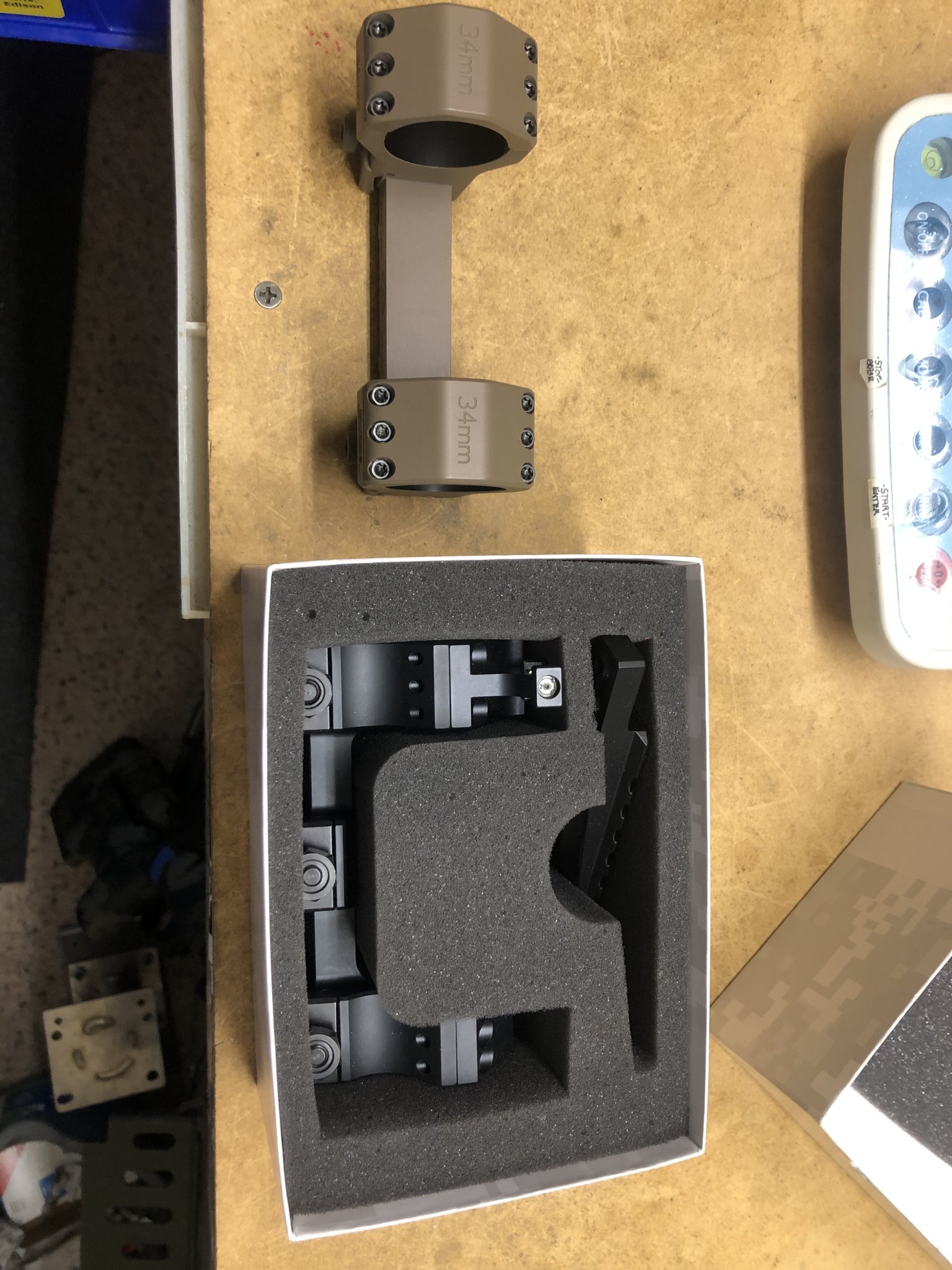

LNIB Hawkins 35mm one piece scope mount. 1.5” 0 moa. $290 shipped
DTA 34mm scope mount. Cerakoted fde. 1.5” high with 20 moa built in cant. Brand new ring cap screws. $190

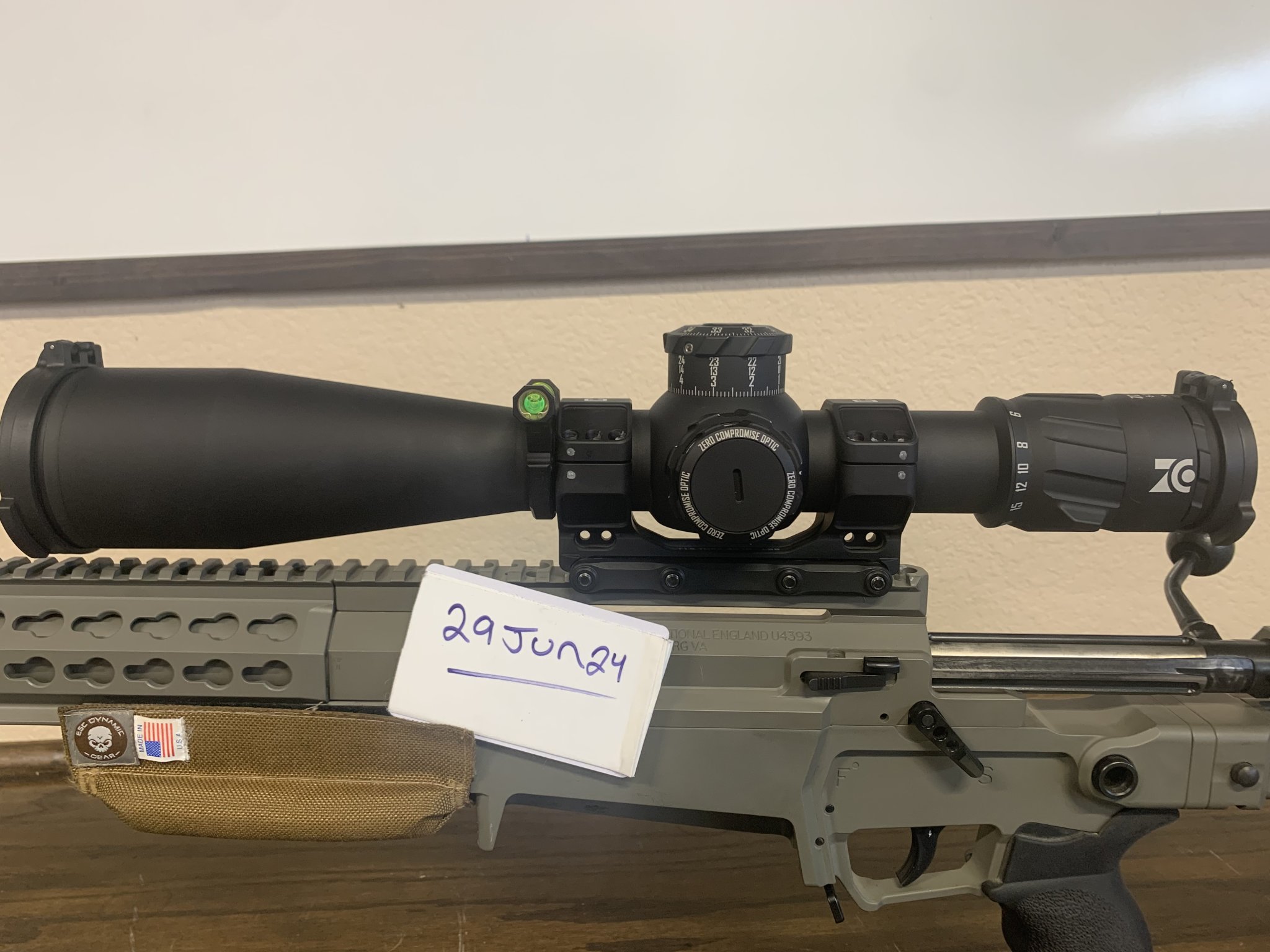

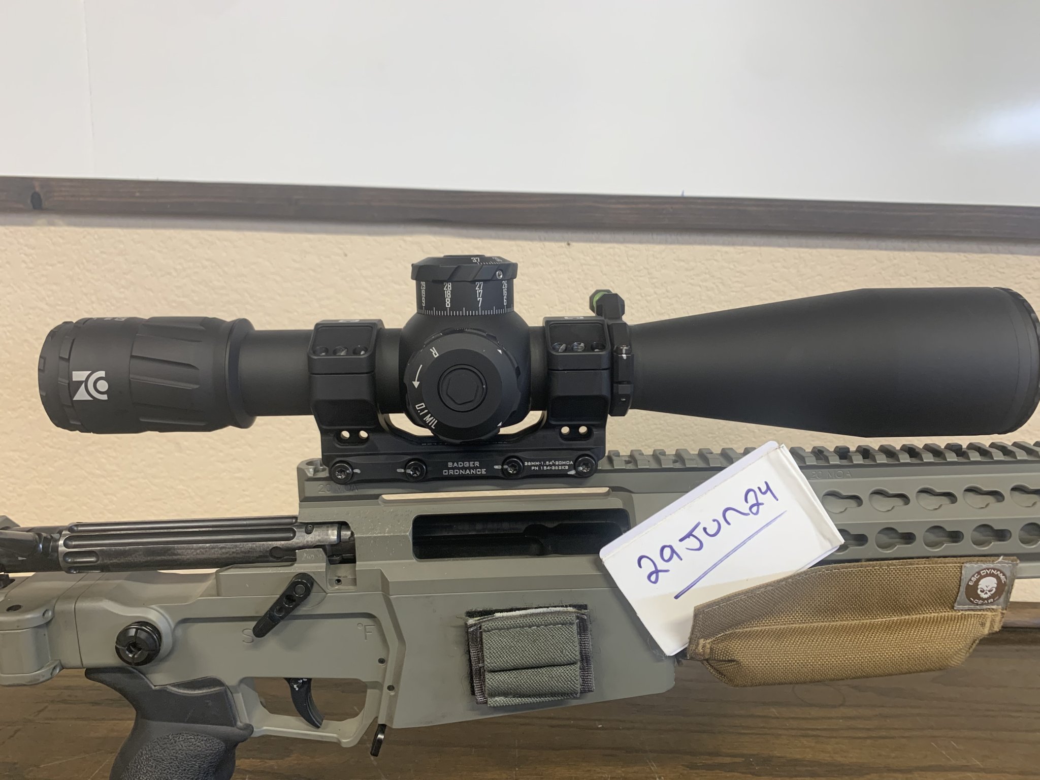

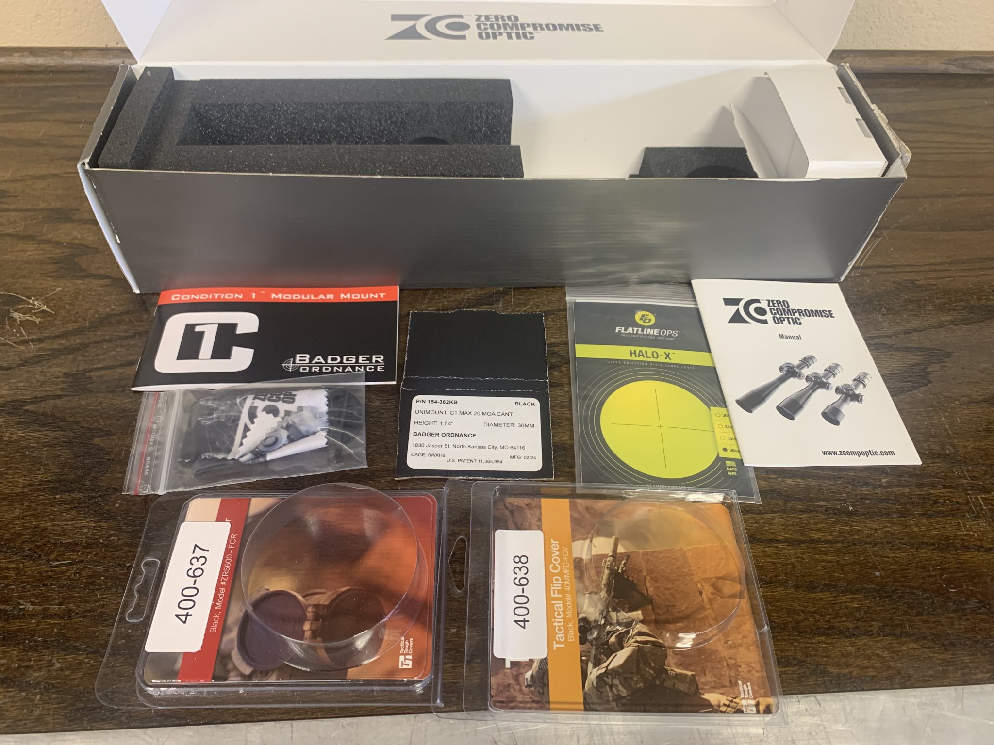

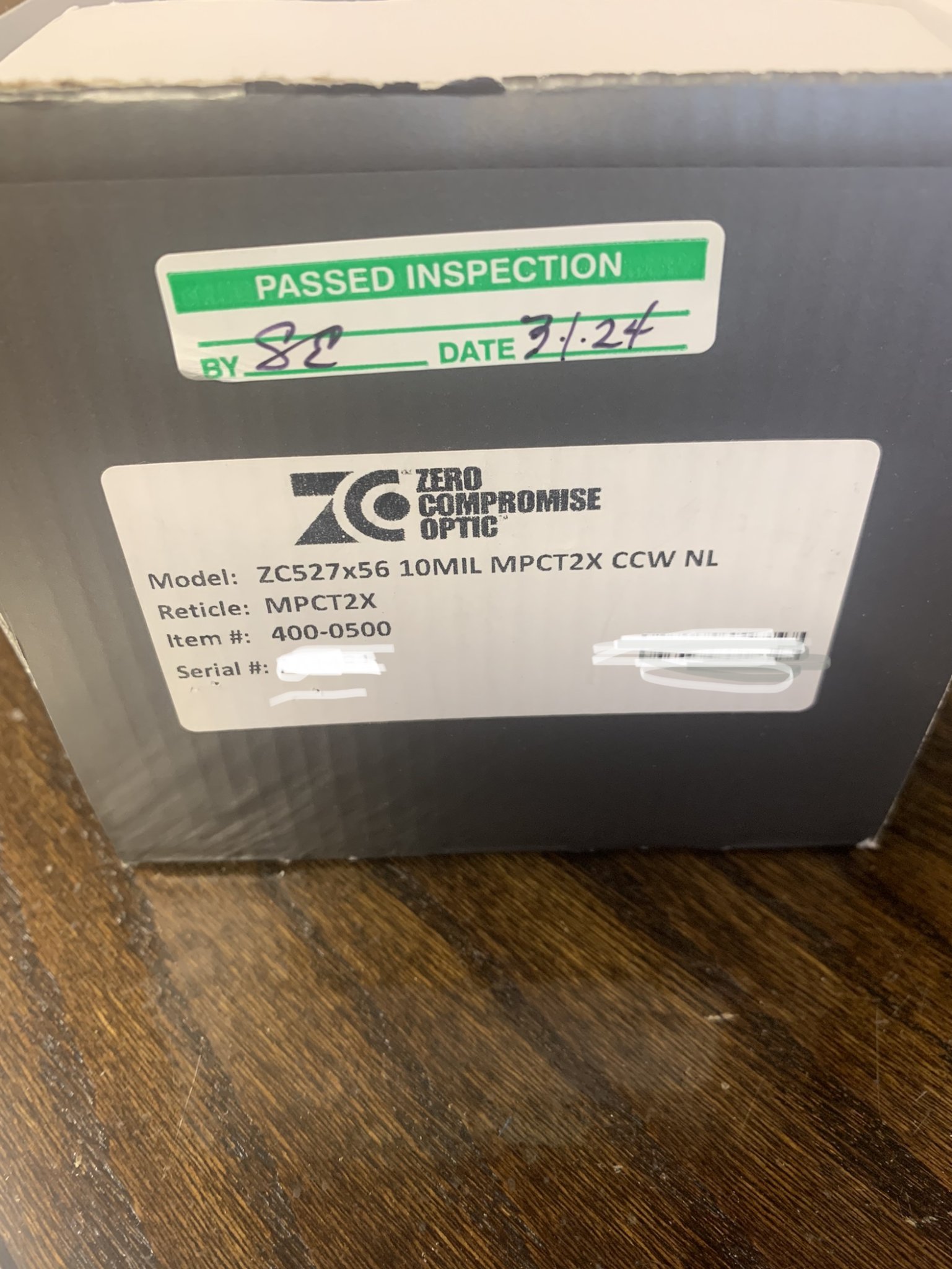

SOLD SOLD

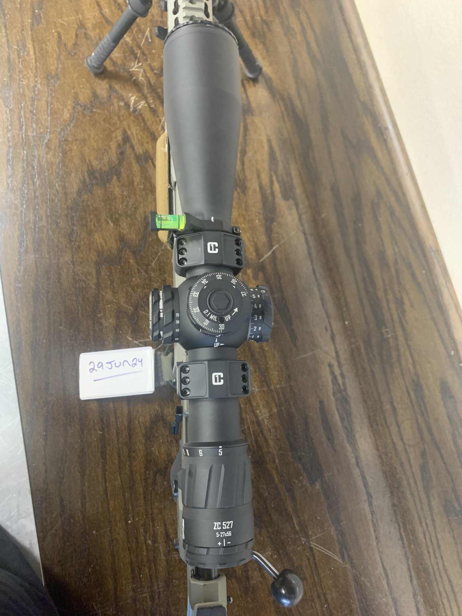

Package:
-ZCO 5-27 10MIL NLE MPCT2X (Black)
-Badger C1 Max 1.5" 20MOA (Black)
-Flatline Ops Halo-X
-2x Turret Tapes (Unused)
Comes with box, tenebraex caps, tool, manual, factory box everything it came with from the factory except the sticker.
Everything is in excellent condition and glass is pristine.
