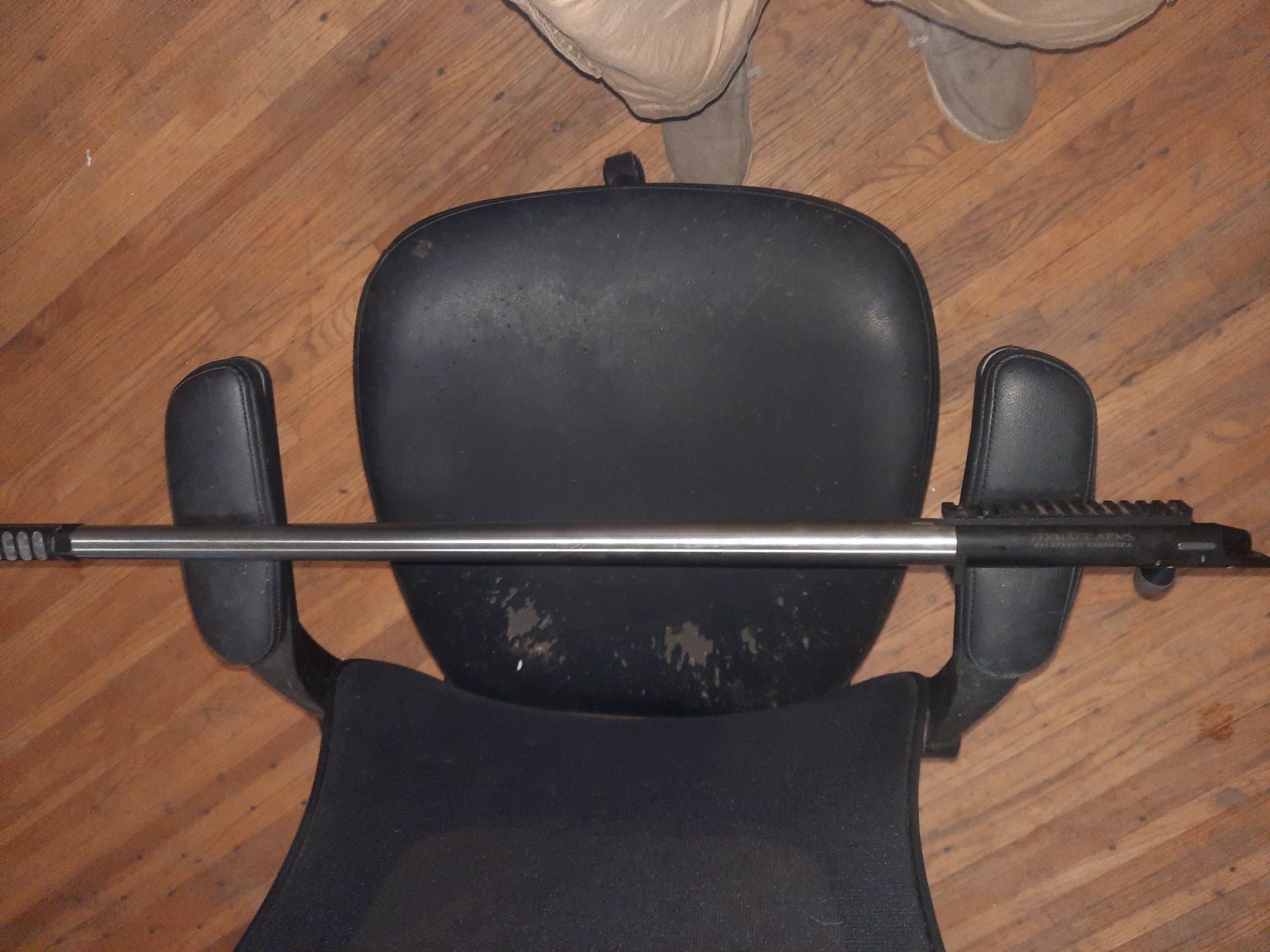

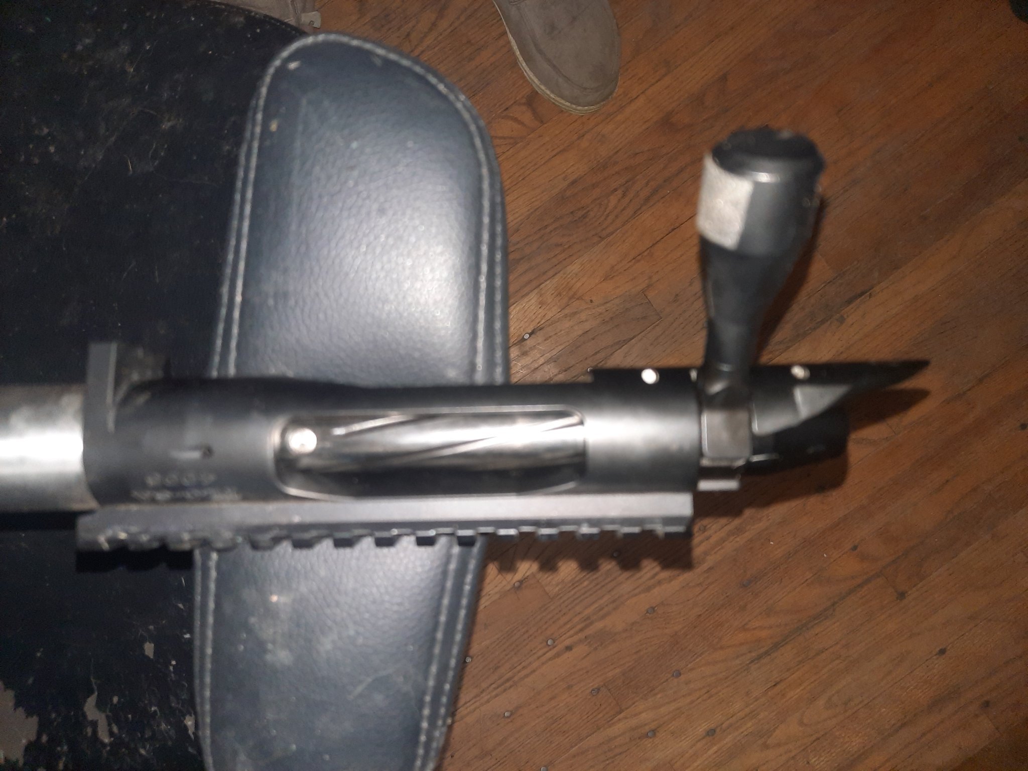

SOLD Big Price Drop TL3 with Proof 6cm
Would like to sell a Zermatt TL3 with Proof SS comp contour 6cm 26" and has a mpa dn3 6.5mm muzzle brake. The action and barrel have around 400rds thru it. I also have roughly 300rds of lapua srp brass that can be sold with the barreled action.
BA with brake-$1550
BA with brake and brass-$1800
