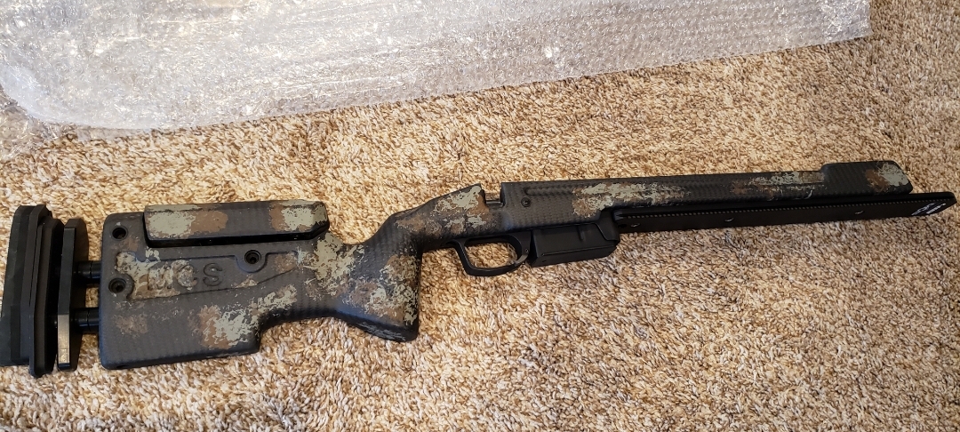

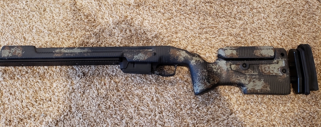

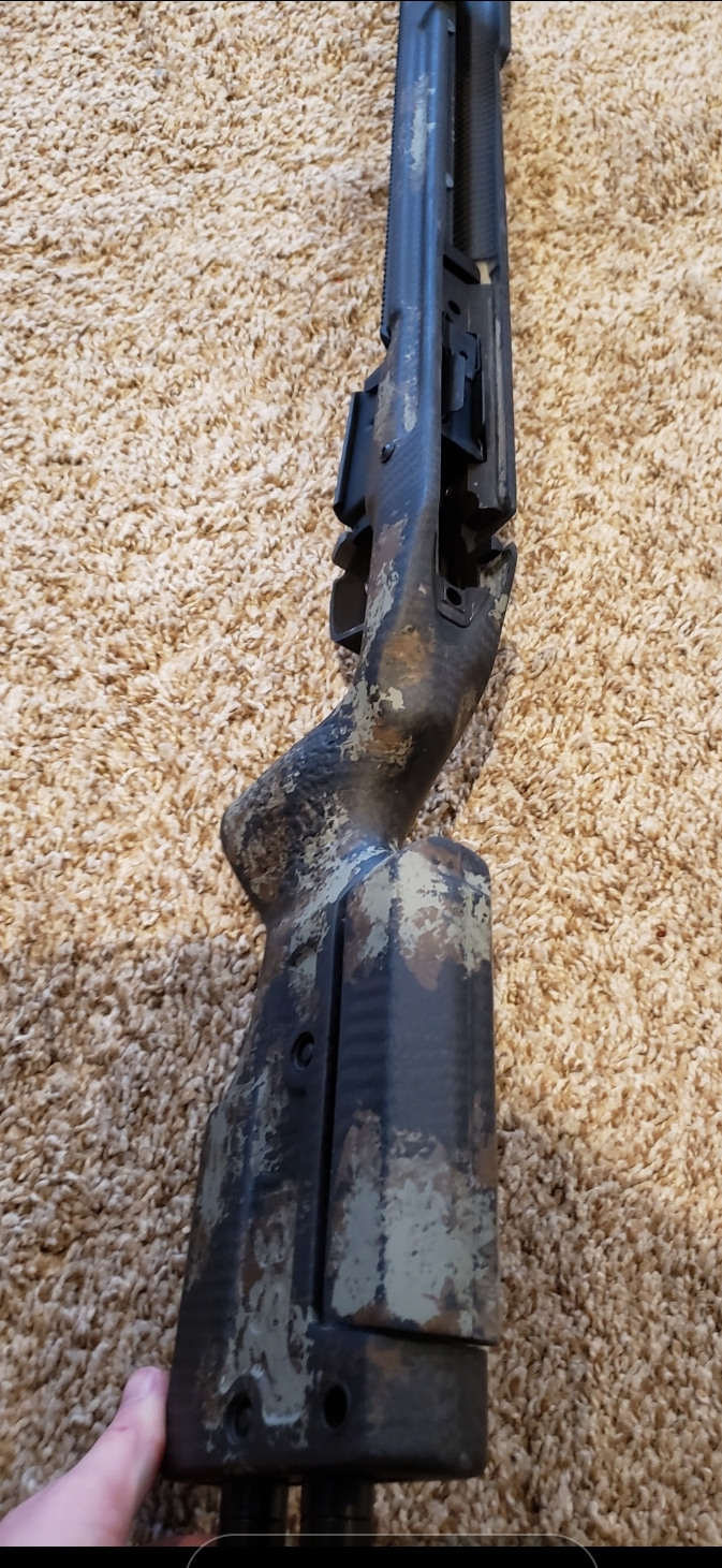

SOLD McMillan A3 Remington 700 SA
McMillan A3 for Remington 700 SA ADL. Molded in camo Black/Green/Brown. Never bedded, lug pocket opened up for an aftermarket lug. Barrel channel for. 1.2” straight contour. Comes with action screws, trigger guard, and blind mag follower/box. Has a small cutout for side bolt release. $550 shipped. Payment via USPS MO, PayPal F&F or Zelle. SOLD

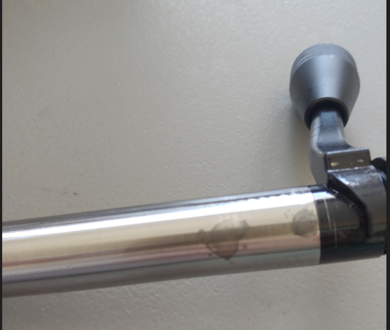

So I Baked My Brass at 425 For a Bit...
I like to dry my wet tumbled brass in the oven at 225 for 30 minutes, then let it cool in the oven overnight to to insure that it's dry. Long story short, I left the brass in the oven for a few days. Wife pre heated the oven to 425 for some nom nom nom onion rings, and lo and behold. When she went to place the onion rings into the oven, there sat my brass. The brass was in that environment for about 25 minutes. It now has a nice rainbow hue to it in the right light. What type of damage did I do to that brass?
It's no real loss as it's only range .223/5.56 brass. Only 100 pieces that I was part of a lot that I will be turning into .300 BO Brass. But I would like to know what damage I did to the brass? Why is it now a rainbow hue? Obviously due to the high heat at a prolonged time, but metallurgically speaking, what happened to the brass? Should I throw it away now as it may be unsafe to use?

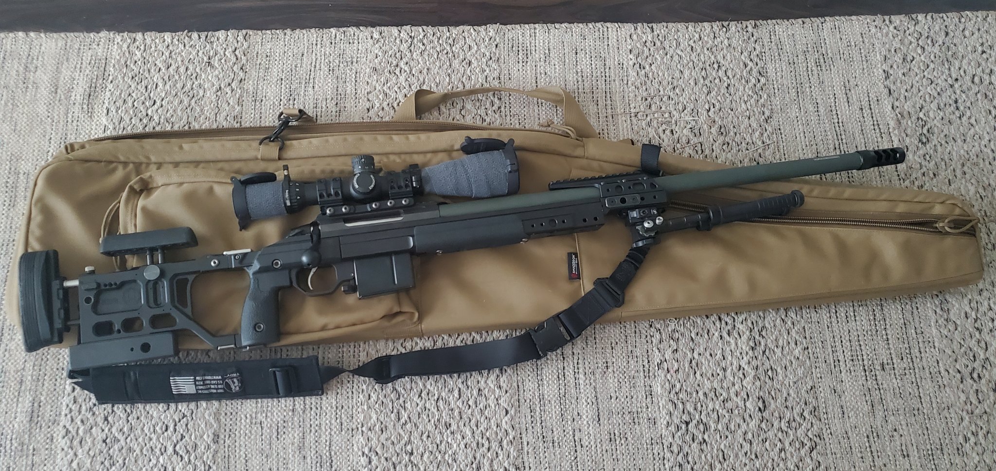

Firearms AI ATX - Elite Sand
I may regret this later, but I decided to consolidate / deal with swapping barrels and bolts on my AXSR rather than run two rifles.
$4250 shipped and fully insured to your FFL. The rifle will come with a hinge kit installed, but no barrel. The buttstock and hinge are cerakoted in AI dark earth (I’m willing to have it swapped back to ES if that’s a deal breaker), although I’ve been digging the contrasting colors. If you’re interested, drop me a PM and I’ll share pictures.
215 hybrids, or an L lug (very random I know), would be the only partial trades I’m interested in. Give me a shout if you have any questions.
