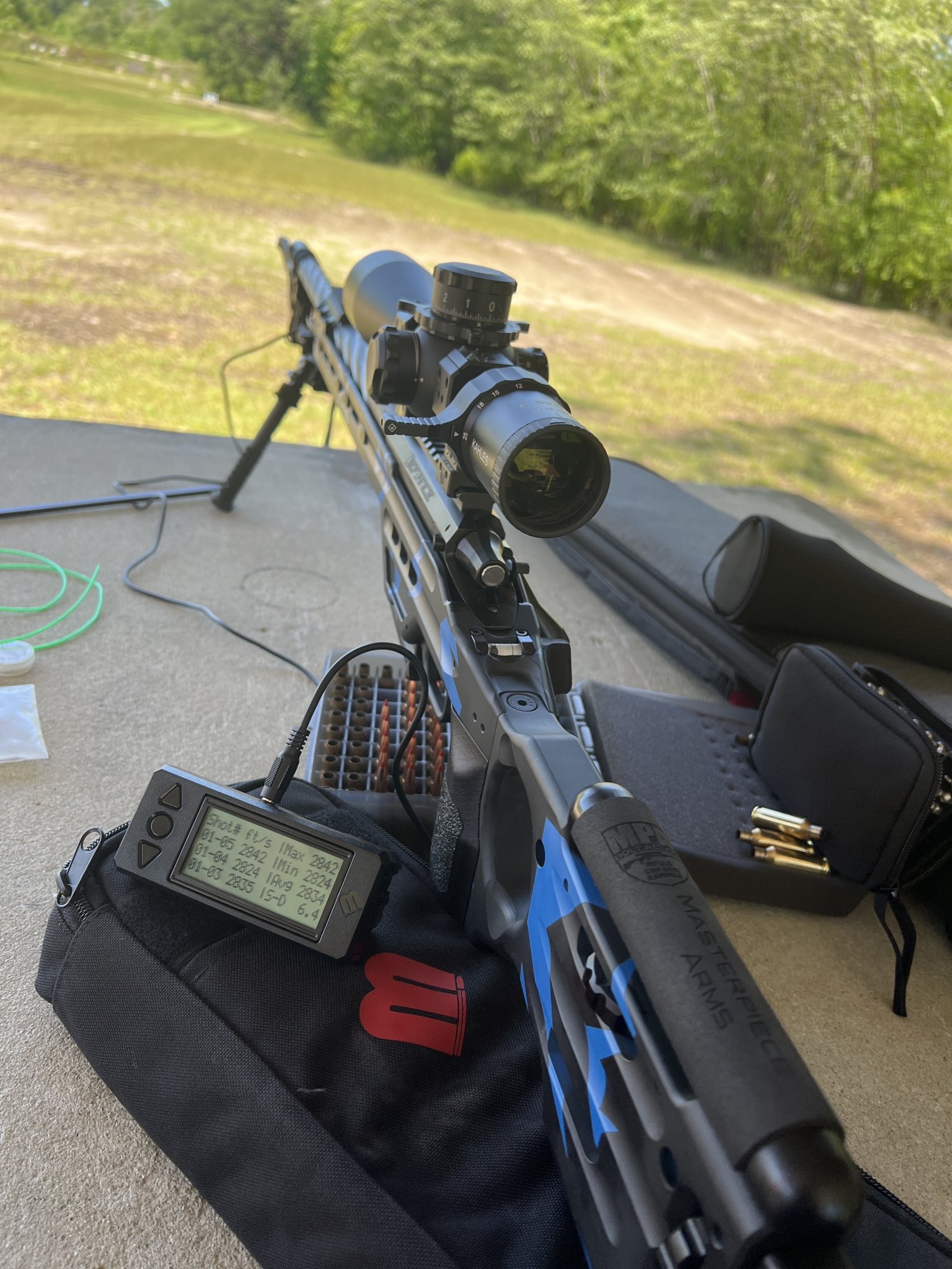

Rifle Scopes Trijicon Tenmile dang
I decided to try two scopes on my new long range rifle.
Trijicon tenmile 4.5-30 MOA FFP
Nightforce NX8 2.5-20 MOA SFP
NF was great and took the rifle way beyond ranges I imagined to 1400 yds.
Just for trying I swapped to the Tenmile for magnification and the FFP. After a hard time zeroing and finally getting what I thought a zero at 200yds with some cheap and nice ammo. 300yds plus was almost impossible. All bolts were double checked for torque on scope rings and Seekins mount.
I was getting very frustrated and swapped back to the NF scope.
The NF zero was still great. Shot only the cheap ammo and damn. I shot 200 to check zero, hit my 300 propane tank and knocked it over then continued knocking over the 400 and 500 yds propane tanks.
600yds was on paper and 700yds hit the bullseye almost center.
Not saying the Tenmile scopes are all bad but this one was definitely defective. The FFP and 30x was nice but not if the zero goes all over the place.

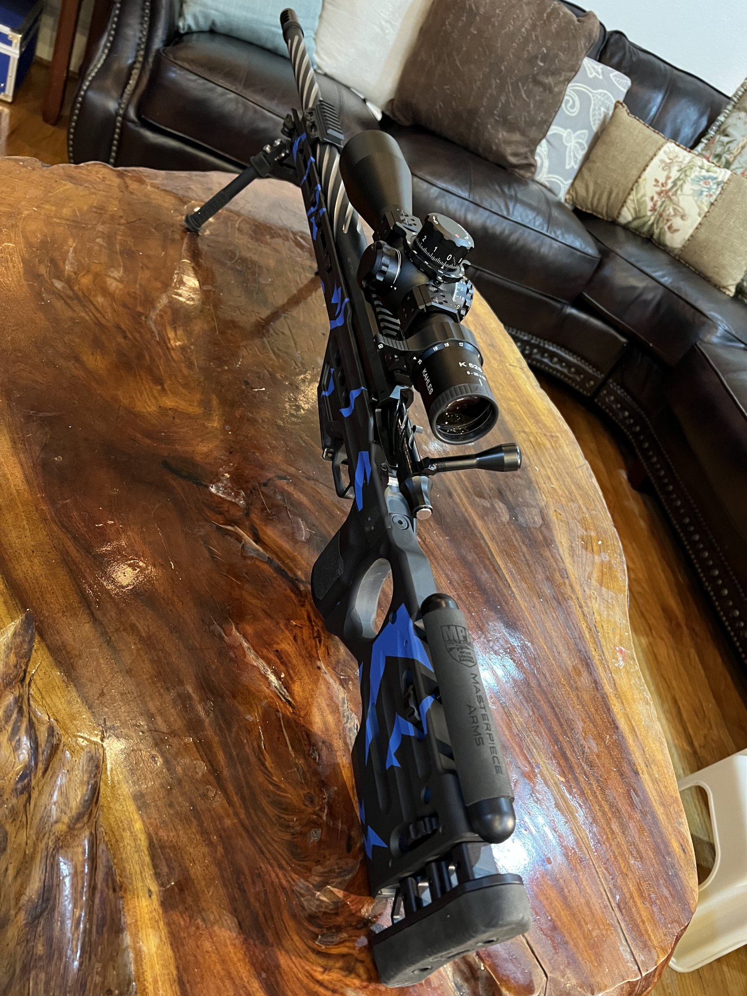

So I want to try a chassis
I want to build a short lightweight rifle for when hunting with my boys. Western PA and WV mountains. Most shots 300yds or less. Mostly tree stand or box blind hunting.
Whitetail
Coyote
Woodchucks
Coons
Fox
6.5x47 Lapua and 6.5CM probably. I’m already set up to load for both. Have multiple rifles chambered in both.
I’ve always used Manners and McMillan stocks. But with my kids being young and growing, the adjustability of the chassis have tweaked my interest. LOP and eye relief being a priority. No bedding / inlet work needed will reduce cost. And lack of bottom metal / bedding dam nears gets some of the chassis I’m looking at to the same weight or less than my carbon fiber EH4 Manners stocks.
I’m looking at the MPA BA Ultralite chassis. Defiance Anti action. Proof CF 20in barrel. Triggertech trigger. Threaded for my TBAC suppressors.
Anybody here have experience hunting with a chassis rifle? Experience with kids shooting a chassis rifle?
