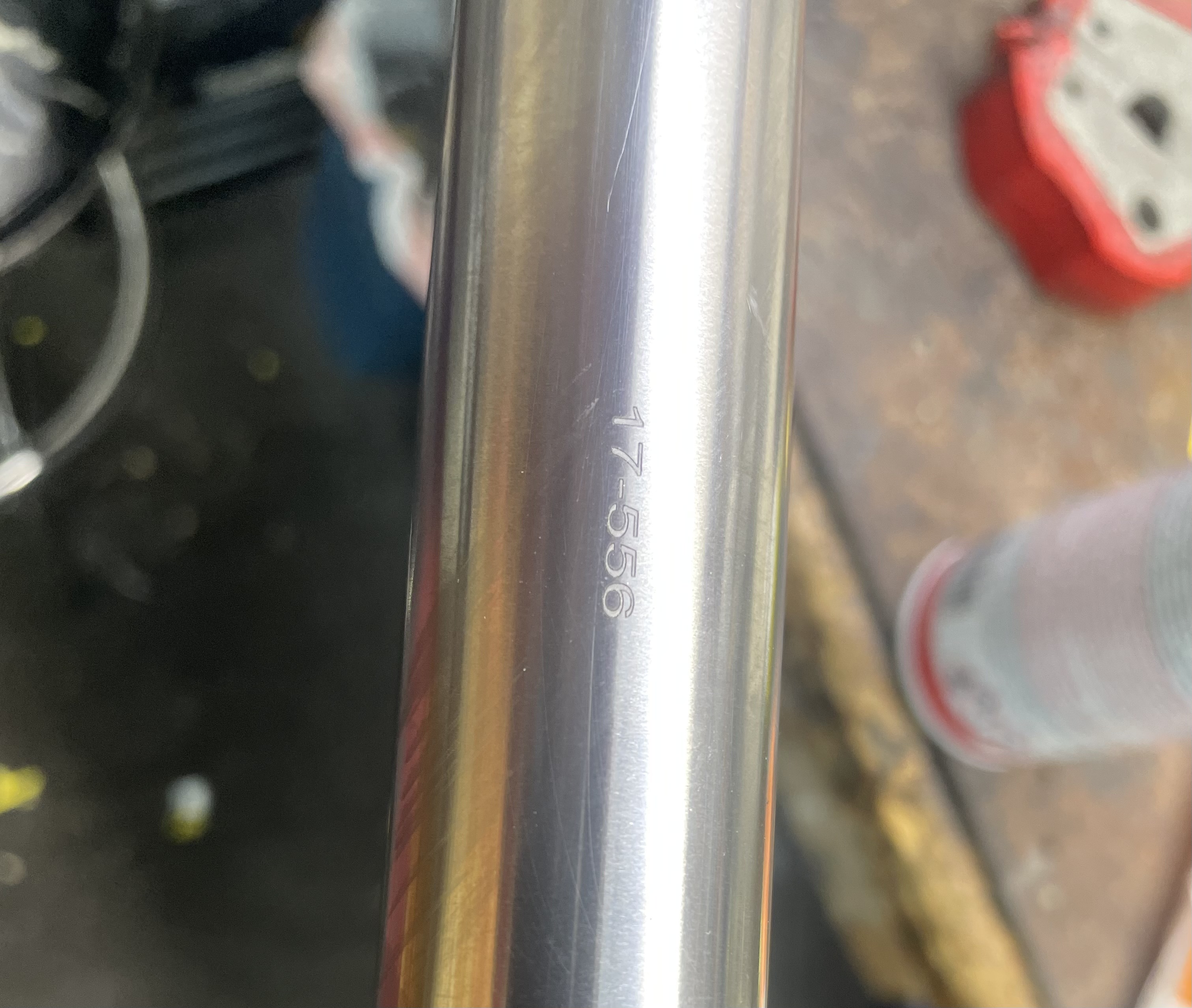

7 flute, 7in twist, left hand.@bohem
It's two years later, but did we ever get an answer to what this flute count was?
(and contour)
Close enough, call it whatever you want. It's your wildcat.Would this technically be a 17x45?View attachment 8786198
