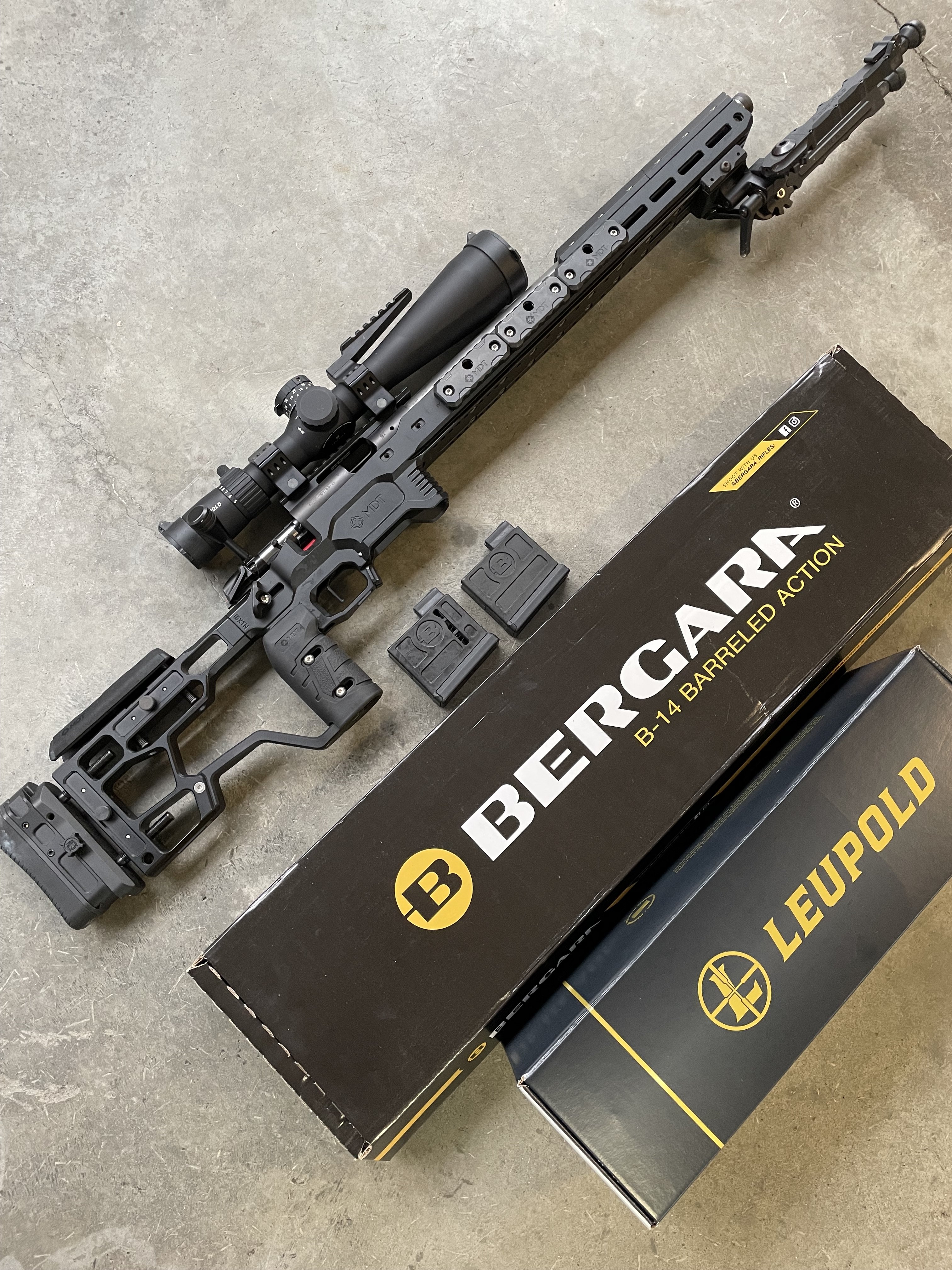

Firearms WTS Bergara B14R 22LR Heavy barreled action & Leupold MK5 5-25x56 PR2

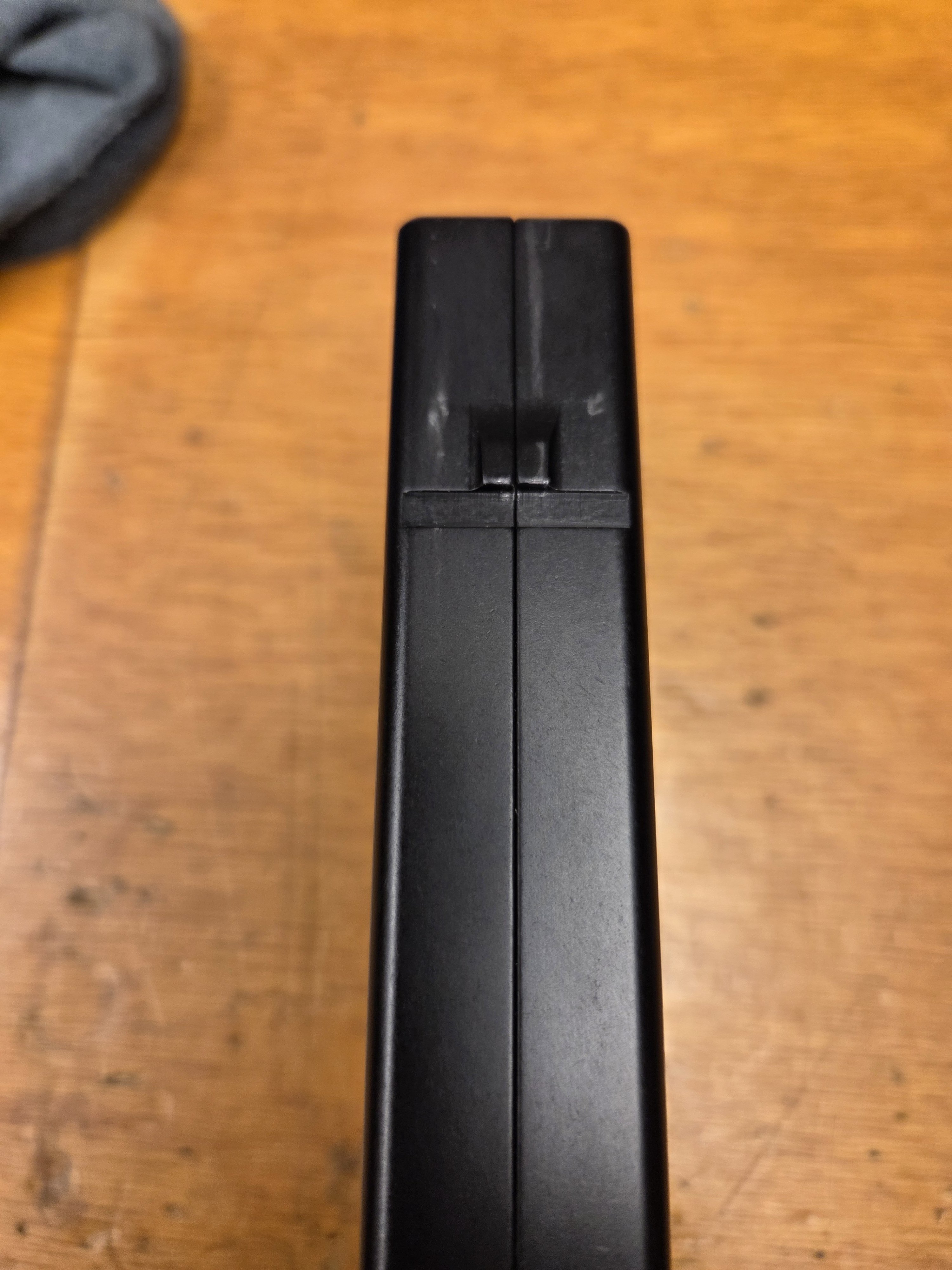

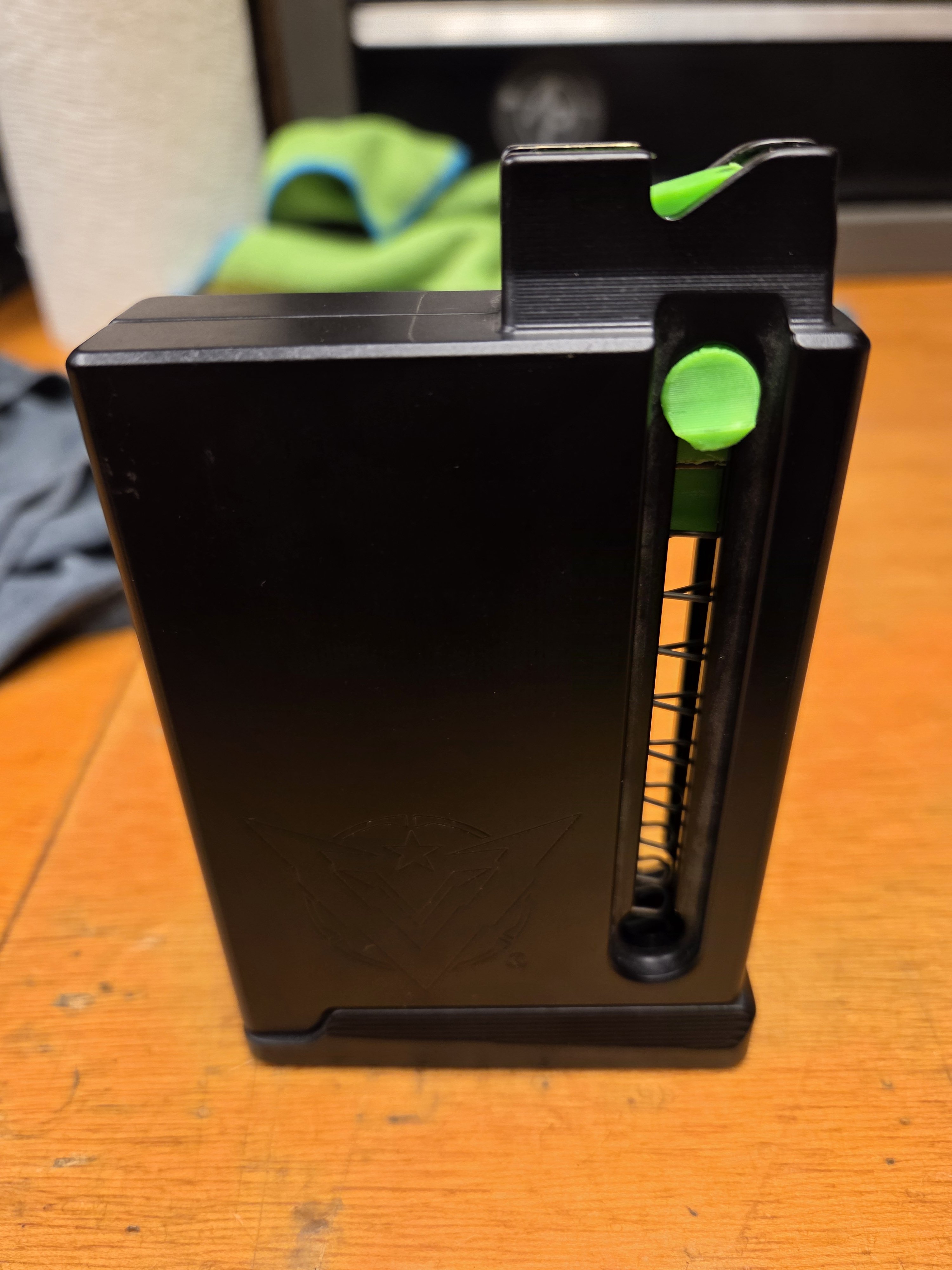

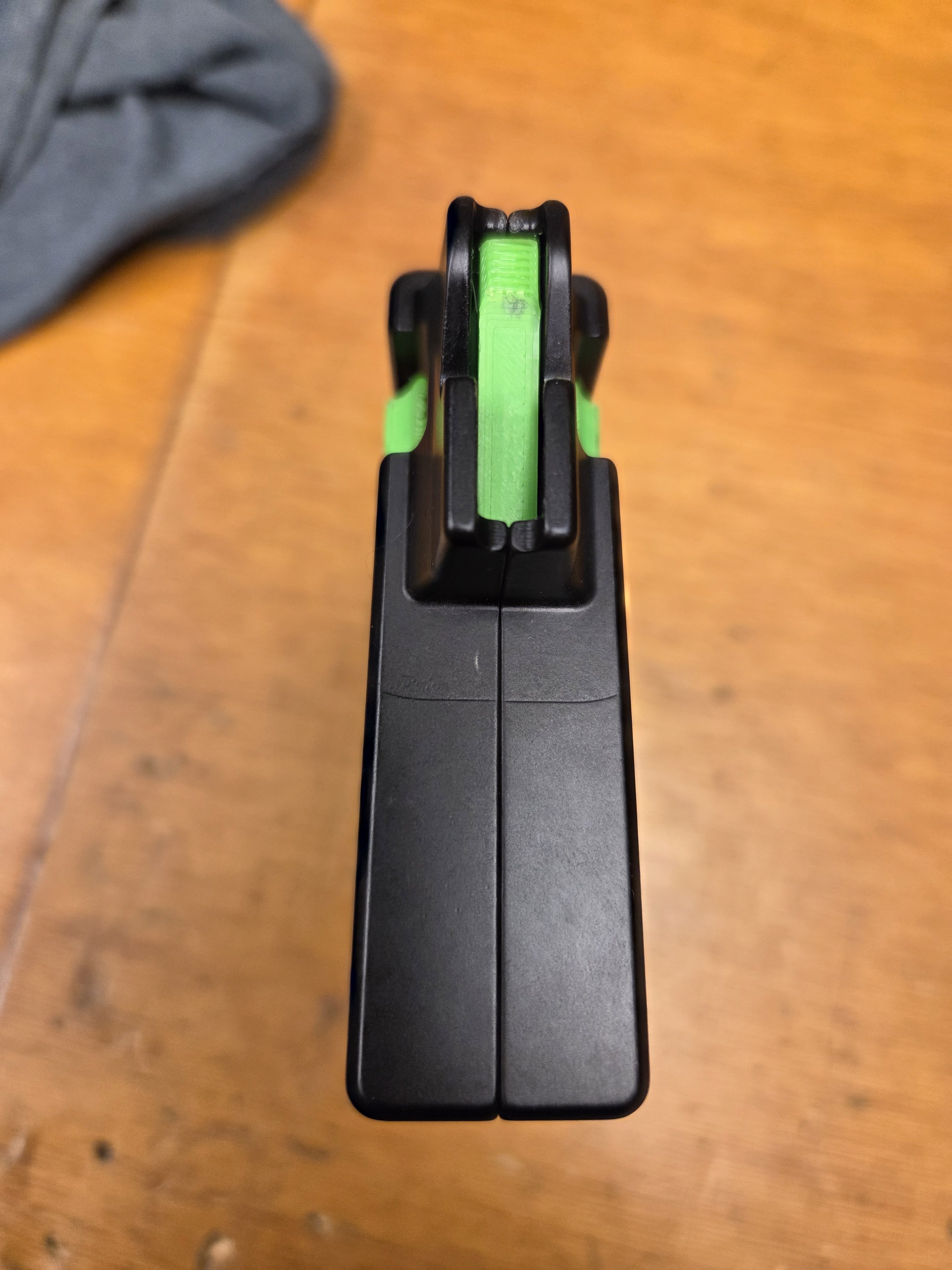

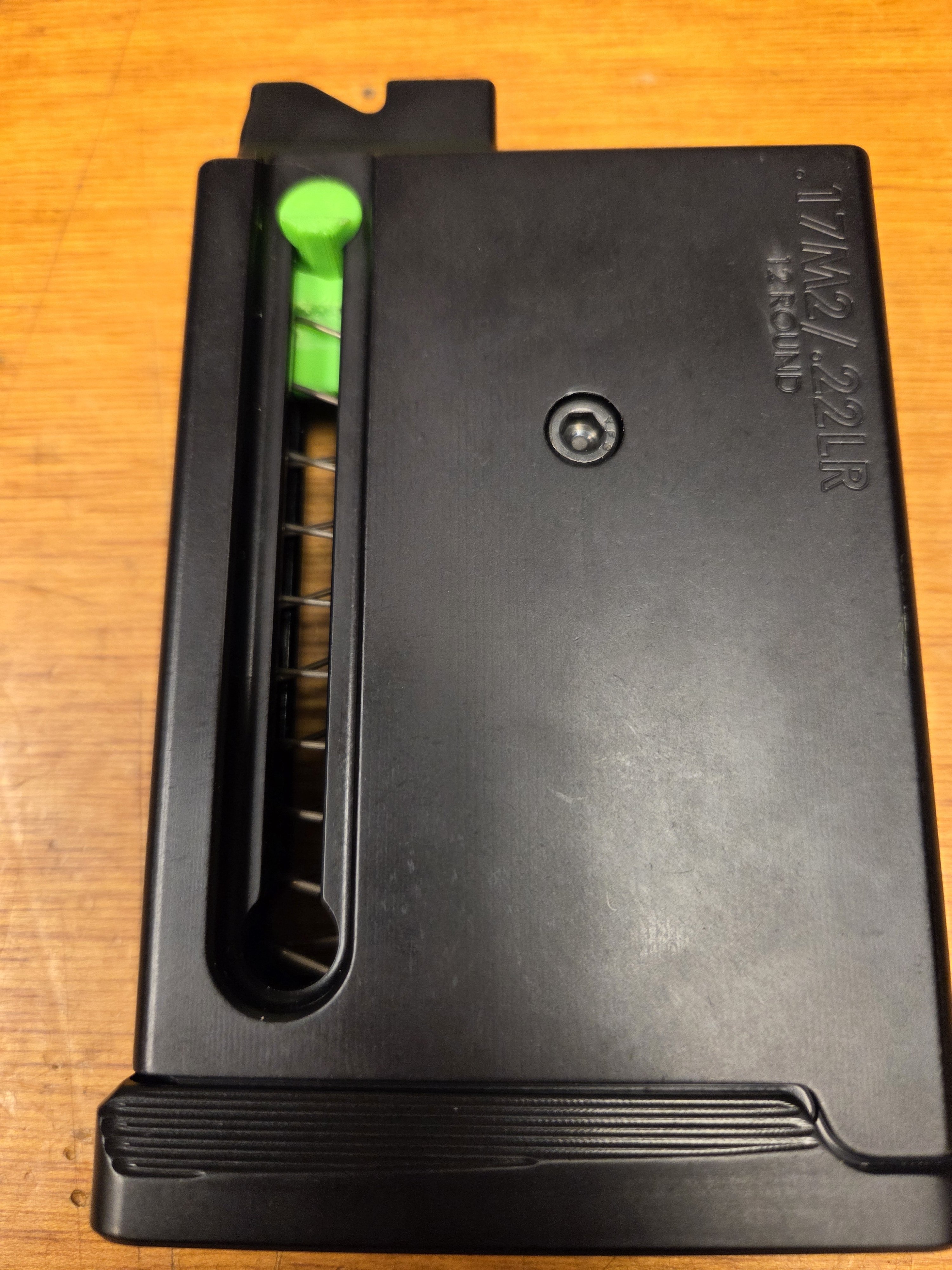

Like the title says I have a B14R barreled action for sale with about 1400 rounds on it. Come with two mags and a EGW 40MOA base.
I also have a like new Leupold MK5 5-25x56 with the PR2 Reticle. It’s sitting in Hawkins Precision rings at the moment. Would like to sell them together but I don’t have to.
B14R w/ Mags and Base $780
Leupold MK5 $1800 w/ Rings
Reactions: Garett73
