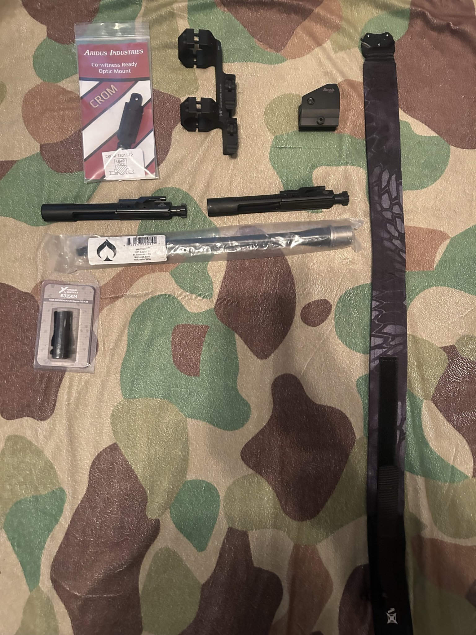

Now you might just say "Oh that guy just bitter and doesn't know how to shoot. Well here's a 20rd group (4 separate groups of 5 shots) with the same 69gr Barnes ammo shot out of a virtus barrel installed on the exact same optic (1-6x)/upper/lower (different tapered bolt of course for the virtus) today as well, shot off the same bipod and rear bag. Except this group is at 100 yds. Still not as impressive as a couple of my JP barreled AR's with match ammo (especially considering Sig charges $900 for a barrel) but for a 1:7 Sig barrel, of a bipod and rear bag, and 4 separate groups, It's more than acceptable.. The downside is the weight of the Virtus barrel destroys the gun's balance and you lose the best part of the MCX (light weight and balance) in the process.
