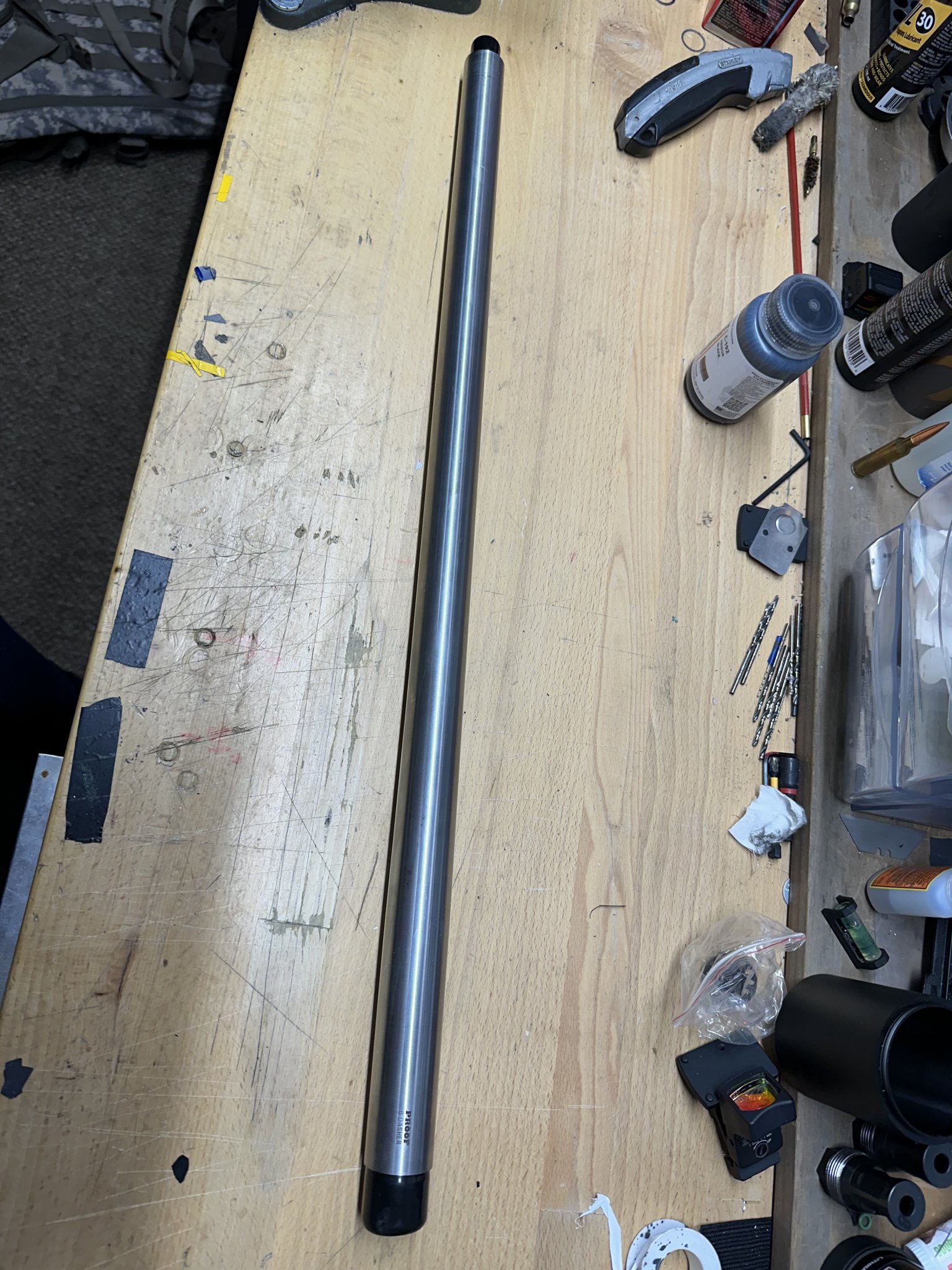

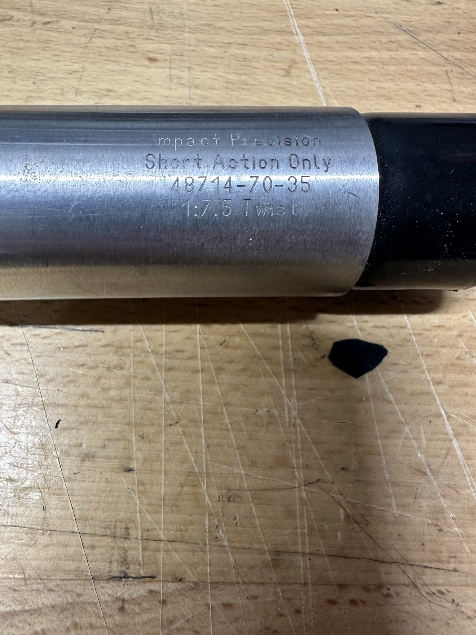

Accessories New Defiance Rukus Prefit Barrel 6CM Benchmark
Brand New Defiance Rukus Prefit barrel chambered in 6mm Creedmore by Blue Mountain Precision. Barrel is a Benchmark M24, 7.5tw, threaded 5/8x24, finished at 26”. $750 shipped to the lower 48.
Payment: Venmo, Zelle or Money order.
