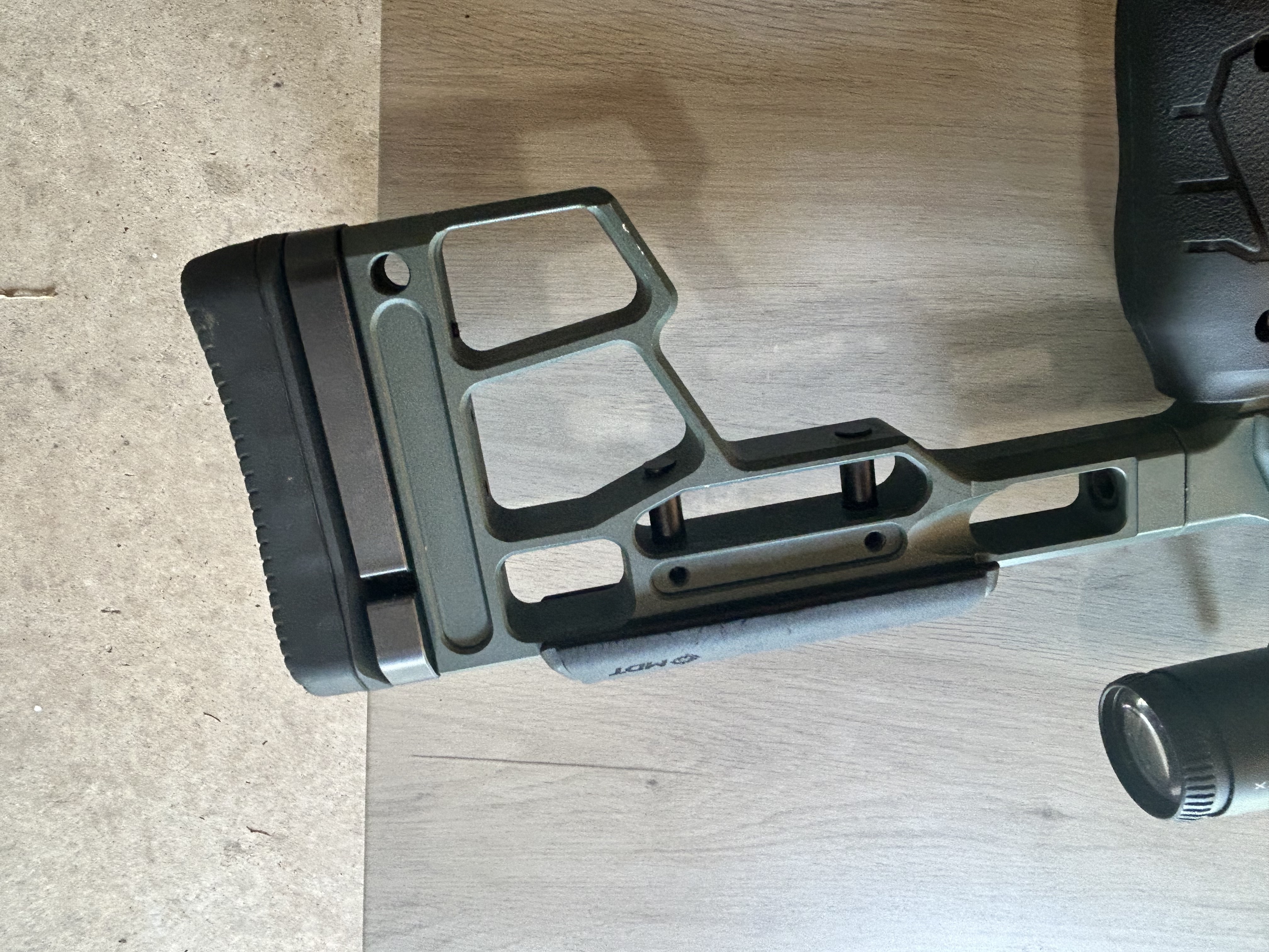

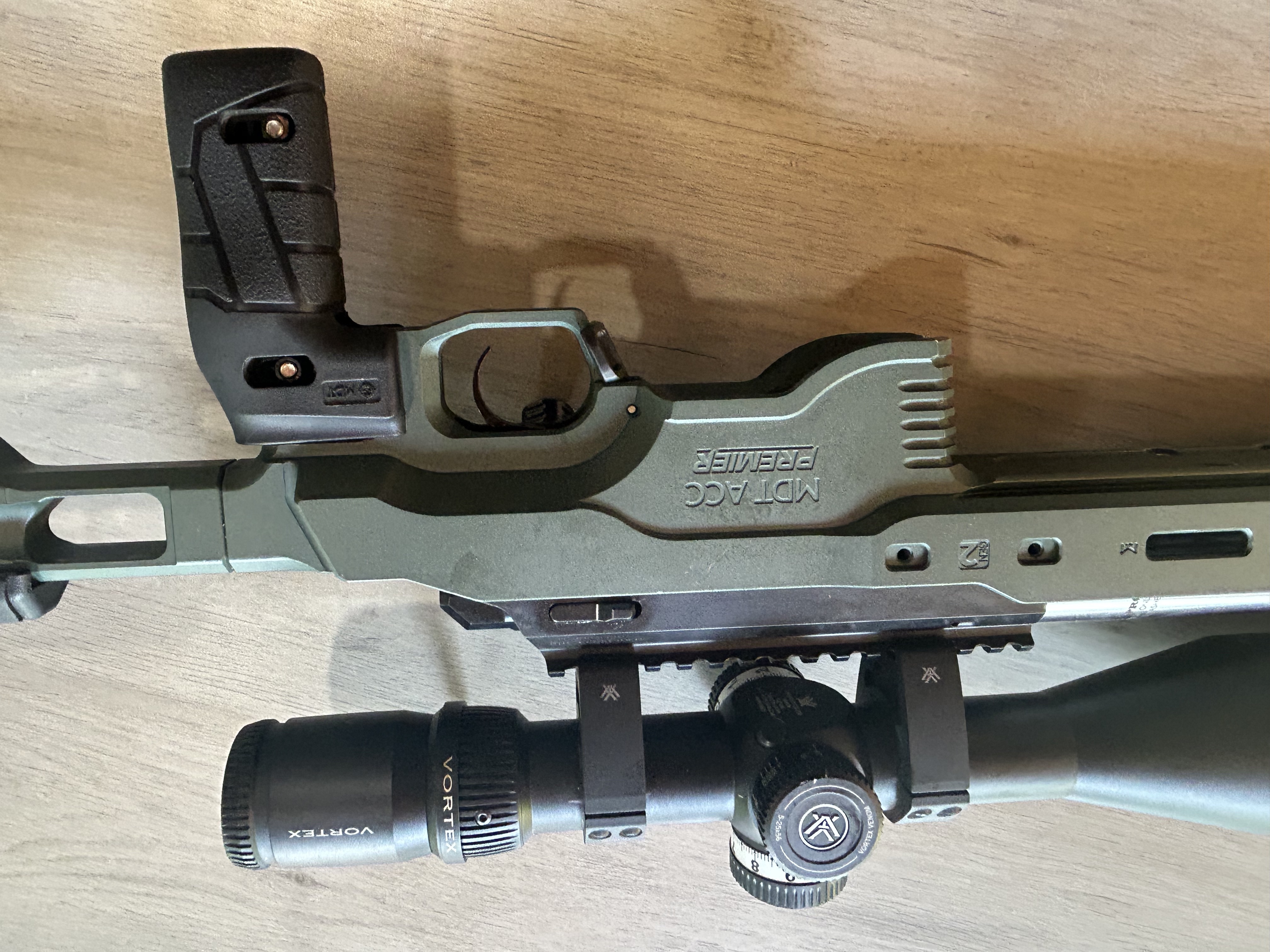

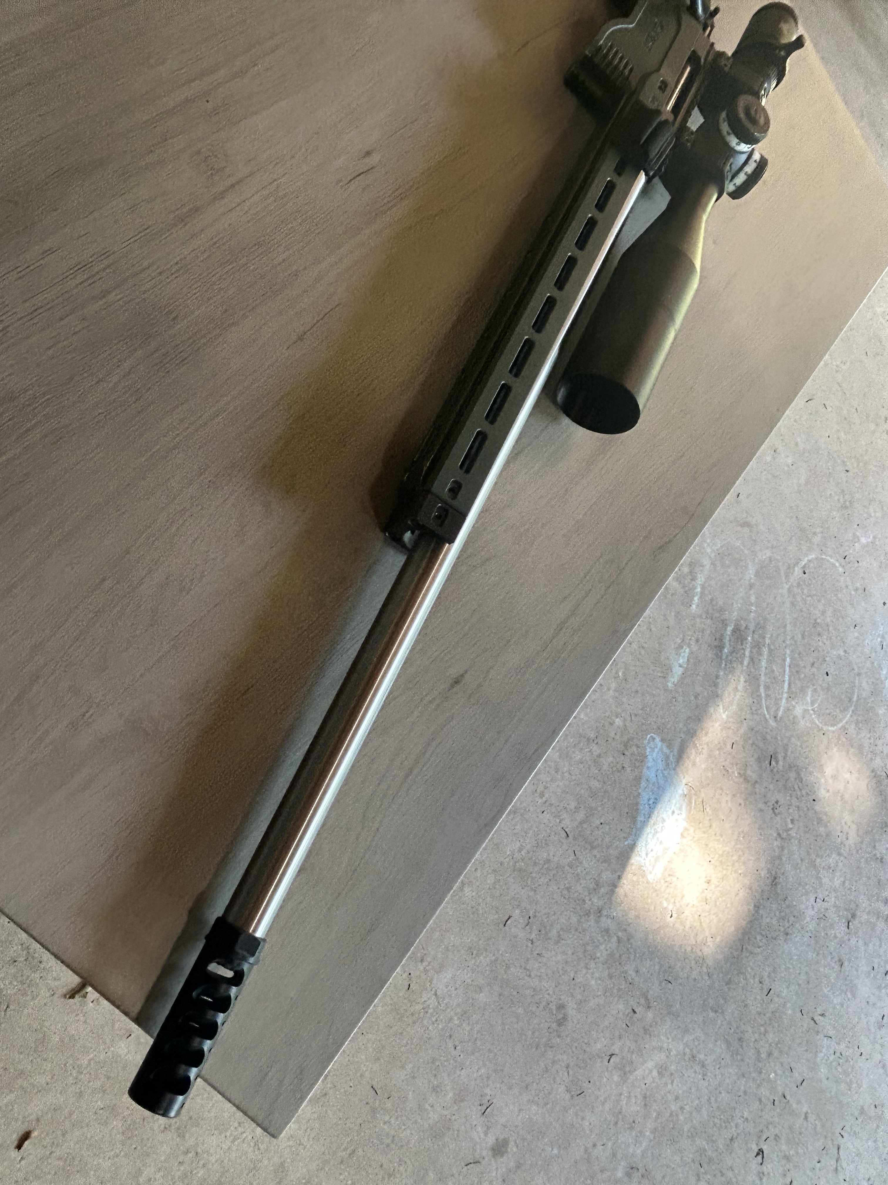

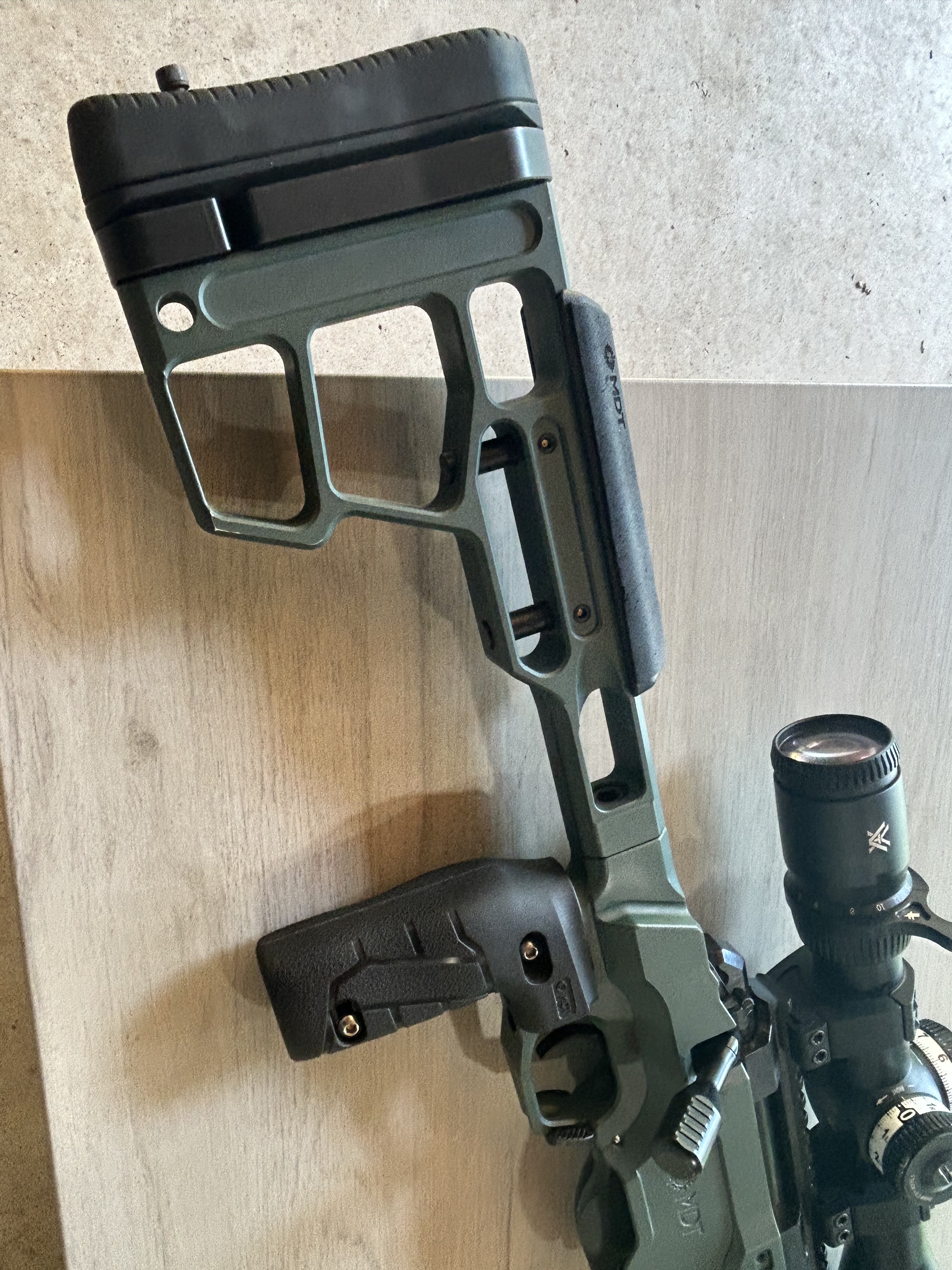

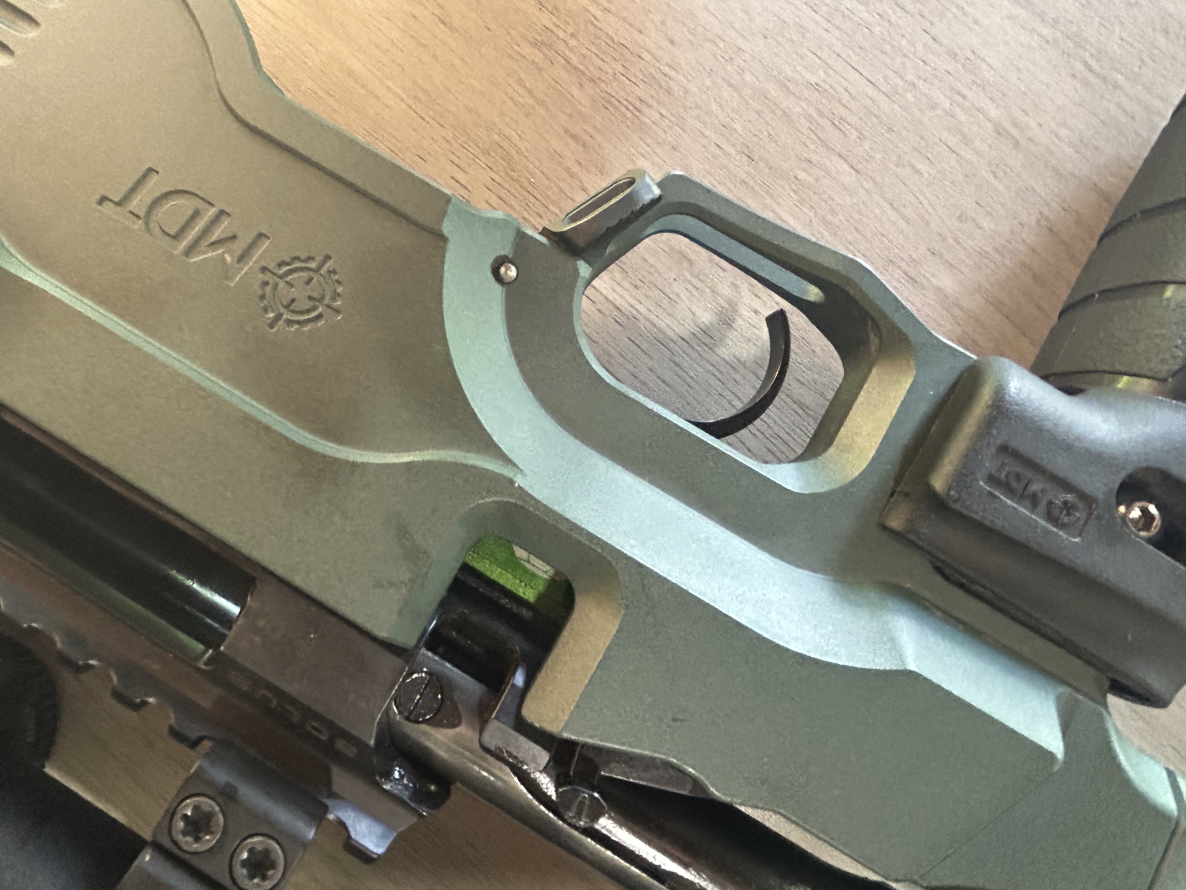

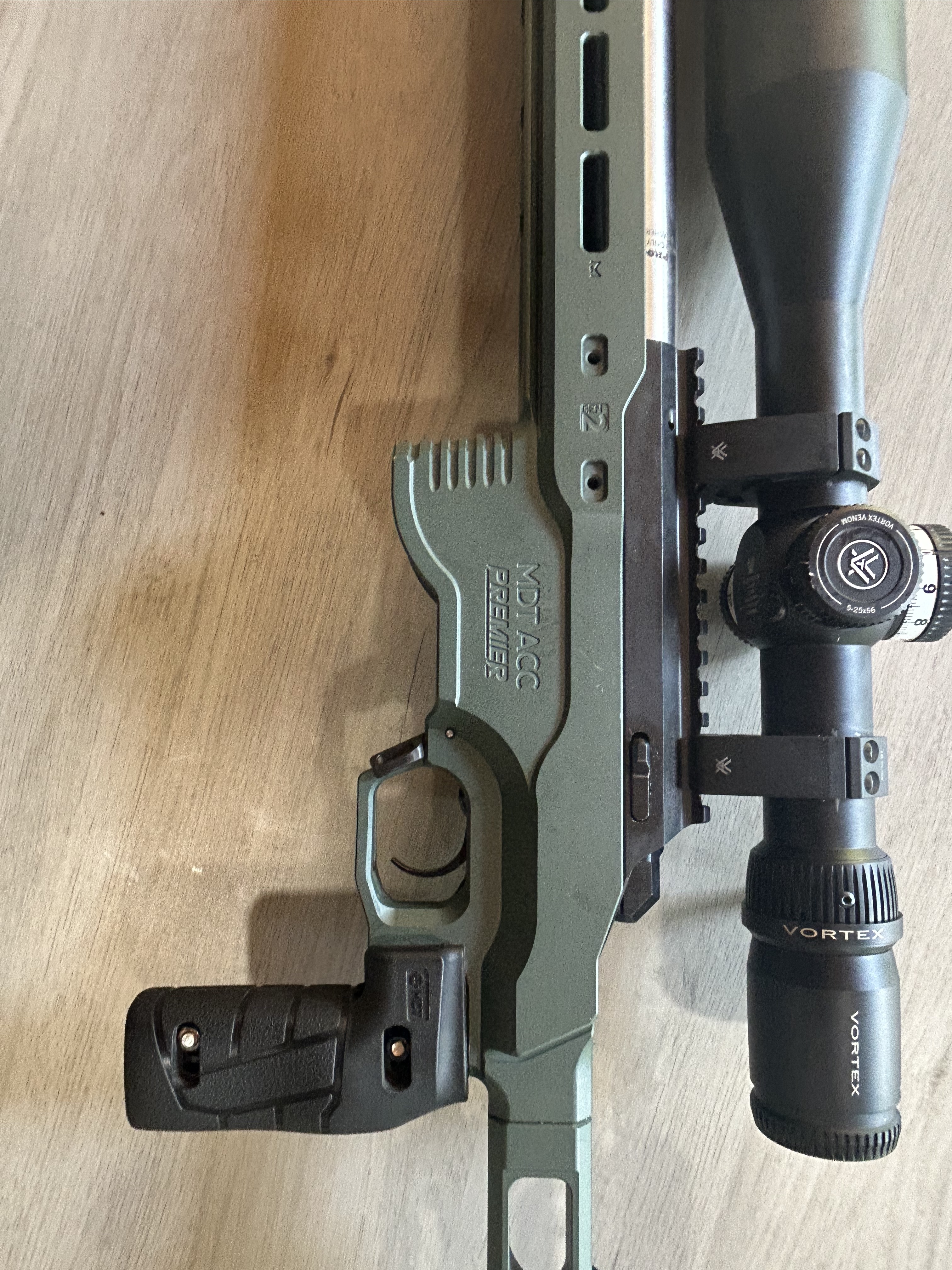

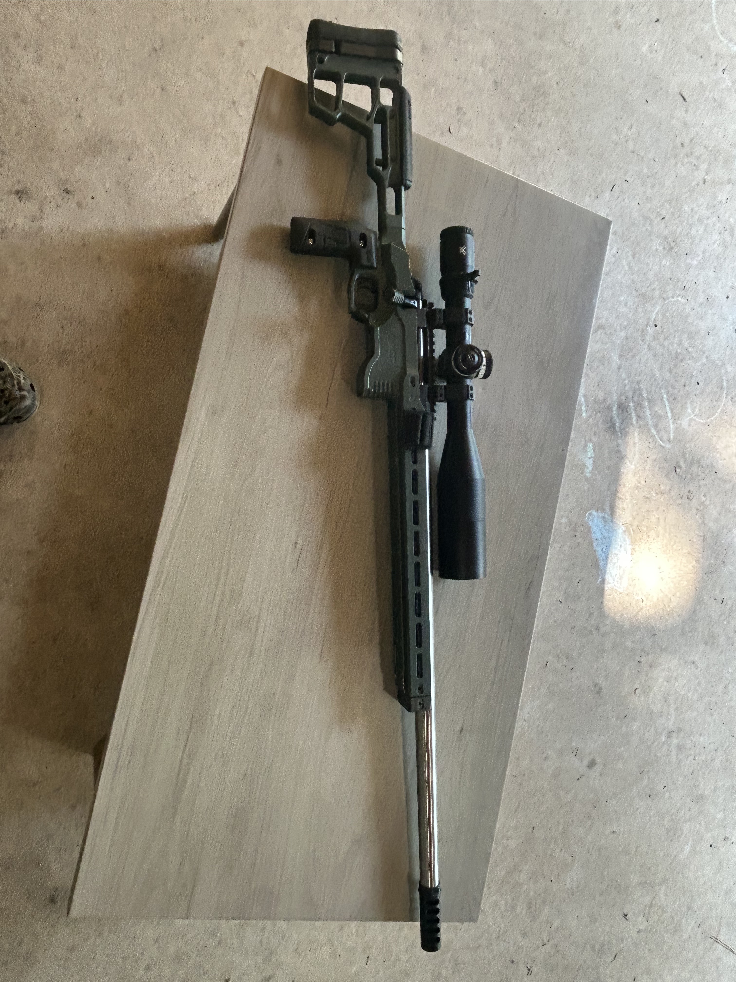

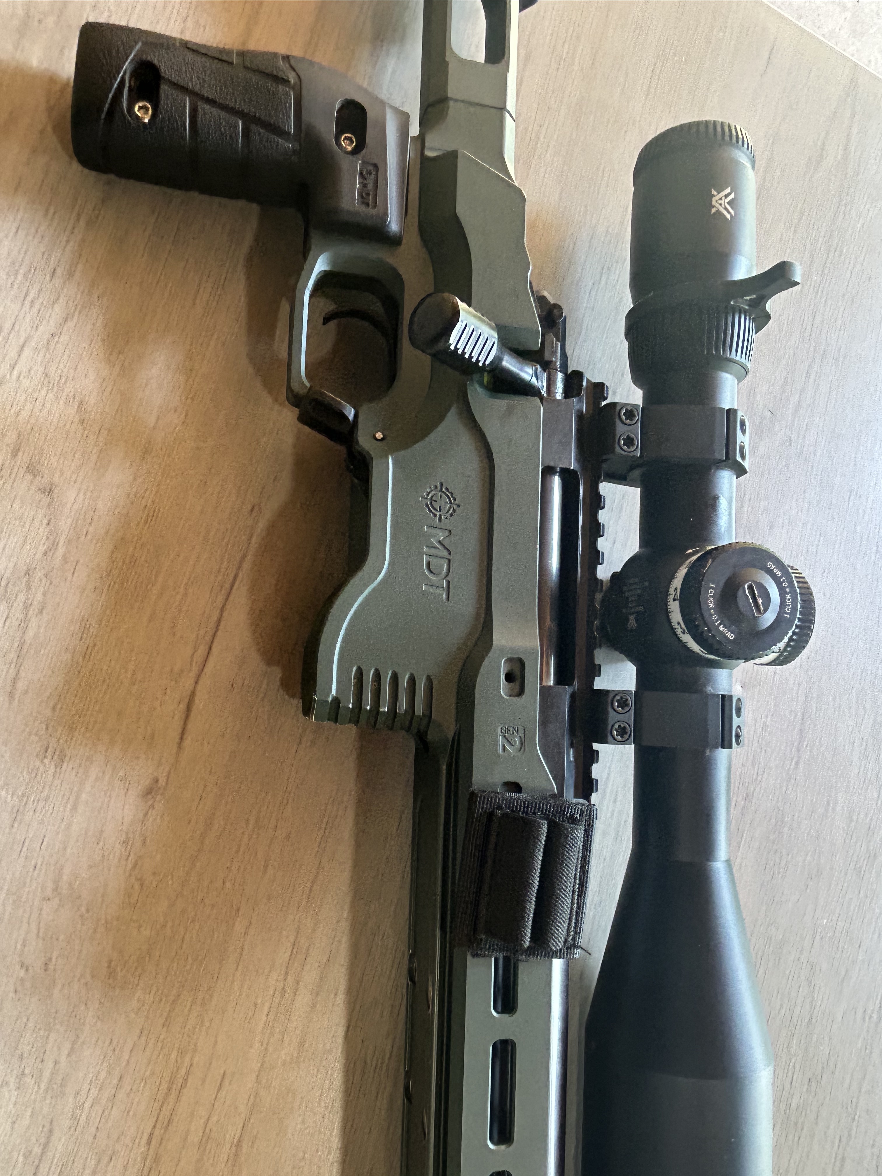

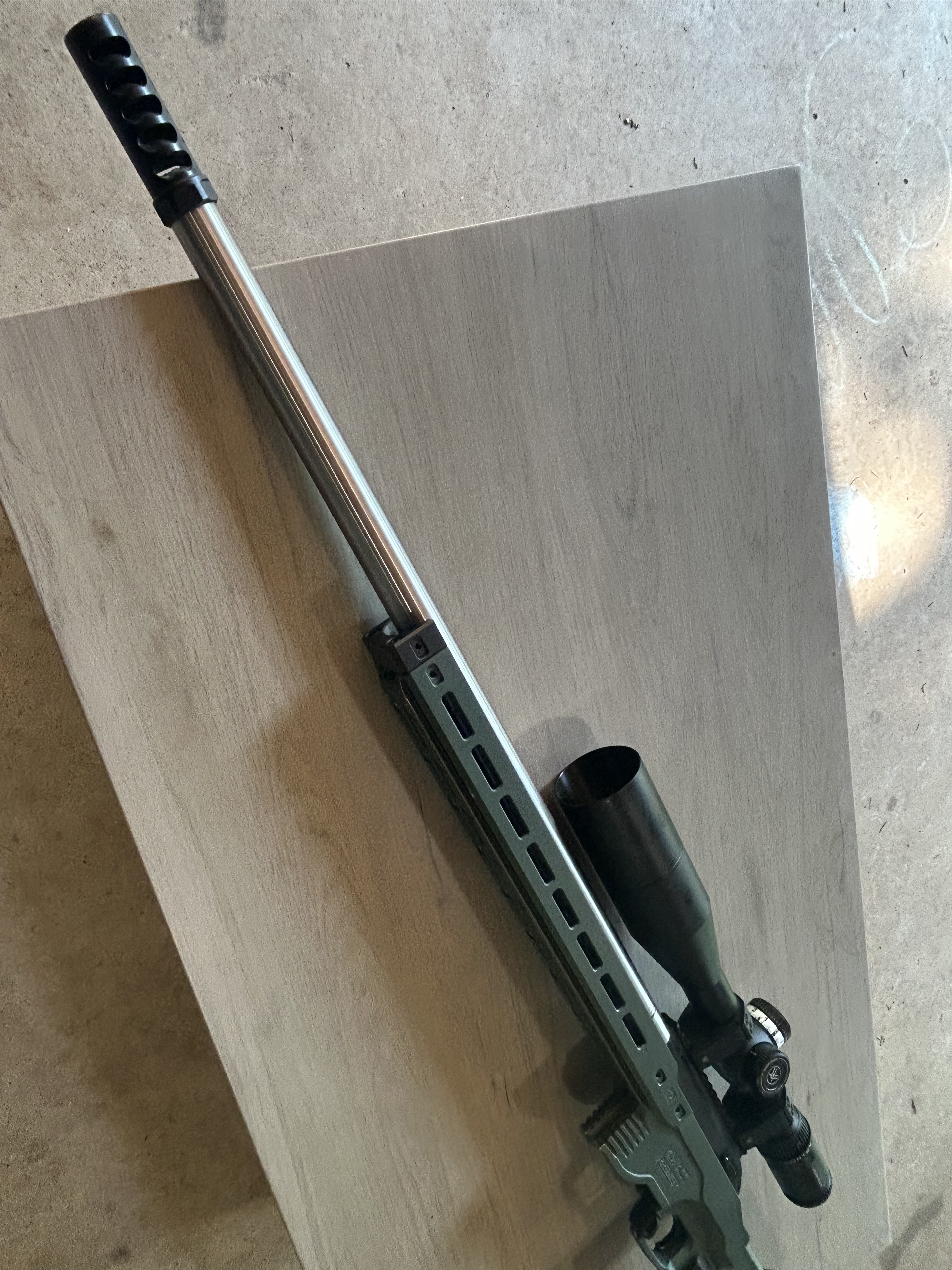

SOLD KIDD Supergrade barreled action in Oryx & Grey Birch chassis
  • KIDD 22lr Supergrade barreled action factory assembled by Kidd 20" Black Steel .920" Bead Blasted - $1,300 (build sheet in photos)
  • Grey Birch MFG La Chassis 10/22 DLX Chassis 10” $525
  • MDT ORYX RIFLE CHASSIS - $780 assembled
  • MDT VERTICAL ADJUSTMENT BUTTPAD
  • MDT ORYX CHASSIS ARCA RAIL
  • MDT MDT VERTICAL GRIP ELITE
  • JAMMER BAG RIDER
  • Everything Total New = $2,600 + tax
KIDD & MDT & Grey Birch chassis = SOLD RELISTING MDT
Kidd & MDT chassis = SOLD
Kidd & Grey Birch chassis = RELISTING MDT chassis
Shoots .35 MOA at 100 yards with Lapua Biathalon. 1 yr old.
Will ship from my local FFL (I’m in Iowa) to your FFL (please provide that FFL name and address). Will accept USPS money orders or discreet electronic forms of payment.

6 Dasher Build
First bolt action I have put together myself. With the easier than I expected. Just had to find the parts. Built this with the intent of getting into PRS and learning how to shoot better for hunting. Now I just need to figure out how to do this reloading thing. Hope to do a ladder test this week from 32-33grains if Varget.
Build List:
Impact 737 Action
Foundation Genesis 2 Stock
Proof Research 1/7.5 Dasher Prefit Barrel
Hawkins Bottom Metal
Trigger Tech Diamond Trigger
Area 419 Hellfire Brake
Leica PRS 5-30x56 Scope
B&T Atlas Bipod
I have a Nightforce Atacr 7-35 MilXT on order for this rifle, but took the Leica of my big game rifle until it comes in.
Going to use:
Alpha Munitions 6 Dasher Brass
Berger Hybrid 105s
Varget
BR4 Primers
