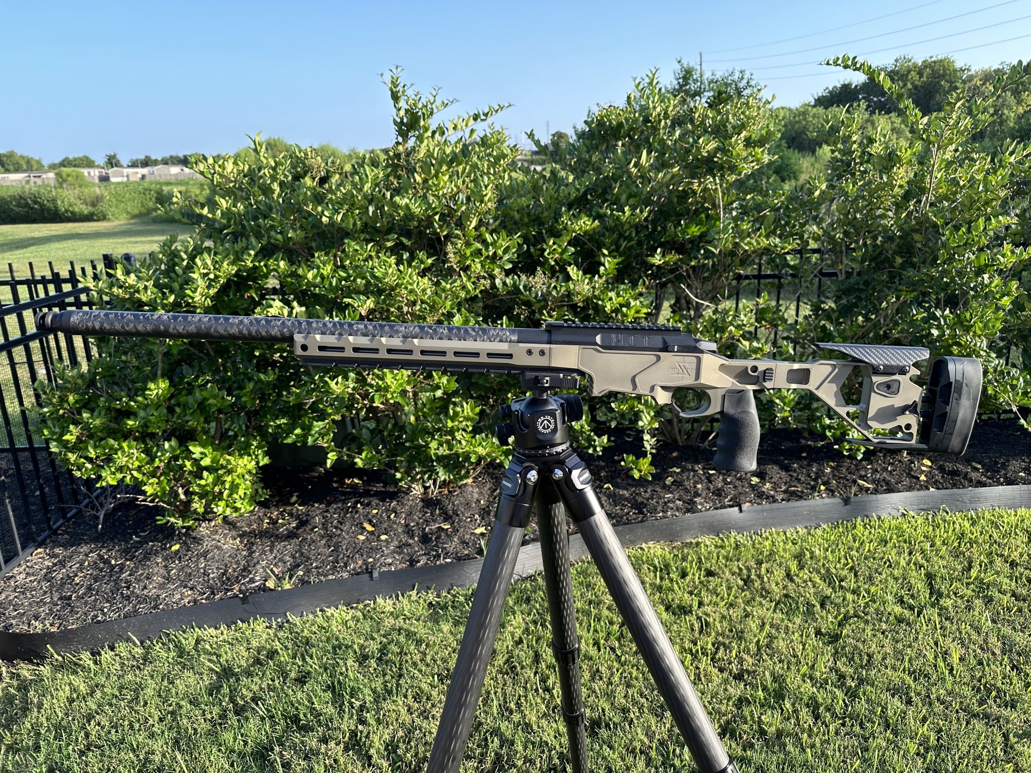

This barrel is a chonk for sure. If you think m24 is a truck axle, you don’t know truck axles. This barrel, she’s a proper truck axle. The Bravo chassis almost couldn’t handle her….almost. The barrel nut was close but daylight managed to squeeze through.
Now this particular setup isn’t new. It’s been wearing a PVA pre fit and the consensus is clear, Josh builds a fine barrel and mine is no exception. I routinely shoot that barrel 0.25” or better (5 shot groups) so the platform is proven. If the Outlier barrel can’t shoot, it’s the barrel maybe the ammo but it’s not the other parts.
