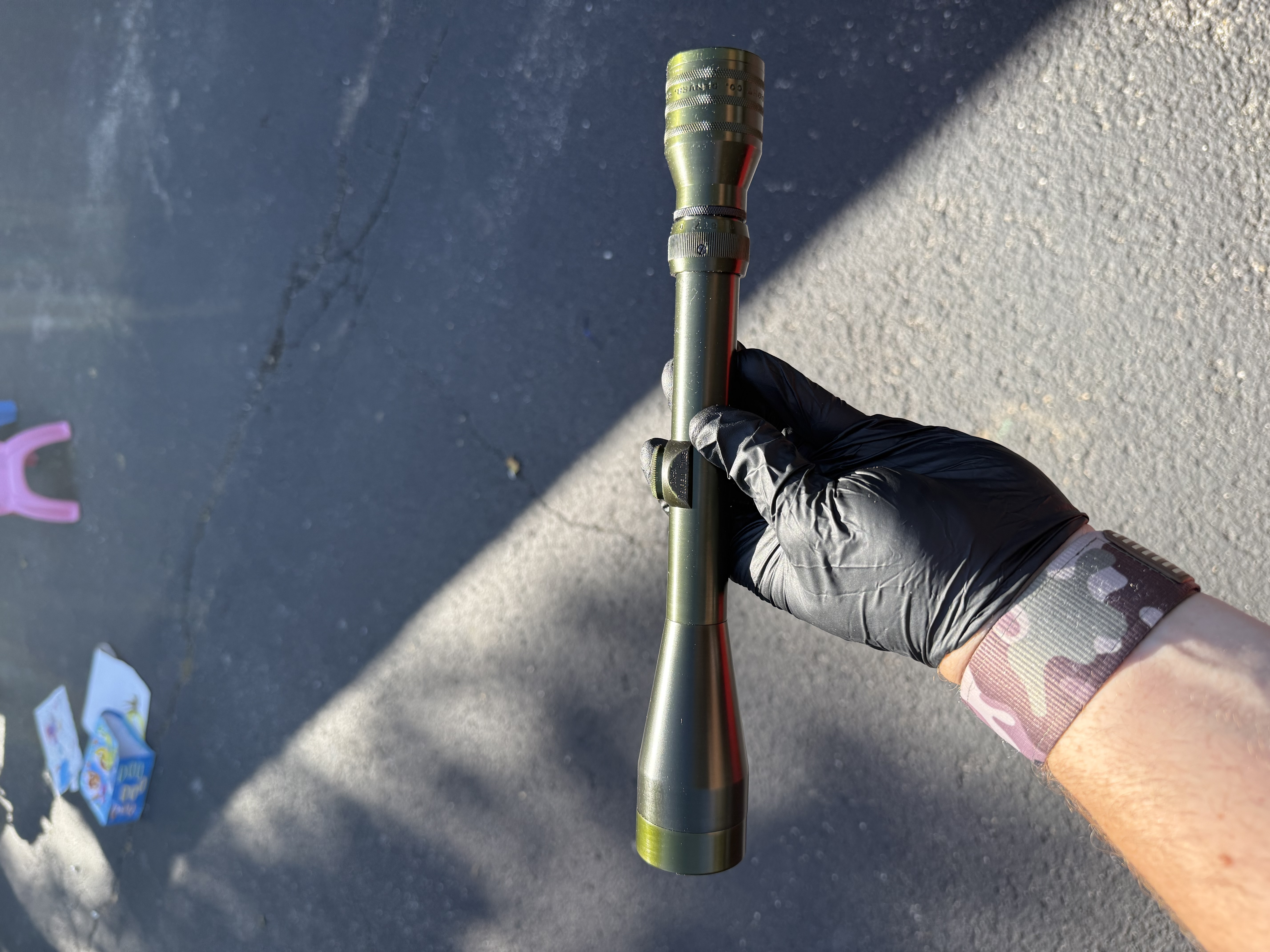

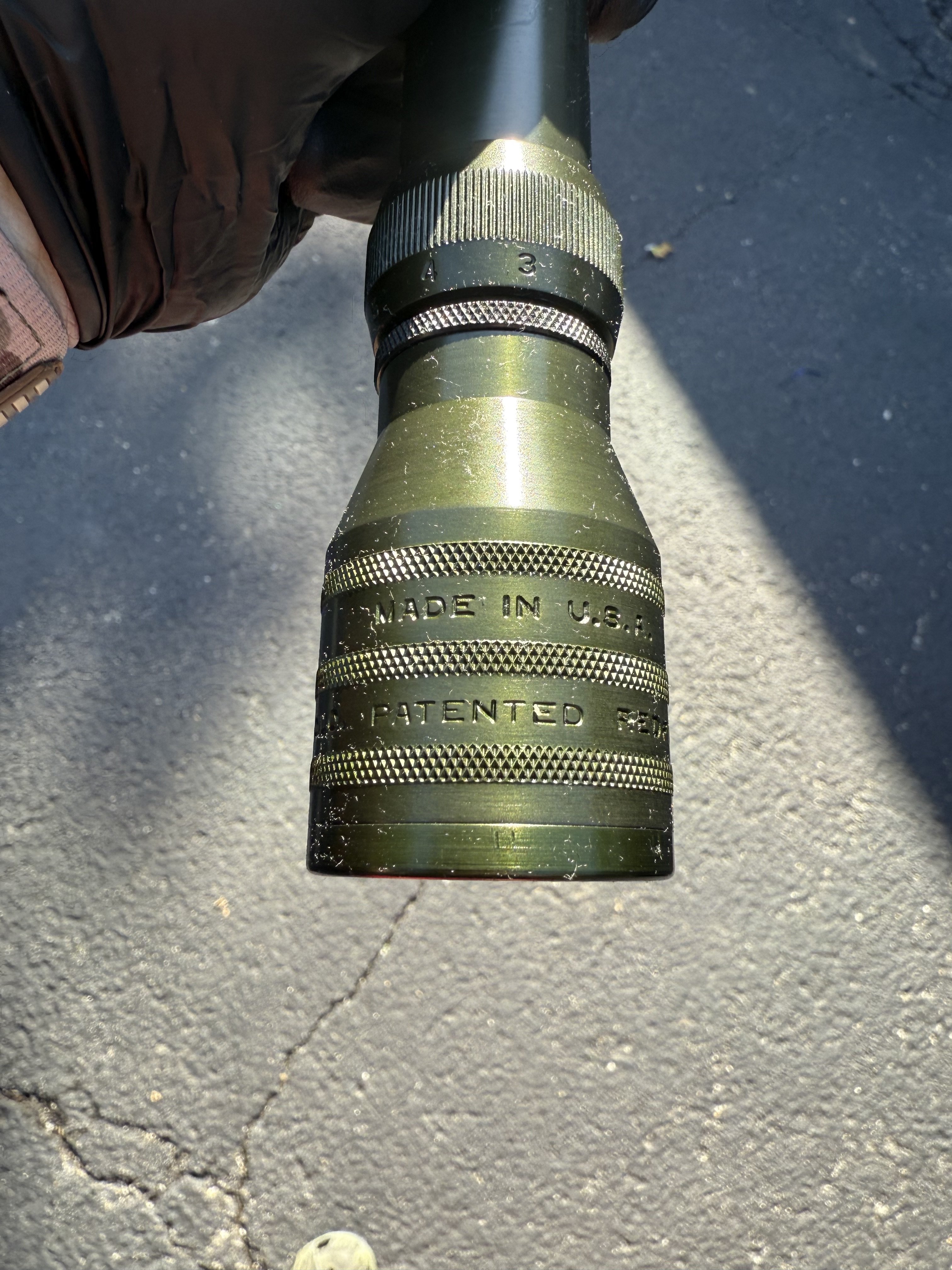

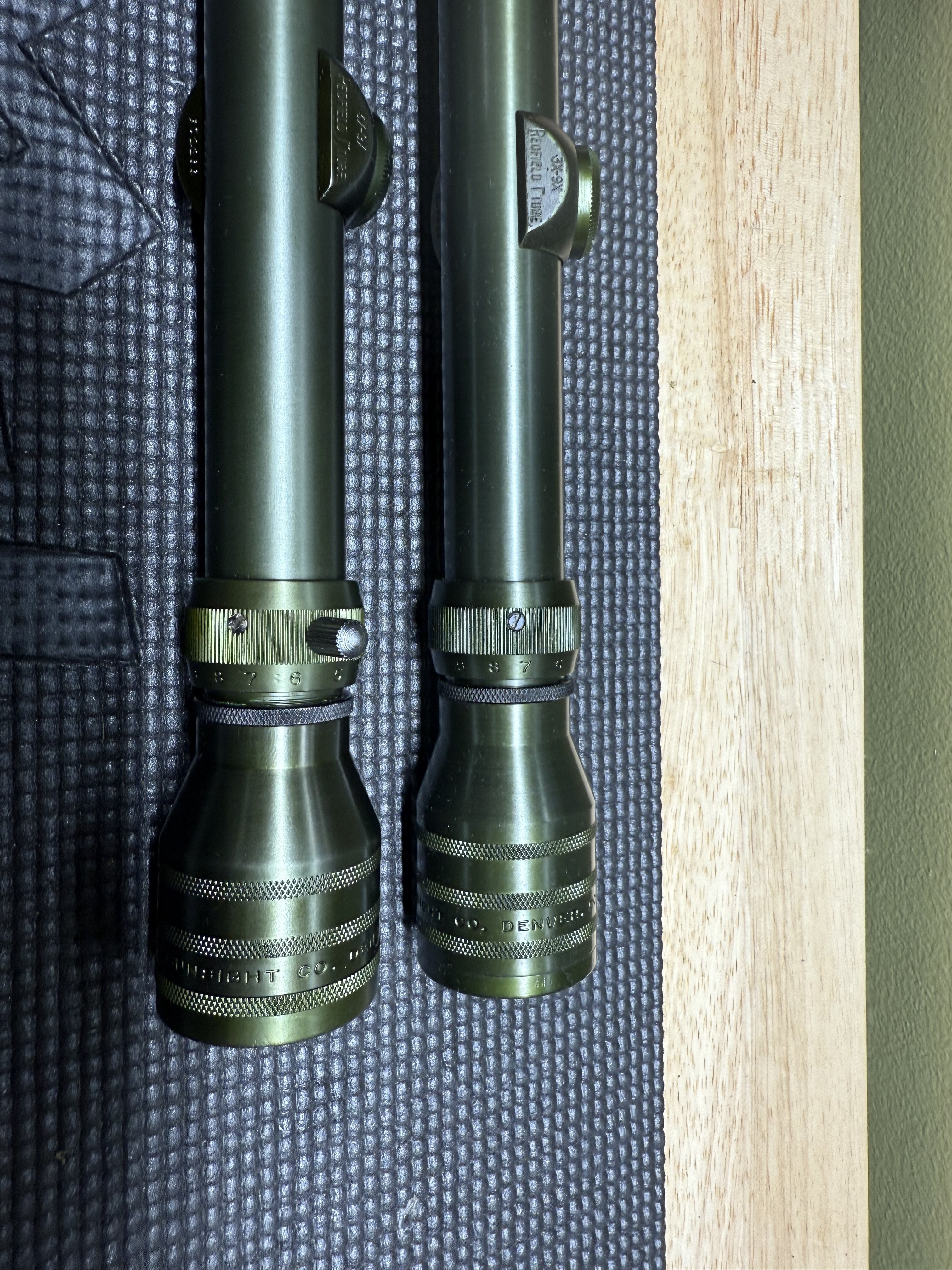

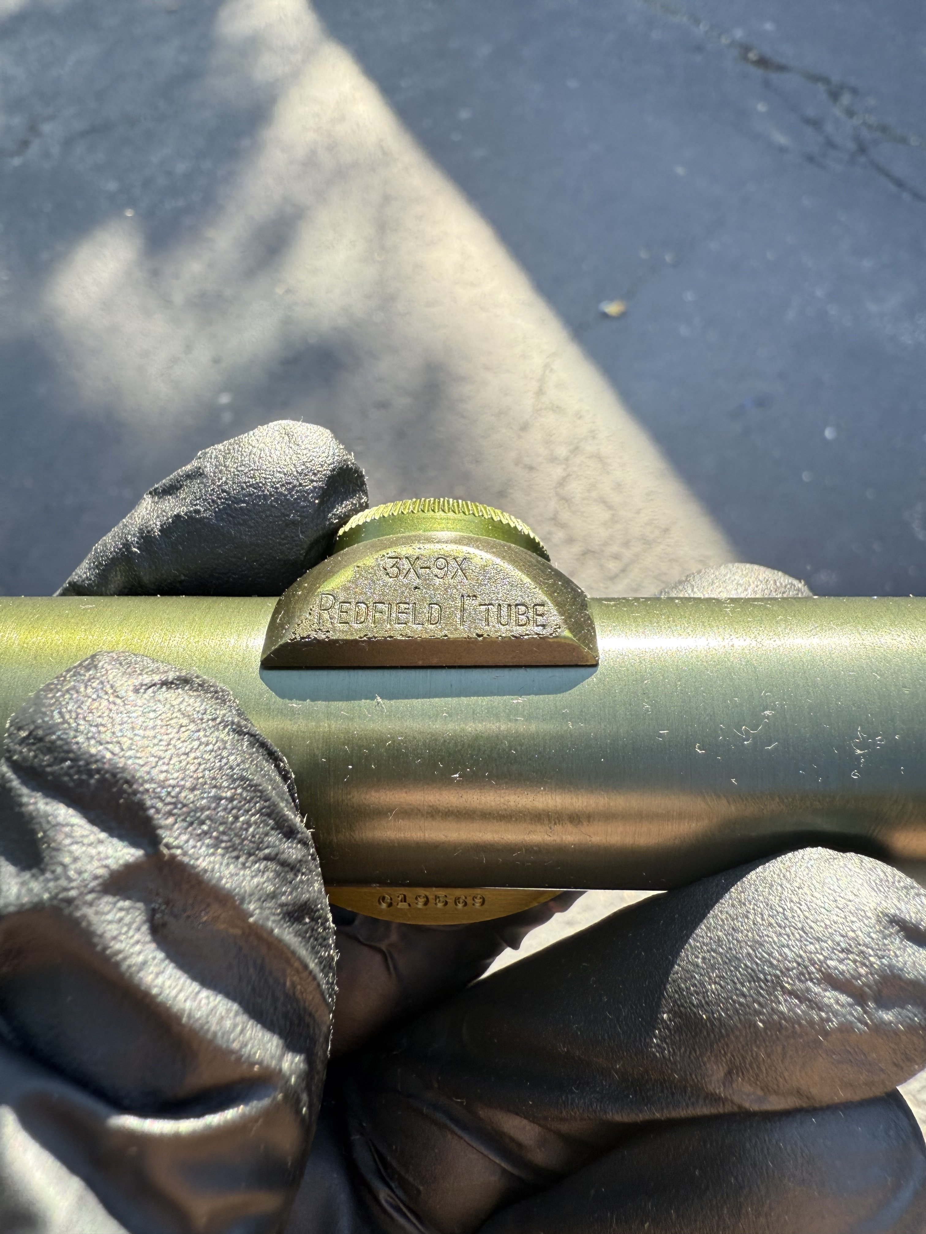

Optics Redfield M40 "Greenie" 3x9 1" tube
" M40 Greeine" Redfield 3x9 1" tube. F serial number, Scope has standard reticle (does not have accurange), does have throw lever. Scope has been anodized green, cleaned, purged, and sealed up. $450 shipped. Second scope details below.
Redfield 3x9, standard reticle, standard zoom, anodized green, clear glass. There is some pitting on the middle part right below “Redfield” it came to me this way. Doesn’t hurt the function at all. $250 shipped.
