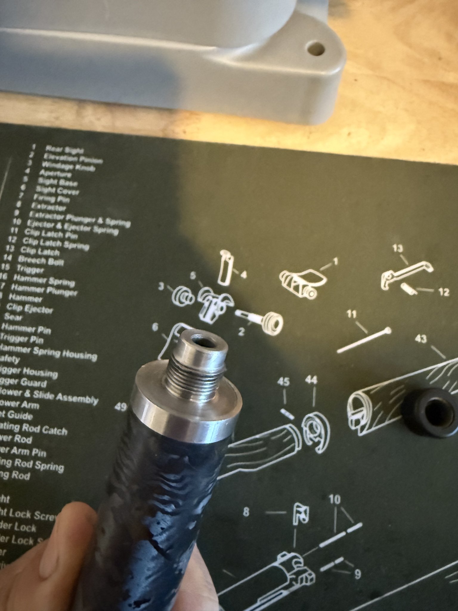

I have a PRI Mk12 mod H that has suddenly lost its accuracy. It held 1moa 10 shot groups all day with my handloads. It has suddenly opened up to 3moa. I checked torque in the optic and rails, tried shooting without the suppressor, and decoppered the barrel. Still shooting 3 moa. The rifle has about 1500rnds on it so it’s not shot out. I ran the handloads through a friends rifle and it grouped fine so ammo doesn’t seem to be the culprit. I took the brake off and cleaned the crown very well and noticed a scratch very near and into the muzzle. I am not sure if this is enough to cause the accuracy issues. The pictures attached do make the scratch look much more severe due to the light. I couldn’t get it to show up at all without outside light so keep that in mind. My next step was to swap scopes to make sure it’s not the optic. I’m trying to get through the last of my hand loaded 308s before I swap (changing bullets). I don’t want to re-zero with such a low round count left.
